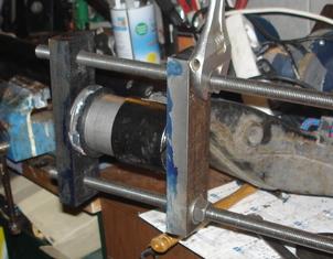

I have made an extraction tool which i will be trialling in the next couple of weeks. Now it is not a light hearted approach , i will be using a 20ton bolt pull ram to extract said bushes:D
The problem is to manufacture something to do these bushes with ease and make it cheaply well errrrrrrrrr i cannot see how you could:confused:

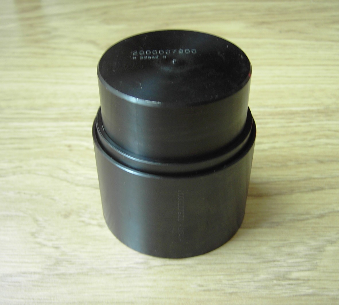

Part number for the tool is 2000007800 priced at £13.79. Considering Fiat special tool are usually very expensive, I ordered it, thinking at least some of the bits may be useful for fitting the Stilo bushes, even if only the three pronged press piece that's needed. Collected it from local dealer today, it looks nothing like the tool in the diagram and as far as I can see, is completely useless. :mad:

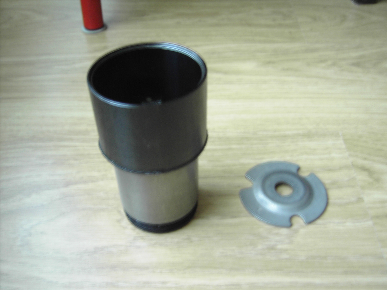

Both the hollow cylinder and the ring have rebates machined around one inner end and the three parts will fit together in the rebates as in the second photo but what it's for is anyones guess. Not even a hole in the cup for a bolt to go through. :confused:
Those parts look to me like they are for use with a press/hydraulic tool. Is it possible they make 2 types, one for putting the bushes in using a press/hydraulic and another for use with a threaded tool as in the drawings. :)
The tool I have is the same part number as in the fitting diagrams. The part number is stamped on each of the parts. There could be a hydraulic tool aswell of course but there's no mention of it in any of the eLEARN manuals.

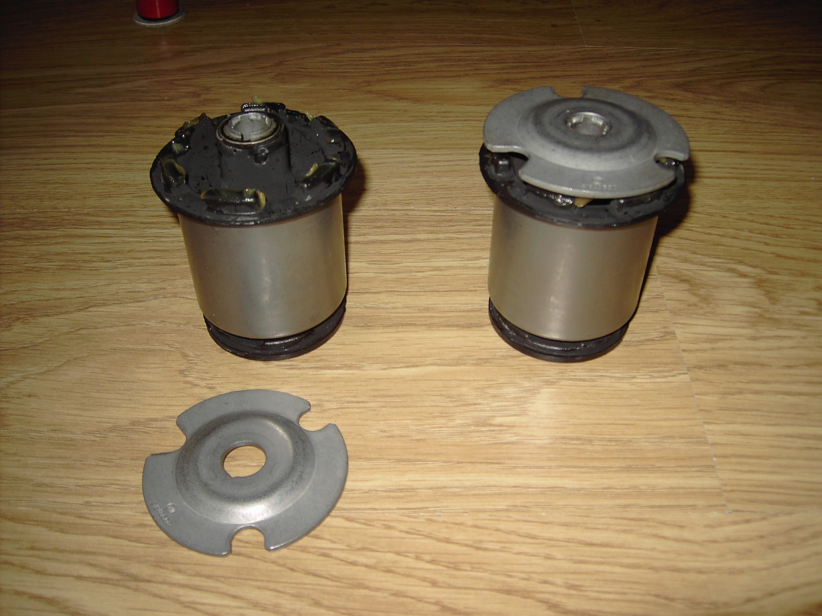

If you take the metal plate off the bush, then the hollow cylinder fits perfectly around the outside of the rubber castellations on the end of the bush. But then the pressing force would be applied to the outer edge of the thin metal flange of the bush. I think the force needs to be applied further towards the middle of the bush through the three cut-outs in the metal plate by using the three pronged press piece.
I have to agree with you the amount of force required would surely damage the thin outer edge. A 3 pronged tool seems to be the only way.

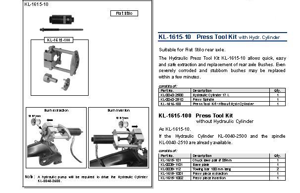

The Klann tool looks the best bet but someone said in a previous thread that they wouldn't give a price for it. :confused:
I phoned them today for a price for just the insertion and extraction press pieces (save me making the 3 pronged piece) woman said she would phone back with a price but hasn't yet. :(

Klann tools are a total joke.
I have phoned them several times and i,m still waiting for a reply, i have given up on them please dont hold your breath waiting for a reply , you may just turn blue !!!!!!!!!!
If you do get a price i would love to know how much

i second that with klann, ive also contacted them a number of times and never recieved a reply, i was willing to purchase the whole kit from them as we have two multiwagons and im sure others in my area would have benifitted from the tool,

Klan tools do seem to be a bit of a joke. Lots of enquiries about the tool but still no joy. They can't even be bothered to call anyone back forcing potential buyers to contact other outlets abroad. With that sort of customer service I'd rather build my own(keviwal) (y)

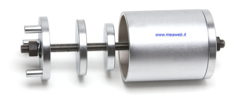

For the likes of me and every other "average Joe" the much simpler and cheaper threaded type that Franklin Tools produce would be a much better idea IMO. Most people will probabely only ever replace their rear bushes once or twice in their lifetime, a hydraulic tool is just far too expensive, may as well replace the axle. :(
Well, surprise, surprise, I got a phone call from the woman at Klann UK today (y)..................
To say that she hadn't had a reply from Klann Germany yet. (n)

Ha! I think someone's posted that image before. The screwthread doesn't even look strong enough to use for bushes on a bicycle:)

yes i have seen those and in a word .............cr*p !!
they just do not look man enough for the job.
What you have to remember is that you have to put TONS of pressure on that bush to get it out, looking at that tool you would probably put POUNDS of pressure on the bush before the threaded bar picked and it all went pear shaped :bang:

Decks the one i have made has 1.5 inch diameter bars that hold the ram, even though the ram will be in compression on them, what you really dont want is the removal tool collasping as you wind the power on;)
