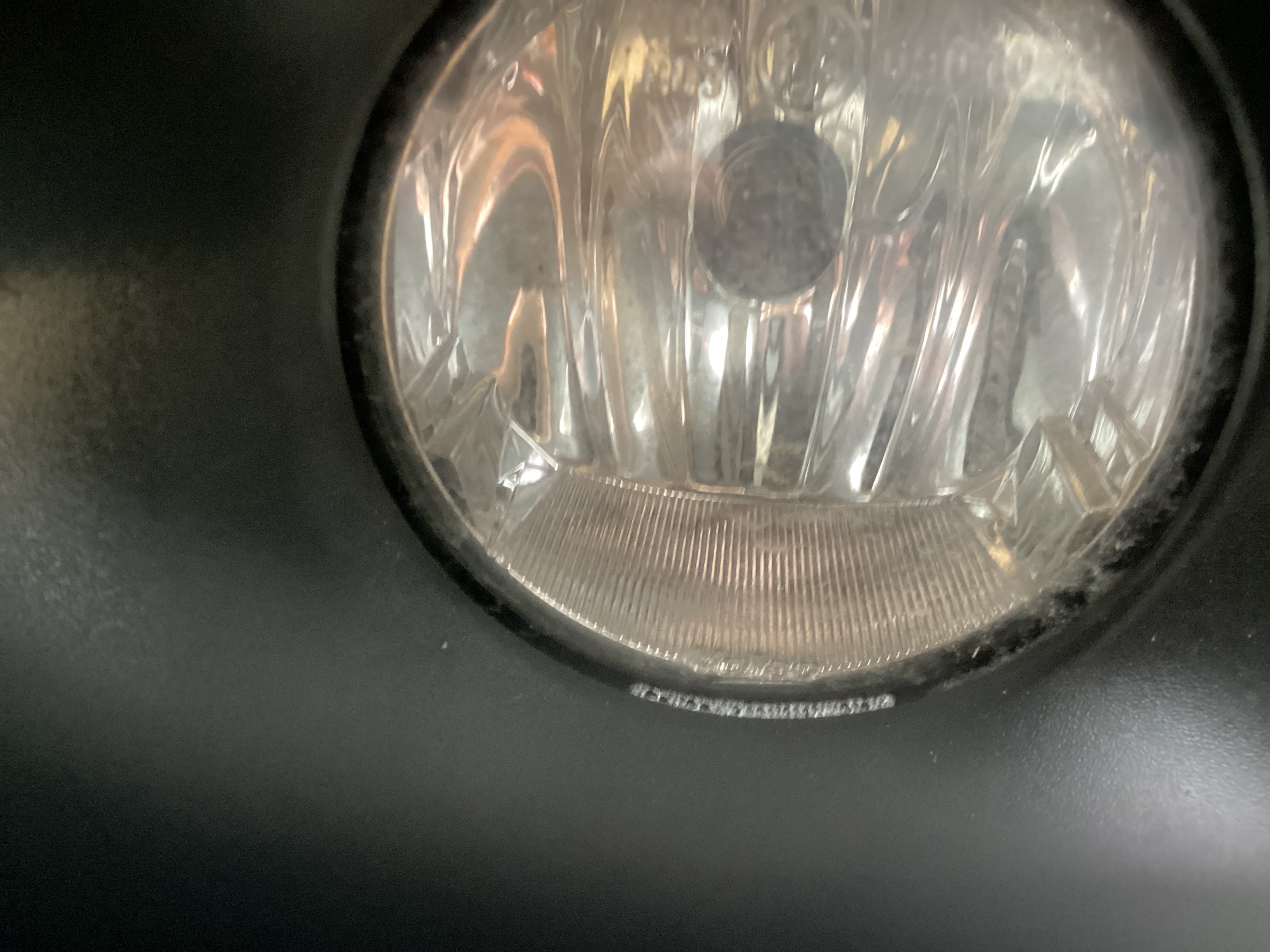

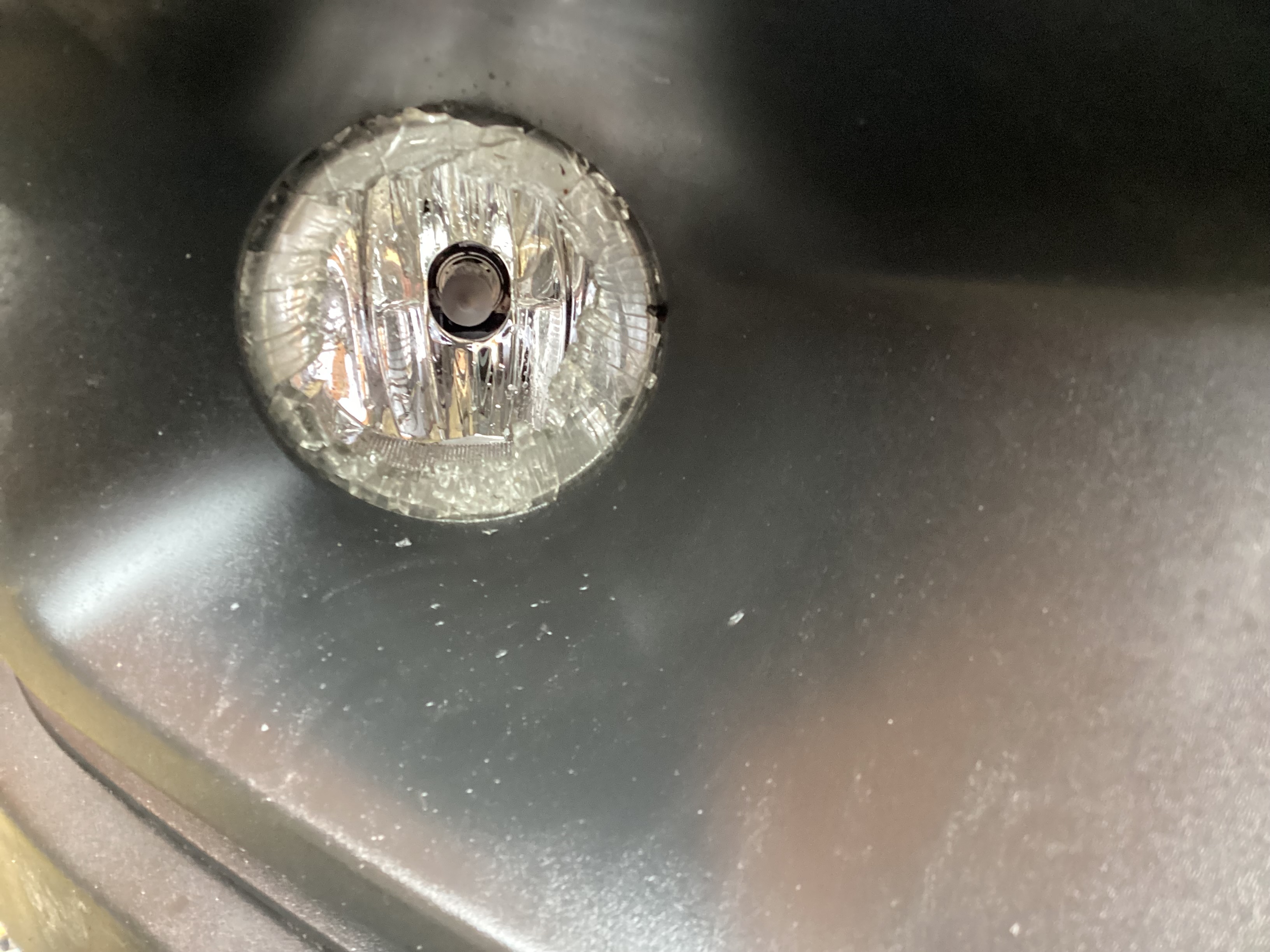

Jumping on this thread, but I’ve just found the o/s front foglight smashed on my 2021 TIPO. It’s stormy and cold outside so I’ve not had a chance to check access, but does anyone know how to access the back to swap the unit?

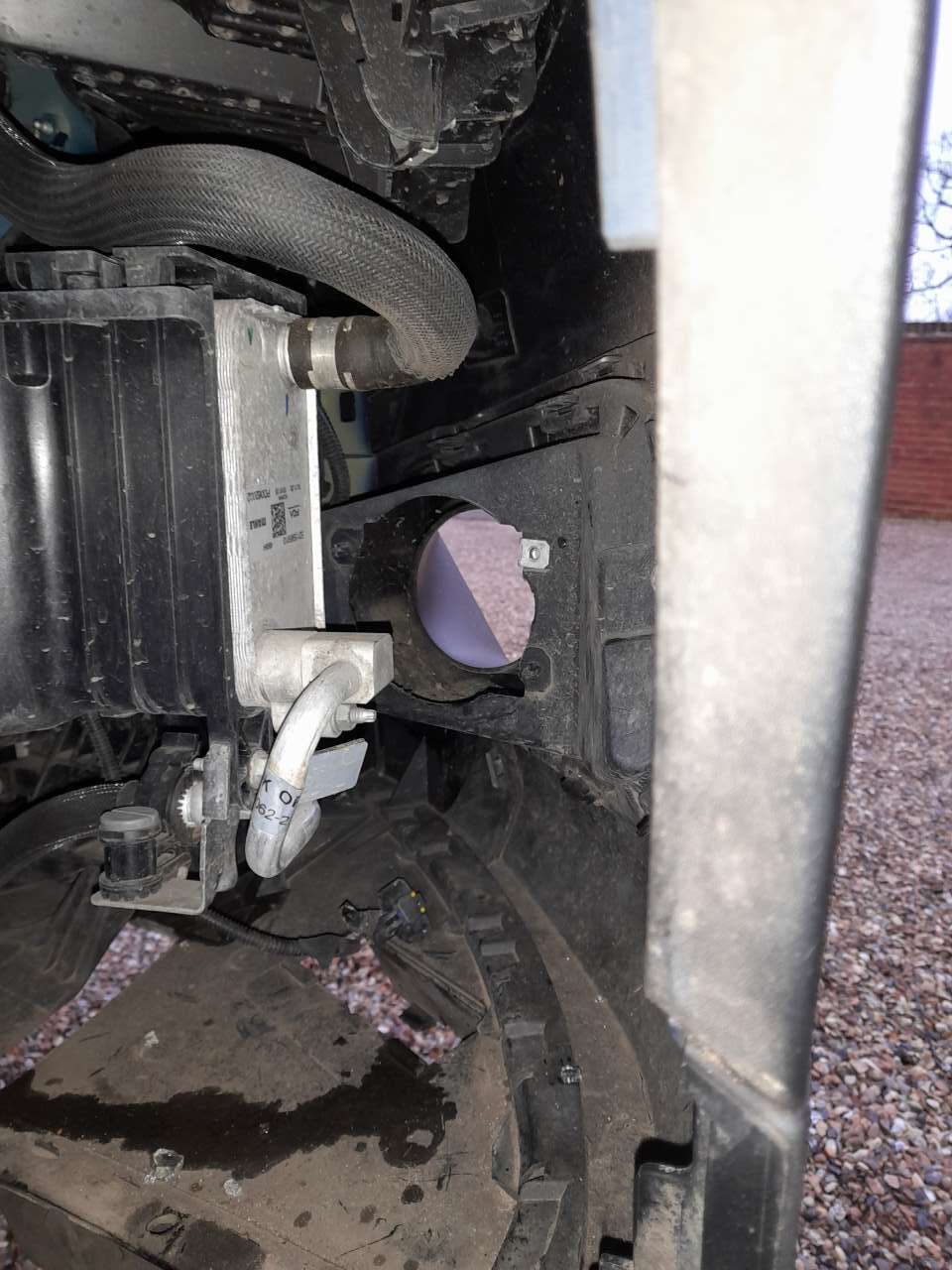

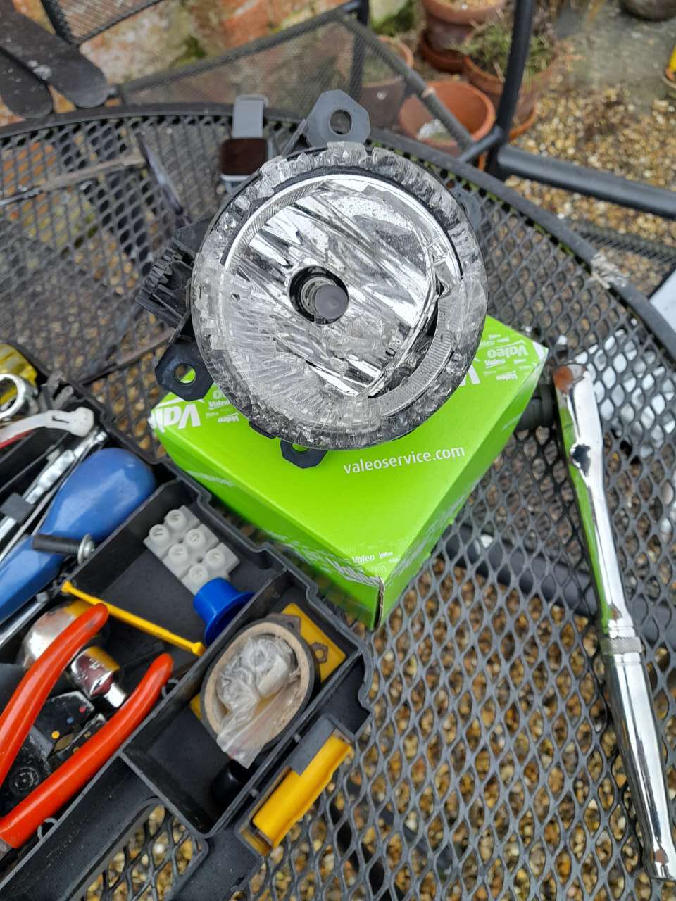

The new Valeo unit has arrived, but apart from a Quick Look at the wheelarch liner which showed the hatch in position for the headlamp but not the foglight the weather hasn’t been good enough to crawl about under the car.

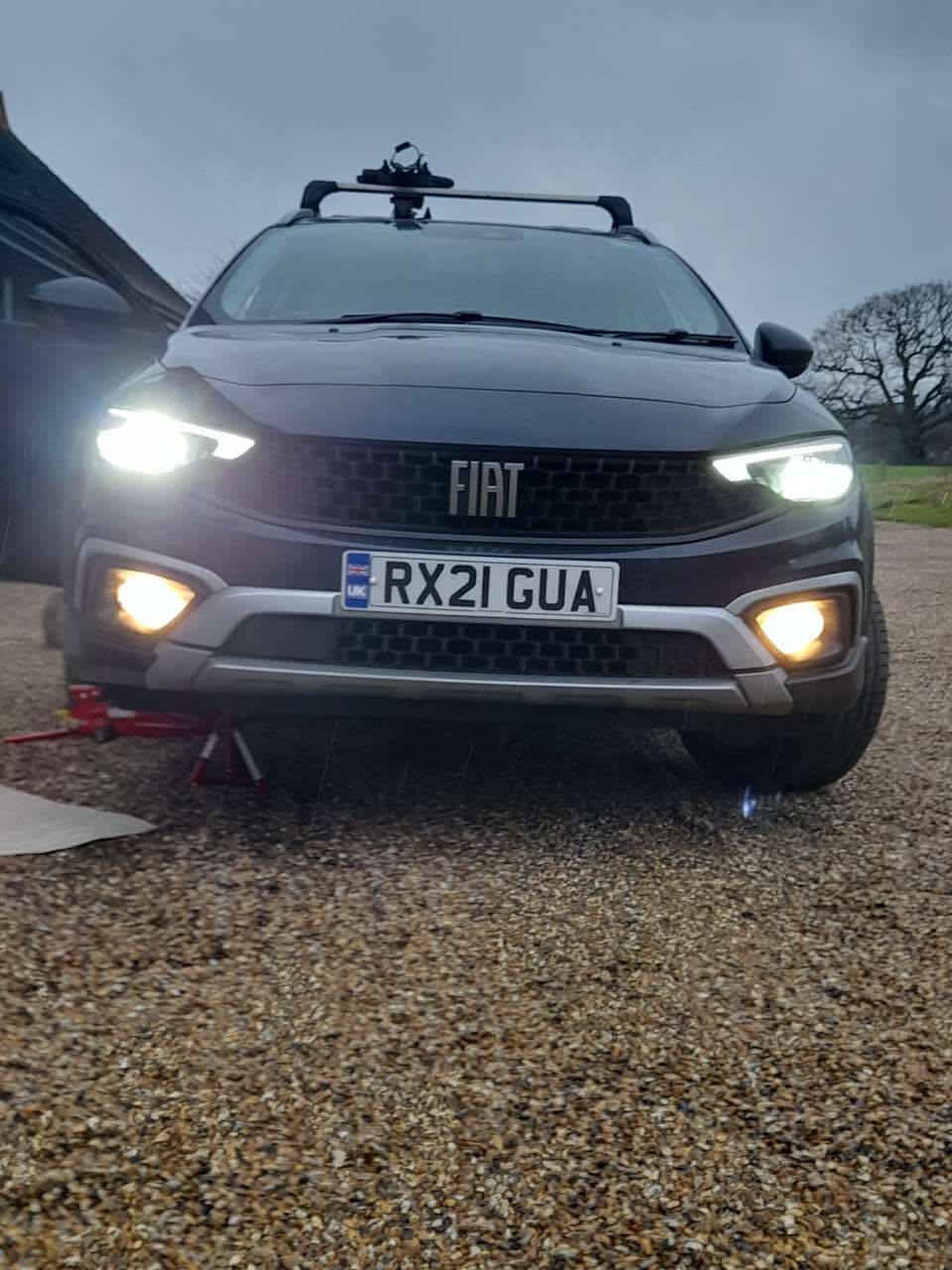

I’ve just done it. Had to take the wheel off to get the arch liner out of the way and then just about reach the two securing screws. Getting it out was a very tight squeeze behind the condenser!
