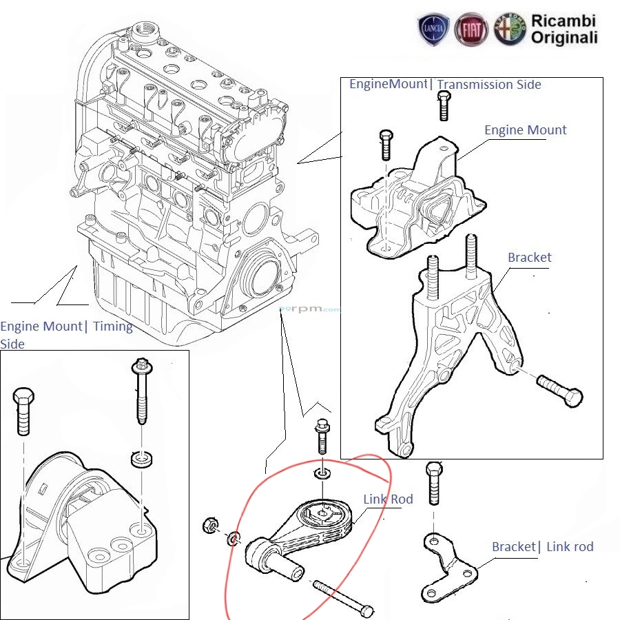

My 1.4 8V 2013 is shaking on operational temp at idle (700rpm, VVT, Euro5). When I turn A/C , rpms are going up to 720 and theres no shaking. I feel shaking of whole car on hot idle, in steering wheel, seats, everywhere. I opened bonet on idle and watched engine movement when I quickly press gas pedal, engine shaked once "forward and then back". Also when I quickly accelerate for example on 3rd gear, it shakes with car, and when I release gas pedal, it shakes again.
So based on this quickly method it looks like dogbone engine mount has broken rubber.
I didnt eye inspection yet, just to want your opinions/experiences.
What I saw on pictures, this dogbone is made by 2 parts? One looks like "triangle" with some rubber bushings, and 2nd part is dogbone itself...is that correct please?
Or how to simply diagnose if main engine mount is bad, or lower (dogbone) is bad? My main mount has space between upper metal part and rubber part approximately 1,5cm. Is it ok? I'd like to diagnose it before creeping under car to dismaount dogbone...so any info is helpful here guys! Thx ;-)
I changed dogbone on 2 previous cars, but on one car there was also shifter movement back and forth, and on 2nd car I heard metal bang, so it was easy to identify bad dogbone...
Maybe I can shake engine via oil pan back and forth, and see movement around dogbone...this looks to me like easiest method...?

Hi guys,
When my mj dogbone failed.. you could just grab the top of engine.. and rock it towards front and rear...
It was wrecked.. no rubber left in the dogbone.. and new one was @£20 :)
Hmmm I grabbed engine from top side, but I almost didnt move it. Because dogbone is lowest mount, I think I must push engine through oil pan. I'll try it soon and let ýou know guys
