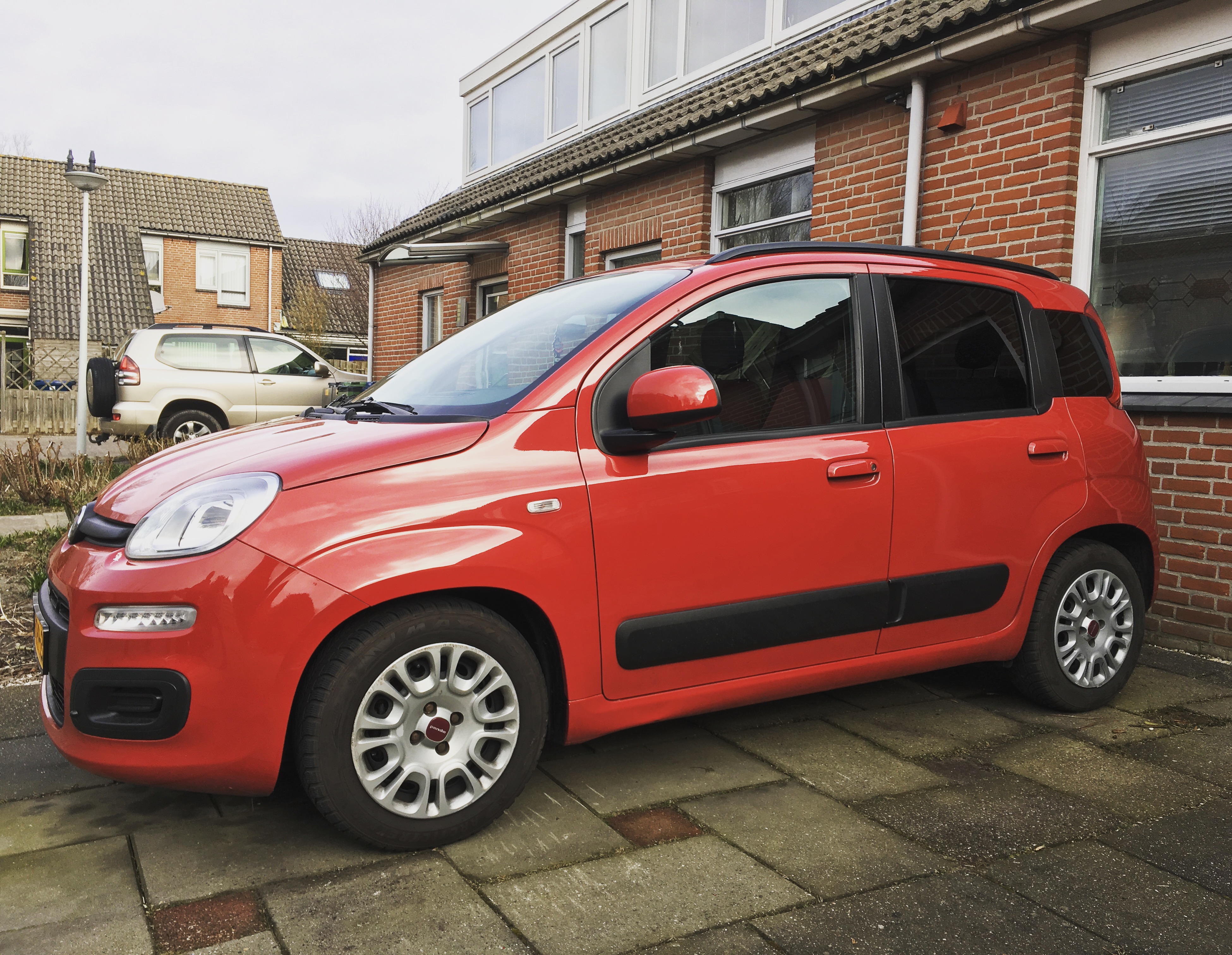

Great looking panda! I have the same wheel covers. We need new wheels ASAP.
ET37 the wheels are 7J wide.

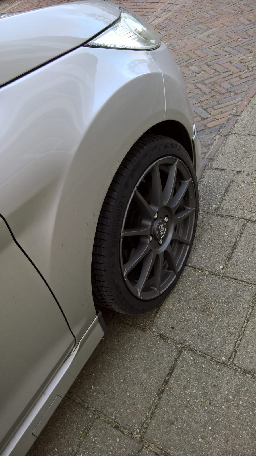

How are the wheels coming, have you fit them yet?
I really wonder what the end result is going to look like.

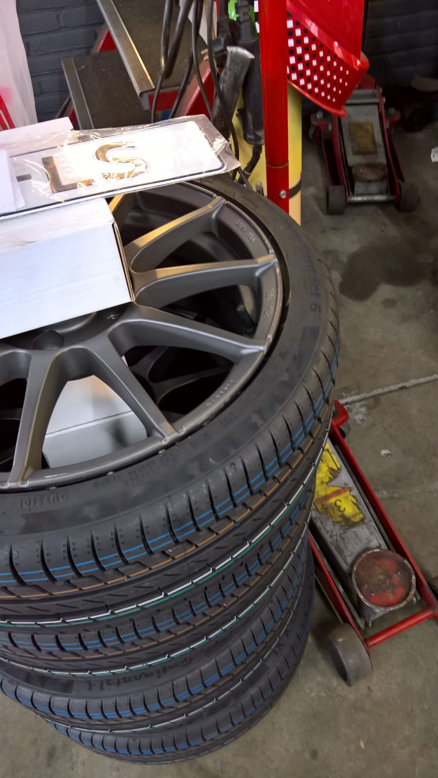

I've ordered the tires for my new 17" summer wheels and hope they will be in soon.
I'm going with the Continental Premium Contact 6 in 205/40R17.
I can't wait to get my insane 17" Tec Asa 2's on my car.
Buddy of mine got these tires in the same size on 17x7 MSW wheels for his Ford Fiesta and they look great(the wheels as well). The tire sits very needly on the 17x7 rim so I don't expect any problems with fitment on my Panda.

No the tires stil have to get mounted on the rims...
Witch color do your Tec Asa rims have??
