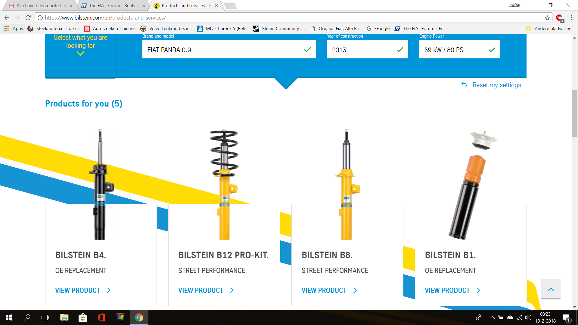

As stated before, Bilstein does not offer the B8(short sport shock) for the Panda 312. There are lots of companies that say the do have them but if you talk to Bilstein directly they will tell you that there isn't a B8 made for our car.
I'm not saying that the shocks being offered won't fit but they are not developped specificly for the Panda 312.
But there on the site off Bilstein...
Then I stand corrected. I've maild a while a go and then they didn't offer them. Also I checked last week on the Bilstein site and the B8 shocks still didn't show. Now it does appear on the Bilstein.com site so it must be correct.
I would suggest to contact Bilstein directly to ask if they have the correct part numbers.
Lot's of sites where offering them for years but Bilstein said that these wheren't correct so watch out when you order.

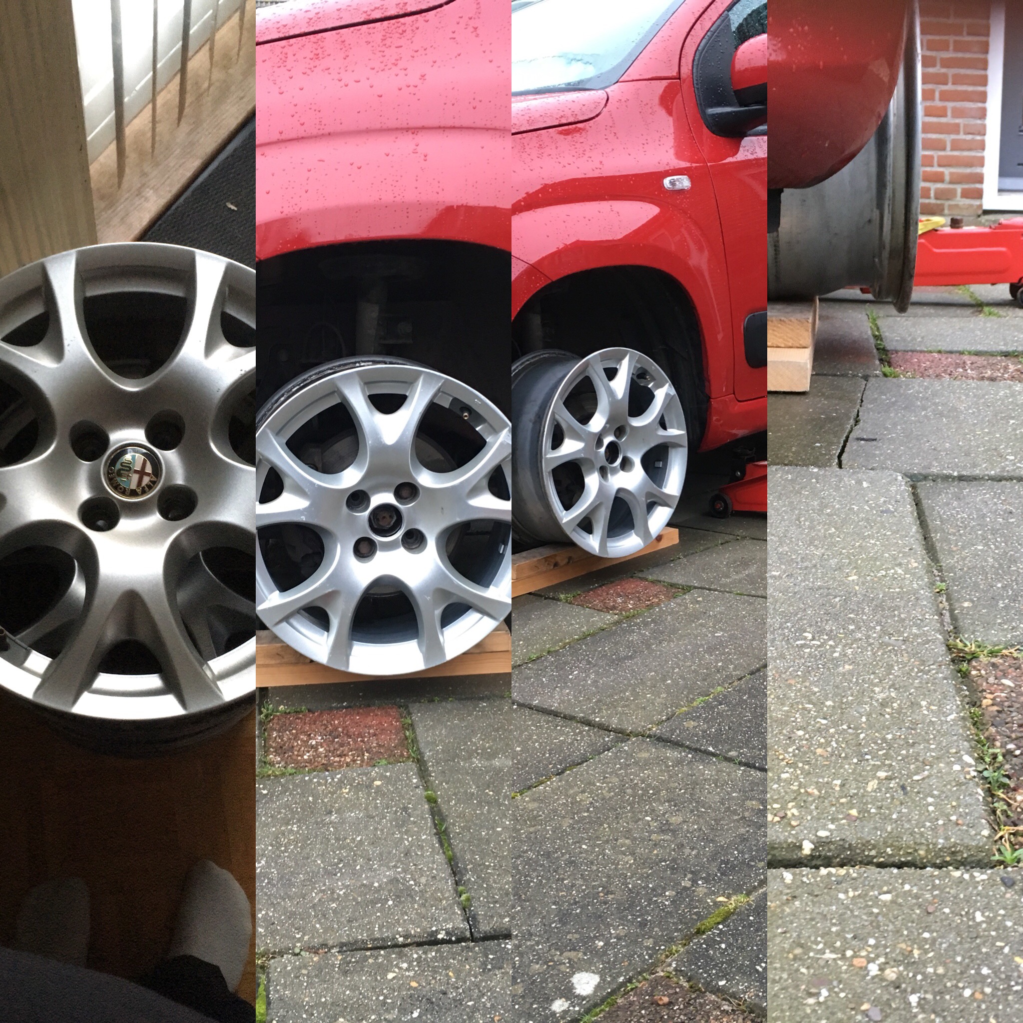

I would like some pictures of your Panda and the Mito wheels. I have also looked at many Alfa wheels but could never find a nice pair.

And...This thread is worthless without pics:p
Only after i put on the Mito wheels...
With these 175-65-R14 winters i'm not even going to try

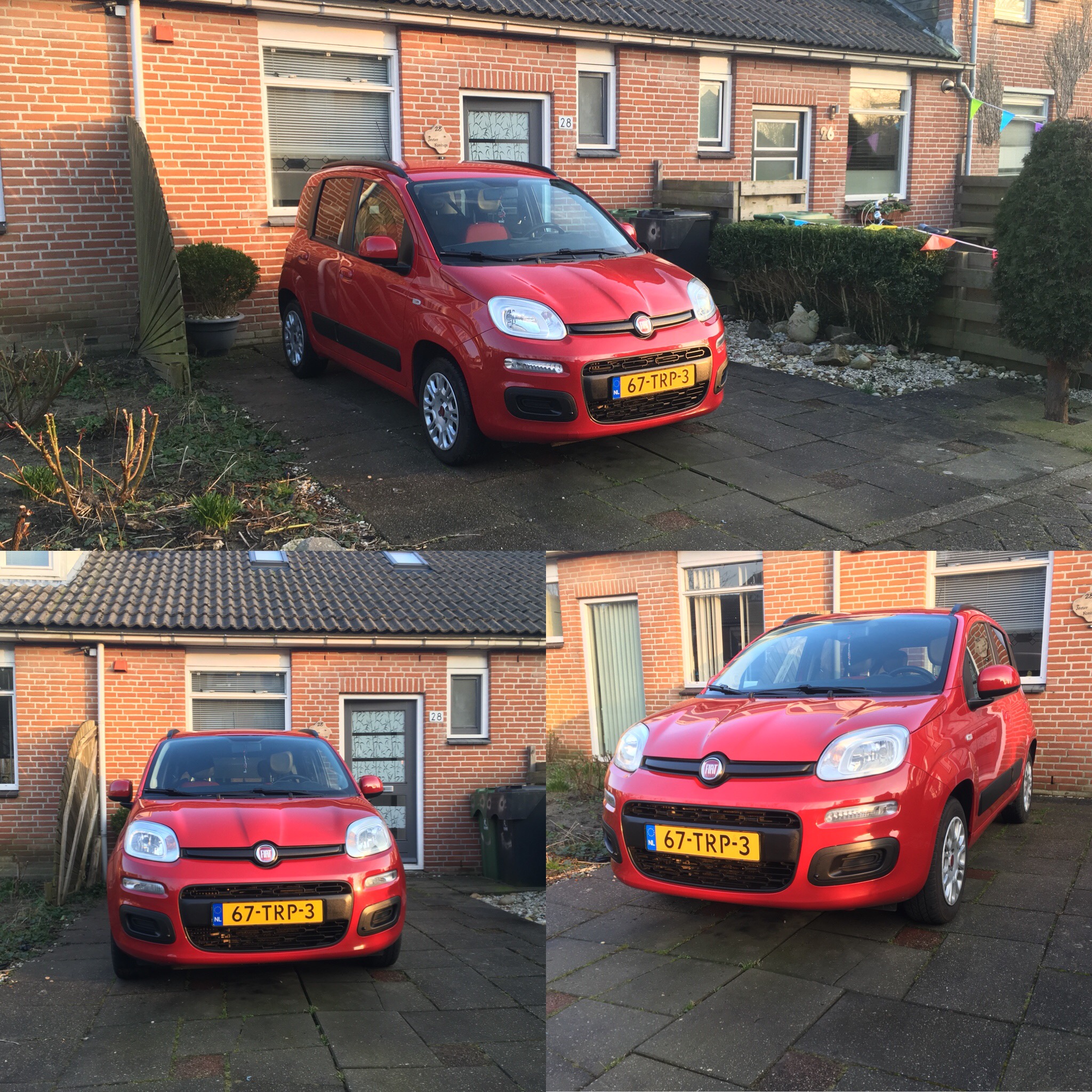

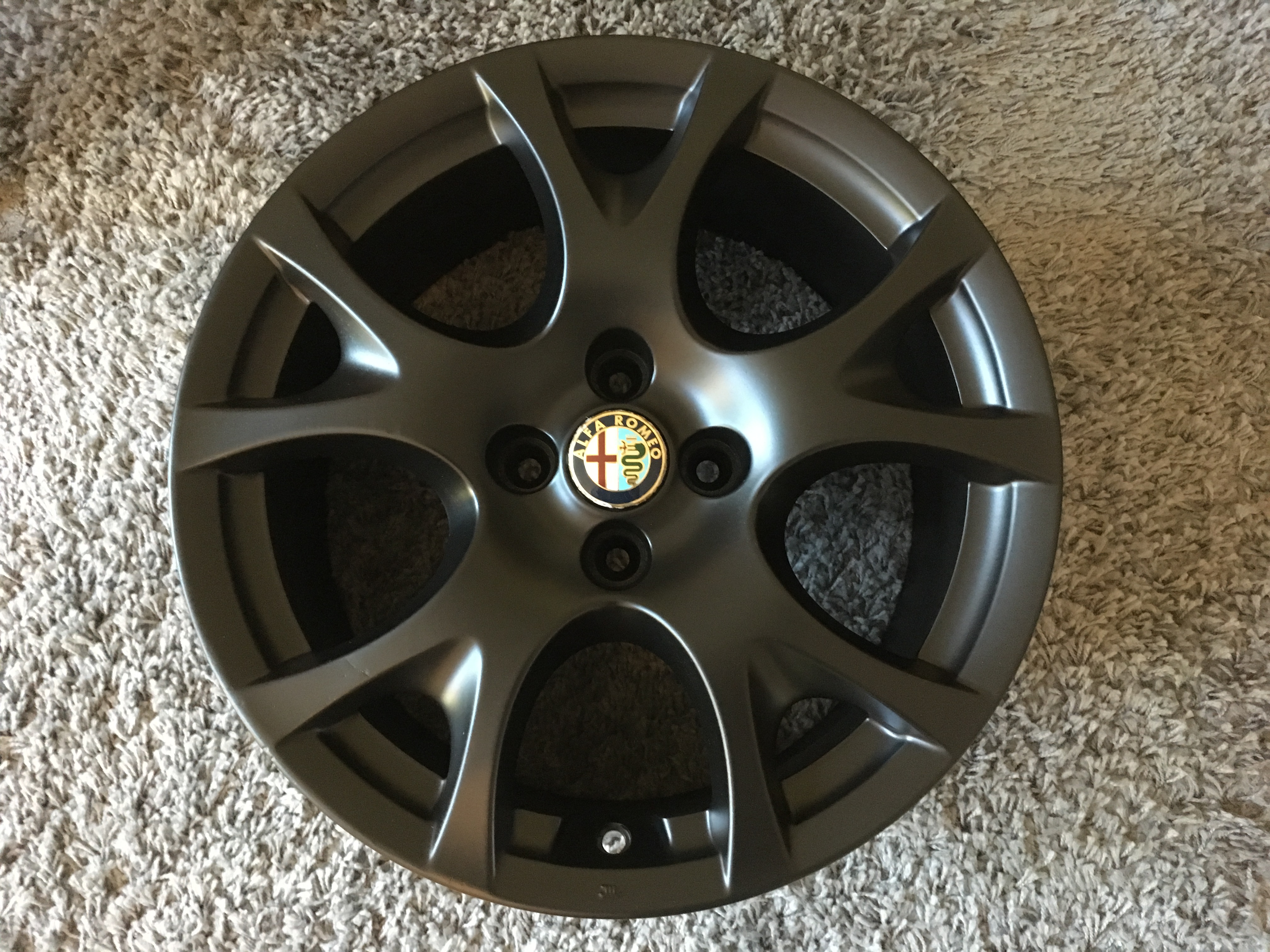

Nice Panda(y) I like the Alfa wheels. Are they going to be the dark color or silver?
What brand and type of tires are you thinking of for those wheels?
Matt black, so its the same as the plastics and rear windows.
