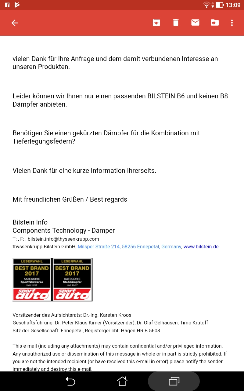

Well Bilstein offers their B4(wich is more or less an oem replacement) and B6 sport shock now for the Panda wich might be an interesting upgrade(esspecialy in the rear) but sadly not the shorter B8 version.
Yes, i came along copanies that offer those parts for the Panda 312/319.
But i have contacted Bilstein directly and they told me, they have no fitting parts for the 312/319.
Maybe my info is more rescent. I don't have part numbers though, but I do believe they are now mentioned at Bilsteins site.
This is what they mailed to me:

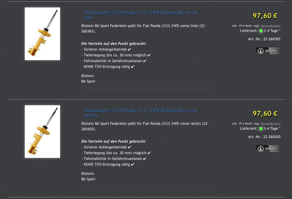

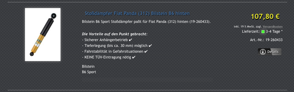

Same here. Do plan on fitting the 17" wheels in the summer but I'm not in much of a hurry. I might be interested in fitting some Bilsteins B6 to the rear but the front suspension is working fine.
These partnumbers look to be correct:
https://www.fahrwerke-stossdaempfer.de/en/fiat/panda-312

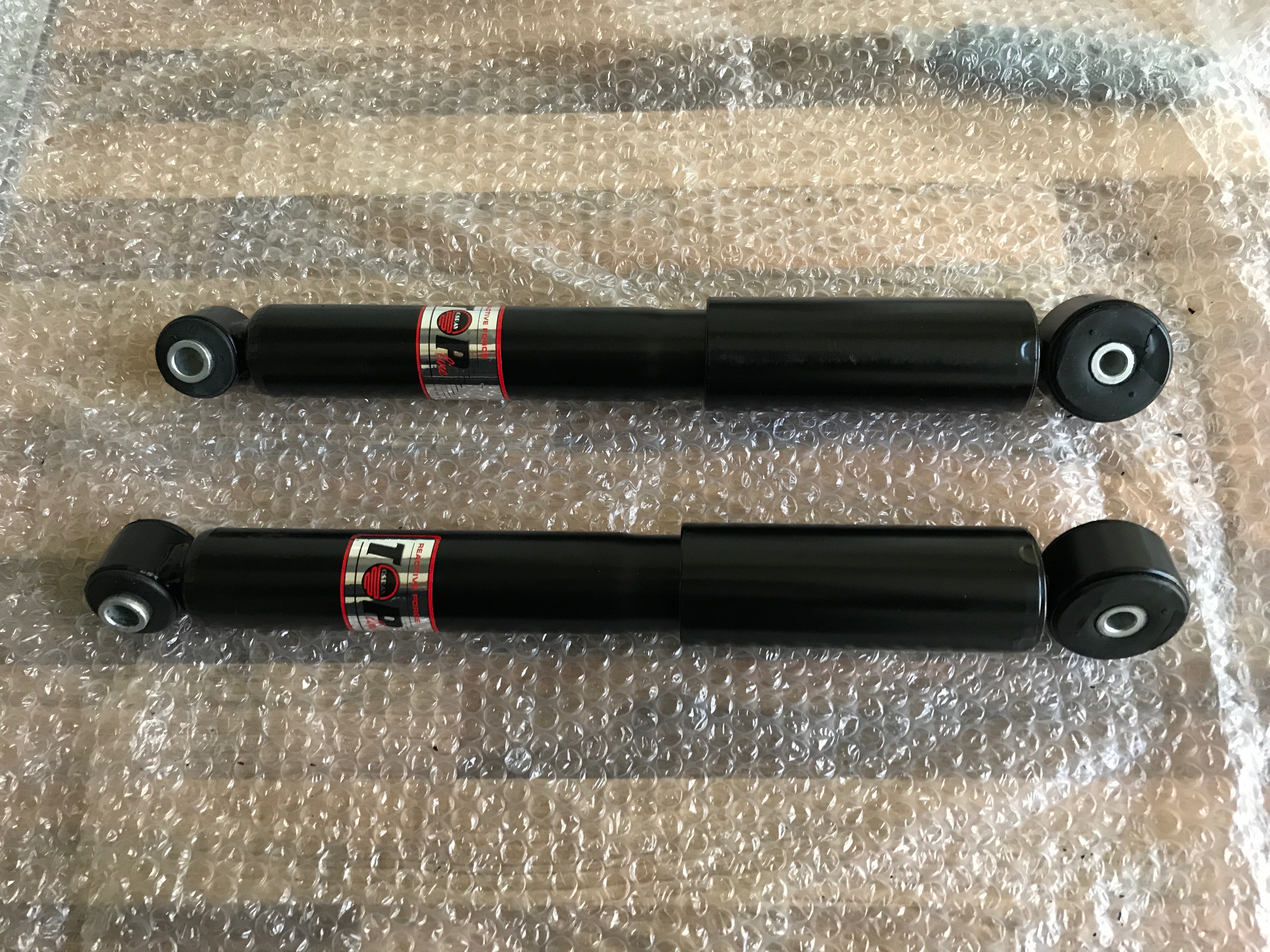

If interested you can get my less then 1 year old rear shocks. ;)
i will send them to you for free.
That's very kind of you. I apreciate your offer but if/when I change I will probably go for a B6 in the rear to make the damping more controlled and stiffer. With the stock shocks the rear feels under damped on compression.
