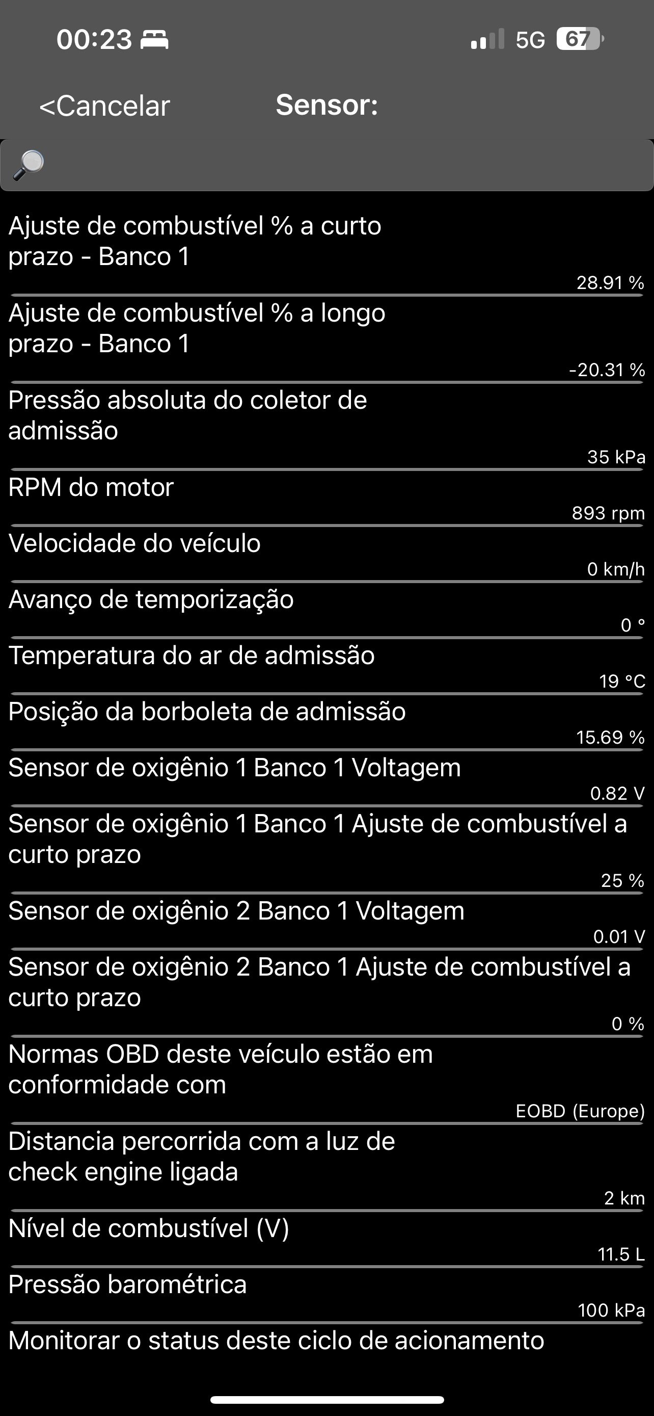

Some time ago, when my car was going at high speeds 120km/h or higher than 3000rpm, it went into safe mode.
After that, I took the workshop, where we read the errors on the machine, and it was the following:
P0300
P0302
P0303
This in the first reading, I changed the candles, spark plug cables, coils, and crankshaft sensor. After a few more laps, it happened again in the same circumstances, only when I'm at a high speed. There I called again, and now I have the p0300 and the p0302, I would like to know your opinion. Is it the fuel injector? Lambda?
Attached I leave some real-time information, in idle 900rpm it has a short-term fuel adjustment of 28% and long-term -20%. The collector pressure is at 35kpa which seems normal to me, the butterfly position 15%, oxygen sensor 1 at 0.82V in which the short adjustment is 25% and the oxygen sensor 2 is at 0.1V. Hence my thought of the lambda.
Thanks!

That looks to me like readings from a generic error codes reader. So, knowing we're speaking FIAT, can be not precise.
However I did some digging in eLearn and found those troubleshoting docs for the errors that start with the a.m. numbers.

I Will try clean, but my sensation is sonda lambda or injector
