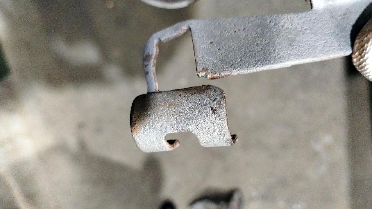

The right handbrake cable hasn't gone on yet, problems, but when i checked it didn't look like it was going to solve the problem, so i went to the left hand side and found this...
This is a fixed bracket on the rear axle that holds the left handbrake cable.
How do i fix this?

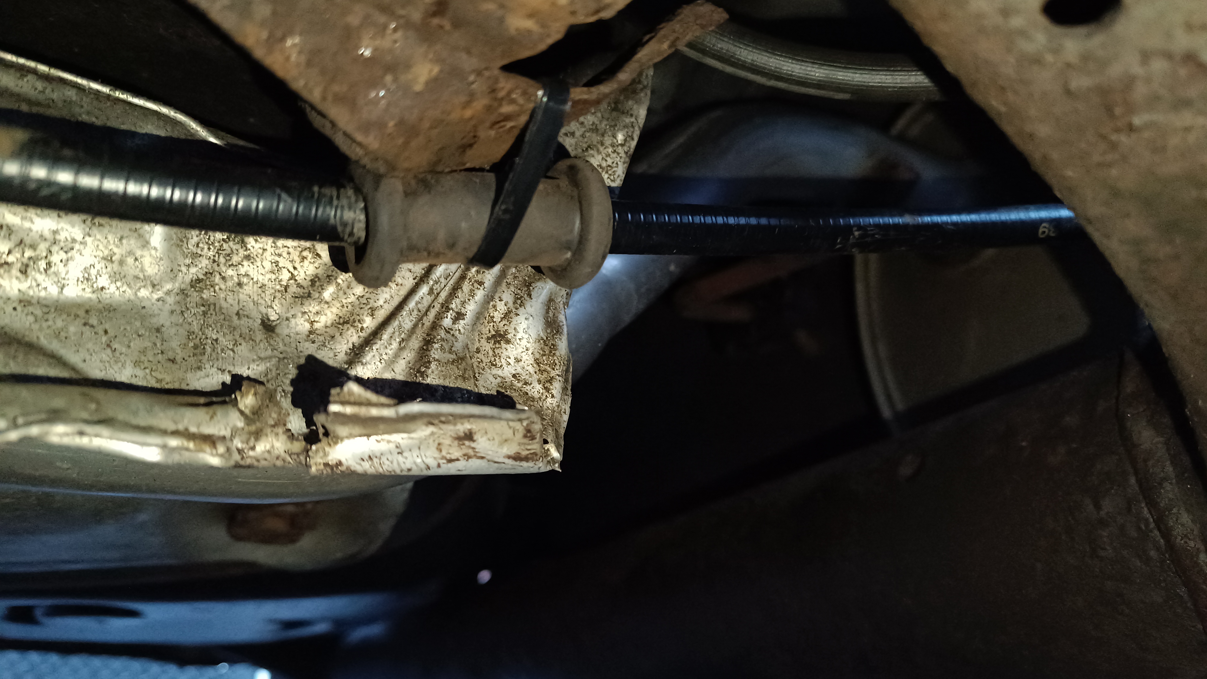

So i tightened everything up underneath and cable tied the broken bracket like this, do you think it is acceptable?

Over time, plastic will yield to repeated mechanical stresses by deforming itself. I wonder if your plastic binder can be considered a "permanent solution", will it actually stay on? Why not use a hose clamp which you could bend a little so it fits

My car has had cable tie retaining hand brake cable for 7years never problem passing inspection in uk. There is very little load on tie and it hasnt deformed at all.

Nope. That's not acceptable. It will spoil the handbrake (cable shield is not secure, mounting point not stiff enough).
In theory it should fail the MOT (due to corrosion and improper - not factory - cable mount, using hose clamps etc.).
Means: rear axle job (mounts/brackets, whatever you call it).
Or you could attempt to repair the cable mounts, welding (risky, fuel tank is close).

I have some hose clamps, and metal cable ties, so i could try those.
I asked whether cable ties would get this passed the MOT tester, and the other posters said "yes". I was aware it might need spot welding, but don't have the welder at this time.

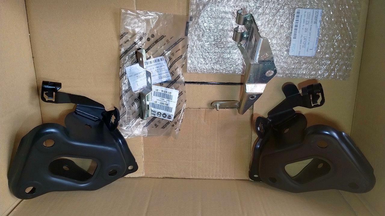

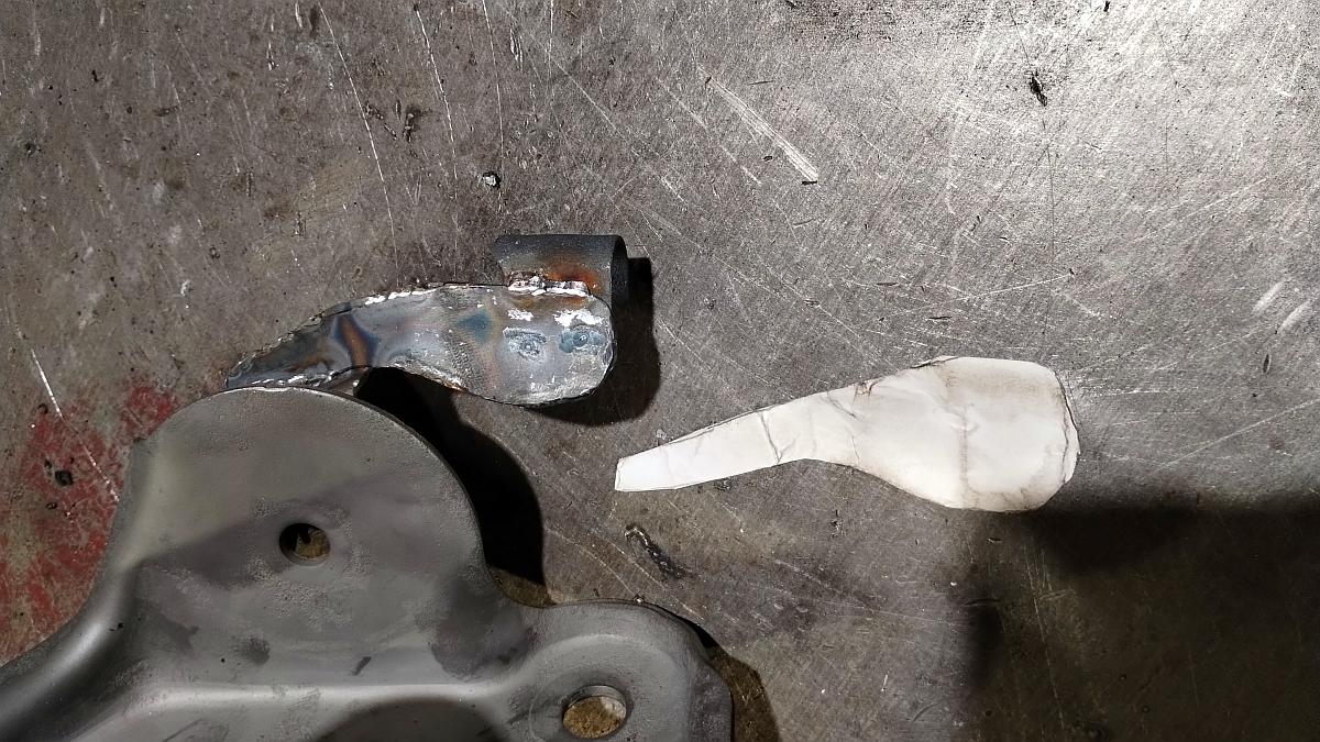

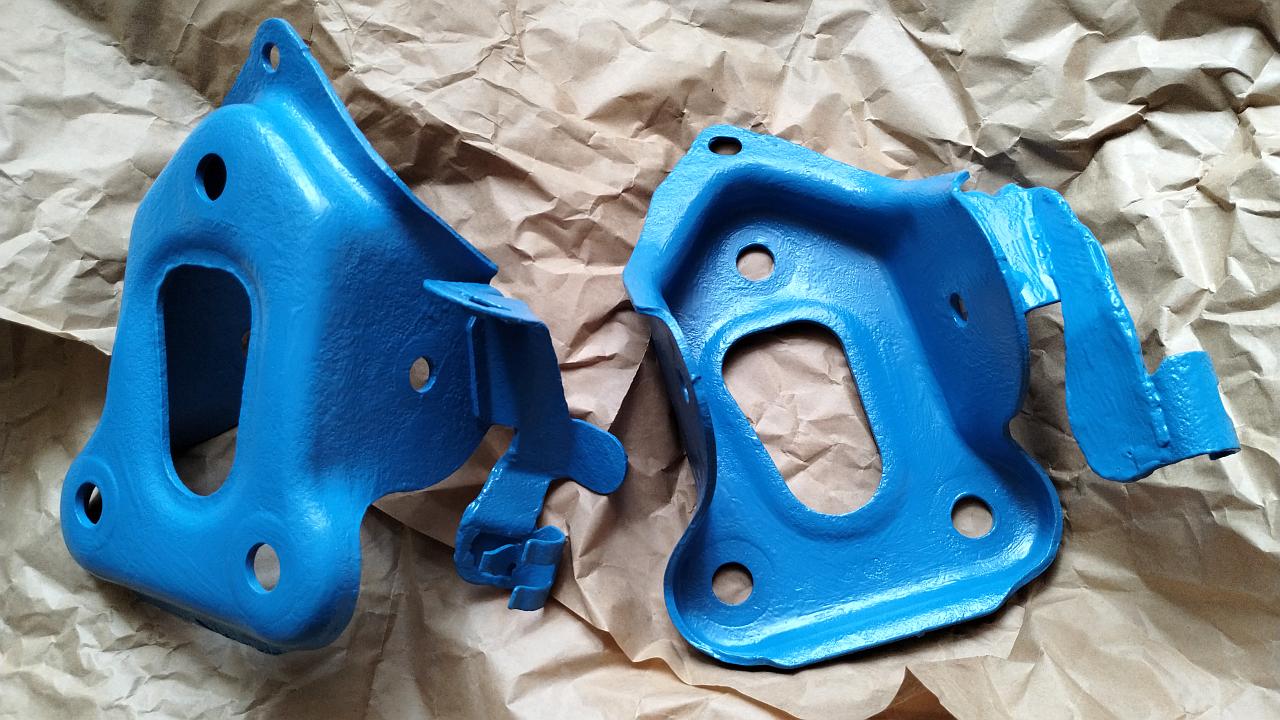

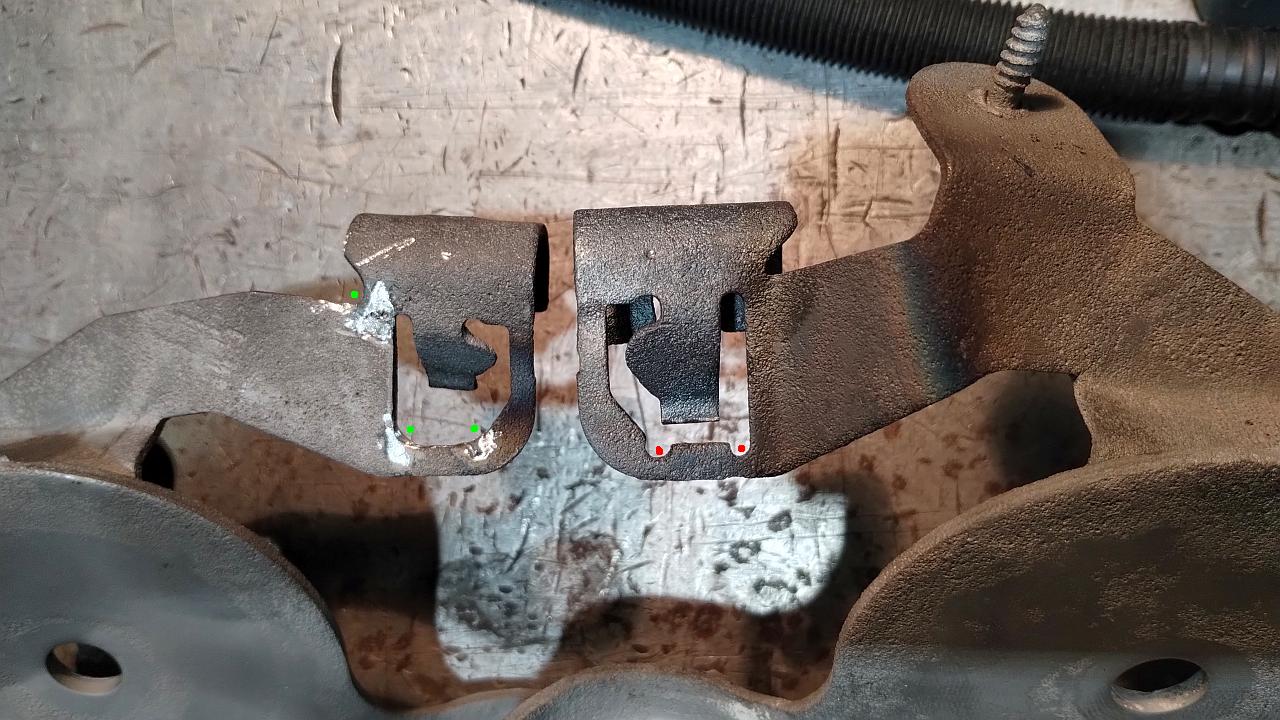

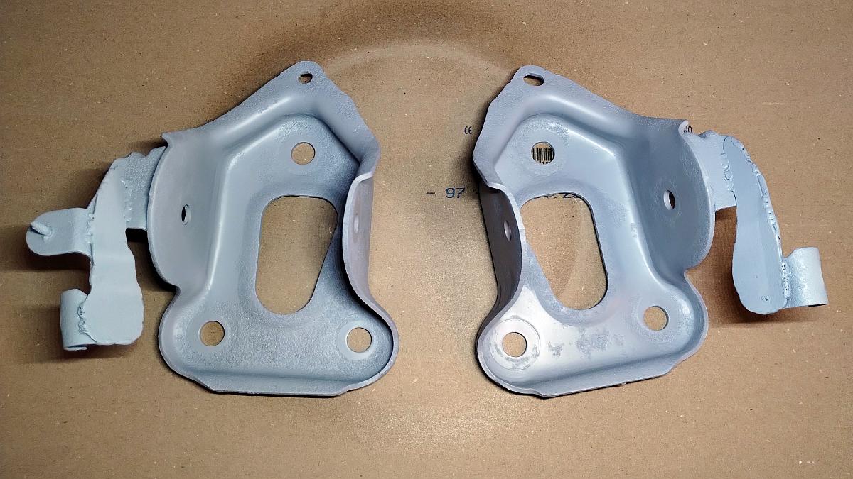

As for rear axle mounts, here is an example DIY repair. Sandblasting is ideal for such rusty parts.
Easiest repair is small welds, spots, just re-attach broken bits.
Or reinforce it, make a patch.
Sandblasting doesn't help when parts are rusty. Welds are porous (no matter what you do, welding metod - this was TIG). Primer coat.
Put some quality, durable paint (coating), 2K (paint + hardener).
This should pass the "MOT" in other countries (with more strict rules). If not, you buy and install brand new ones.
Thaty is very informative and helpful. Its quite possible that i'll fail on that bracket, i just have to hope not!. I saw your graph in an earlier post, i think you asked the question am i the oly one to make such a graph, and probably because its very good. it told me i probably need a new self adjuster. And now i know how to fix the bracket if i have to weld it.

Leave it as it is, if Tester unhappy then ask him to put a clip around it if he wants.
