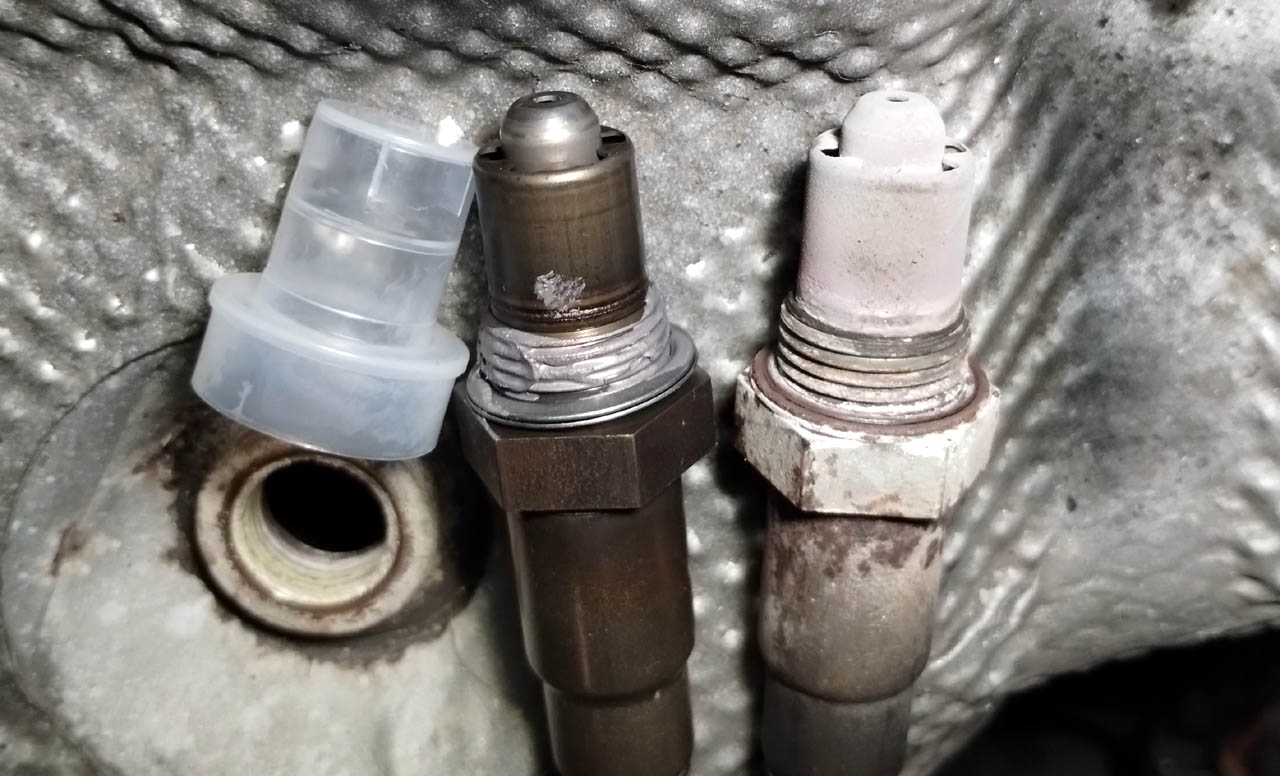

Maybe it wants to, but other systems or parts are spoiling the performance (including bad, old, dirty oxygen sensors - inspect them visually, there are wear charts too, just like for spark plugs). This is an example of working but too slowly sensor. Fouled, "poisoned" a bit. And brand new one.

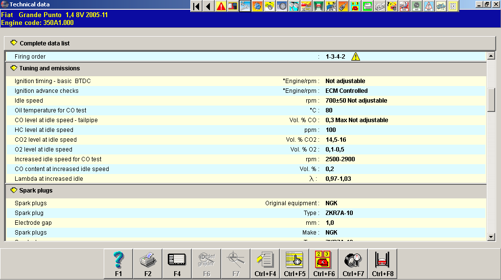

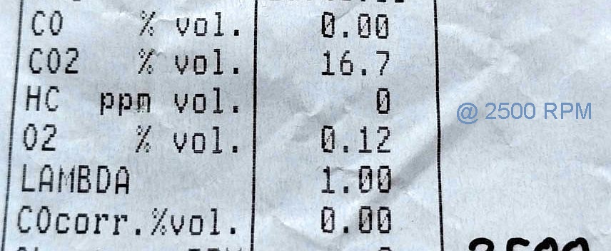

Proper emissions test result should look like this... Chemical reactions are there and not much oxygen left and lambda is perfect.
Healthy engine has zero HC and CO. If not, there IS a problem (even if you pass the MOT). Don't trust such data from service manuals/programs.
