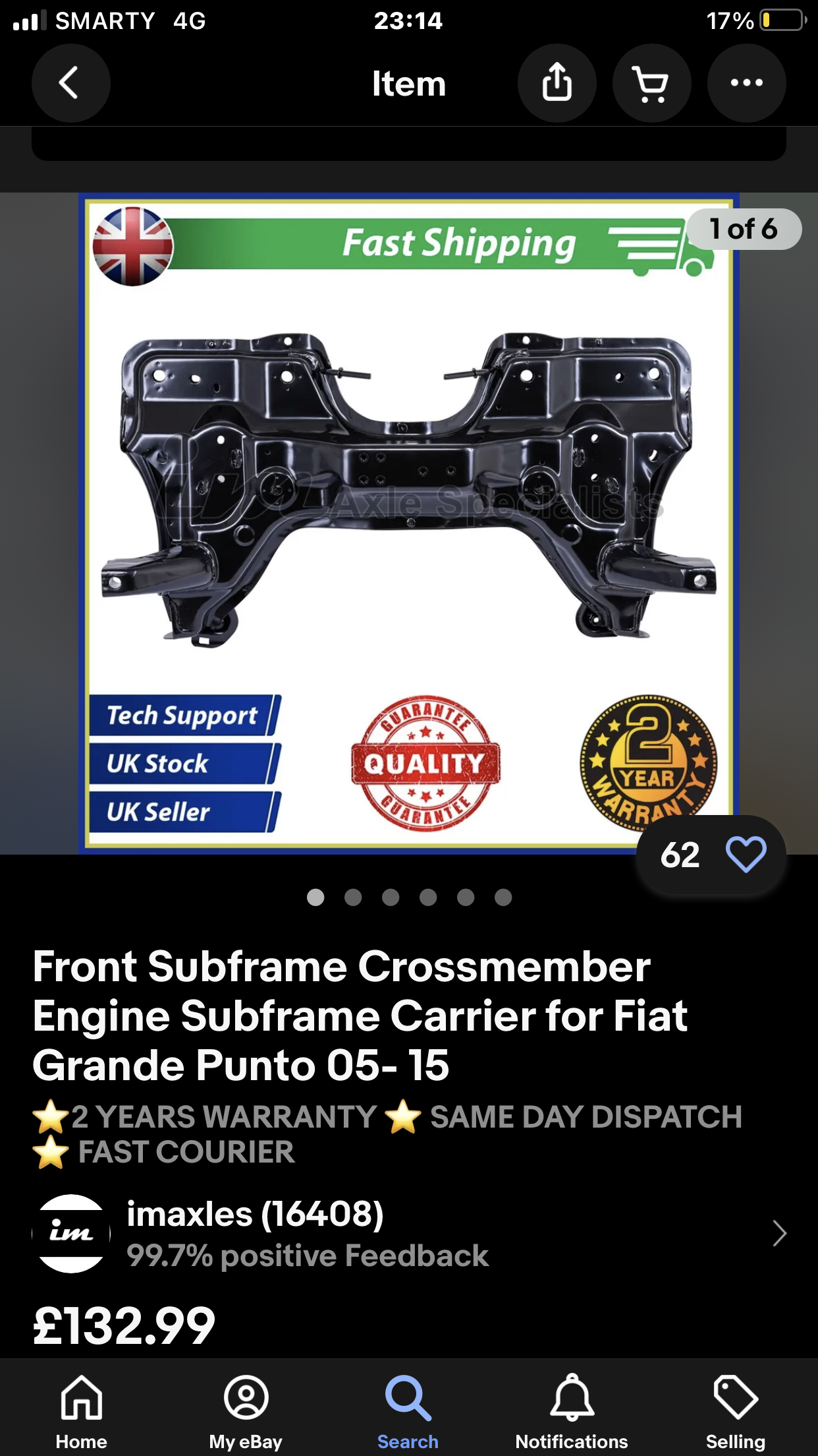

Hi, I have replaced the subframe on my Grande Punto- real ball ache of a job and I was lucky to have help. It took two of us allday and even then I had to go and buy new wishbone bolts after the heads had perished!! Cost me about £140 for frame off eBay- a British company that hold frames and drill holes etc where needed. I can check to see if they are still operating as it was 2 yrs ago….
