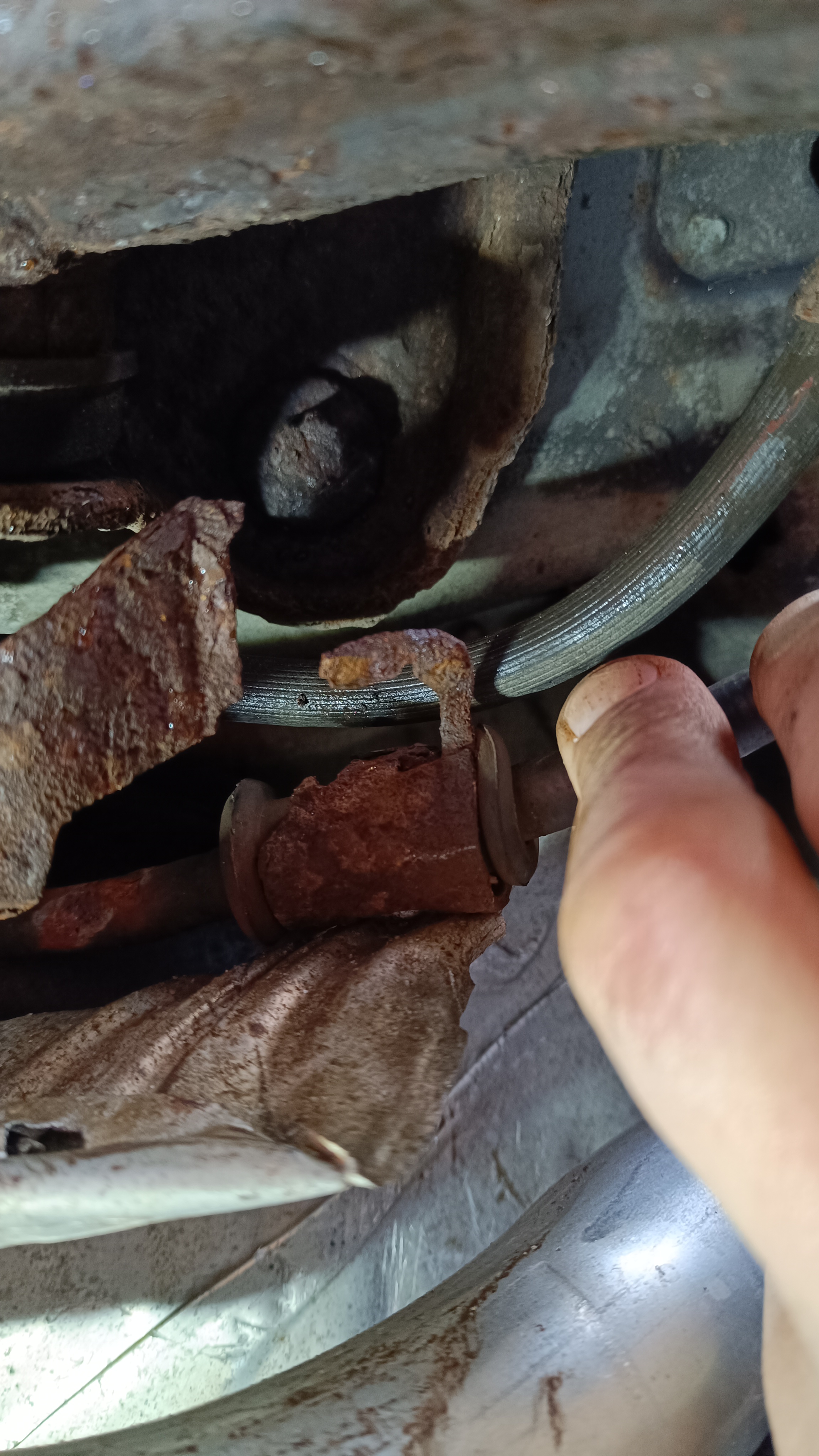

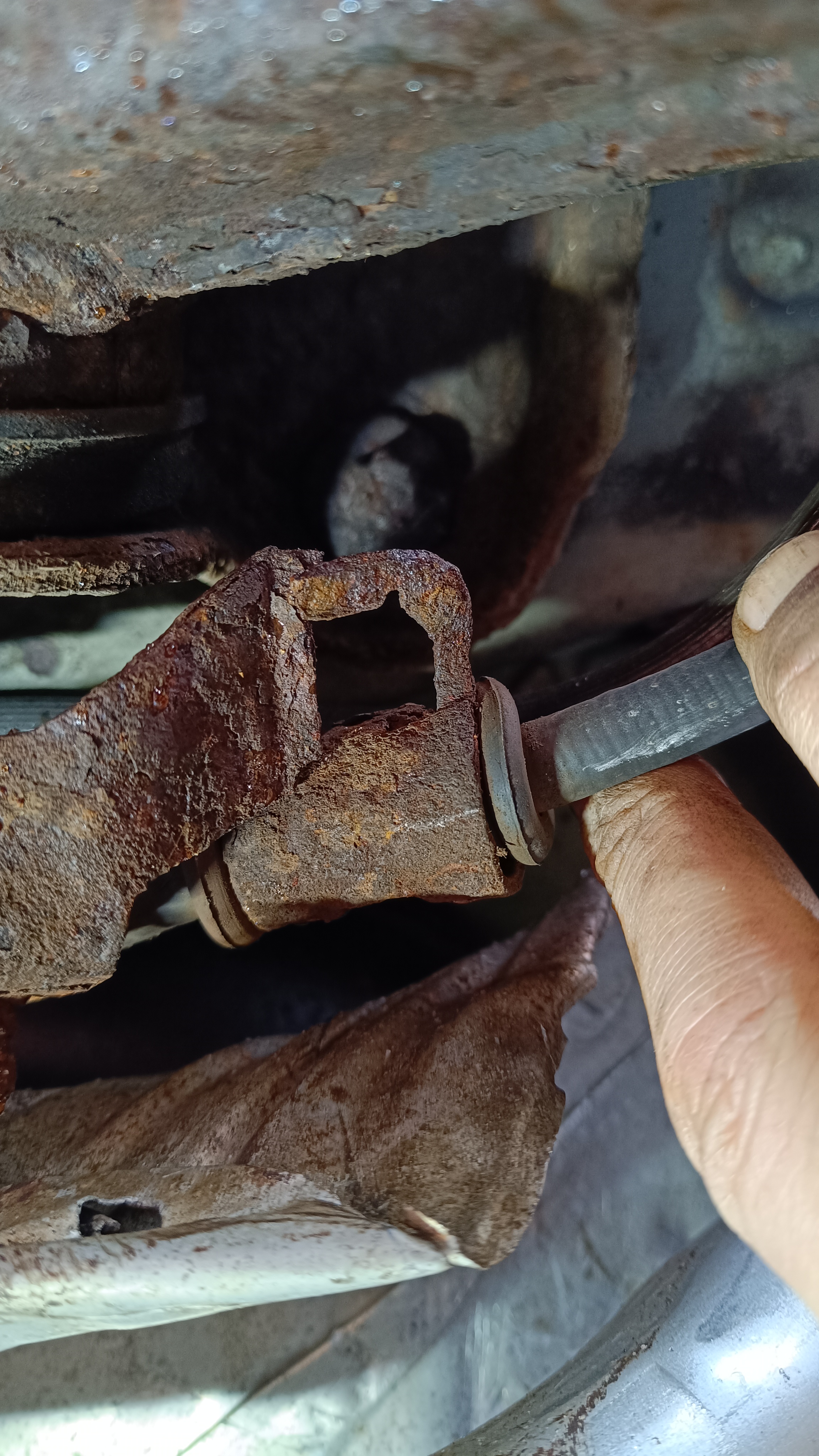

The right handbrake cable hasn't gone on yet, problems, but when i checked it didn't look like it was going to solve the problem, so i went to the left hand side and found this...
This is a fixed bracket on the rear axle that holds the left handbrake cable.
How do i fix this?
Despair 🤕
Take broken bit off cable and use a cable tie to hold it to remaining part of bracket on car
Will that get it through the MOT?
Well i thought that the previous mechanic had put the shorter left handbrake cable on the right...but no...he put the longer right handbrake cable on the left. So now i have to change the left handbrake cable...
Yes that should be fine you may get an advisory note.

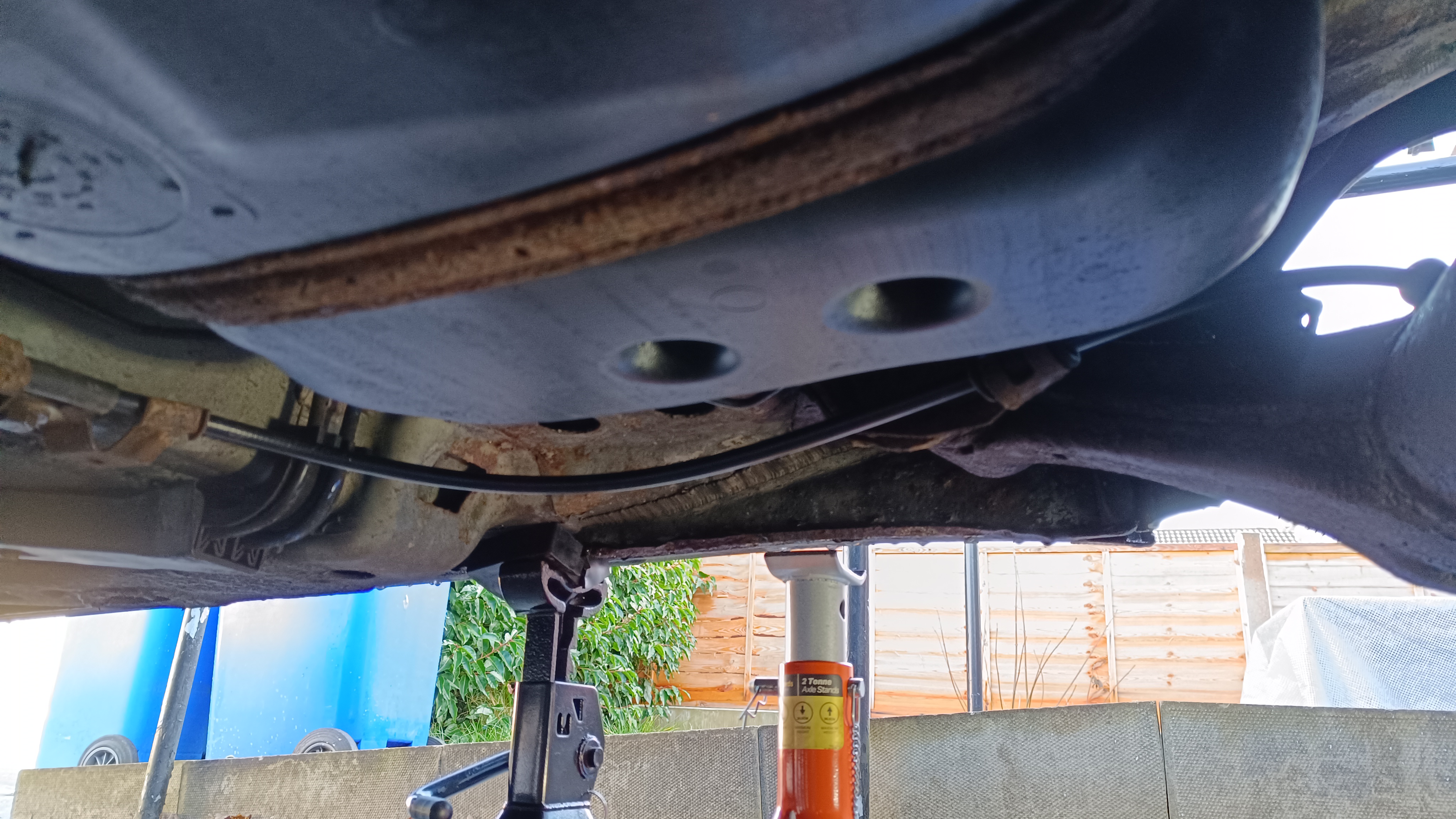

Now i can't seem to get the path of the cable right.
Is this too low for a handbrake cable to sit?

I have left the brake shoes and the rest of the mechanism in place while i changed the handbrake cable. I haven't touched the brake adjusters, I think they will be right, as i haven't done anything with them.
My main concerns are;
1) whether i've routed the cable properly. I'm assuming from BugsyMikes post above that the handbrake cables should be above the line of the petrol tank, is that correct?
2) Can someone confirm Jacks post, that cable tying a broken braket will be sufficient to get it passed the MOT? (See post #180)
As with most MOT points it is largely down to the testers opinion, but in general terms if it is secure, with thick good quality plastic ties I see no problem. So no baler twine or knicker elastic.;)
I'll use a metal cable tie and hope for the best then! :)
I think as long as the cable is secured so it doesn't constitute a snag hazard it'll be fine. I've used cable ties for stuff like this before and it's never been questioned.
