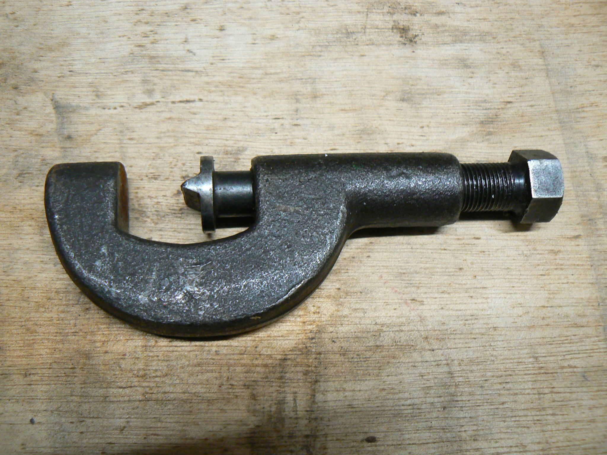

Stop trying to rotate it, you'll probably just snap the stud. Use a nut splitter or air hammer chisel to spread the nut. it'll then loose it's grip on the stud and you'll be able to wind it off with a mole or footprint type wrench. Here's a couple of videos to help:
And, if you have an air hammer, here's the way I favour. Be a bit careful with the vibration if you're near the cat though as you might damage the honeycomb core.
If you're buying a nut splitter there are two main types. One is the type shown in the video but I bought this one:
because it's easier to use in a situation where perhaps part of a casting is blindsiding one side of the nut.
Thanks. I never knew there such tools as nut splitters. I was amazed in the one video to see perfect threads buried deep in what was seemingly a mound of rust.
I especially like using the air hammer because the vibration tends to slacken everything off nicely - I'm a big fan of using Vibroshock techniques on corroded fittings as many will know from some of my previous posts - The first couple of times I tried it on exhaust fixings I was absolutely bricking it that I might damage the cat honeycomb, however I've not seen any evidence of this. I've also had some great success with the nut splitter. The problem with the nut splitter is often access though, particularly on manifold flanges, whereas you can often poke the chisel in through the obstructions because of it's length.
