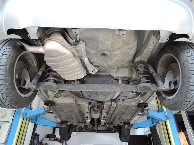

Hi all,
Besides my other thread with the air bag issues, I also need to replace rear springs for upcoming MOT.
Have some jack stands, and intending to pick up a trolley jack to make this less painful in general (and because I think I'll be lifting again to replace shocks once I've had a good look at them!)
Never needed to lift more than one corner of a car so uncharted territory for me.
I've made up some slotted wood blocks so I can hopefully get the stands on the sill jack points, allowing the wheels to drop and release the springs.
But where is a safe spot for the trolley jack initially?
Saw in a Punto thread "anywhere the subframe mounts to the body" which doesn't mean a huge amount to me. I found an image of the Idea lifted and it looks like they're just on the sills... can I lift from any point on the sill (with a slotted block), lift each side of the car and shove a stand in?
Advice for a newbie please 😅
