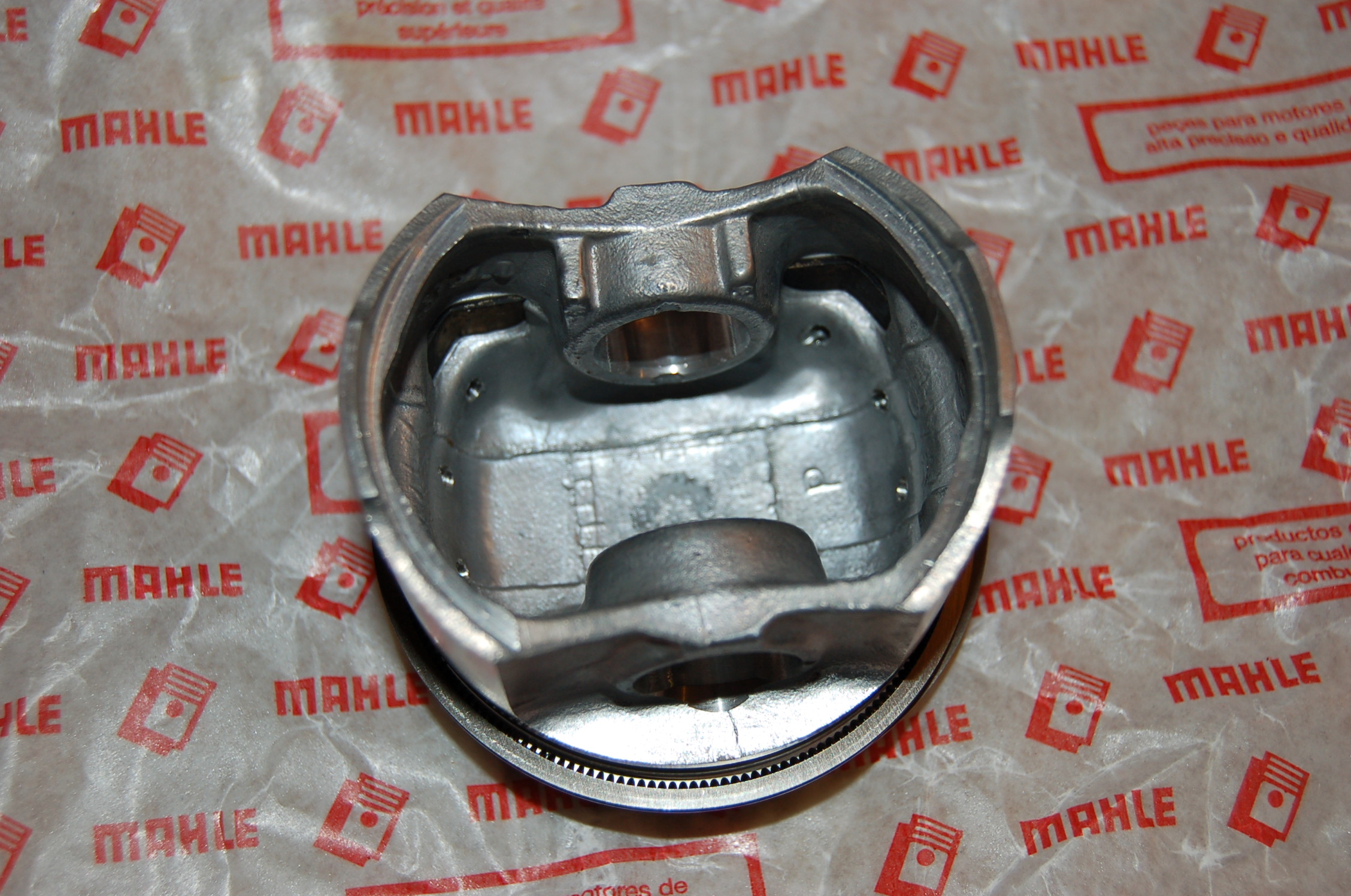

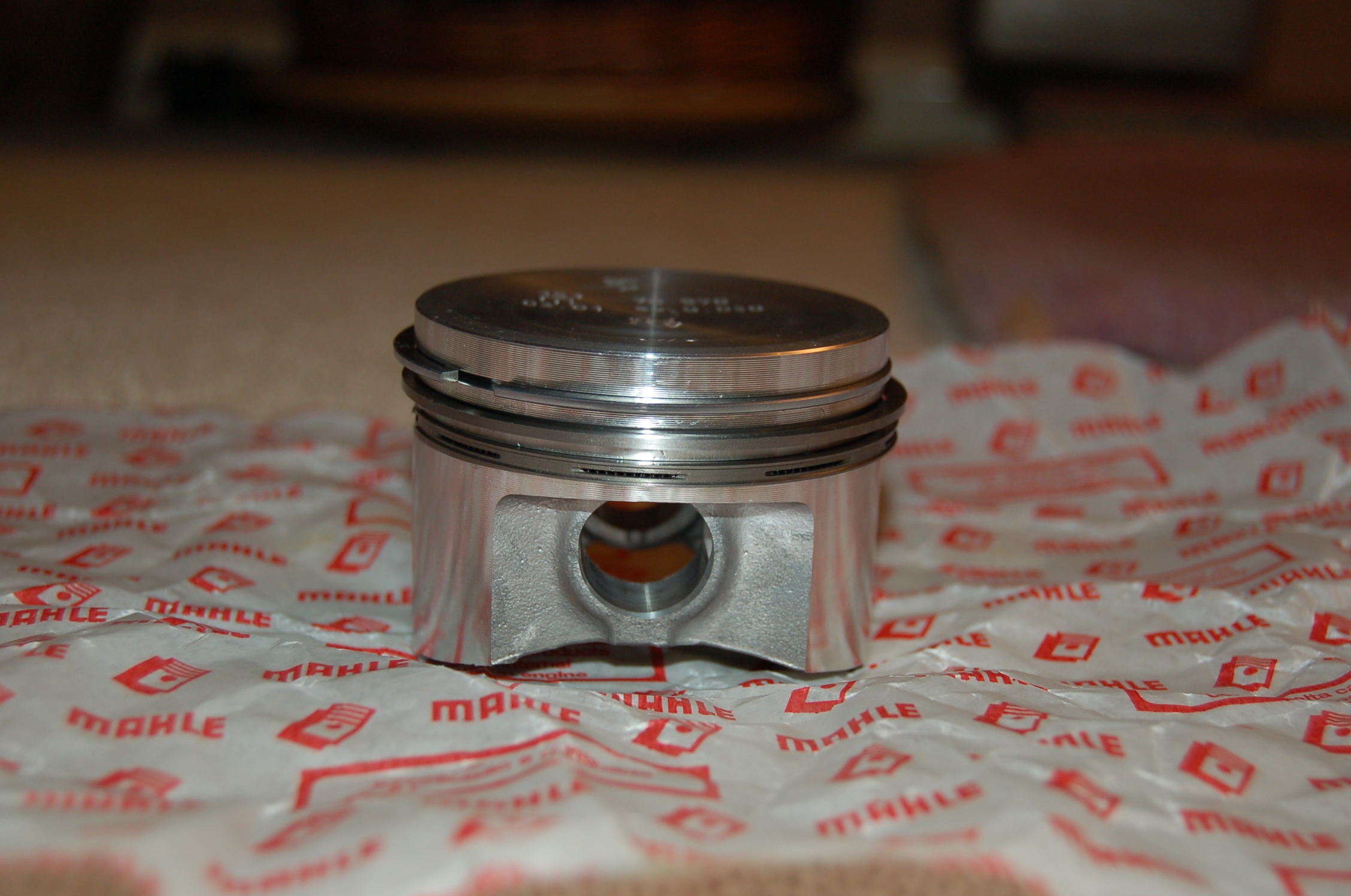

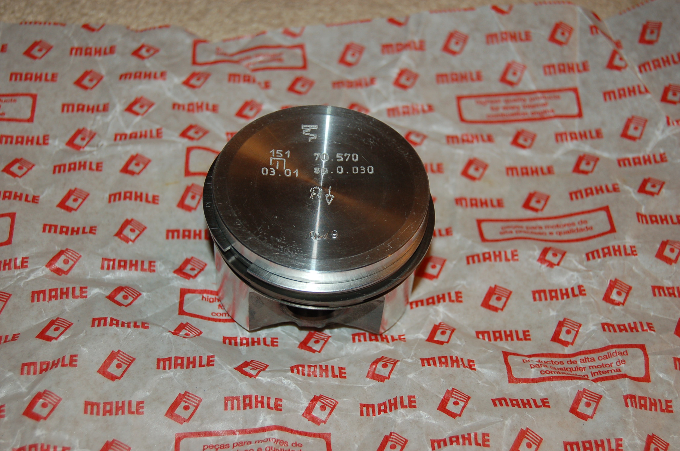

Emma has forgotten to add its getting new pistons from Mahle and will hopefully be machined to include a dish which the normal VAD hi-boosts didn't have as what they did was machine the dish off so the piston is flat to lower compression. There is a piston cut in half by her Dad which shows the crown thickness of the piston, its pretty thick, about 6mm or so which I'm sure she could post up.

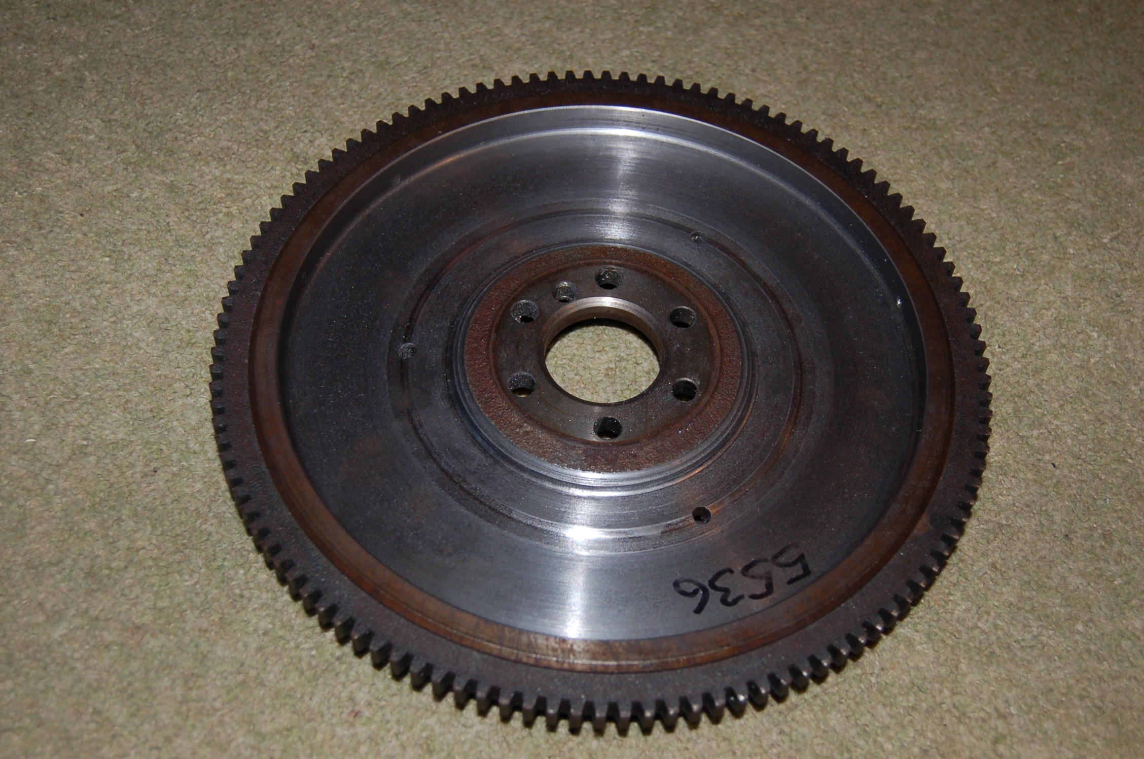

The fly wheel is being lightened and balanced, (as piced above) but on the 2 1108cc engines that we looked at there is a considerable difference in the flywheels, with one looking like it has a lot more meat on it than the other :confused: all the rods have been weighed and are negligible in difference, really not enough to merit full balancing as the are very close, within a gram of each other or less.

they are not custom, Mahle list pistons for the 1108cc engine in various sizes, they were a great price, but you need to know people in the correct places to get them at the price Emma paid, and then have a Dad who can get them machined to his own specification.
And just to add the Mahle piston looks to be a better made piston than the Fiat one with it being lighter, stronger and thicker in construction and therefore have more meat left on it after machining.

Also a lightened flywheel, about 1.5 kilos taken off.
This flywheel worries me a bit especially in a turbo. At the centre nothing should be taken off.
Two years with similarly machined flywheels in the 750 class on 2 FIRE engines the flywheels went. One guy was fortunate the other lost the entire gearbox when it shattered. And these weren't turbo charged engines with much less torque. The flywheels were done by engine builders. I wasn't Guy Croft and neither me as it was claimed then.
is it going to crack all like this, then fall to bits?

oh yes i forgot the other picture of the flywheel, some has been taken from the outside too, to be fair i dont know how much was taken off where, but i can find out, i'm sure the machinist that did it for us did a safe job.
I can see where Oldschool is coming from here - I've no idea about machining flywheels but I can see the benefits of having a slightly larger mass at the centre :chin:
