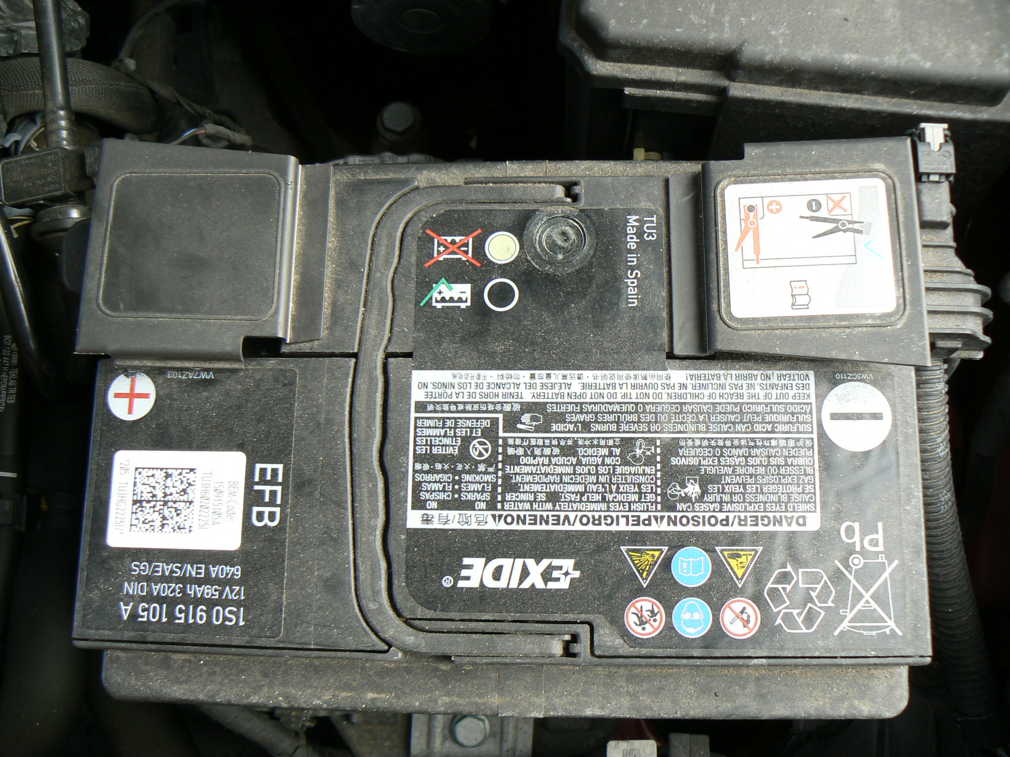

First thing to know is YOU CAN DESTROY IT IF YOU JUMP START IN THE "NORMAL" WAY. ie by connecting your jump leads directly to the vehicle battery terminals. I've long connected pos to pos then pos on donor battery/vehicle to block on "flat" vehicle to avoid any possibility of a spark igniting battery gasses These sensors monitor both voltage and CURRENT via a shunt. If you connect the leads directly to the battery the sensor is now not "seeing" the connected battery in the same way. I don't understand it all but I suspect you might get a reverse flow through the sensor? Result seems to be - POP! expensive sensor then needed! I've now seen several pieces of advice that if you must jump start then go pos on doner to pos on the "flat" vehicle then take your black lead connections to engine block on both vehicles. That way the sensors will be in circuit on both vehicles. If jumping with a jump pack or slave battery (as I do) then go pos to pos and neg to the flat car's engine block.

1) when jump starting go pos to pos - as has always been done - but then black lead goes engine block to engine block. I have read that there might, very occasionally, be a sensor on the pos battery terminal, who knows what you do then?
2) when charging connect charger pos to battery terminal and charger neg to body earth. (almost certainly advisable to use a "smart" charger (I have a Ctek)

Had a reply back from SEAT. It's from the person who said they would forward my query to their tech department. She tells me she's spoken to an internal Master Technician who advises, as long as it's a trickle charger (which is, I suppose, what the CTEK is?) just connecting directly to the battery terminals on both positive and negative. It's disappointing that I didn't end up with a direct technical contact - I'd be happier hearing it from the "horses mouth" but I suppose I should accept the advice.

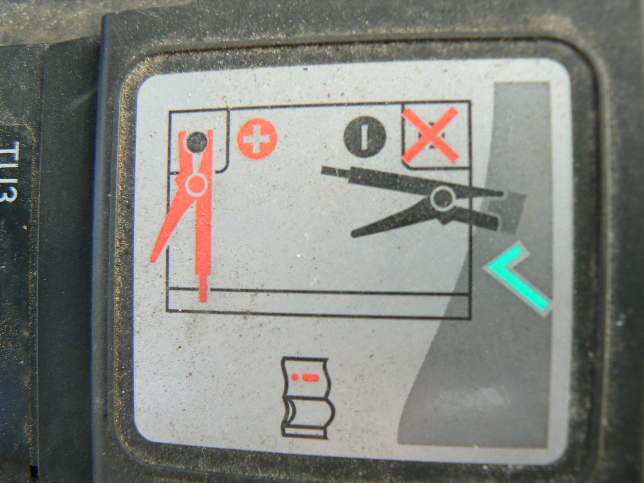

I'm still rather nervous about the instruction on the terminal protector/shield not to connect to the negative terminal:
Which seems to be pretty convincingly saying to connect to the domed nut earth point on the inner wing? But what do I know? I've replied requesting clarification on this. Wonder if they'll get back to me?
