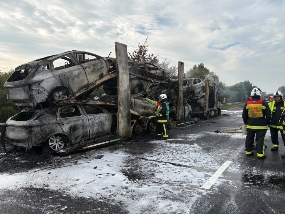

A few weeks ago in England near Exeter a car transporter truck carrying electric cars caught fire on the M5 . I think the fire originated in one of the cars. Many fire stations were invovled and the M5 was closed in both directions.
One side of mway shut 4hours other side shut 12 hours.

Er not quite
The fire started in the trailer, AIUI the axle overheated, a hydraulic line split and fed the fire.
Nothing to do with the EV apart from the fact they burnt just like an ICE car would.

Not all EVs are using LifePo4. I thing the LifePo still burn, they are just less likely to self-combust. But like all EVs, once burning, are hotter than an ICE car, and more difficult to extinguish.
Whilst the transporter may have started it own fire, once it spread to the EVs, it made the situation much worse, and significantly longer to resume normal road operations.

Again not quite
If you look at the pictures from after the fire the cars still look like cars, if the batteries had combusted then there would have been just a mess of metal due to the heat

Their batteries all combusted. Only the shells are left. Also there was a news article 5 days afterwards which states thermal runaway in one of the vehicles as the cause.

My main point with the fire on m5 is time taken to deal with the fire involving electric vehicles. Major motorway closed for 12 hours , many firefiighters and their equipment tied up with incident. The fire point of origin or battery chemistry is interesting but secondary.
