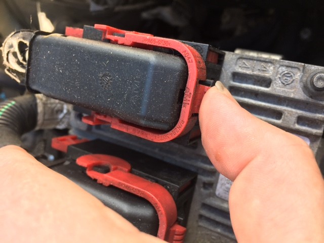

I just want to remove the 2 wiring plugs going into the 2 side by side ECUs in my Euro5 69bhp engine (2011). So that I can check they have a good connection. I have a detox spray waiting! But it looks like I have to lift up a red plastic locking tab, but these are very hard to move and I don't want to break them!
The reason I want to do this is because, despite new plugs, leads and coil, and no codes on the canbus reader, engine is jerky on low throttle settings. All happened in last 2 weeks. Fine before that and old plugs all nice and biscuit coloured. Anyone else struggled to remove these plugs?

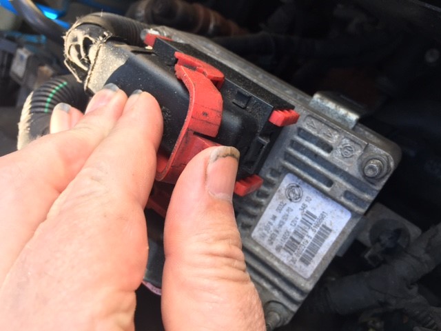

this will not be you problem
you really need to have done them before and know how much force to use
if you just lift them and they are corroded together then you will just snap pins off and leads to a world of pain and expense
if they are stuck you have to open them a bit and push them back down
anyhow heres how you do it
push the middle bit inwards
and lift upwards
and lift upwards
They lifted up easily once I had figured out the release catch. All shiny pins and no dirt. Probably not the problem!
