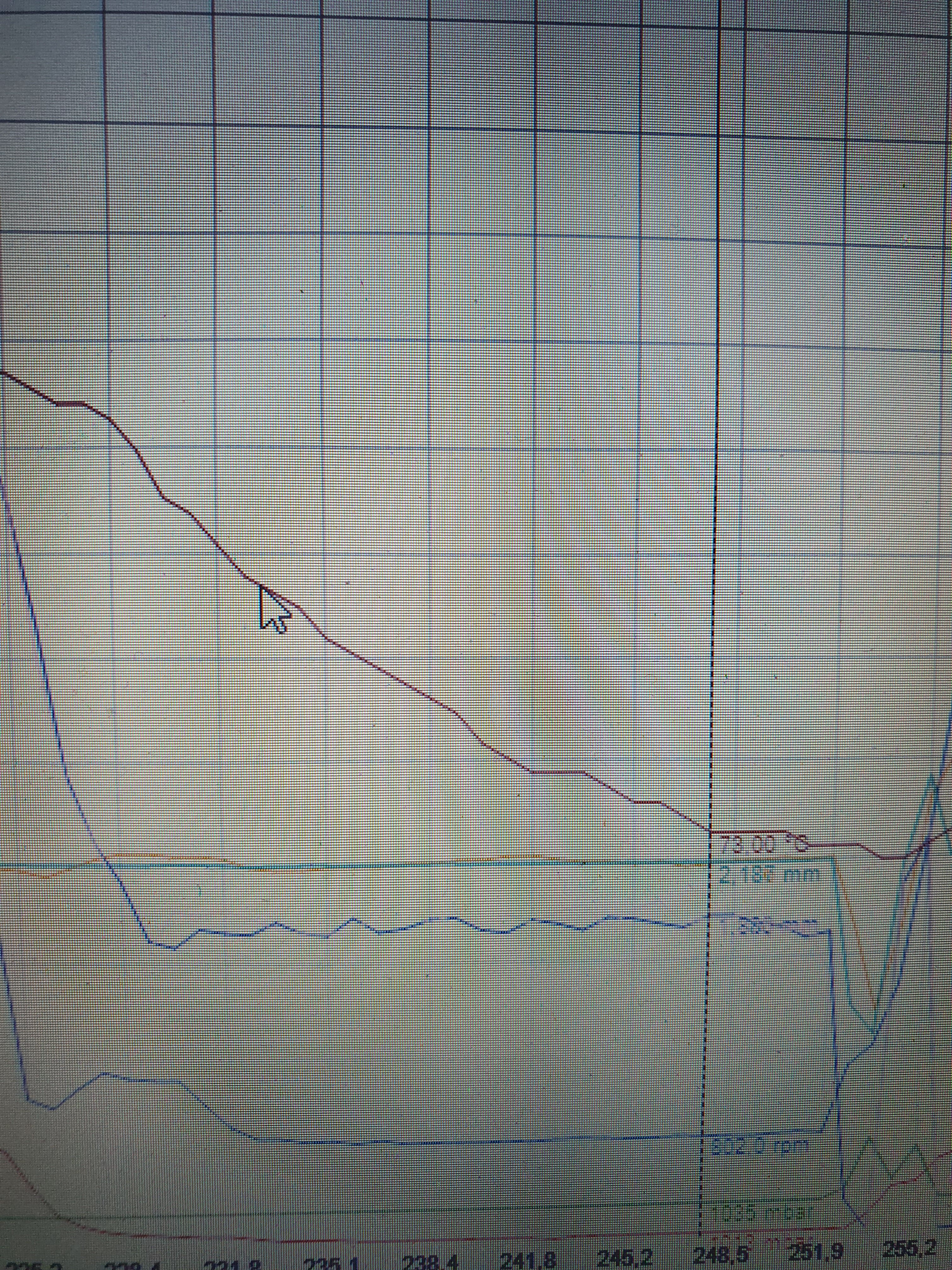

For anyone new to Multiecuscan i wrote this simple step by step to measure specific parameters and save the data for additional analysis.

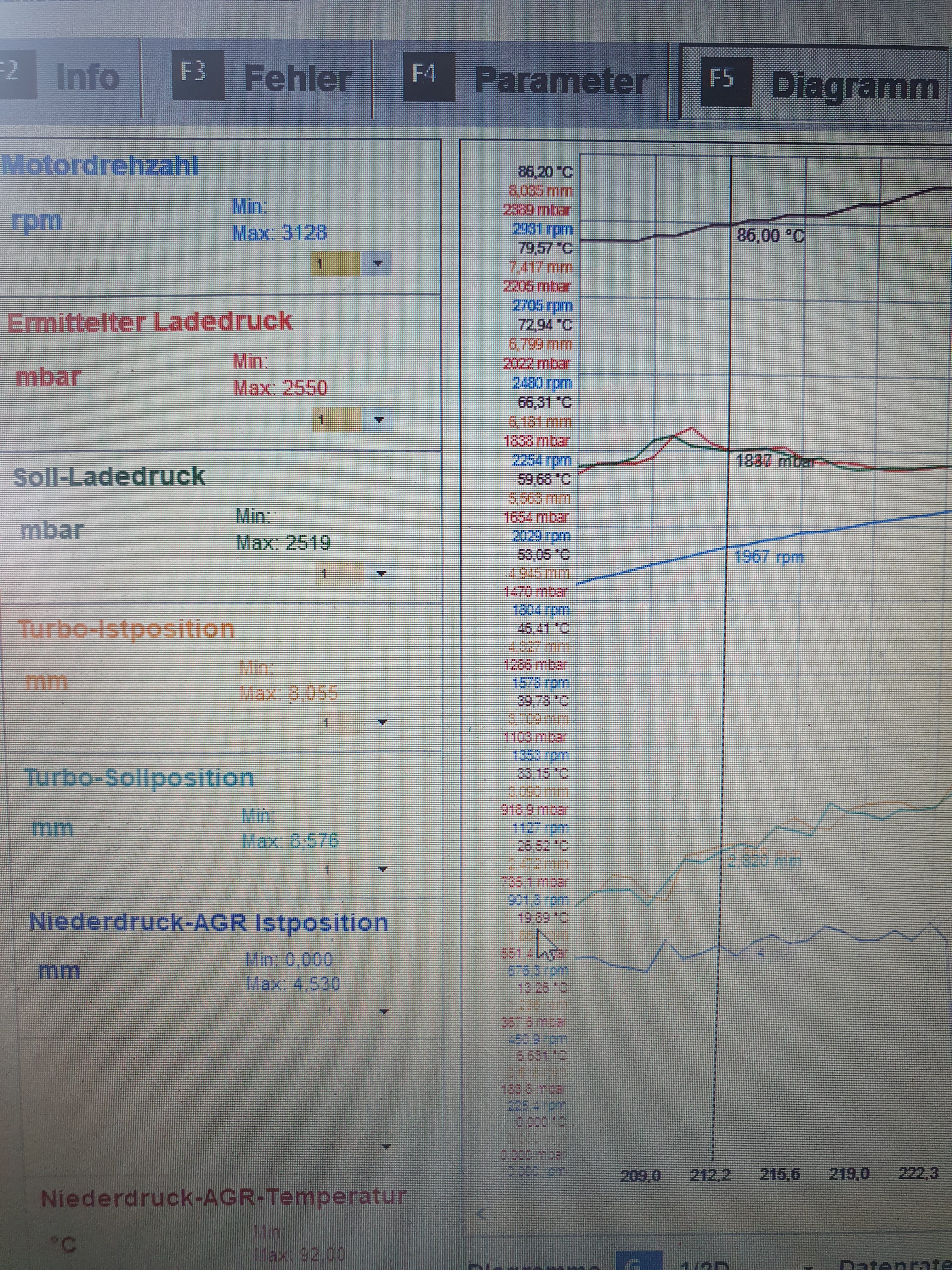

I've got the opportunity to check a known working vehicle today.
Attached the MES screenshots.
611.000 km on the clock but with new (used replacement) engine.
Software Version 0032.
And what should I say.
Problem seems to be indeed the LP EGR Cooler.
I've noticed that LPEGR Temperature in idling is 50-60 C.
And under partial load and open LPEGR Valve it goes up to 105 C.
Besides the air and boost pressure problem, my LPEGR temperature doesn't reach more than 65C in any case.
So conclusion is - - > LPEGR cooler indeed is blocked.
I guess ECU in my van is noticing that as well and is trying to open the LPEGR full to get more air inside.
That's why the desired opening of LPEGR in my van is higher than the one in the working vans.
So unfortunately that has nothing to do with the software version.

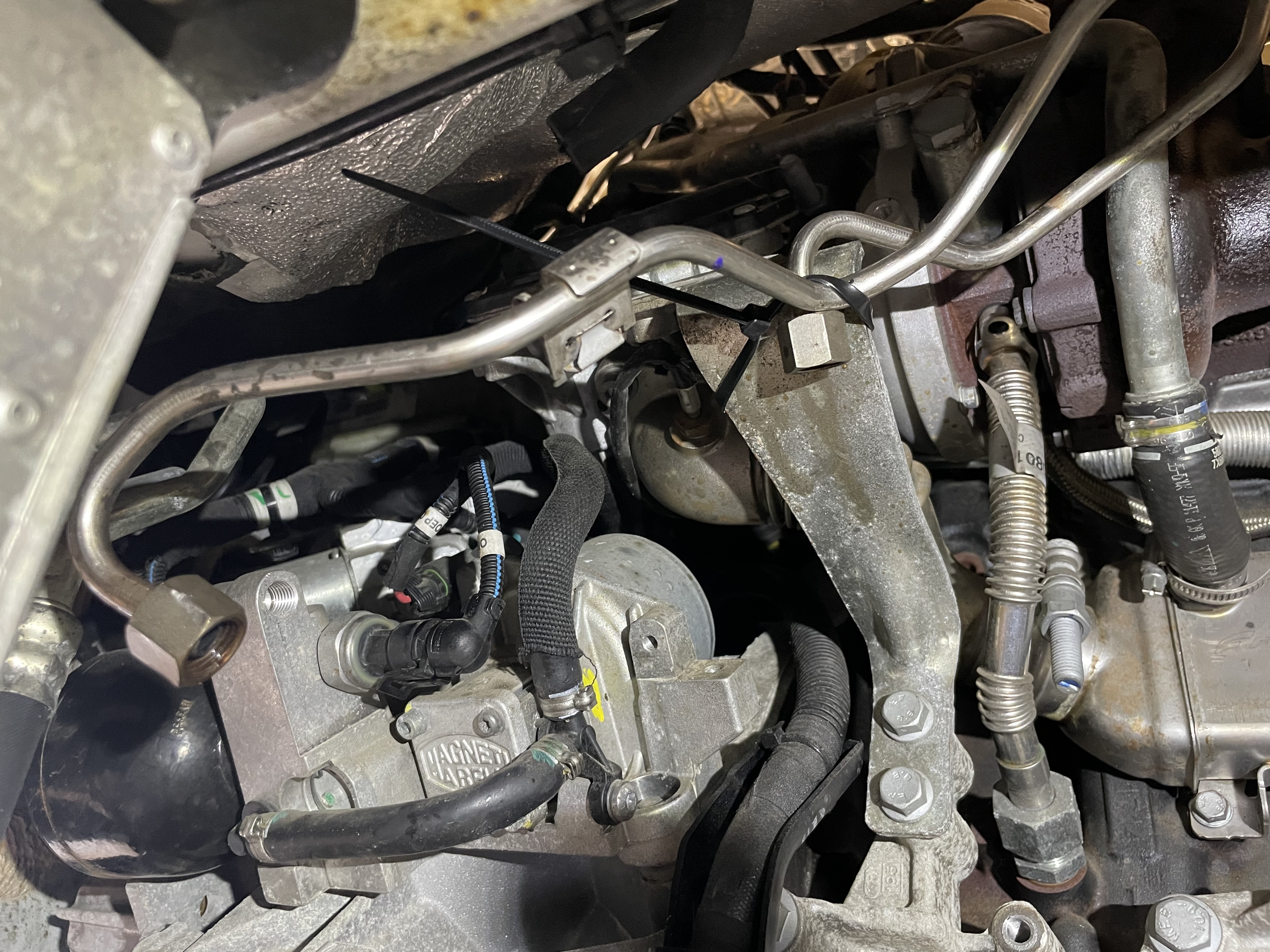

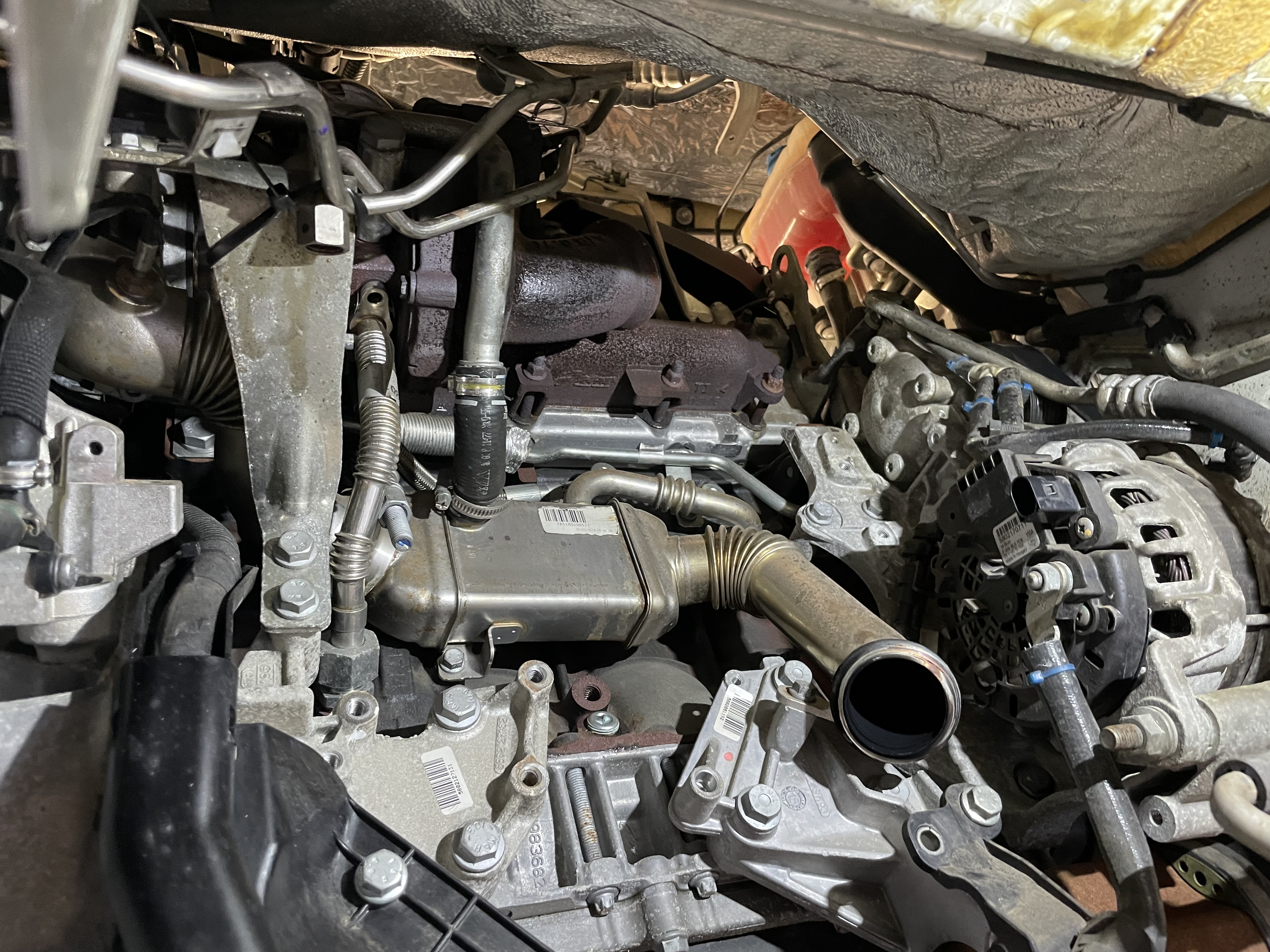

The LP EGR is a composite unit. There is a butterfly throttle. I think that It operates in sequence with it's EGR valve to close off the air from the normal air filter to make the turbo suck exhaust, probably blends it. If this throttle closes AND the cooler is blocked there is no way that the turbo has a chance to make the inlet manifold pressure because it's strangled.
Question is, am I right in my theory?

I agree with Fredastair theory. LPEGR is an exhaust/fresh air mixer……
Theory sounds possible.
There is one point that needs to be considered.
What I've red about LPEGR in other cars, like VW, is that the airflow from LPEGR also gives a force onto the tubrine and generates that way more boost pressure e.g. quicker response of turbocharger in partial load situation.
If this would be also the case in FIAT than just giving fresh air maybe doesn't solve the problem.
It will maybe throw up other codes.
There are a lot of sensors and the whole EGR process is watched by the ECU.
If the ECU thinks there is some problem, it will throw codes and go into limp mode.
My opinion is cleaning out LPEGR and LPEGR cooler could solve the problem.
But it's a matter of time problem comes back.
Because LPEGR cooler gets blocked again.
Maybe gets blocked faster because of other issues (DPF, Injectors, etc...)
Or a ECU programmer shuts of the EGR and related codes in the software.
That would be a long term solution.

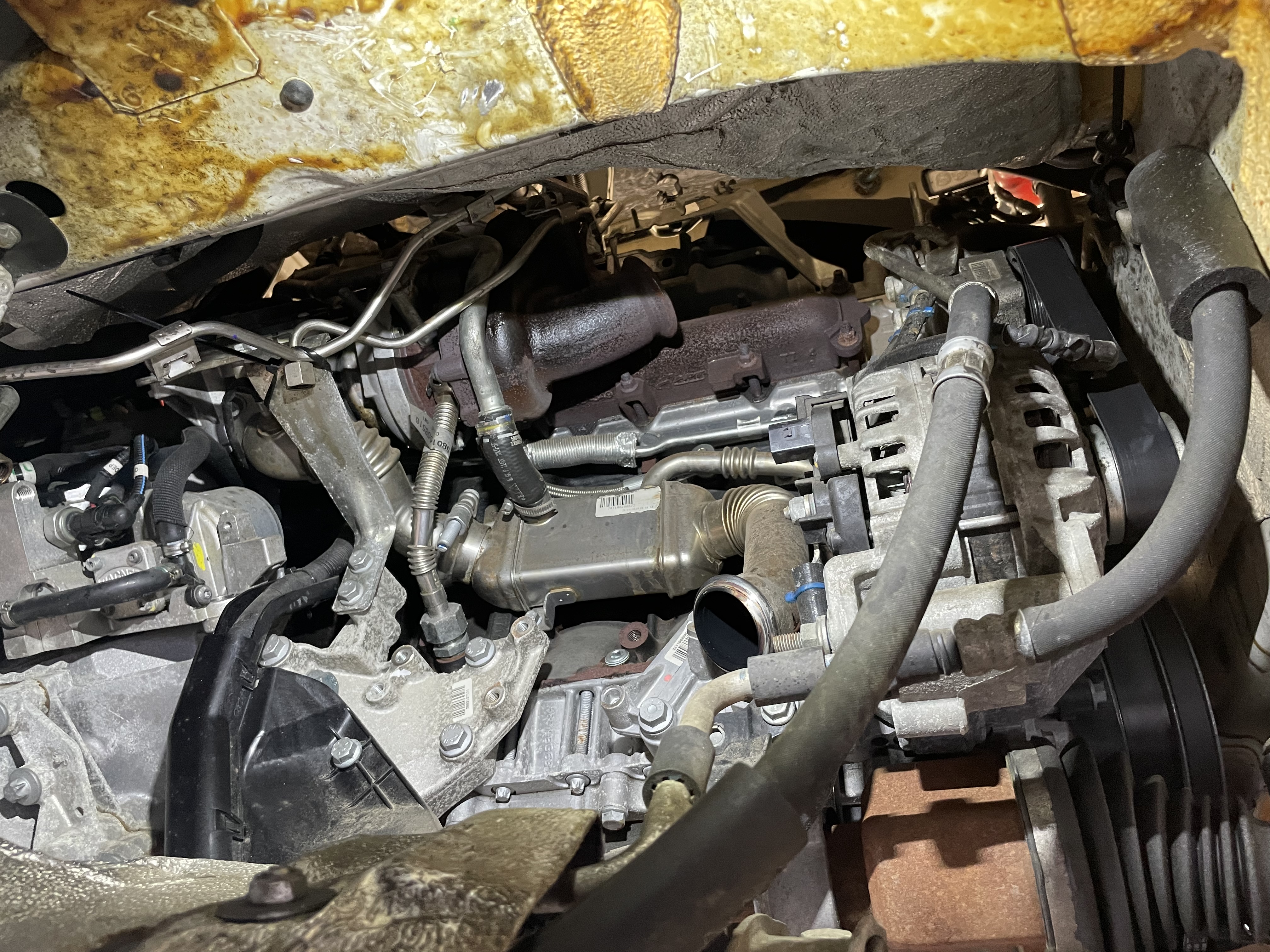

I'm still wondering if it possible to undo / remove the flexi pipe to the cooler and do keyhole surgery up the cooler pipe to the tea strainer gauze and vacuum suck out carbon/ liquid clean the gauze without major disassembly.
I need to go under my van for a detail look as my comments above are pure thought at this moment.
I do not see the way how to do it without disassembly……

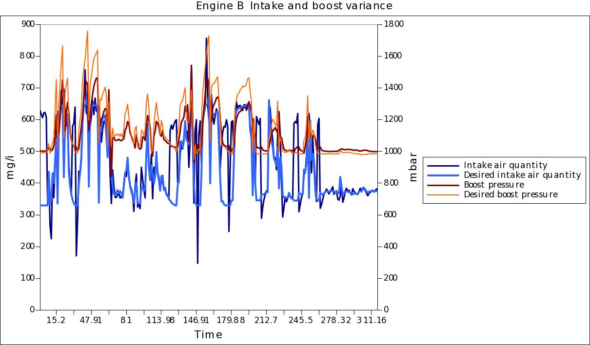

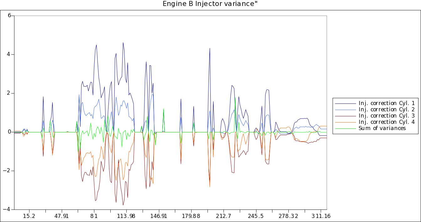

The injectors look way out. If memory is correct the maximum individual injector balance should be +-2
The lpegr looks to be working, from my van this EGR opens when you put foot on pedal and closes with foot off. The graph clearly shows it closing with foot off and the EGR temp then falls because the infeed exhaust has been stopped. Then temp climbs again when EGR opens again.

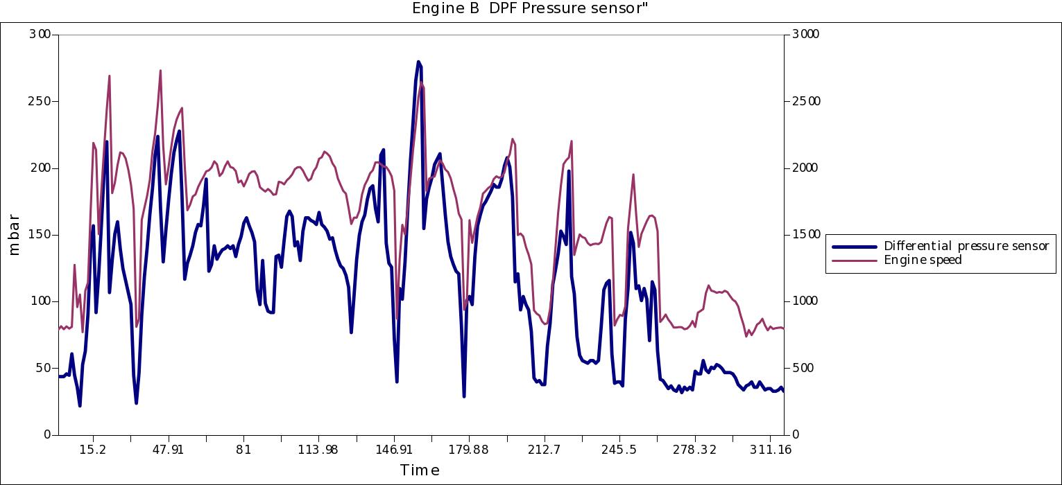

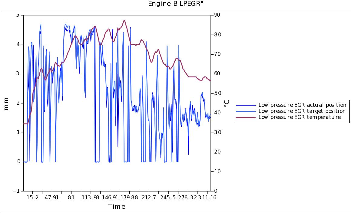

We did a run yesterday with MES connected and the Wife watching figures.
Ive now worked out how the LP EGR and it's integral throttle work.
The engine is designed to intake exhaust gas post DPF all of the time your foot is on the accelerator pedal.
Foot off the LP EGR is closed and its butterfly throttle is at 0%.
Foot on pedal, the LP EGR opens in varying mm (4.76 max), plus the butterfly operates showing a higher percentage (9-11% often).
The butterfly will partially close to limit the clean air thus it's a mix of clean / dirty air that enters the turbo.
As the LP EGR begins to operate you can see the LP temperature rise from 60° to a varying 70-80° with highest I saw of 92°.
Climbing uphill the EGR is open max mm and the temperature say 70-80° which must mean my cooler is passing exhaust through it's tea strainer gauze. The harder you put your foot down, the higher the temperature,(92° seen once).
Downhill; foot off; the LP EGR closes and the EGR temp drops back to 60°
What I don't know is whether my cooler is clear or part blocked.
I could do with one of you repeating my running tests and finding out if you see similar temperature effects compared to foot on pedal
I would like to have an idea if my cooler is part blocked or clear.
Additional note - my van did a self regen 17 miles before getting home. At home the DPF was reading 17% blocked. I guess that's pretty clean, (?).
