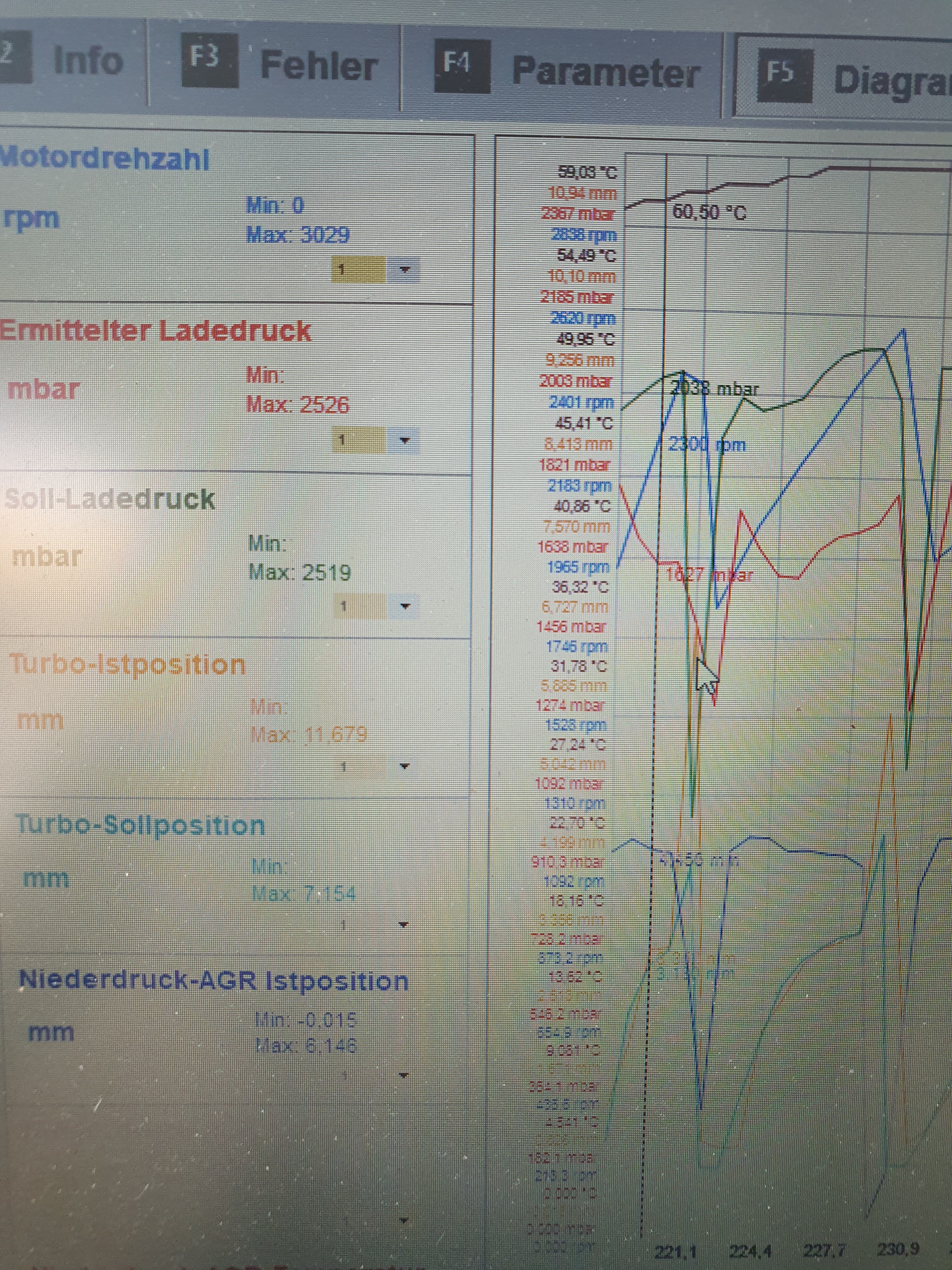

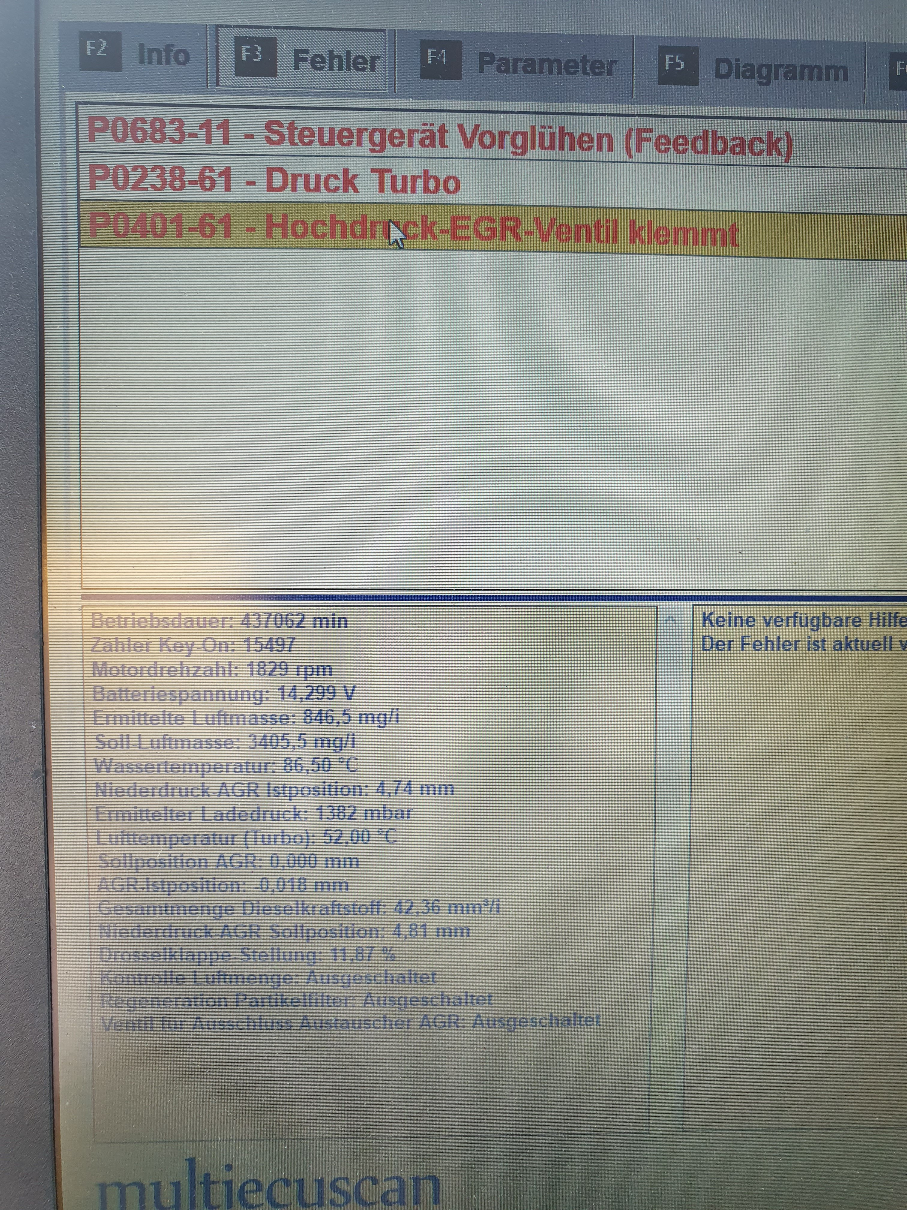

Also I've done some further testing today.
MES results attached.
I've cut a brake cleaner bottle in half and drilled a hole inside to block the exhaust pipe partly with it.
Goal was to see if there is back pressure on the LPEGR cooler and LPEGR, if the turbo charger than is responding properly.
Result was no change in turbo pressure reading at zero speed and rev up to 2000.
And differental pressure just moved from 2 mbar to 6 mbar. Not much for a blocked exhaust.
I couldn't see or hear any leak on exhaust system from anywhere else.
Exhaust pipe was producing a lot of pressure at exhaust.
That's why I couldn't do a test drive with the blocked exhaust pipe.
Even fixed with cable tie, cut bottle would come off immediately under boost pressure.
I've then done a test drive today without the blocked exhaust.
What I've noticed is that turbocharger isn't producing enough boost pressure under partial load.
Couldn't find the problem yet.
Maybe the new (remanufactured original) turbo charger has bad settings?
And that's why in second stage the EGR doesn't get enough exhaust flow and the EGR code pops up?
I've noticed that under partial load, when the LPEGR is open, the actual boost pressure is up to 500 mbar lower than the desired boost pressure.
Under full load there is no gap between desired and actual boost pressure.
I've noticed that while the LPEGR is open the LPEGR temperature rises and when its closesd the temperature comes back.
I think LPEGR and cooler aren't blocked and are working properly.
Has someone LPEGR tempartue reading from known working ducato?
Attached screenshots from todays test ride.
Any Ideas?

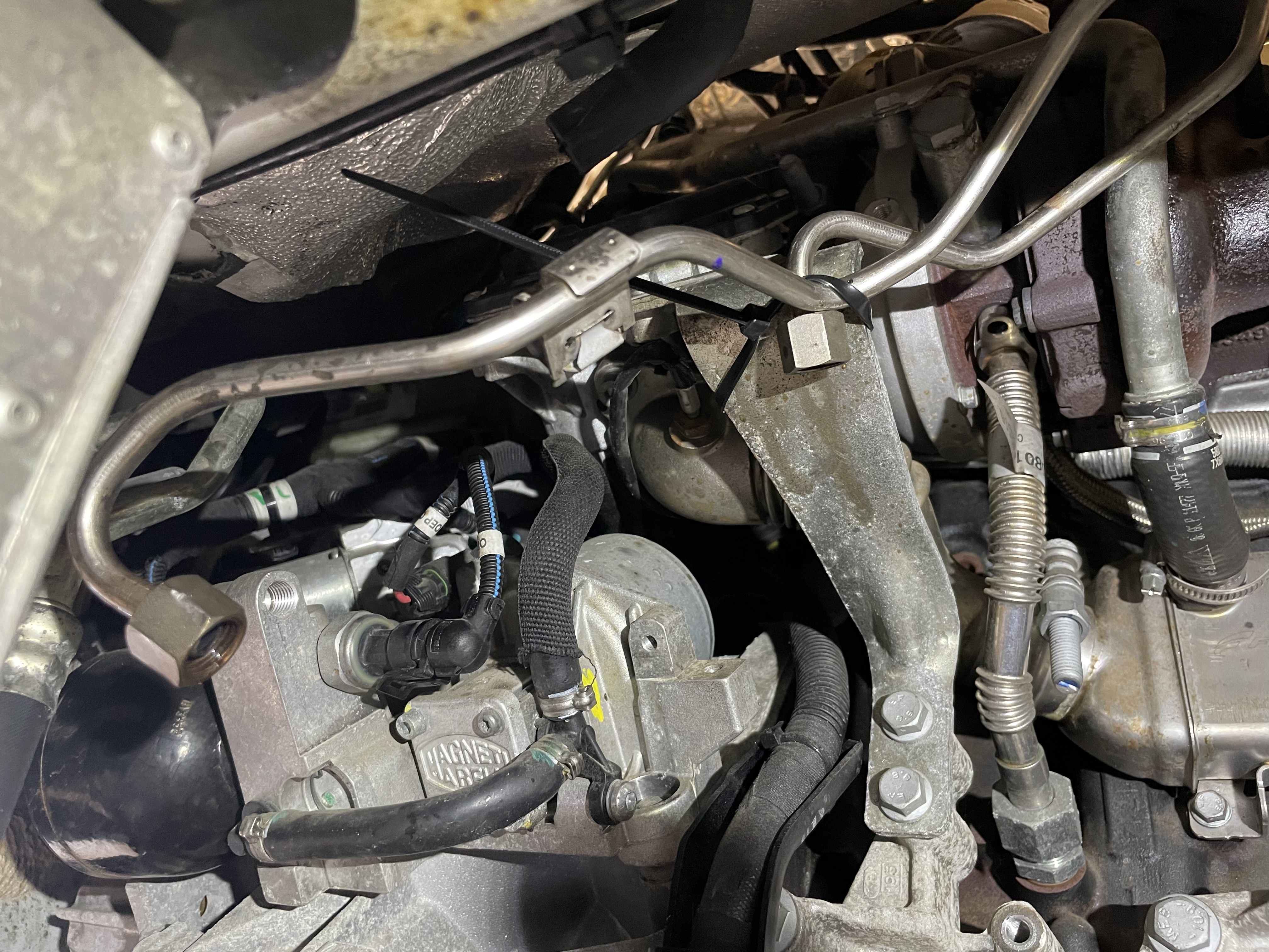

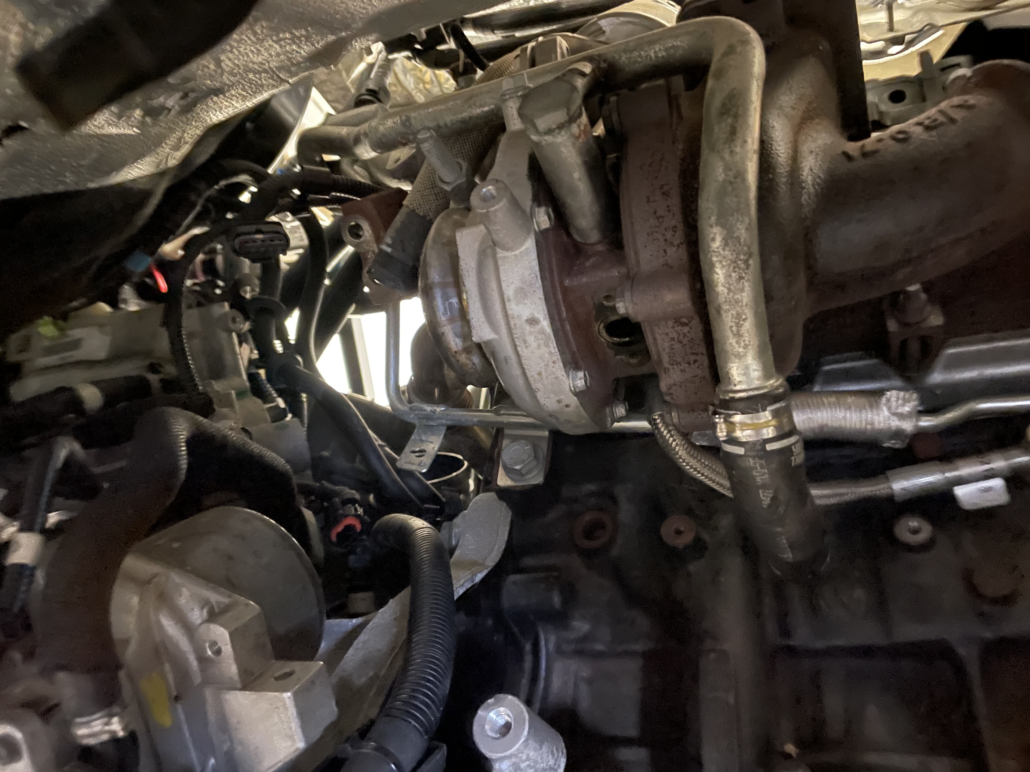

Not sure what you mean by 'turboactuator'.
My engine is the 130. There is a vacuum device at the turbo which pulls a lever on the turbo. I would call that the vacuum actuator.
There is a solenoid valve fastened centrally of the scuttle, just behind the vacuum storage air receiver. I'm calling this the vacuum.solenoid.
Do you have both and have you replaced both?
The black air pipes to and fro the air receiver also need checking for air leaks / cracks etc.

If you look at the MES data you will see that the desired position of the turbo charger is always same as the actual position of the turbocharger.
Turbocharger control is working fine in all load cases and scenarios.
Turbocharger isn't producing enough boost pressure in a certain partial load condition.
(same condition in which the LPEGR is working and open)
Under full load the turbocharger is producing full amount of desired boost pressure and with the correct position of turbo positioning sensor.
If there was a problem with vaccum control it also would be there under full load condition.

I've done a test ride today with unplugged EGR.
Unplugged only HP EGR but ECU shuts down both EGR.
And the boost pressure issue disappeared and also differental pressure of DPF is showing normal values.
When EGR plugged in the boost pressure issue comes back immediately.
Have also tested to block the HP EGR with a plate.
But no difference there.
So the boost pressure problem is only there while LP EGR is open.

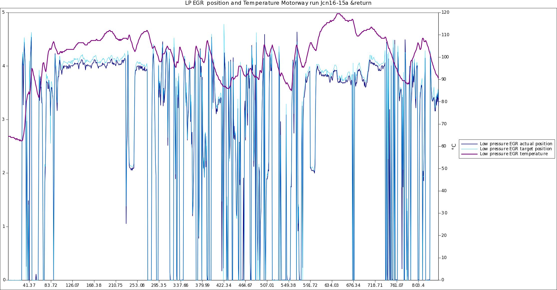

LP EGR graph. Warm engine 8 mile journey down one junction on Motorway @50mph and return idle in laybys at begin and end of journey as reminder ecu @28
the opening values are simular to yours at 3-4 mm at 2000-2500 closed at idle. the last plateau at 2000 rpm is when i changed to 6th at about 52mph

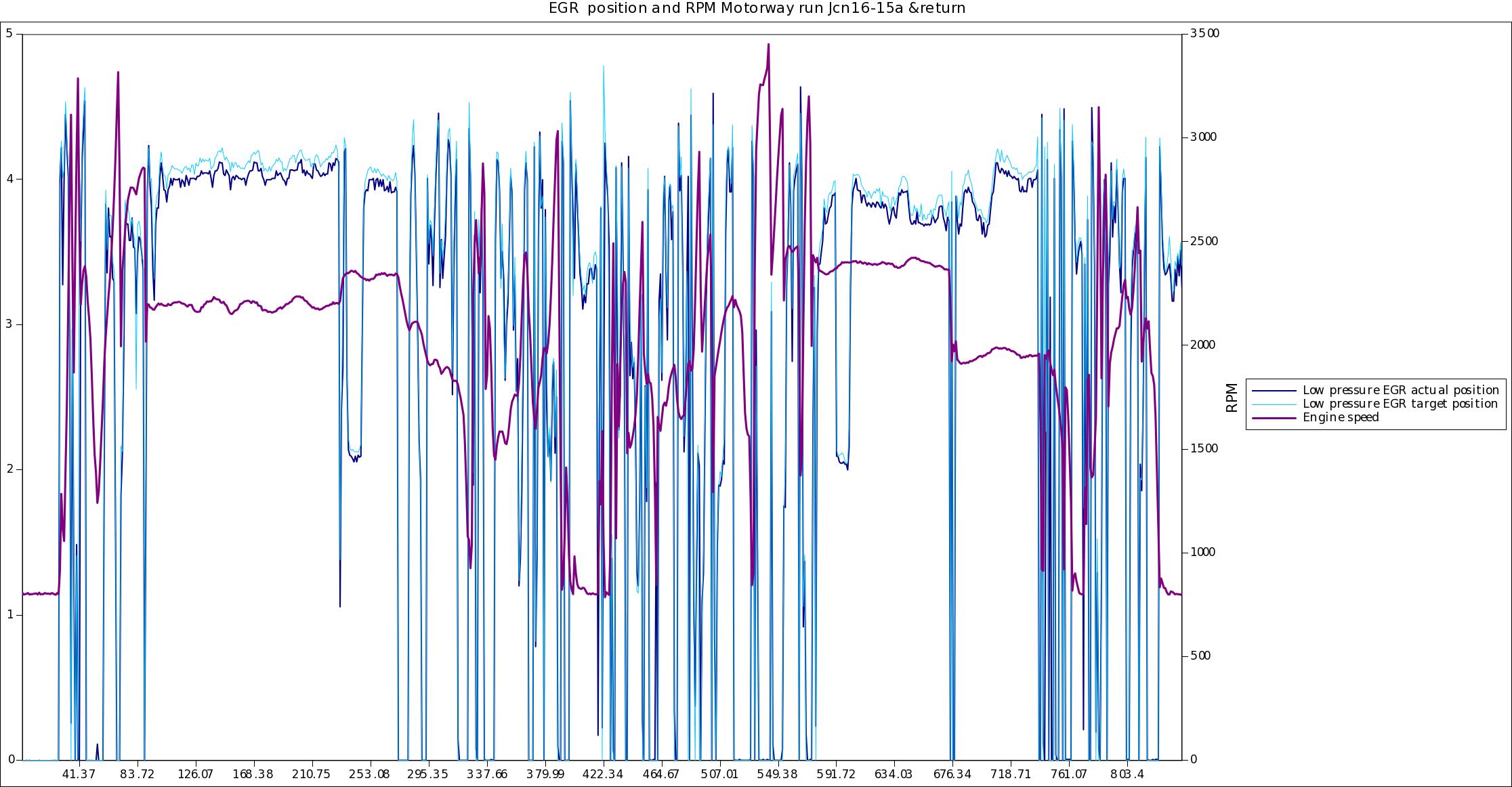

My LP EGR is at 4,5 - 5 mm.
Yours is at 4 mm.
A difference. But not that much.
My LP EGR Temperature doesn't exceed 65 C. Most of the time it's between 50 an 65.
Yours is never under 100.
Is my LP EGR in fact partially blocked?

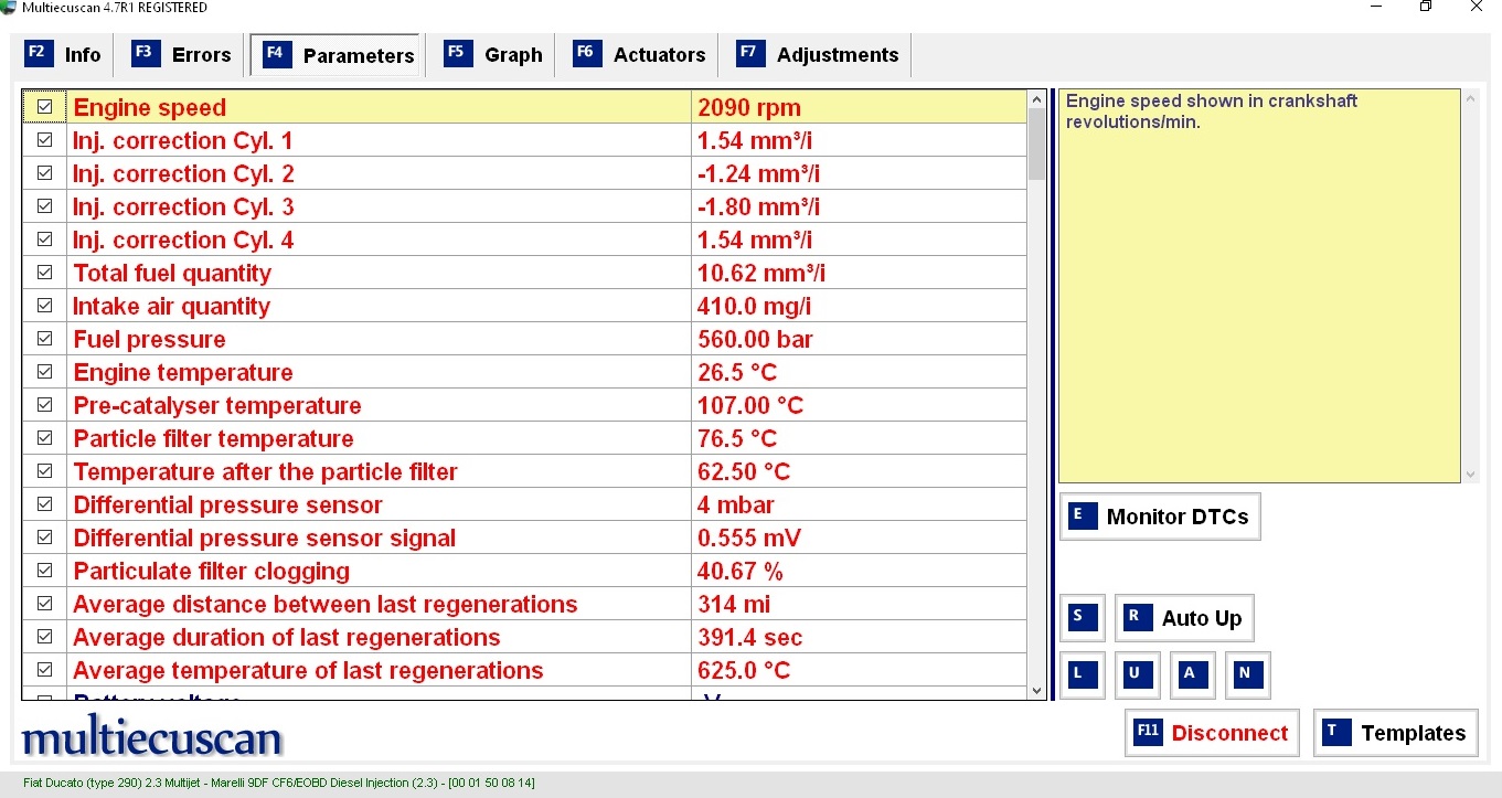

Are your injector readings within range as shown in the Fiat service news/bulletin?
: Maximum fuel correction per cylinder (Max fuel correction)
2mm3/H (2 cubic millimetres/hour)
Sum of injectors fuel corrections
0mm3/H (0 cubic millimetres/hour)

My injector variance
i could have a injector 1 problem?

These 2 examples are for 2000 revs and idle. a dead differential pressure sensor shows itself as not varying with revs and is typically blocked. the injector variance is a way of determining good working injectors. Its been mentioned else the limit is 2 per injector and 1 total.
Some examples of the p401 are relativly low mileage and too early for piston ring problems.

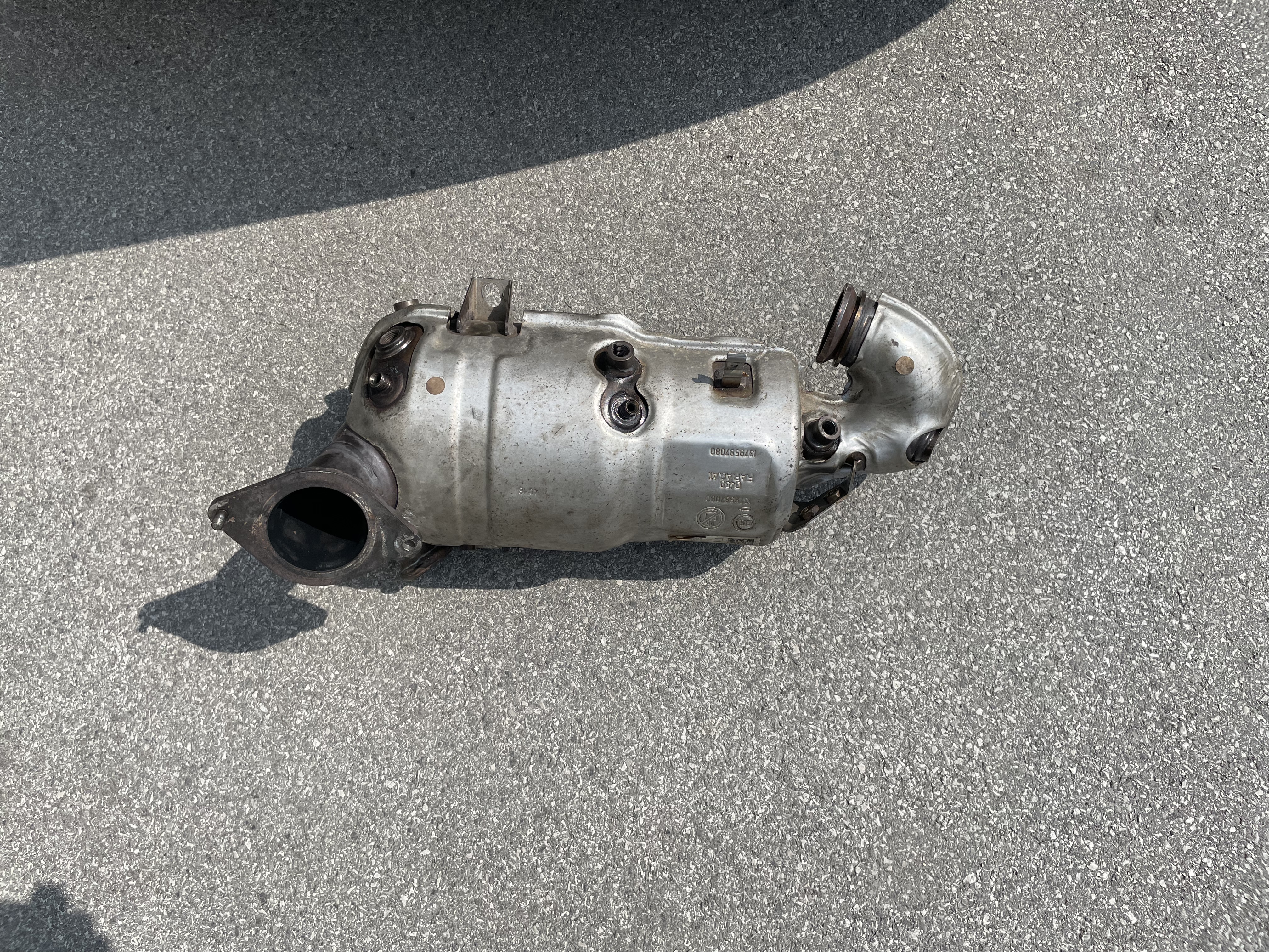

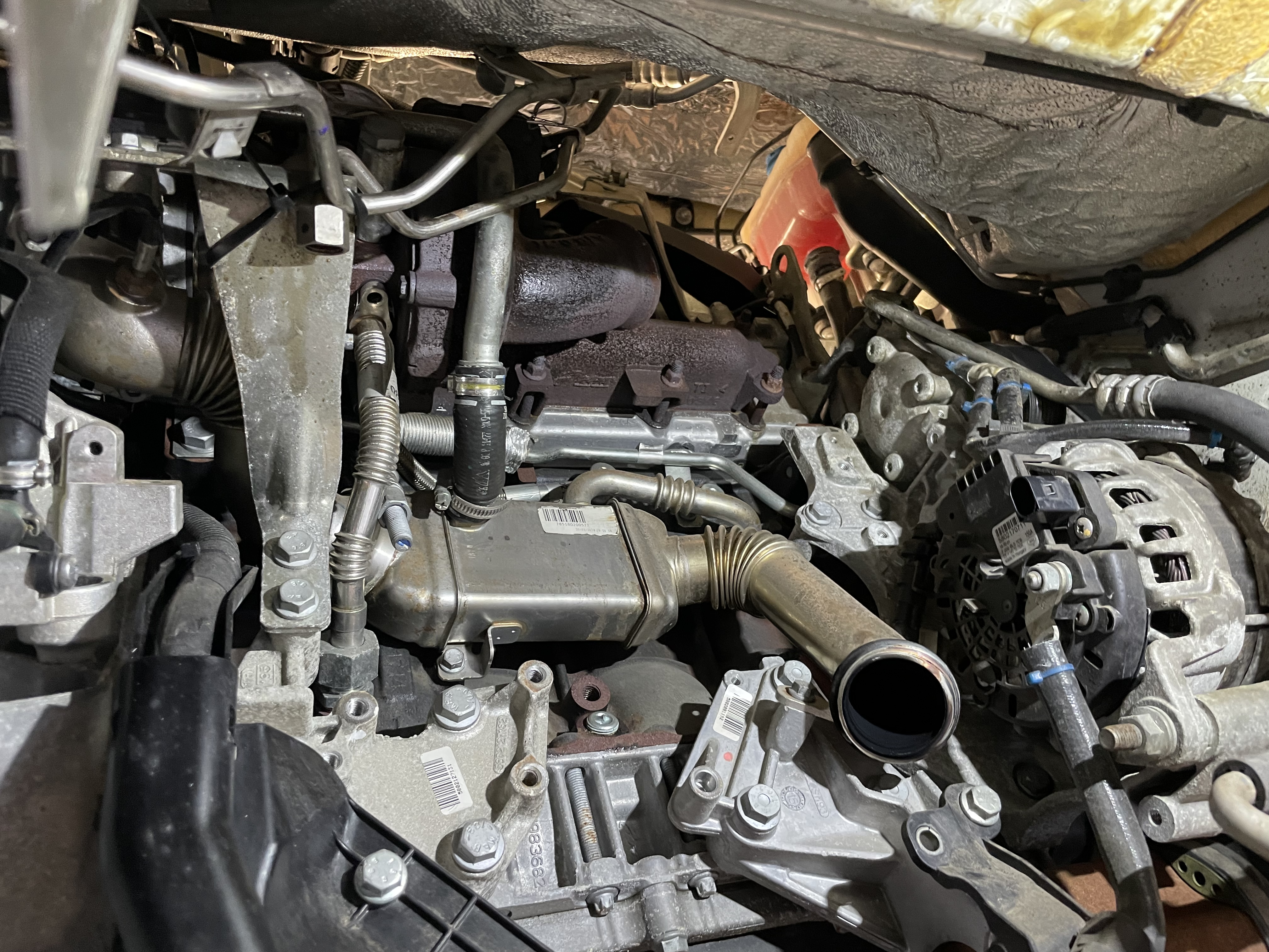

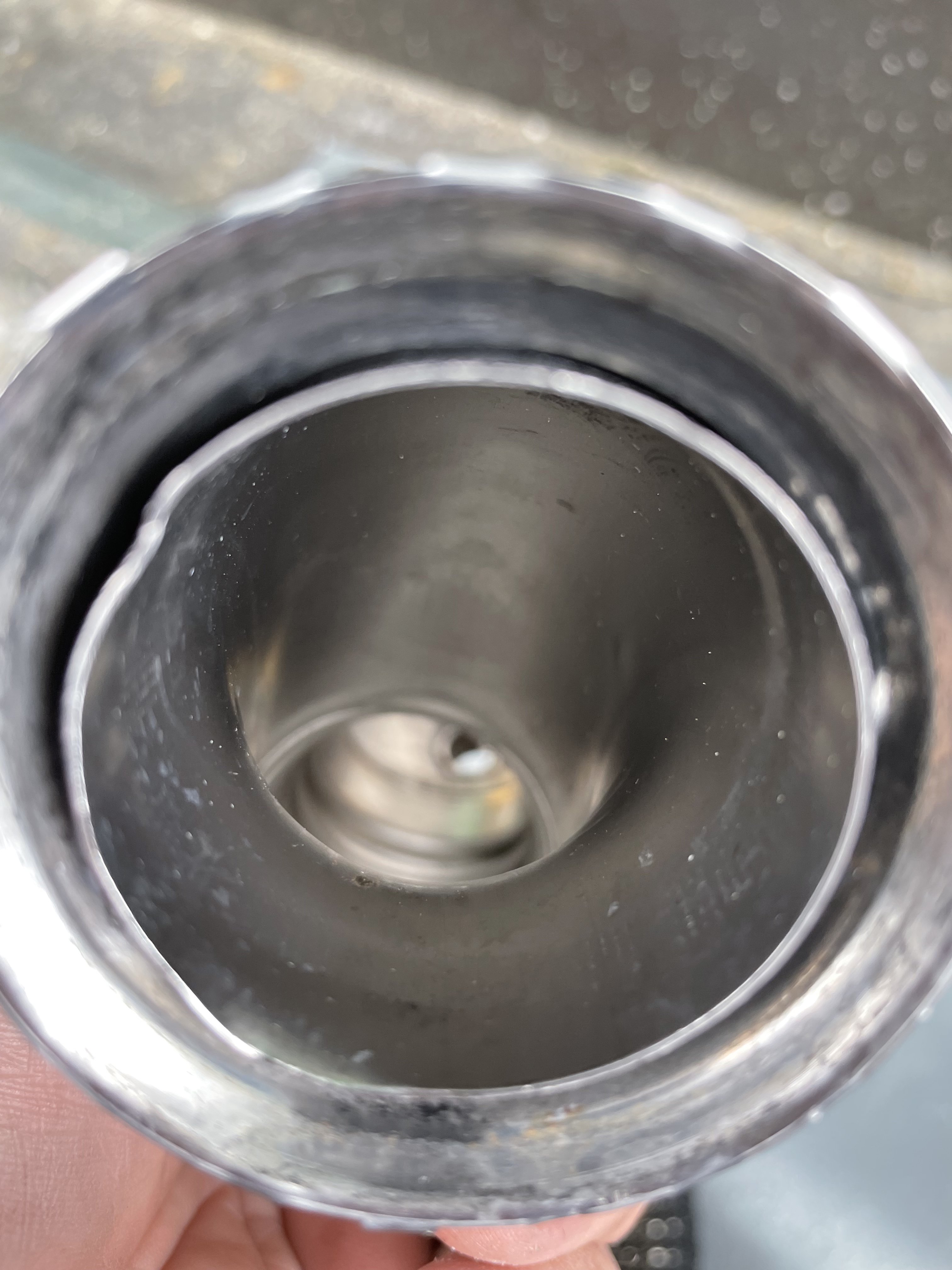

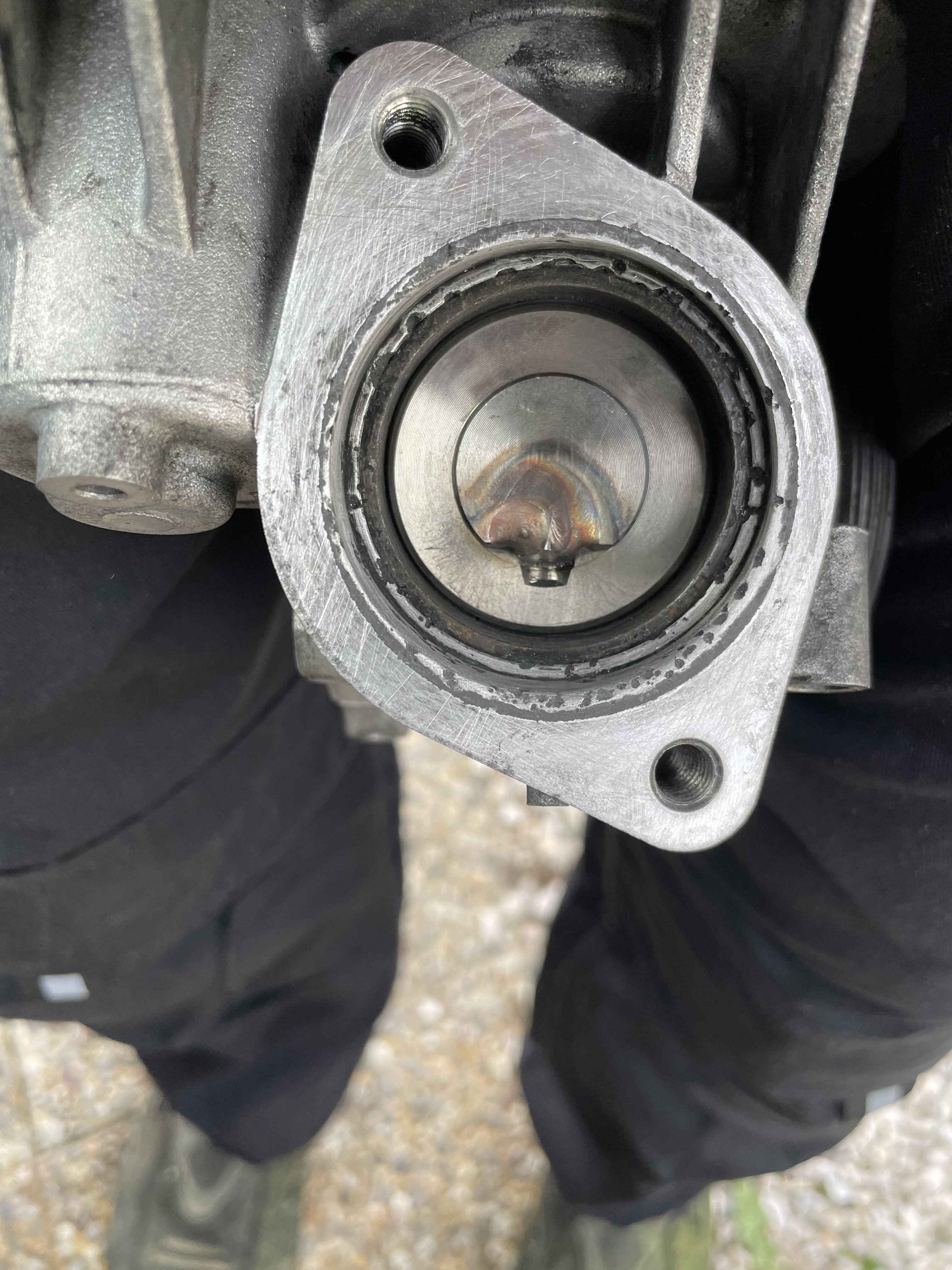

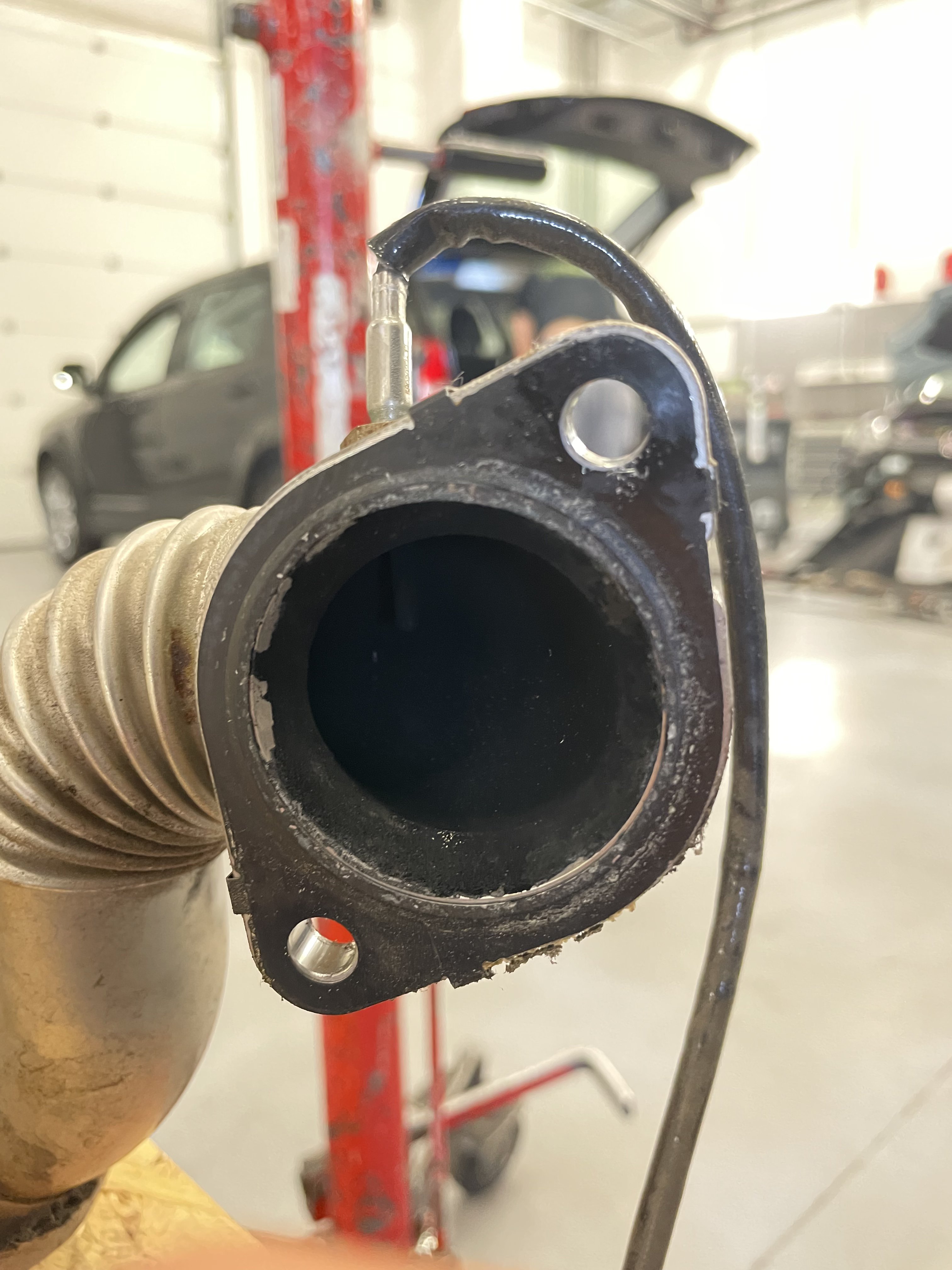

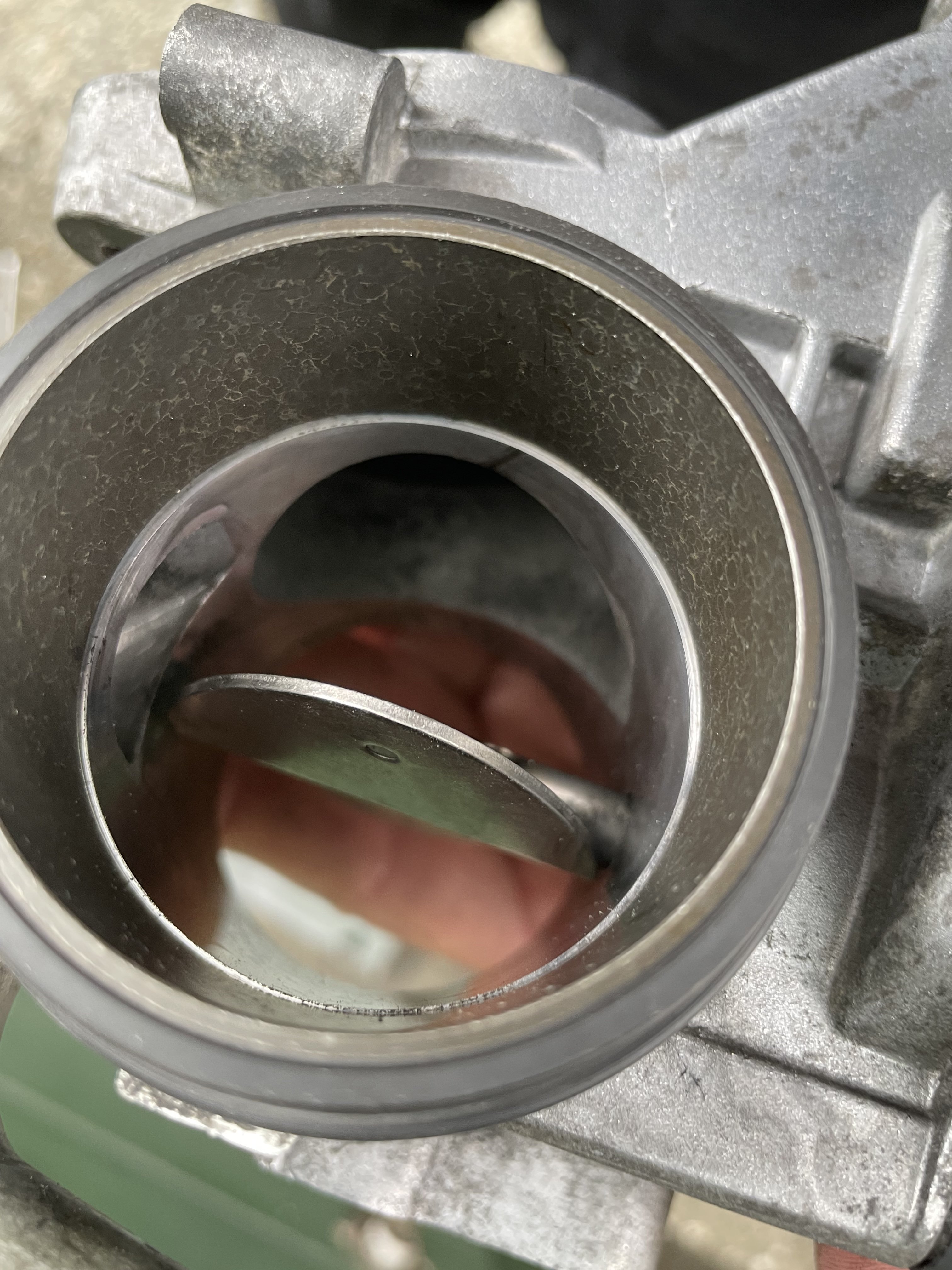

Today i took the DPF to the specialist shop, i will get results tommorow. LPEGR was dirty but not in the extent that would block it. LPEGR cooler looked bad, but it was not blocked. It had some resistance, dont know if it was too much. I cleaned all parts between the DPF and the turbine.

LPEGR cooler is after cleaning withouth resistance. Some more photos

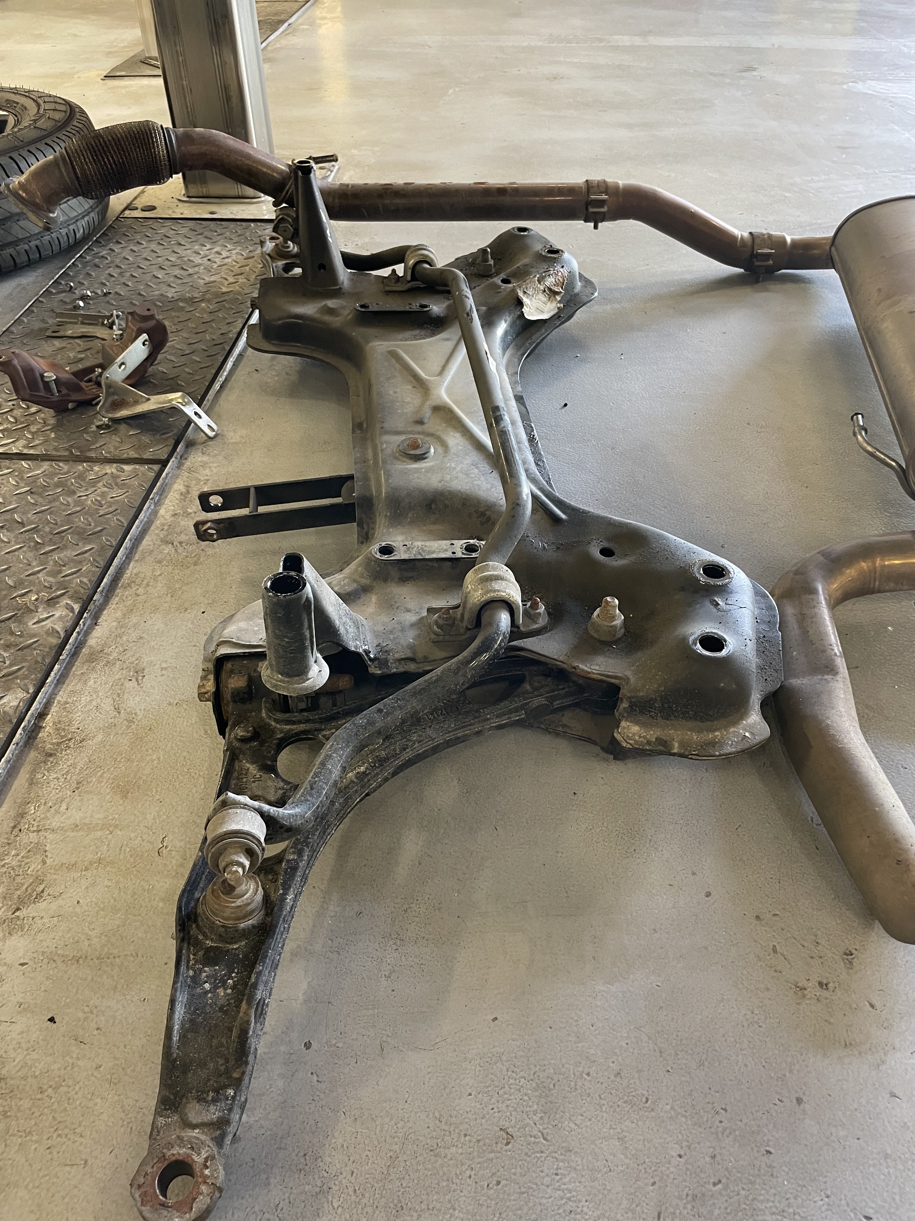

Very skiled mechanic needed 1,5 hours to take of the bridge and the DPF, and another 2,5 hours to take off the LPEGR cooler and LPEGR. It took another 2 hours to clean everyting. You do not need to take the engine out you can do it from the back side of the engine, but need to take off the bridge, exhaust system, some pipes from turbo……
I spoke today with the DPF specialist. In the shop he had DPF from Land Rover (maybe it was Range) with same problems with returning gases from behind DPF, Volvo XC70 has similar problems. The quality of DPF ,material in general is very verry very bad. His statement is: if there is any sooth behind DPF then DPF is broken. So the main question is what is causing the destruction of DPF in Fiat Ducato. All troubles with soooth are coming from broken DPF. What if it is just bad material quality as it is the case with VOLVO XC70? I will have some pictures of the DPF tommorow (hope that they will take them during repair) and will post them. I also had an idea what to change next, i did it and today when driving to mechanic i did not get the p0401 code, i have to test it further….
