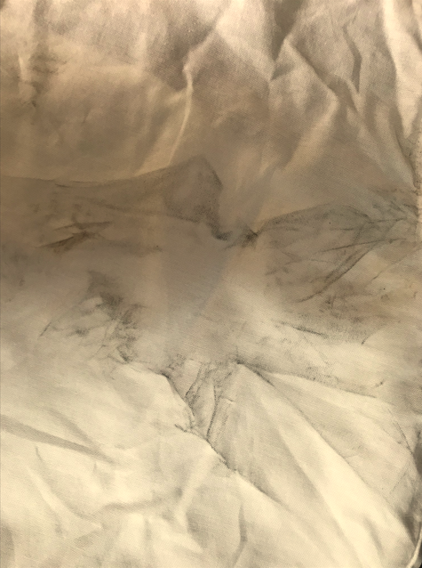

I'm probably way off on this but , I've been under van again and looking at cooler , I had some success cleaning ( old unit )
screen with just brake dust wheel cleaner, so looking at diagram on LP cooler, if it's possible to remove joint at DPF and get enough clearance to fit a cap on pipe and work out exact quantitie of DPF cleaner to fill up cooler( hose fitting and pump in liquid )to just below EGR valve, leave overnight, drain down,flush with clean water , and when dry refit pipe to DPF , I'm wondering could it work?

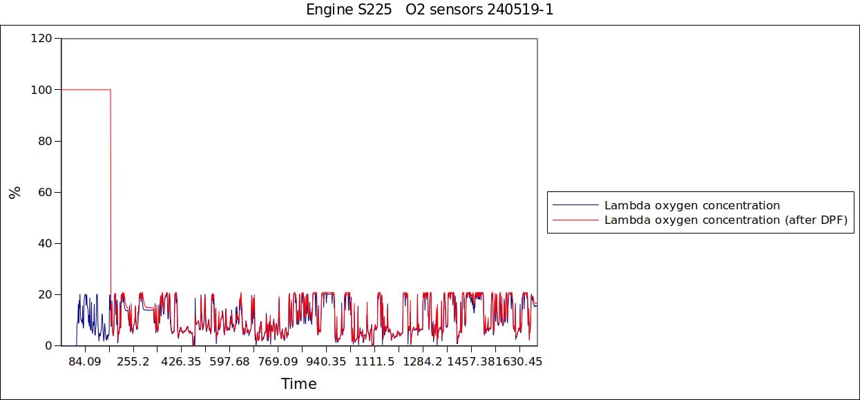

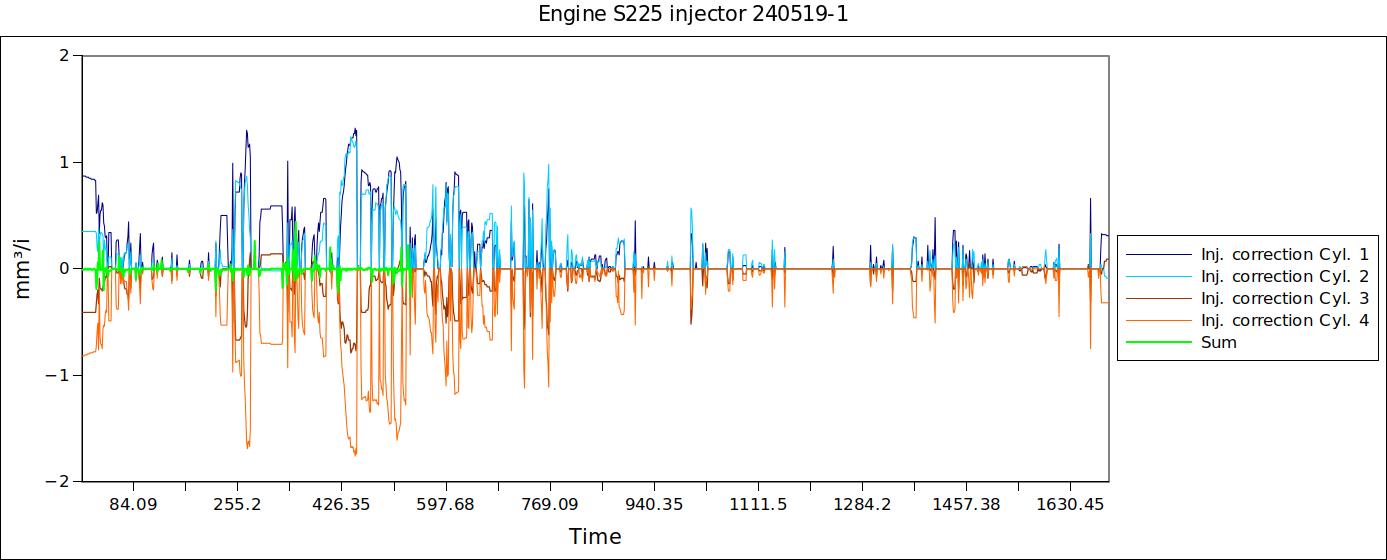

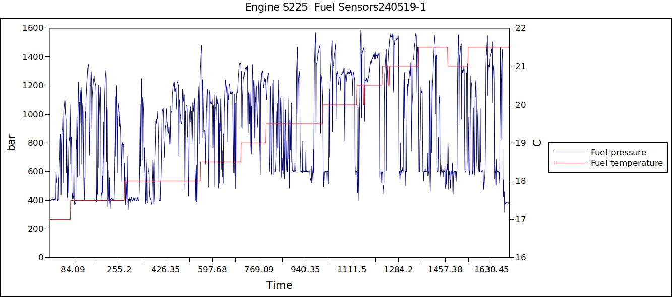

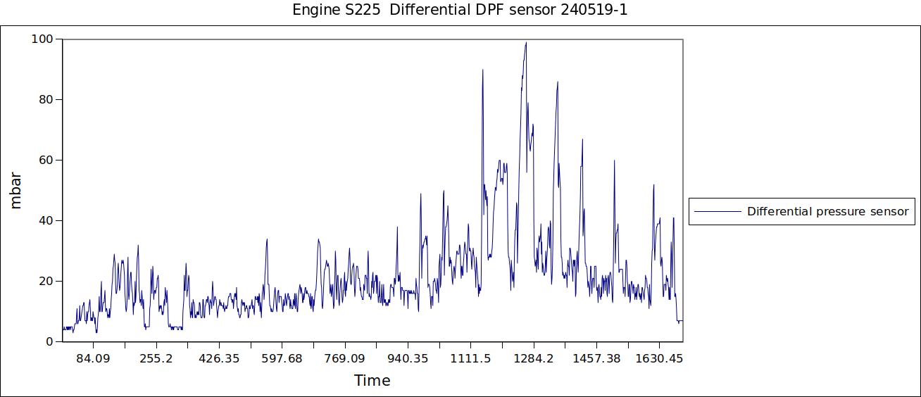

@Serrow225 A few graphs to look at.
Engine S225  Regeneration  240519-1.jpgEngine S225  Turbo pressure 240519-1.jpgEngine S225  Differential DPF sensor 240519-1.jpgEngine S225  Differential DPF sensor 240519-1.jpgEngine S225   O2 sensors 240519-1.jpgEngine S225  CAT DPF temps 240519-1.jpgEngine S225 injector 240519-1.jpgEngine S225  Fuel Sensors240519-1.jpgEngine S225  Regeneration  240519-2.jpgEngine S225  Turbo pressure 240519-2.jpgEngine S225  Differential DPF sensor 240519-2.jpgEngine S225   O2 sensors 240519-2.jpgEngine S225 injector 240519-2.jpgEngine S225  HPEGR 240519-2.jpgEngine S225  Fuel Sensors240519-2.jpgEngine S225  CAT DPF temps 240519-2.jpg
My coments: most doing what we would expect. the -2 injector results are spot on . wish mine we like that.
LPEGR -2 appears to be opening and closing as expected. Temperature i would have expected higher but lets see what its like with a few more runs. You did come from very low values. there is engine to engine variation
