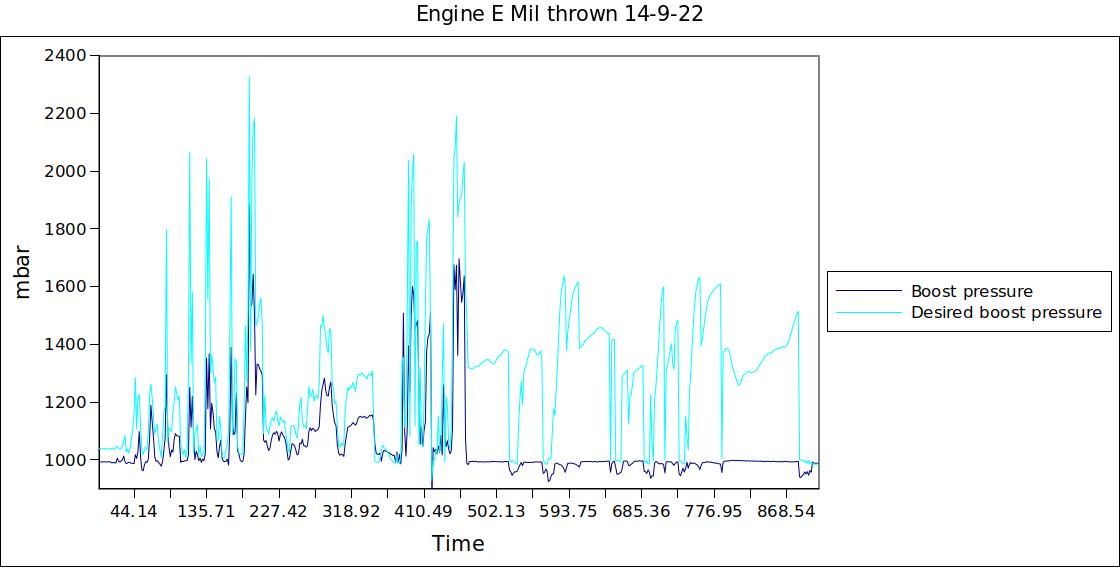

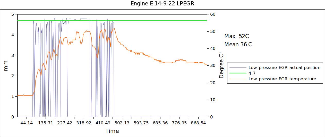

Looking back at old data of LPEGRcoolers i have seen no turbo issues with actual generaly meeting desired pressure but also this one. When the Mil light was thrown the turbo is effectively turned off. I don't remember any turbo or solenoid being repaired at the time. @Fredastaire.
Note the seriously low temperatures.

The pair of graphs make it so obvious..
So it's cooler change time .....

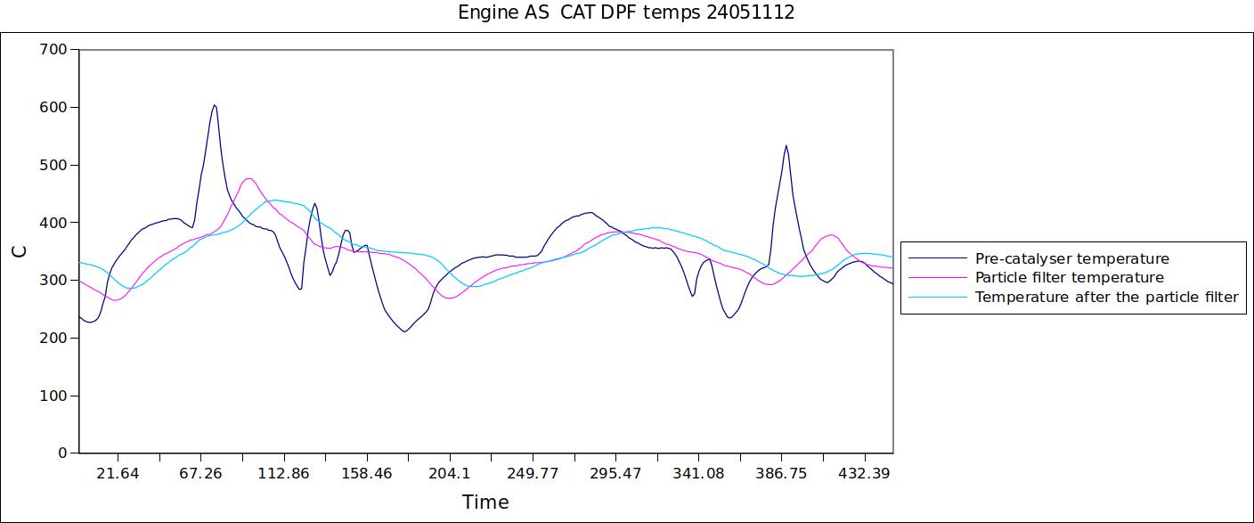

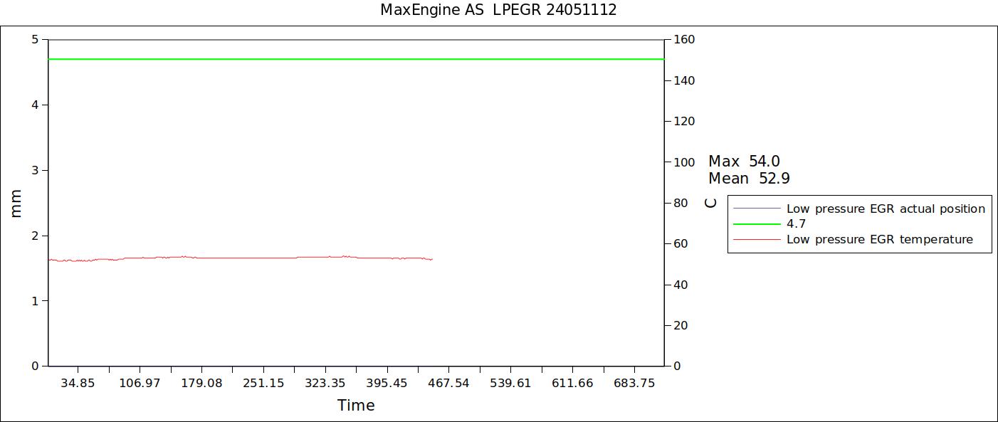

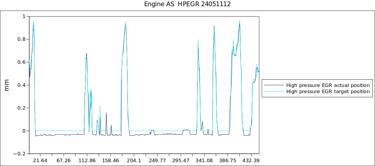

I have gone ahead and applied an "LP-EGR delete" ECU update. @Poachersmoon has reported earlier he has a LP- and HP-EGR delete done (in NZ by Peter James Tuning) and had no problems in a 5 hour trip. Since the LP-EGR delete I have now done around 1100km without any problems.
The proces is to unplug the LP-EGR connector so it won't move. This way no 'clean' exhaust fumes are transported back to the turbo inlet via the cooler anymore, which means the cooler (mesh) won't get blocked. And more importantly, the turbo and engine will only see clean air (apart from HP-EGR recycle). To prevent errors and emergency running the ECU update cancels 24 errors. I am told the following list is blocked: 0409, 0402, 0401, 0101, C405, 0489, 0488, 0486, 061D, 2111, 2112, 060E, 0638, 0639, 061F, 044A, 045B, 045A, 045E, 041A, 046E, 041A (again), 213B, 213A.
The ECU update is done via an Alientech Powergate tool: a) download the original ECU file to the Powergate, b) send the file to the tuner, c) tuner 'mods' the file and sends it back, d) upload the modded file to the Powergate, e) upload the mod to the ECU. Nice thing is the Powergate can hold multiple files, mine has the original (slightly tuned) ECU file, the LP-EGR delete, and the LP- and HP-EGR delete. It is an easy 20min proces to switch between ECU files. I can e.g. choose to switch back to original before going for MOT testing (or "apk" as is called in NL).
I know I will need to track 'health' of the engine (more) myself now these errors are cancelled. I am told 22 of these 24 are directly related to LP- and HP-EGR operation which should not give problems, the other two are for communication with cruise control and the MAF sensor.
I want to check / this, and prepare a periodic manual check of engine health to ensure this error cancel does not hide anything serious from being detected.
But, so far, so good.
Attached are some MES recordings from the 1100km trip this weekend and a short test / check drive tonight.

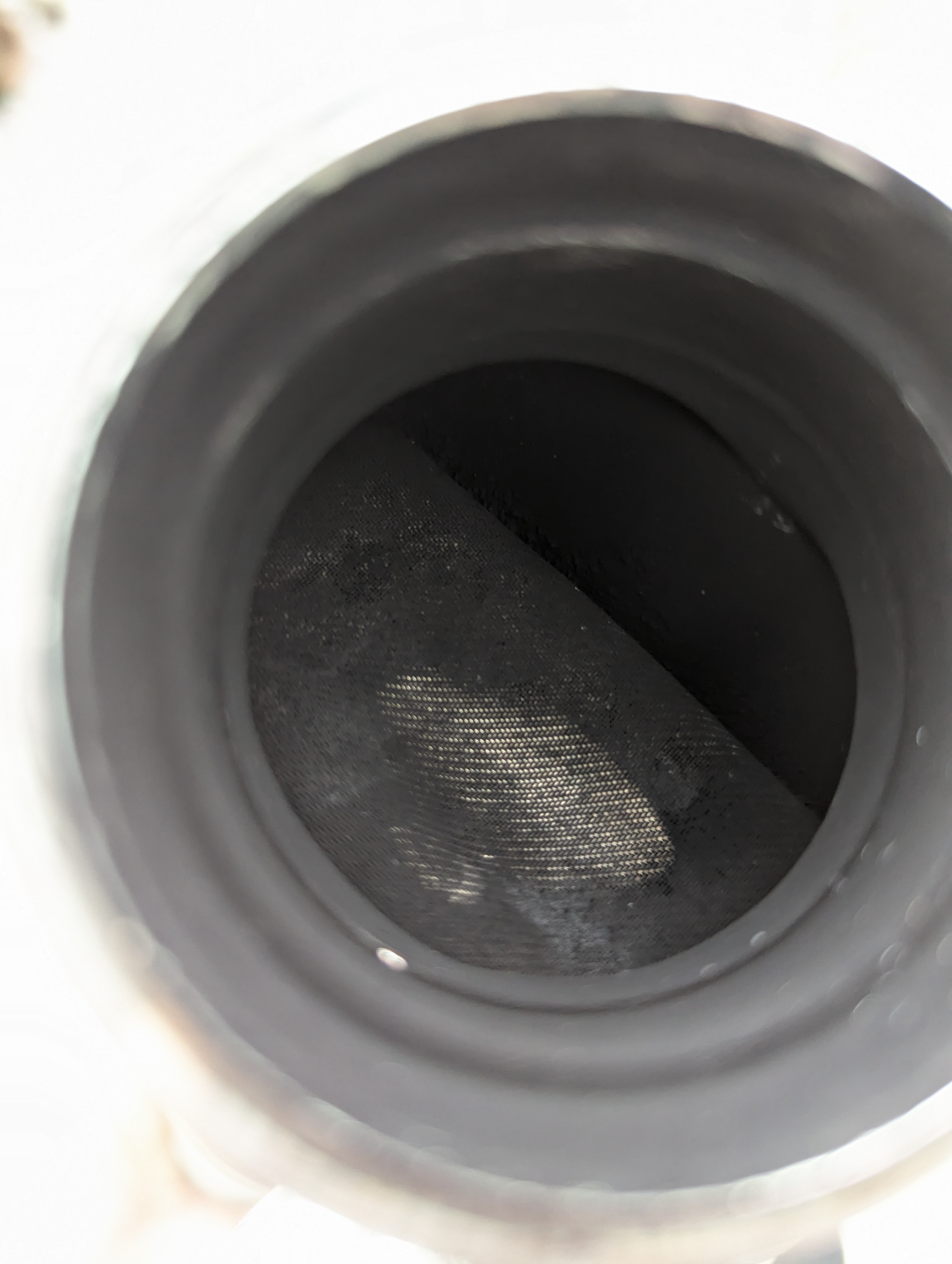

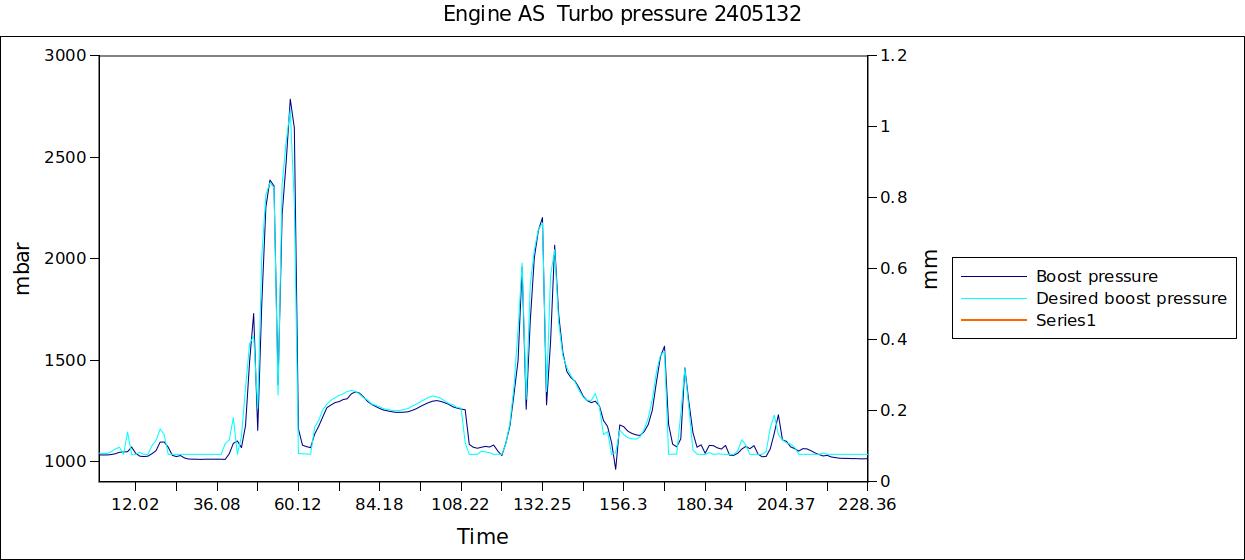

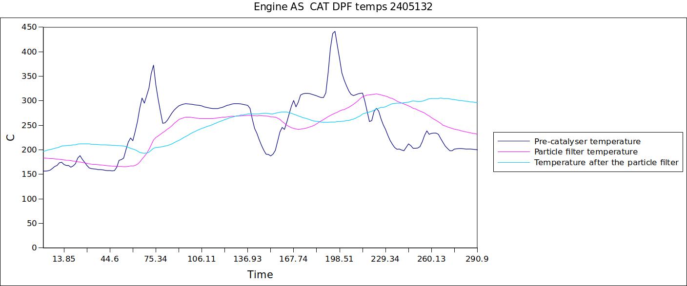

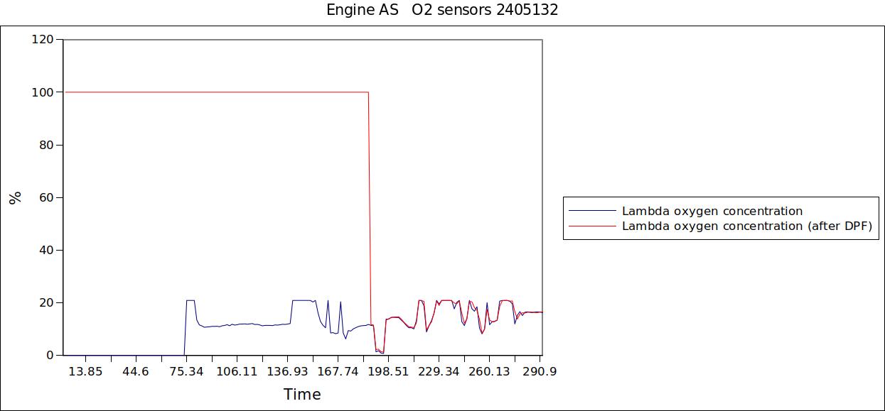

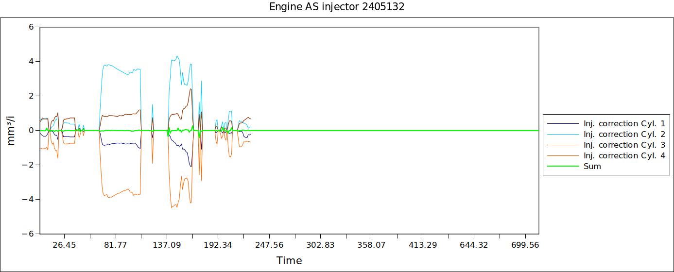

@theoneandonly , hi carried out a rerun on MES data run(same route as 1st run ) now LP cooler replaced , turbo actuator was not replaced as it was deemed not required apparently checked and working .
i cleaned exhaust tail pipe and did a wipe after run , still got a very light carbon film , very much like pencil rubbing on metal .
so i am sure i have a slightly cracked DPF , but i will monitor it for now as i need van as we have a trip in 4 weeks so i cant have it in garage possibly waiting weeks for a DPF .
hopefully I have got engine able to perform with no problems for now .
