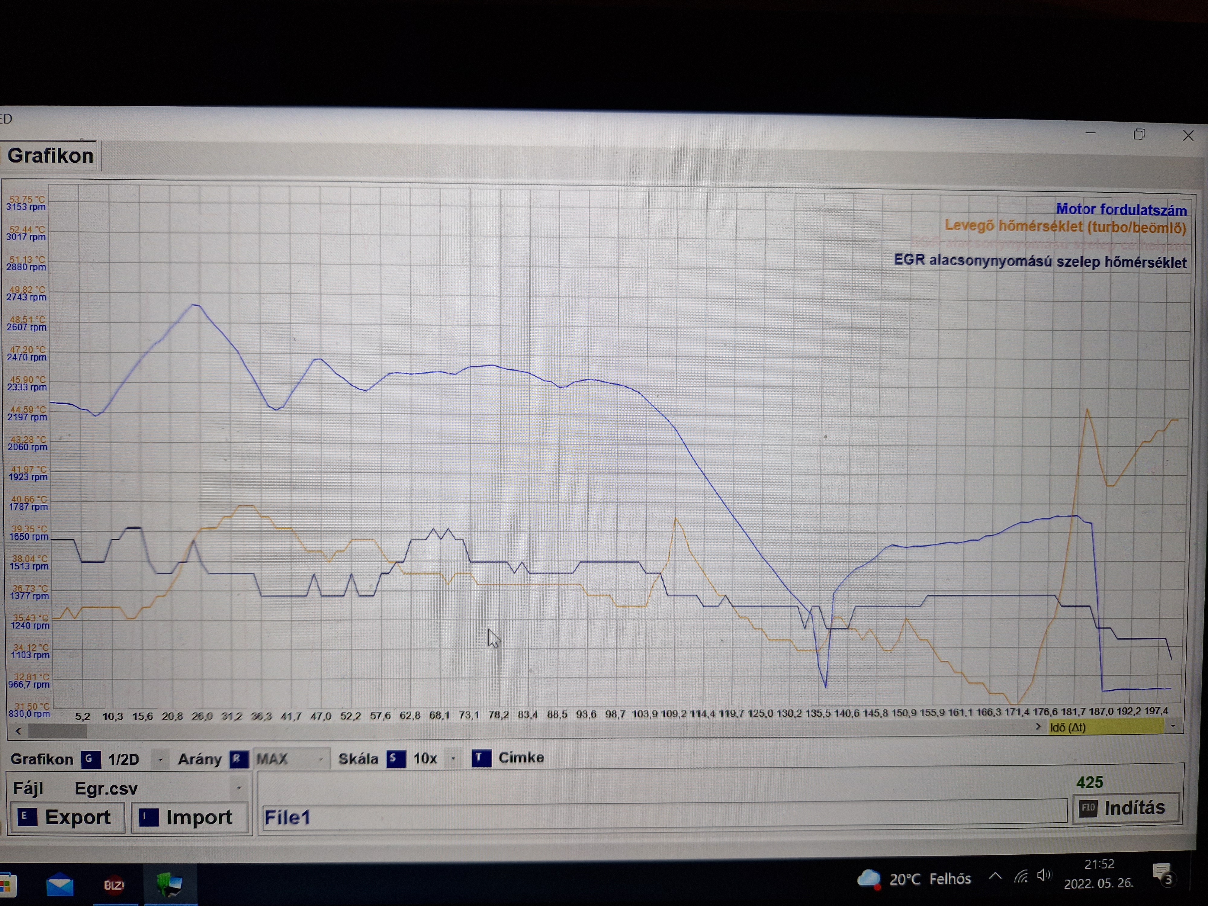

My dpf values:

You can record:
- rpm
- actual position LPEGR
- desired position LPEGR
- desired boost pressure
- actual boost pressure
Try to record with 30-40% gas pedal and under partial load.
If there is a gap between desired and actual boost pressure, while LPEGR valve open, than your LPEGR is blocked.
If the desired and actual boost pressure is the same than there is maybe some other fault.
