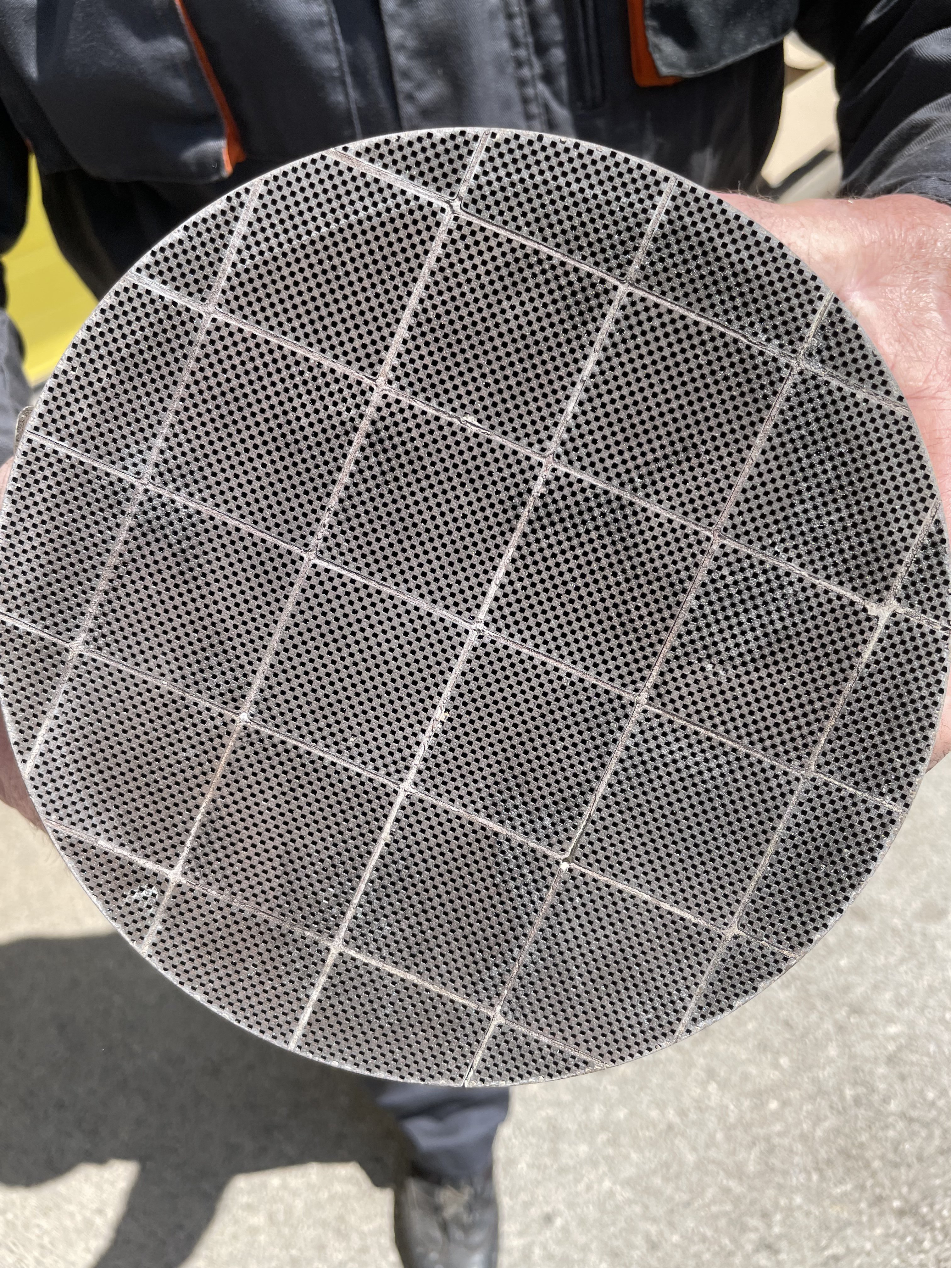

What method was used to clean DPF, just washing or dismantling and hot cleaning (baking) ?
The source of soot are exhaust gases after DPF. There are 3 faults of DPF ( as far as i know). Melted, cracked and blocked (cloged). In first two cases soot passes DPF and polutes air intake system. If you do not take DPF appart or use camera (camera is not 100%) you can not know if it is cracked or melted. In those two cases MES will show normal cloging and normal regenerations. In case that the exhaust pipe is black and has soot at the exit end there is a big chance that DPF is cracked or melted.

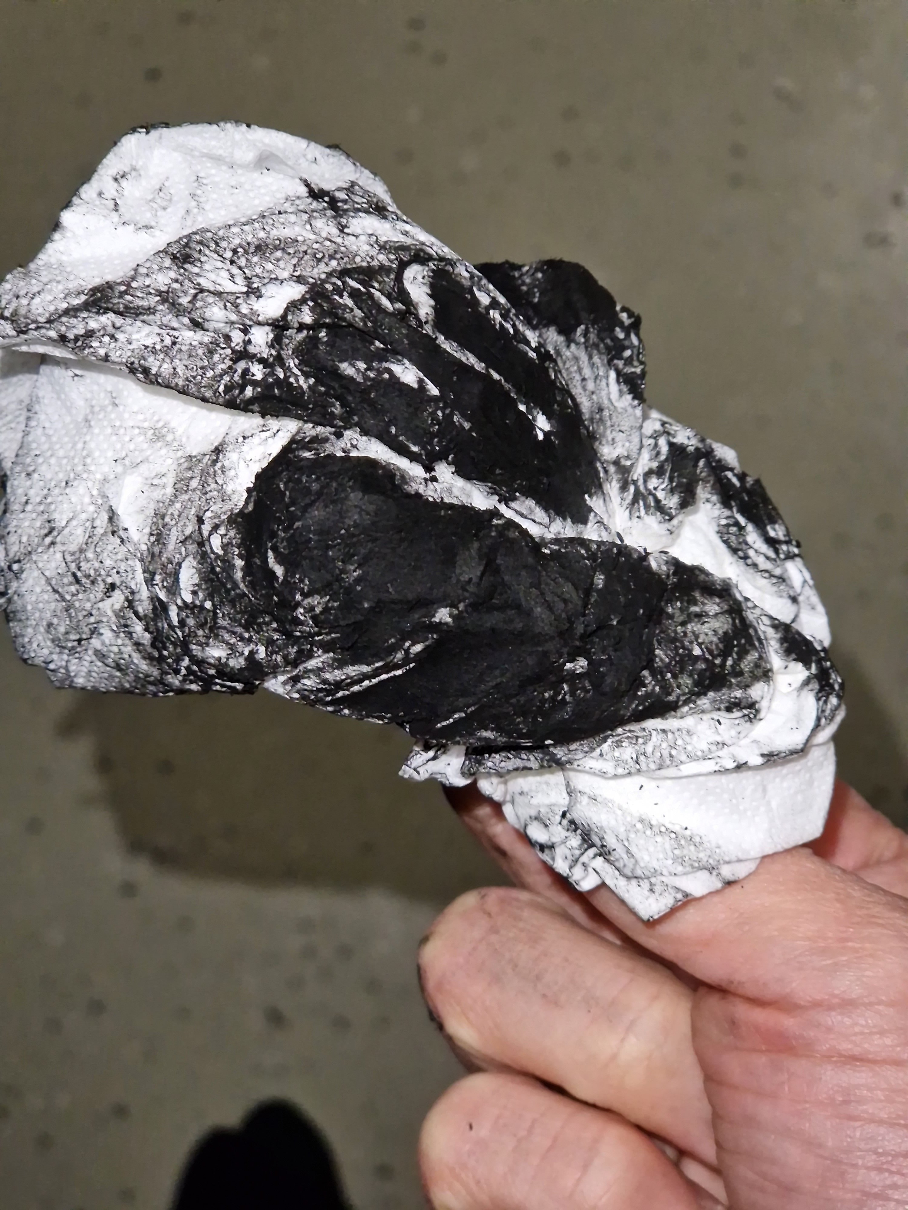

Washing. Is your exhaust pipe clean or black. Try it with white paper towel. Picture of cracked DPF core, can you tell it is cracked?

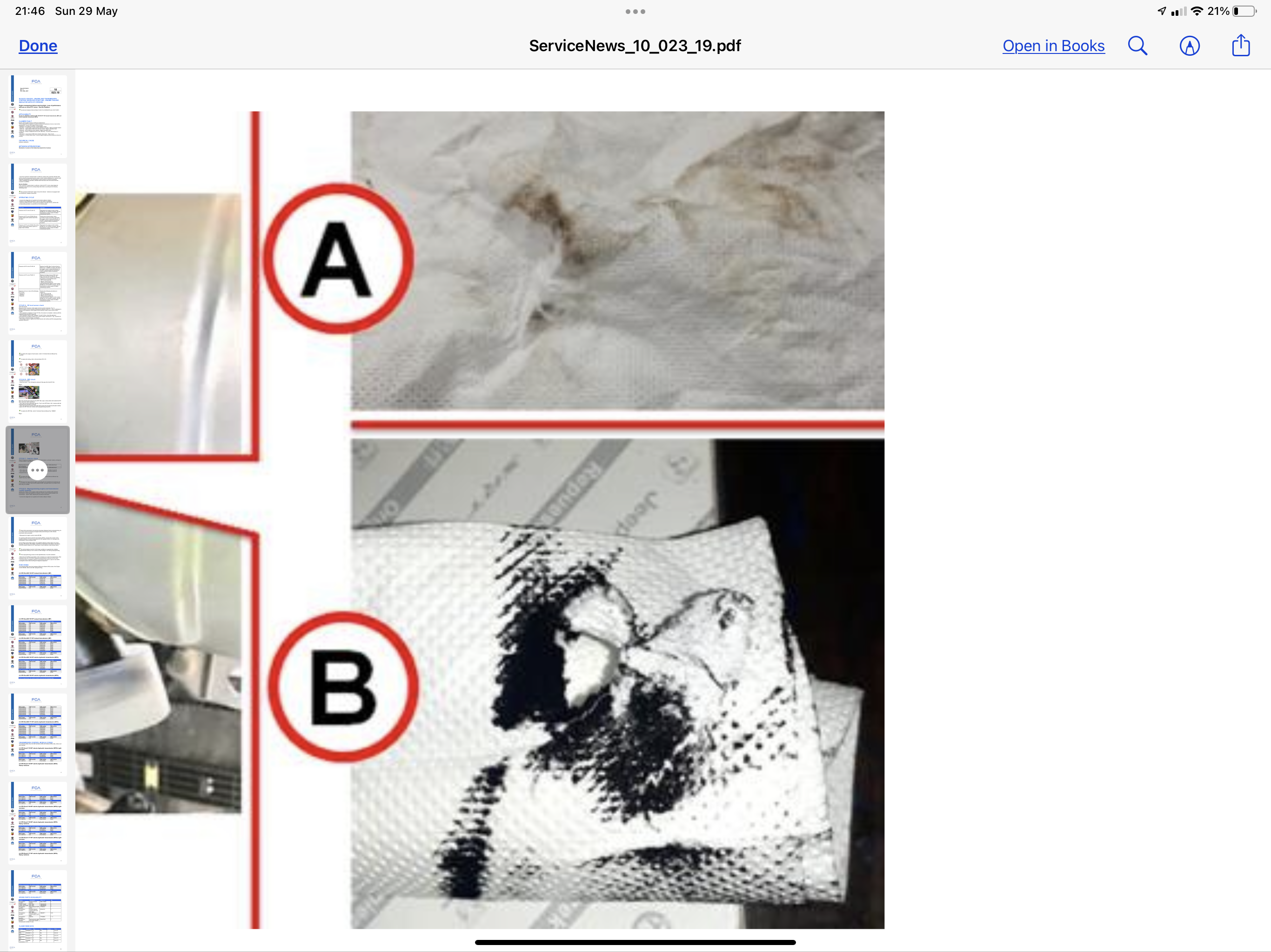

It has to be clean if it is not DPF is not doing the job. FIAT instruction is to check the soot at the exit of the DPF. Picture A ok, picture B not ok. You can check the exhaust pipe.

My old engine didnt cause the black pollution ? How can i check at the moment these black mutant cause my old or new engine ?
That is realy dirty. Every diesel engine is producing soot, some more some less. If injectors or any other component is influencing optimal combustion then more soot is produced. DPF stops soot so the exhaust is almost clean. If DPF was not changed it could be that it was demaged before and with the new engine the problem was still there, it just took some time to polute the air intake system of the new engine and to triger the MIL. I would say that your DPF is demaged. Try to clean the exhaust pipe and drive some miles then check again. Can i ask what was the price of the engine

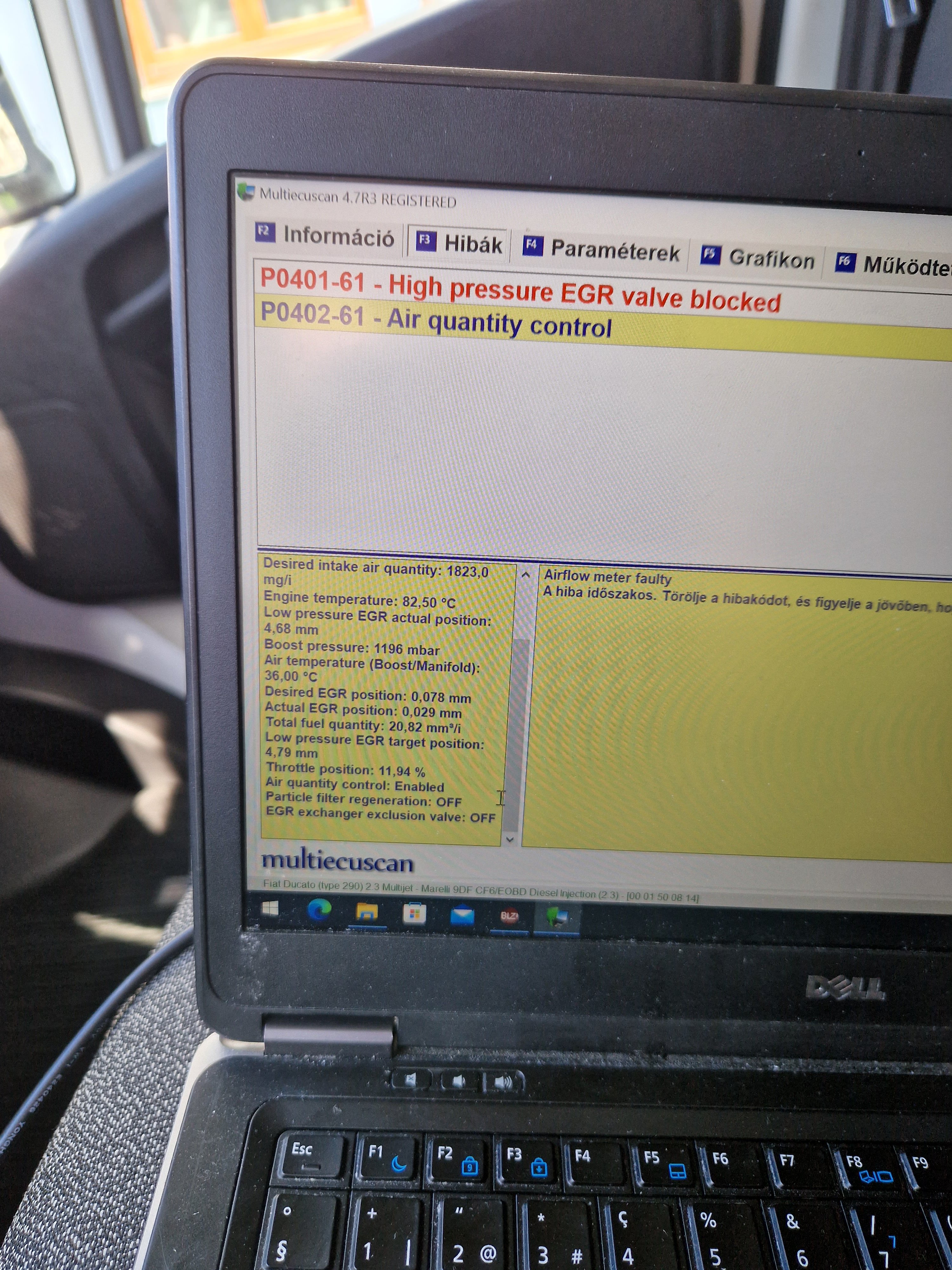

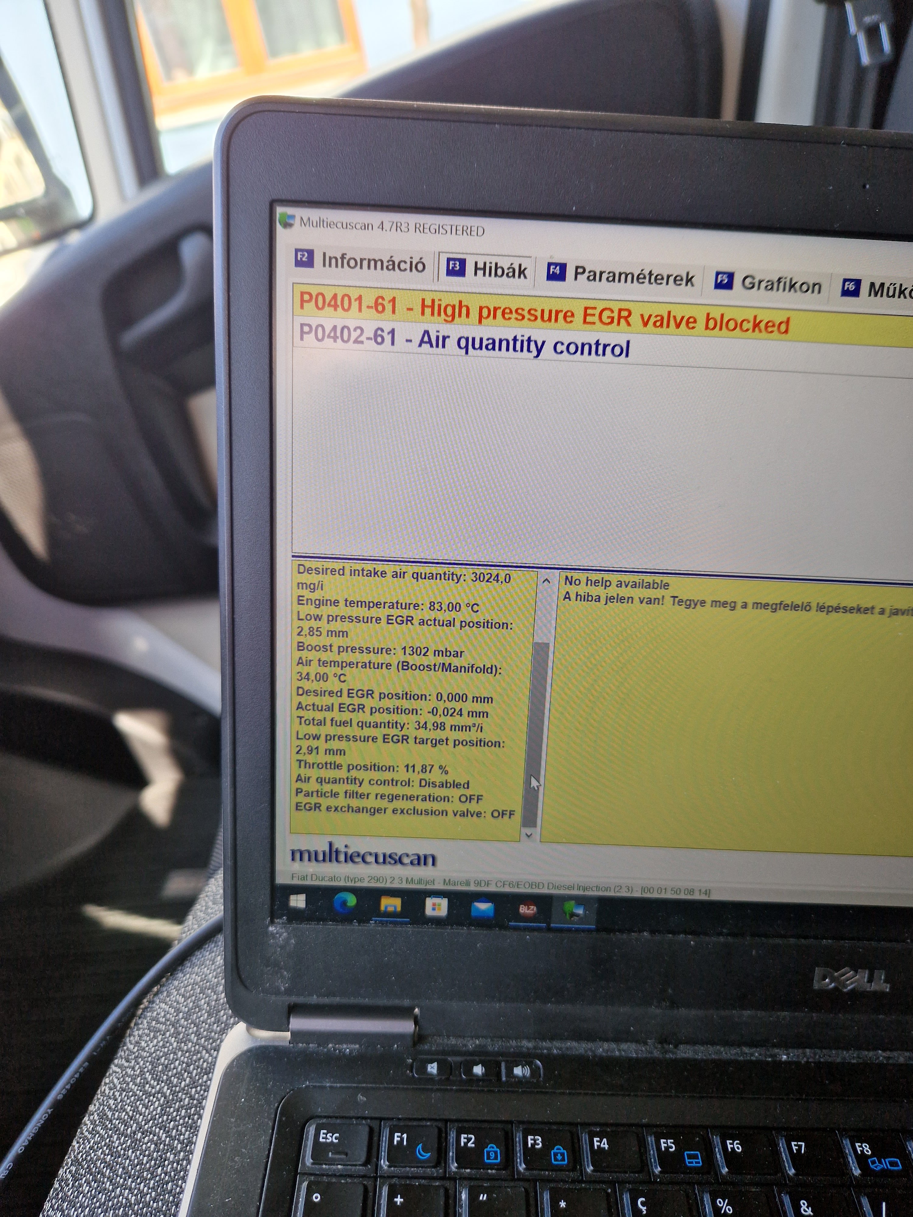

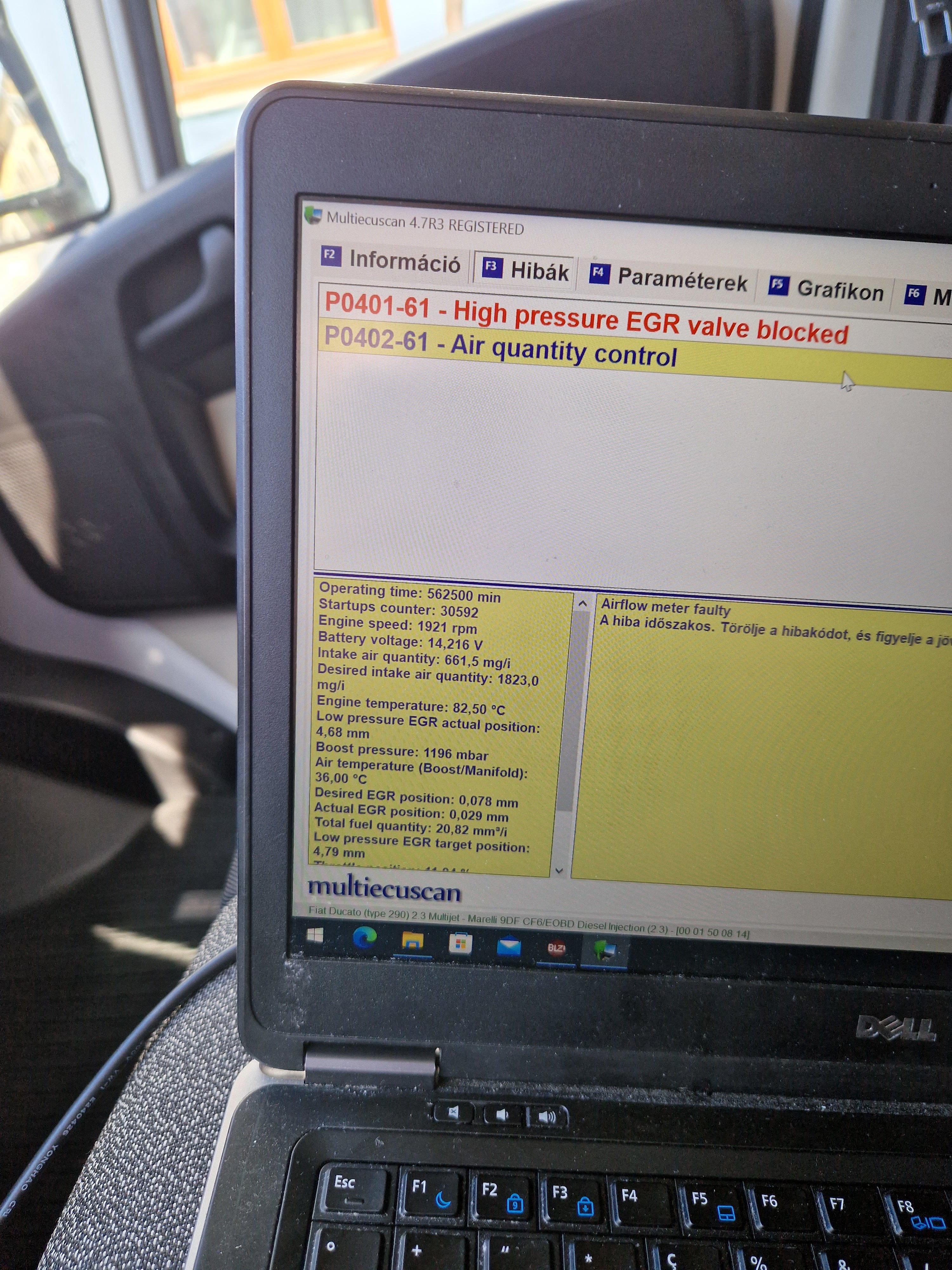

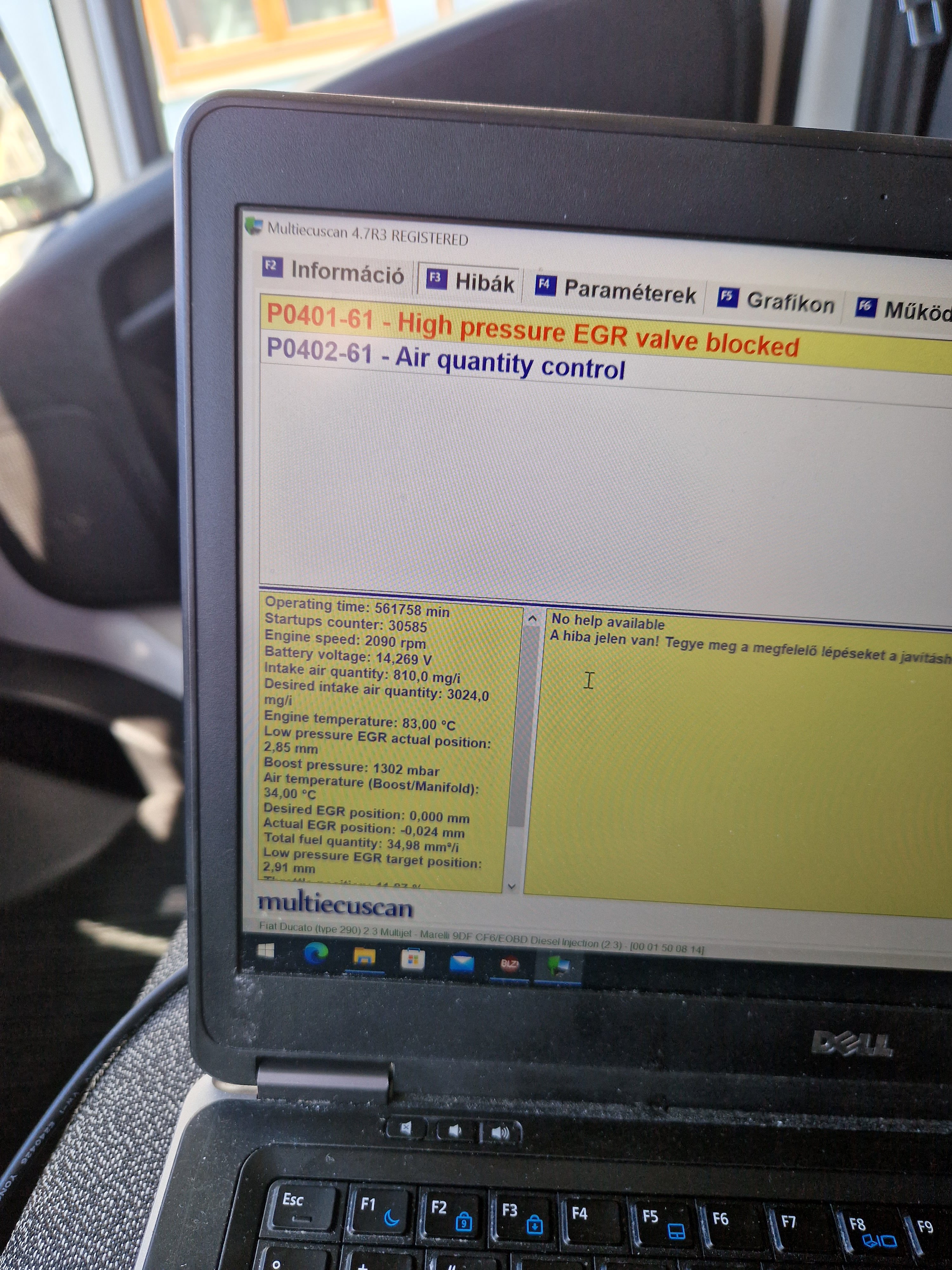

I make log one more check the injector correction and come up one more faulty code. Now i have p401 p402.I have no more question about twin egr system..
