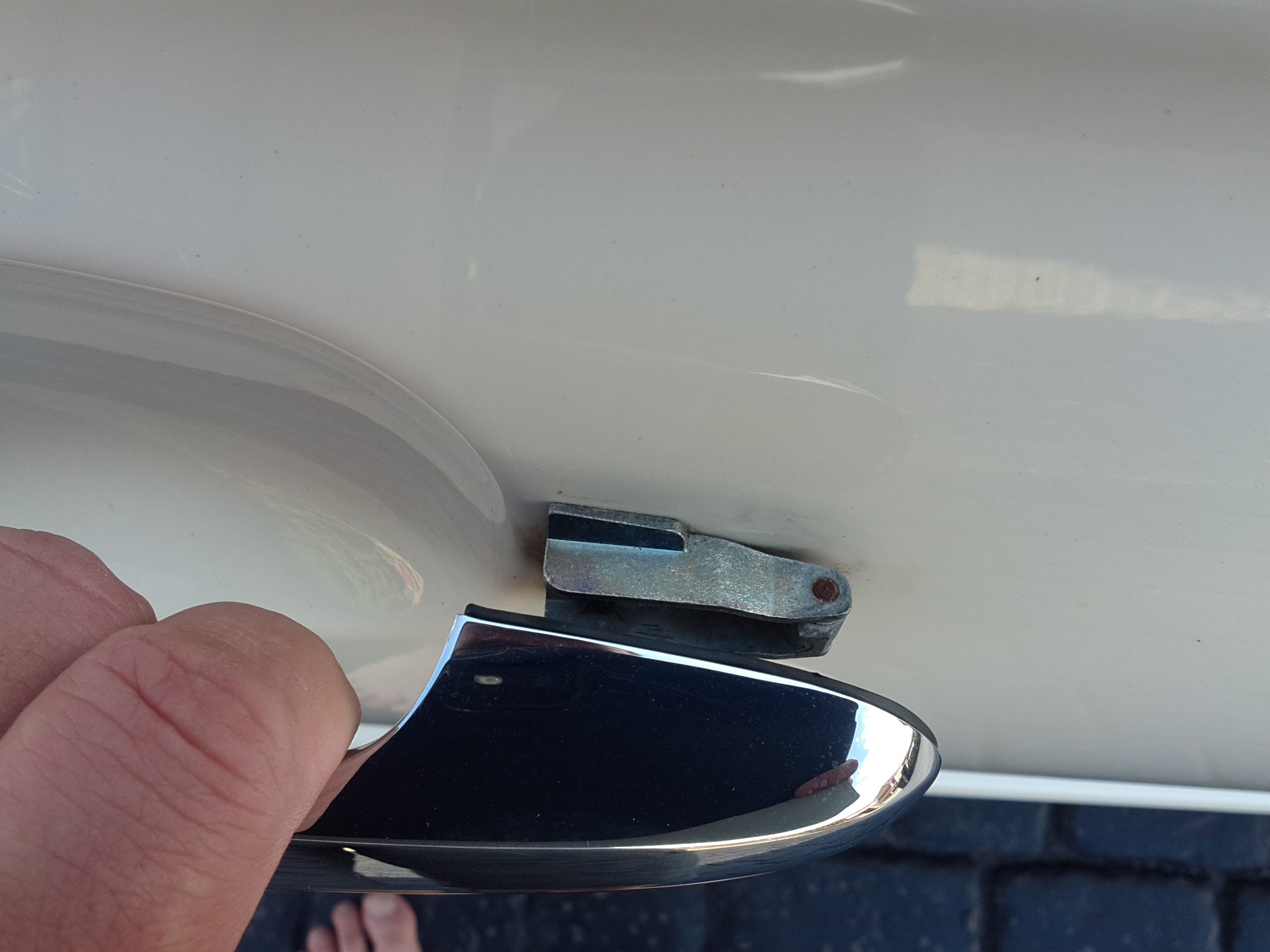

Hi all, I have a similar or identical problem with my drivers door handle, it still works I just have to be careful with it and lever it from opening end, I would like to replace the hinge, can anyone link a site to get them or is a main dealer good as any to get the part I need, I've read through the guide just thought I'd share this image here,
Lee.
I'd wondered how widespread this problem was, as my car is now over 4 years old and it hasn't happened yet. However, the sales figures on Ebay, if accurate, suggest that it is very widespread. It's obviously a rubbish design, and Fiat should fix it, but as they won't I may buy a repair kit from Ebay and pre-emptively fit it, with plenty of lubrication.

Someone saved a few quid/thousand handle assemblies by making the pin out of non-stainless steel (n)

That’s not too bad then. Top tip. When you undo the bolt on the front side of the handle which holds the hinge on. Use that hole in the door from inside to undo the Philips screw that holds the hinge onto the handle. Position the new hinge and again, do the screw up from inside. Much easier than trying to do it from outside as there’s not much room to get a stubby screwdriver in.
