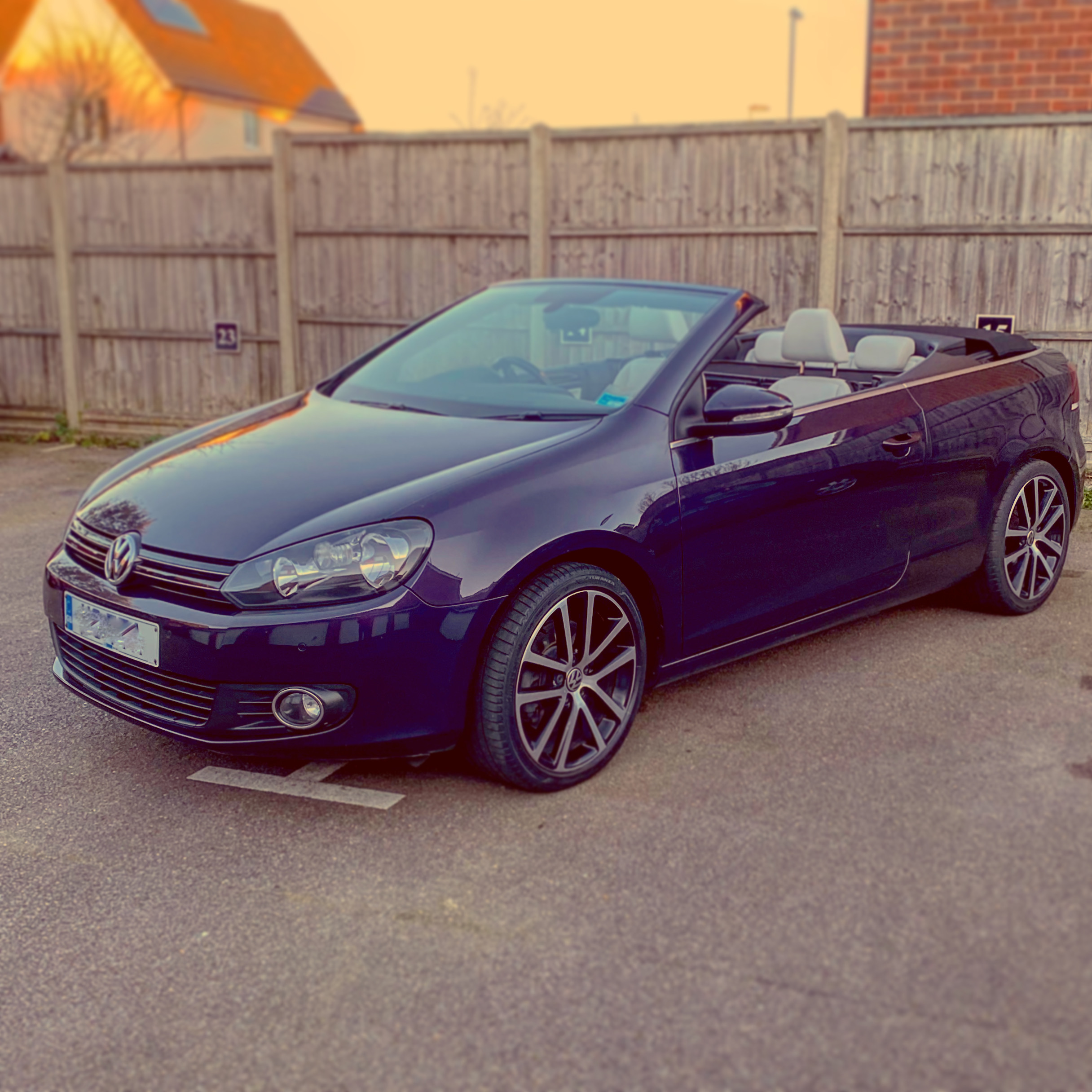

I’ve been ”detailing“ my golf since I got it new in 2015 with only 17 miles on the clock, not wanting to pay VW prices I bought my own AutoGlym dealers kit and applied it myself £40 verses the hundreds that a dealership charges at least I know it was applied properly. In my early twenties my electronics skills lead me to work in dealerships so I picked up a lot of tricks and tips. I also became friends with the AutoGlym and Auto smart Franchises in the area, so again picked up even more.
Since then I’ve used mainly AutoGlym stuff. My routine for cleaning is as follows
Wash with water only with a pressure washer to blast off any loose dirt.
Two bucket system AutoGlym bodywork shampoo - microfibre covered sponge (designed to keep the grit away, but wash out)
once the outside has been cleaned, I use a wheel brush to wash the wheels.
Whole thing then gets jet washed down.
Microfibre drying cloth all over (gets put in the wash each time)
AutoGlym Claybar (not done every time) and use AutoGlym Rapid Detailer as a lubricant
As its a dark colour it gets a coat of Ultra Deep Shine (I’d recommend Super Resin Polish for a red car)
AutoGlym Glass Polish on the windows.
I have an Trade bottle of AutoGlym trim cleaner which blackens and cleans plastic and rubber trims
Then once everything is cleaned off and its fully polished it then gets a coat of HD wax (you can probably guess the brand by now)
Also if needed i have bug remover and tar and glue remover from autoglym if needed for spots of tar, or ground in insects.
I use a German made, rubber seal cleaner that keeps the seals from sticking or in the winter freezing. Also keeps the rubber from drying out and cracking.
The wheels are diamond cut types so you’re not supposed to use sprays on them but I hand polish them with an alloy wheel sealant
The inside gets hoovered and cleaned with AutoGlym interior shampoo. Seats leather cleaner and then a leather balm to keep them soft and from cracking.
7 Years old tomorrow ! Still looks pretty good with nearly 90k on the clock.
Picture is with Wife’s Countryman.
Thats a pukka job. Agree autoglym products are quality.
