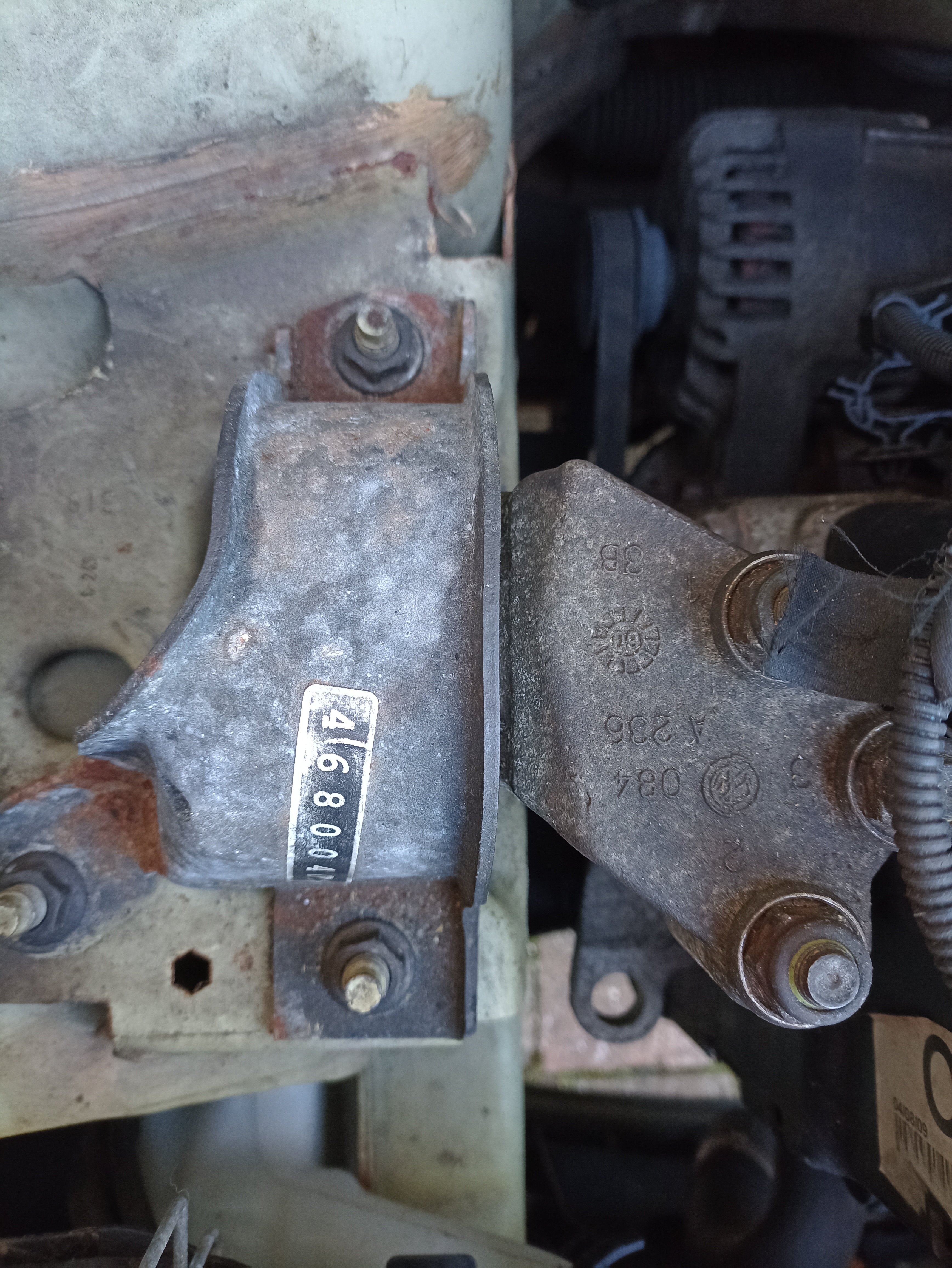

Don't know if this helps much but I just nipped out and snapped these shots of Becky's (2010 Panda 1.2 Dynamic Eco) mount.
Dagdromer has mentioned the top gearbox mount, I'm thinking of lifting the gearbox side a bit with a jack to see what happens.
I'm thinking if the engine/gearbox assembly pulls the lower mount to the left that much this should be noticable on the top mount as well?
I took a picture from above and compared it with online pictures but it is hard to see the difference. I just went out and stood on the off side off the vehicle and I can pull the engine to the right quite a bit without to much effort.

The gearbox mounting has an inverted U-shape bracket that bolts to the gearbox. Remove the battery box and support the gearbox on a jack. It's only a few minutes to remove the whole mounting/support assembly. If the rubber mount has failed it should be easy to see the damage.

its put together wrong because you have to remove the exhaust someone has bodged it, click on the photo for a side b side. The pink dot is how it should go

I appreciate your input but I think there's nothing wrong with the bracket, if I would loose the nut on the bracket (the dogbone and bracket together) will have a space of 15mm between the gearbox.
I took of this bracket to avoid breaking anything of the exhaust. it's only two bolts extra to take off and it gave me just enough space to wiggle that long bolt out.
I have compared my gearbox mount with the pictures online and it seems mine has collapsed. the top metal bit with the bolt sits right on the rubber so I new one is on order and ready for collection tomorrow.
Here's hoping this will solve the issue!
does your dog bone have this offset bush
Yes it has, it's got the same dimensions as the orginal one. The old genuine one still has the sticker on it so I checked with a local Fiat dealer to see if it's the right part. They were happy to get me a genuine one for around £80 to be sure. (I declined lol)

Anyhow the gearbox mount needs changing for the symptoms, see earlier in the thread
