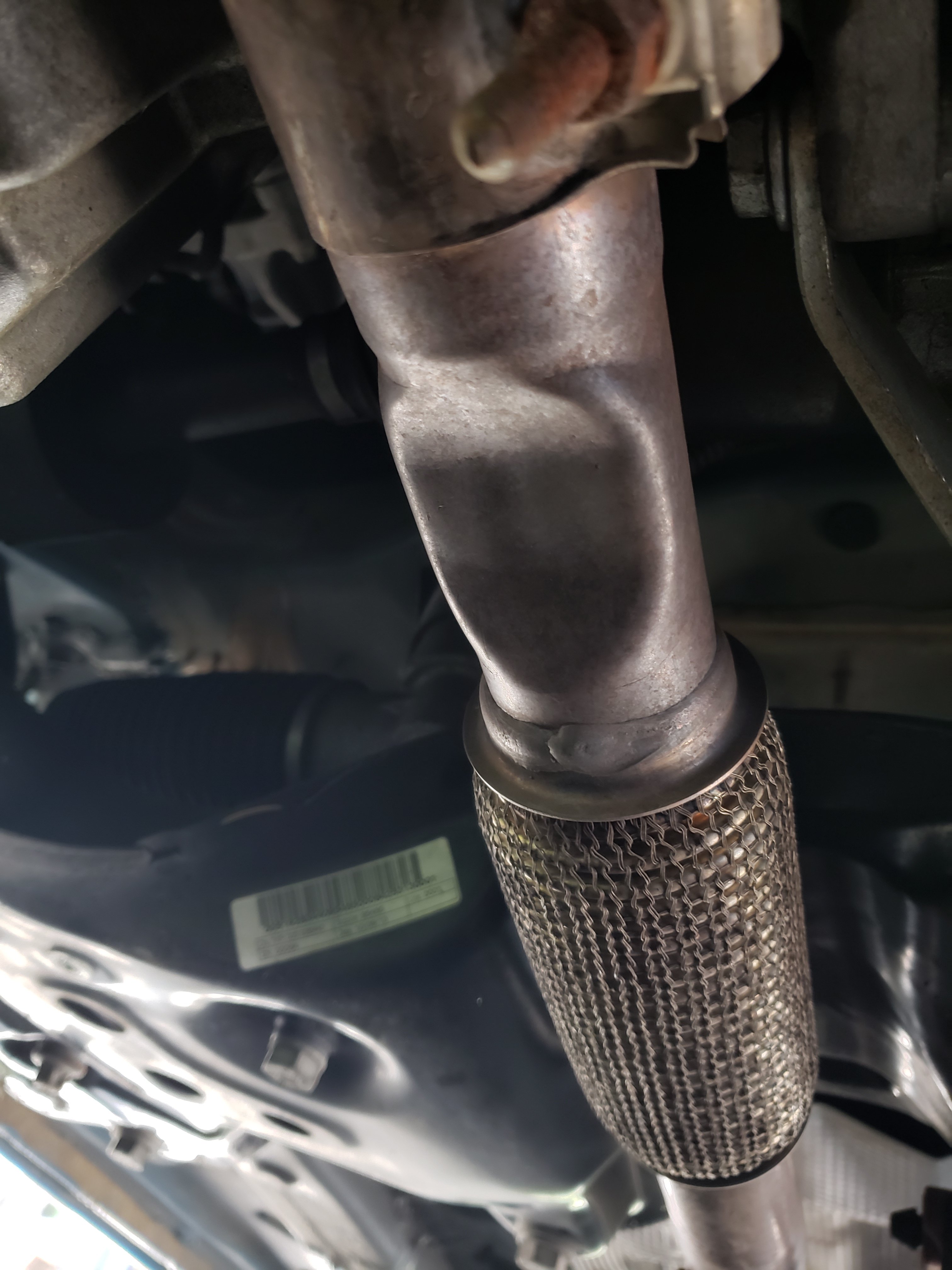

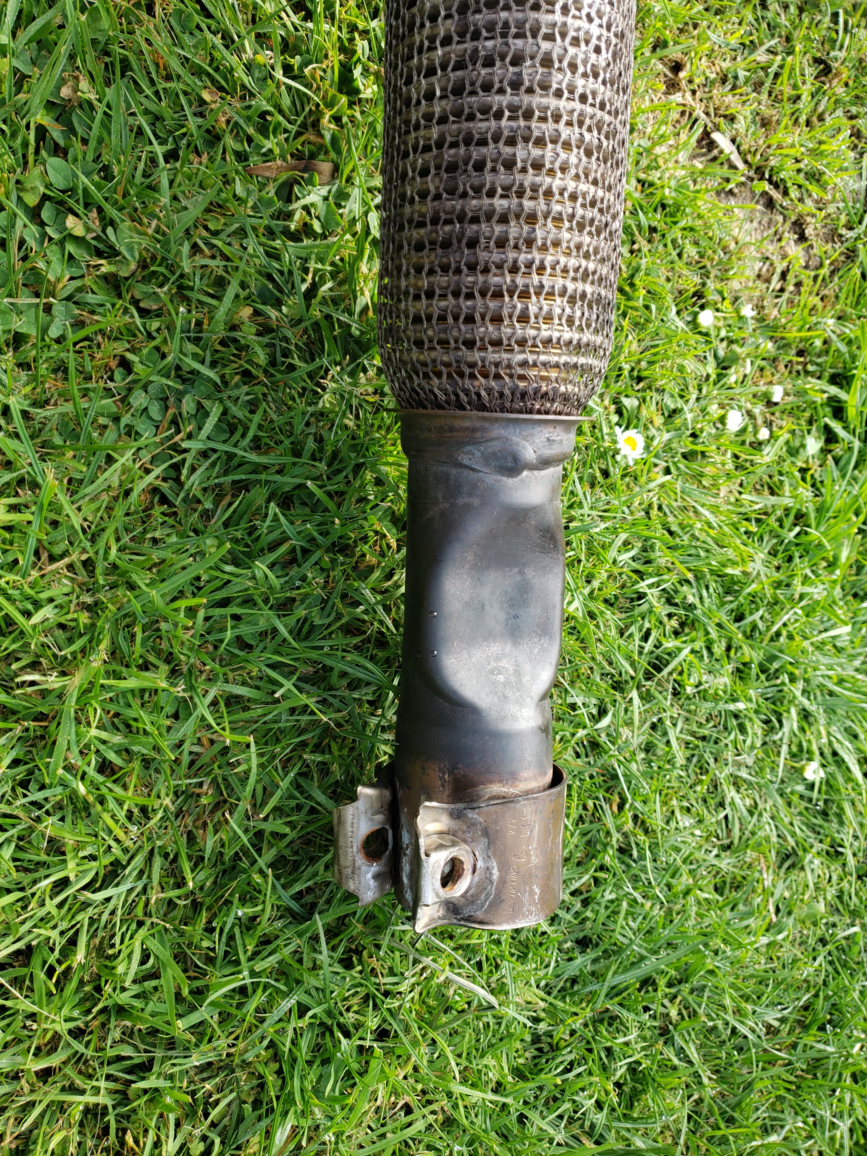

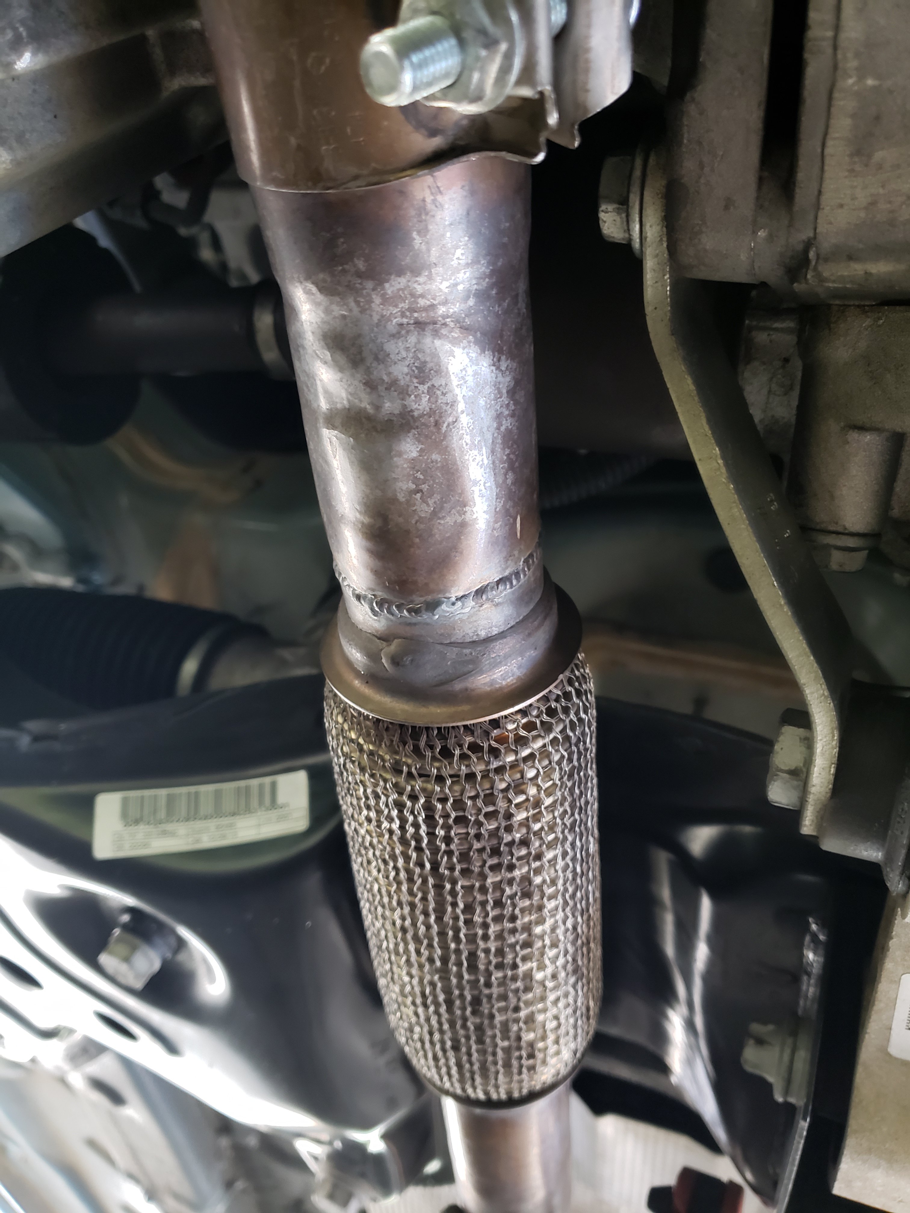

When I removed the undertray on the Panda for aan oil change I discovered a crushed exhaust pipe. I presume someone at a garage hoisted the car with the exhaust taking part of the weight.
I removed the exhaust today and cut the damaged section off. I then used a series of sockets to drive through the tube to bring it back to shape.
A trip to a local engineering shop and it's back on.
A trip to a local engineering shop and it's back on.View attachment 455478View attachment 455479View attachment 455478View attachment 455479View attachment 455480View attachment 455480
Good sheet metal/welding skills there!
