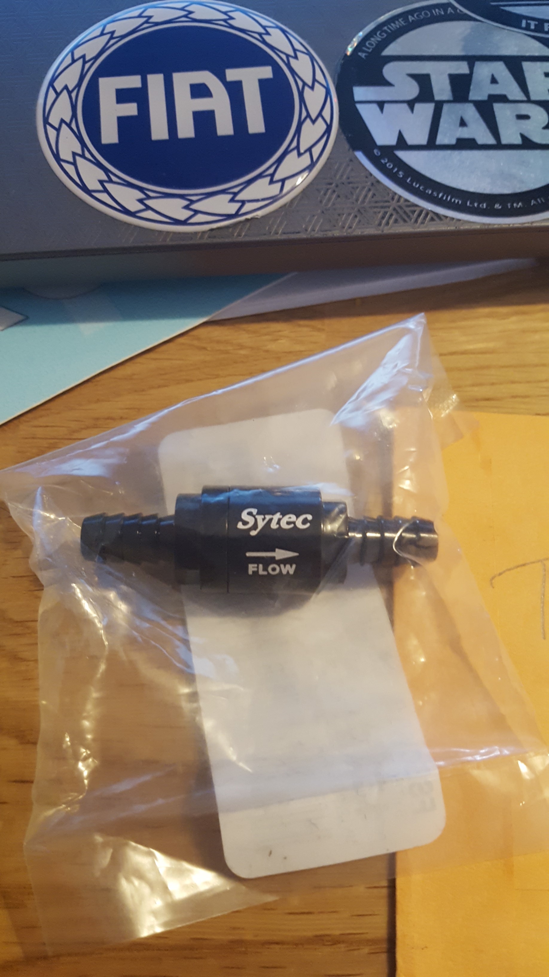

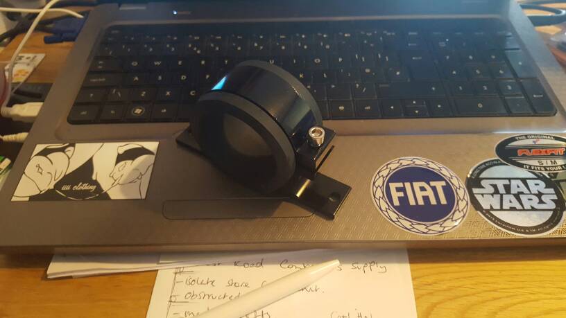

Another small piece of the puzzle, decided as i am using an inline pump i wanted a fuel check valve so the pump stays full of fuel even when its been sat a while - not a cheapy crap one from china this time - don't want this to fail lol.

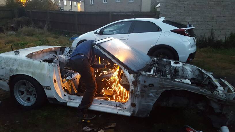

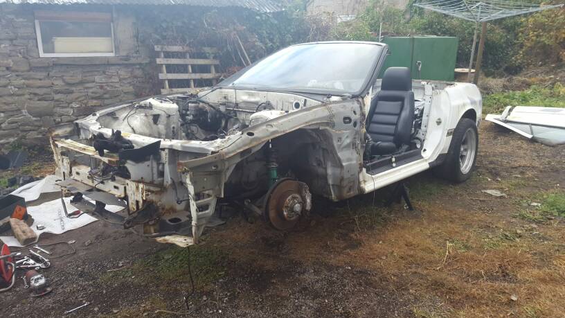

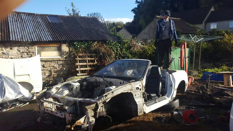

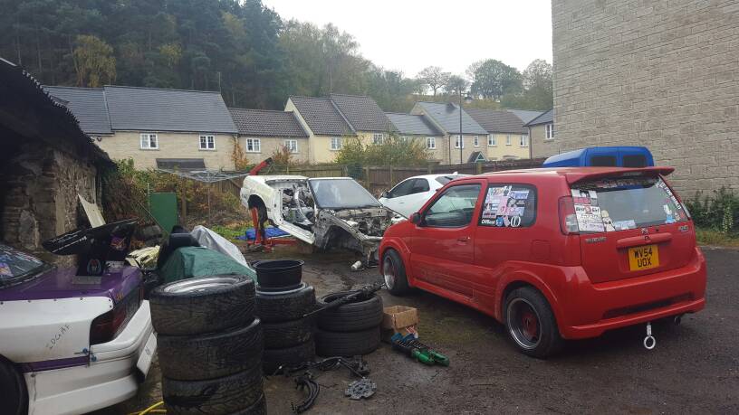

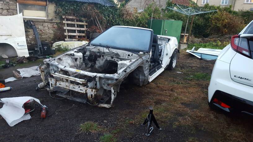

So I really should be getting on with the panda when I have free time. I know this but for some reason messing with other people's projects always seems more fun. So far this week I have fully stripped an fc rx7, its being collected by scrap man 2moro.

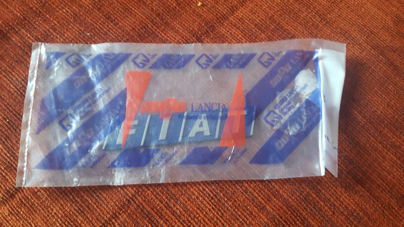

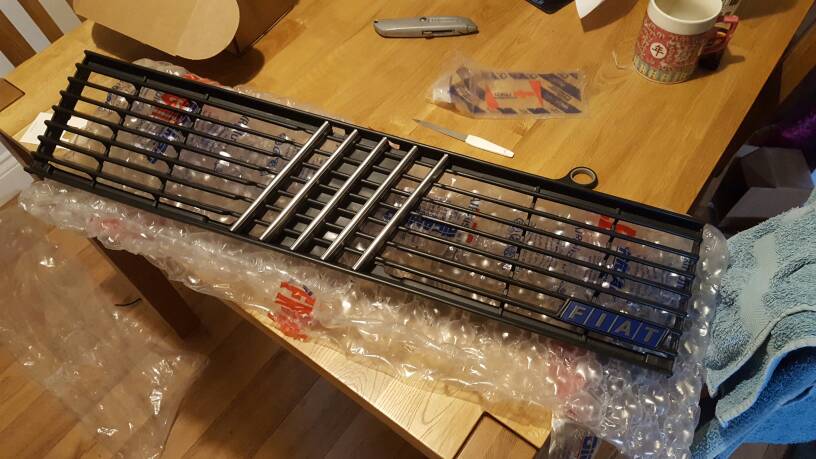

I got it from Ricambio.. They had it listed on their site for ages but not in stock, i dropped Franco a line about if they had some coming in or what not and he said they had a few but were trying to source grill badges for them before they put them up as in stock - said i could buy one without though and I just went and found a grill badge myself. Its not the best - i had to spend a few mins trimming some excess off from the mould but all in all it looks great. Not correct for the car but always been my fave style grill on a panda. Totally unnecessary purchase but an attempt to get my enthusiasm for the project back, need to get some indicator lenses now though - still not got any since i left the clears with you lol.
