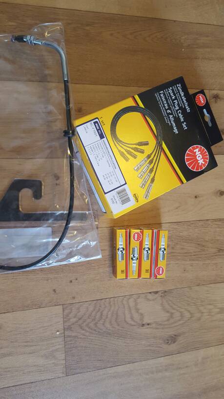

Another small order or bits made today.. gave my spare bit of vac line away recently to plumb up a mates boost gauge, so had to order a little bit more for the map sensor - will swap the fpr line as well from the old rubber one on there atm.
Also some silicone hose blanks, 2 for the barbs on back of the throttle body, 2 more for the coolant through throttle body (decided i'm just not gonna run coolant through it, not like i use it in winter anyway, but i shall cap them to prevent any crap getting in there incase i plumb it up later) and another one to blank the brake servo take-off on the inlet mani.
The panda heater line is not long enough to get to the pipe it needs to go onto on the inlet mani so ordered a short piece of pipe, found a joiner in my tool box i will use for that.
Took the tach out for Owen too, this swap to cinq dash cluster is gonna be pretty tricky looking at it but we will try jump that hurdle when we get there. I really need to spend more time getting this engine swap finished but i kinda lost some enthusiasm for it recently - clearly not gonna get to drive it before the gritters come out and so all forms of urgency have leaked out of me. I'm not giving up, far from it, just not done much recently and the future is looking pretty busy atm - so just doing little bits here and there atm. Oh i pulled the throttle cable out, mostly fitted new one, just need to push the bung part into the firewall properly, sounds way easier than it actually is lol.

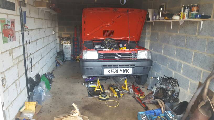

Right not really an update but it had got to the point that I could really get in the garage... I'm a messy worker...
So spent few hours yday pulling everything from in front and down side of Char out the garage, this meant I had space to move the engine crane down the back which is great, that thing was massively in the way.
Chucked loads of scrap metal in my neighbours car that is due to be scrapped. Put everything back in some kind of order. Can actually get to the panda now. Just get rid of the cardboard come recycling collection day. :thumbup:
SPACE! (well as much as you can expect in a little single garage)
Also got a pile of spares in a pile to put up for sale, will sort that soon but if you are after anything from the old engine drop me a PM. Main things at mo are ignition stuff, pointless dizzy with new cap and rotor, new leads. Also the carb and throttle cable, airbox, alternator, starter blah blah. Will sort some actual adverts sometime soon.
