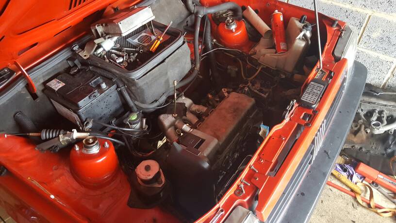

So i thought i would change the rubber boot under the gear lever and finally do the bushings and stuff, figured this would all be easier to get at without the engine and box in... So got under the car and of course 3 of the 4 threads just snapped when i went to undo them, obviously :rolleyes: Hey-ho, should be pretty easy to sort if by just drilling/dremeling them off the plate and using some bolts - could find any suitable though, garage is an utter mess!
So yeah, had little patience today, after that i shut the garage and left it lol.. hopefully i can find some suitable nuts and bolts to fix that without having to buy more. Once thats sorted I will bolt the engine back in (y)
OK so couldn't find any bolts the were the right kinda width and length and that I had nuts that fit them... ffs.
So decided to put engine in now and sort that out later.
And....
Ta da!
Feels like progress but scares me how much more I have to do when I try think of everything. Think I might need to make a list lol.
yep, your average joe would never know this has had a swap. I think the only thing that would give it away as not factory will be the air filter. I was tempted to try get a P75 airbox to see if it would fit - but i cannot find one. Well, i have found 2 for sale that are new old stock but they are silly expensive, like more that the engine cost. And then I found a few people breaking P75s online but none of them will reply to my messages. So I think its gonna end up with some aftermarket induction of somekind atm.
I may also have a 4-2-1 manifold lined up too, although not 100% confirmed as of yet as i don't have the money to pay for it currently :'( lol
well, i figured it would be really tight fit if it did fit so there is a plan in motion for non standard setup. I have since however come across a brand spanker genuine P75 airbox for a very reasonable price from germany - I have taken a punt on it. I am sure I can find someone who will buy it if it doesn't fit... Or i could space the engine down in the bay a tiny bit without much hassle if its really really close to fitting. We shall see, will keep you posted.

As I am here, tiny update - and it is tiny! Got new clips that hold injectors in fuel rail, rail fitted and throttle body bolted on - literally zero room at back of throttle body, from memory all the pipes its block access to are just vacuum ones so i can just cap them off - may or may not be room to get a pipe on the coolant pipe at the rear, time will tell. Did you manage to get the coolant going through your throttle body dragonman, or you just running without?
Got a throttle body 'bob' from a 899 cinq to go on top, will have to buy some silicone pipes to make an induction kit of sorts once i decided exactly how and where i want the filter to sit, could go towards passenger side and above the gearbox or the other way and behind drivers side headlight, i'm not feeling particularly decisive about that atm. Oh and not got the rubber seal that goes between the bob and the throttle body, the old panda car to airbox one may well fit but i think it will be too small. Another thing to add to the need list.
Other thing i noticed is the fuel lines, they are not metal lines under the car as i expected, they are them rigid plastic type lines all the way back bar the short rubber bits in the engine bay - not sure if they are gonna be upto fuel injection pressures - do later injection pandas have the same lines or do they have metal lines??

i used a lot of the pipes from the p75 i got the engine from. the throttle body on mine does have the coolant running through it. its not vital though, i only did it as the throttle body still had the pipes connected to it! more of a lazy anything all i had to do was use 2x hose joiners and just spliced it into the original heater matrix piping.
it is tight back there, basically touching the sound deadening. Like i say though, the 2 that i can't use are just vac lines i think - not checked but i believe one is meant to go to MAP and the other the small pipe on oil breather. I will just blank them and use a different vac source on the manifold.
I remember the rear coolant goes into one of the heater pipes, one that goes into the inlet mani iirc?
The one on the front of the throttle body, where you go that going? I know on a cento it goes back to the expansion tank, not sure about on the actual punto - been so long since i looked in a punto bay.
