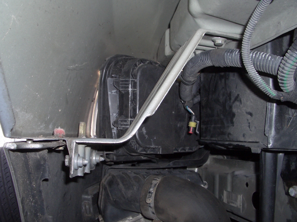

As you can see 3 obstructions stop you removing the cover:
  • Battery cage
  • Wing reinforcing strut
  • Intercooler

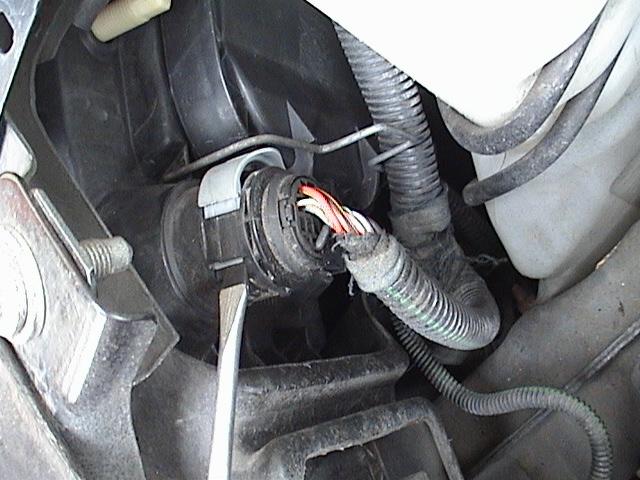

The round connector gives a lot more access, just push in this clip and it's a straight pull to disconnect it

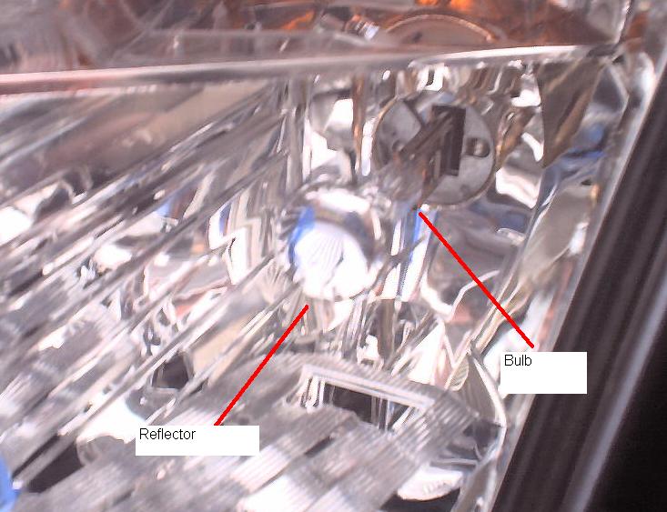

To be sure you have inserted the bulb correctly, look through the front lens before you put the spring clips on and make sure the bulb is aligned directly behind the reflector
It always pays to check
