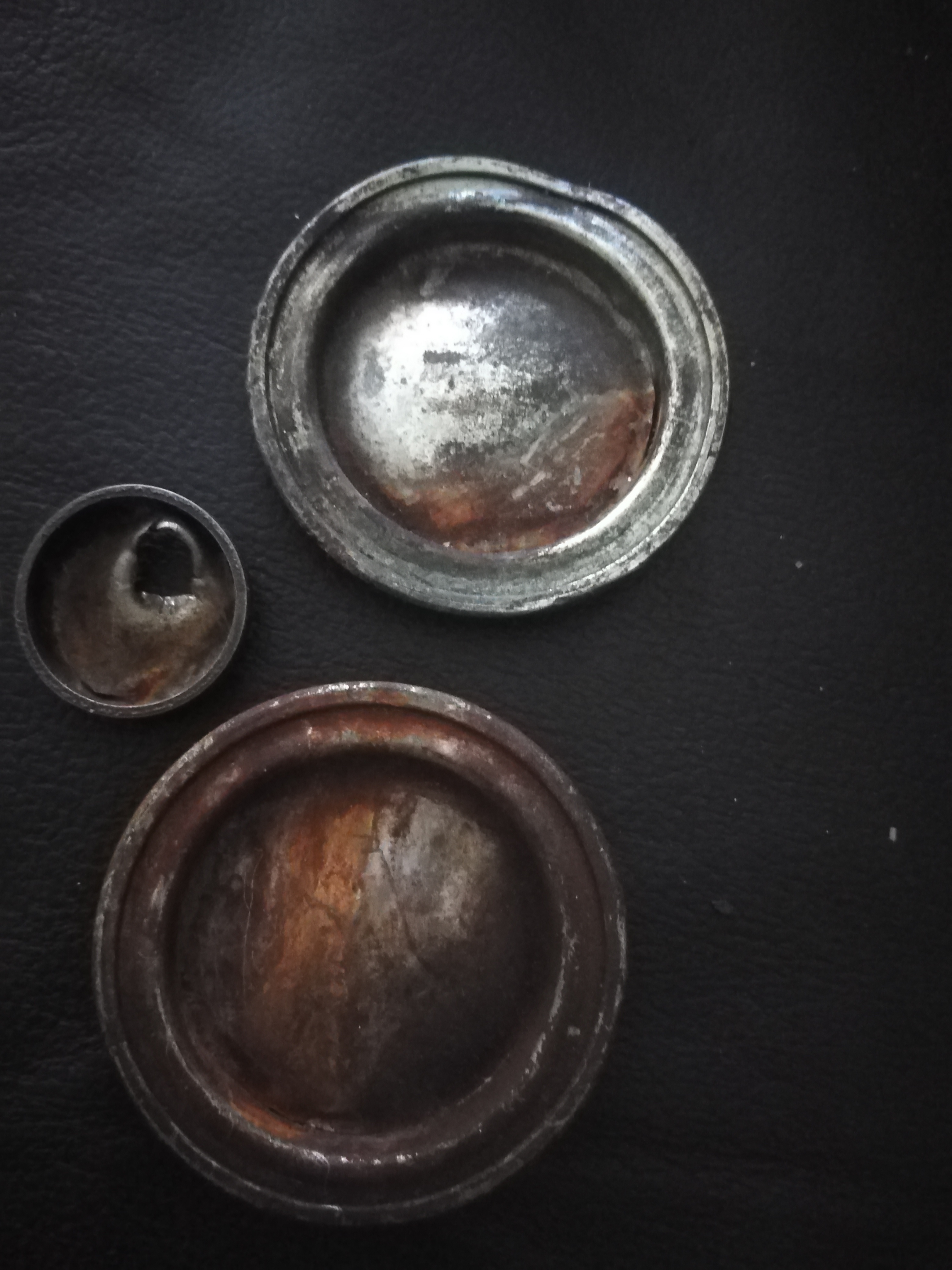

Here's some core plugs

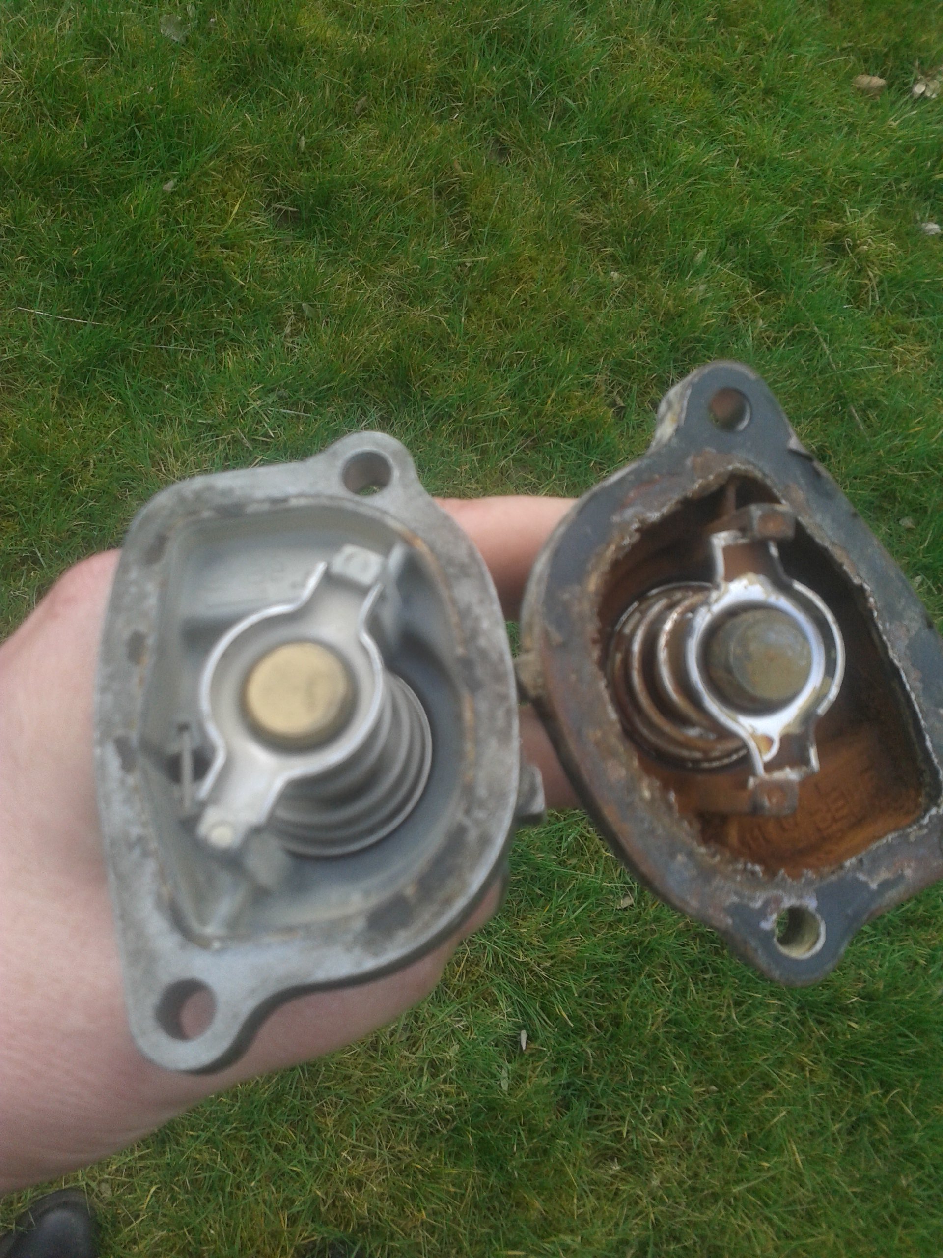

And some thermostats
Along and hoses and general servicing
