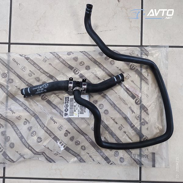

Seems that the original part looks like that:
And my question is: if there are 3 different hoses, a T-junction and 3 metal clips, why FIAT is selling it as a single part? :D Of course, there might be more than one of these damaged, but most of the times it will be only one of them...
Beats me, I guess it's such a simple assembly they just have it replaced entirely in any case.
