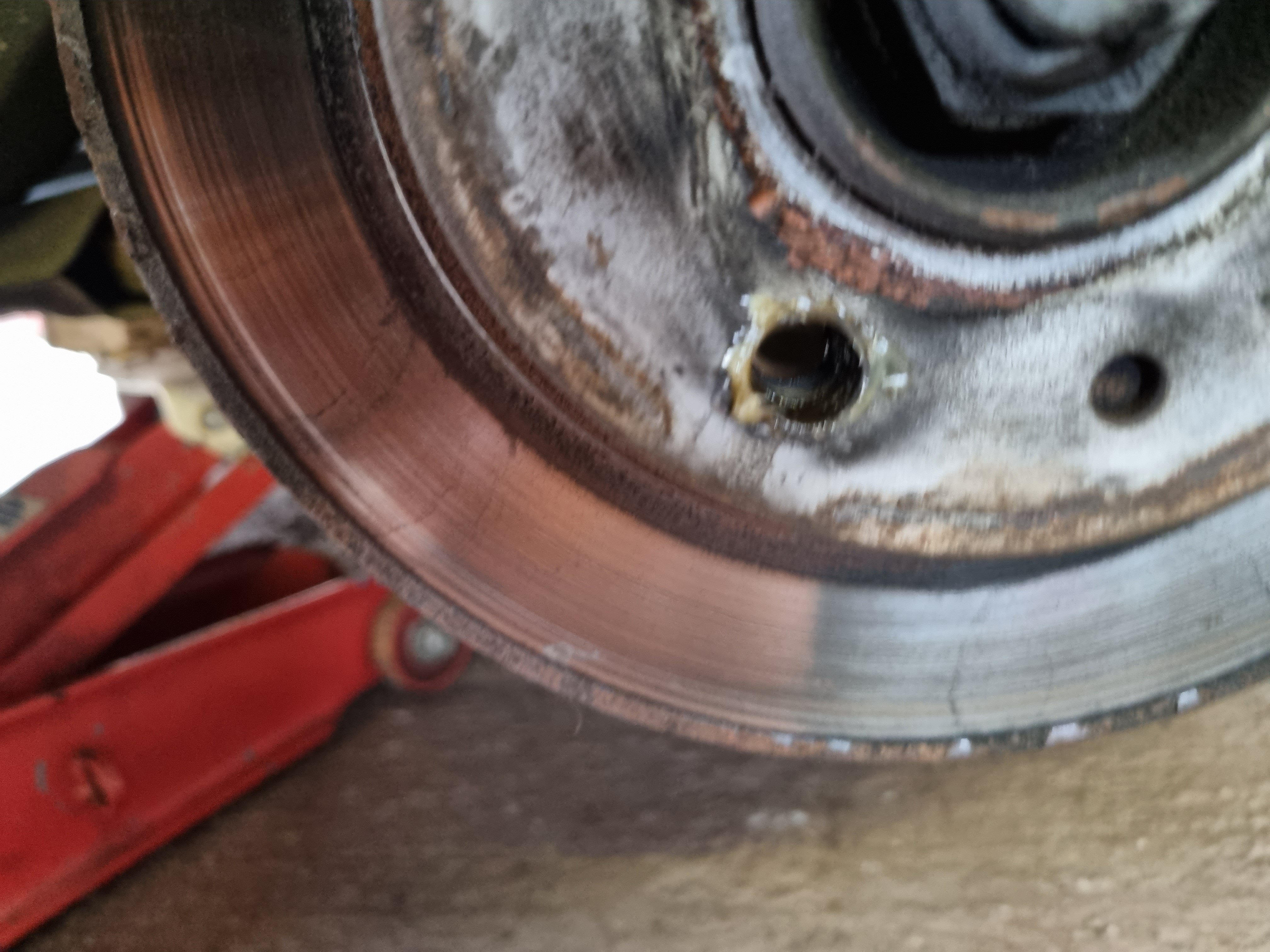

is it cracked ?
photo 3
12 o'clock
could just be the way its photo'd
These are a couple of photos of my 04 plate 1.1 Active, changed the pads today and also wondered whether these were hairline cracks in the discs??

Surface micro cracks

Are normal and show the brakes have been load hard at some time
As long as they ring true and there are within thickness I would be concerned. However the photos aren’t great, I might change my mine with better photos
Thanks Koalar, I've had to "stand" on the brakes once or twice so they have had a few hard loads but still work fine at normal speeds!
I'll just keep an eye on them, modern pads are heavy on discs nowadays anyway.
I think I agree with Koalar. Looks very like the "standing" marks pads tend to leave on discs. I think if you were to check again after a good run that you'd find they are rubbed out. If you're really concerned take the disc off - you only need to undo the two carrier bolts and swing the entire caliperand carrier assembly out of the way - remove the disc from the hub and hang it up on a bit of wire. Hit it gently with a hammer/spanner/whatever and see if it "rings". A dull clunk indicates it's cracked.
Mind you your discs are a bit marginal in my opinion. They're Ok-ish right now but will be pretty rubbish by the time a new set of pads are well worn?

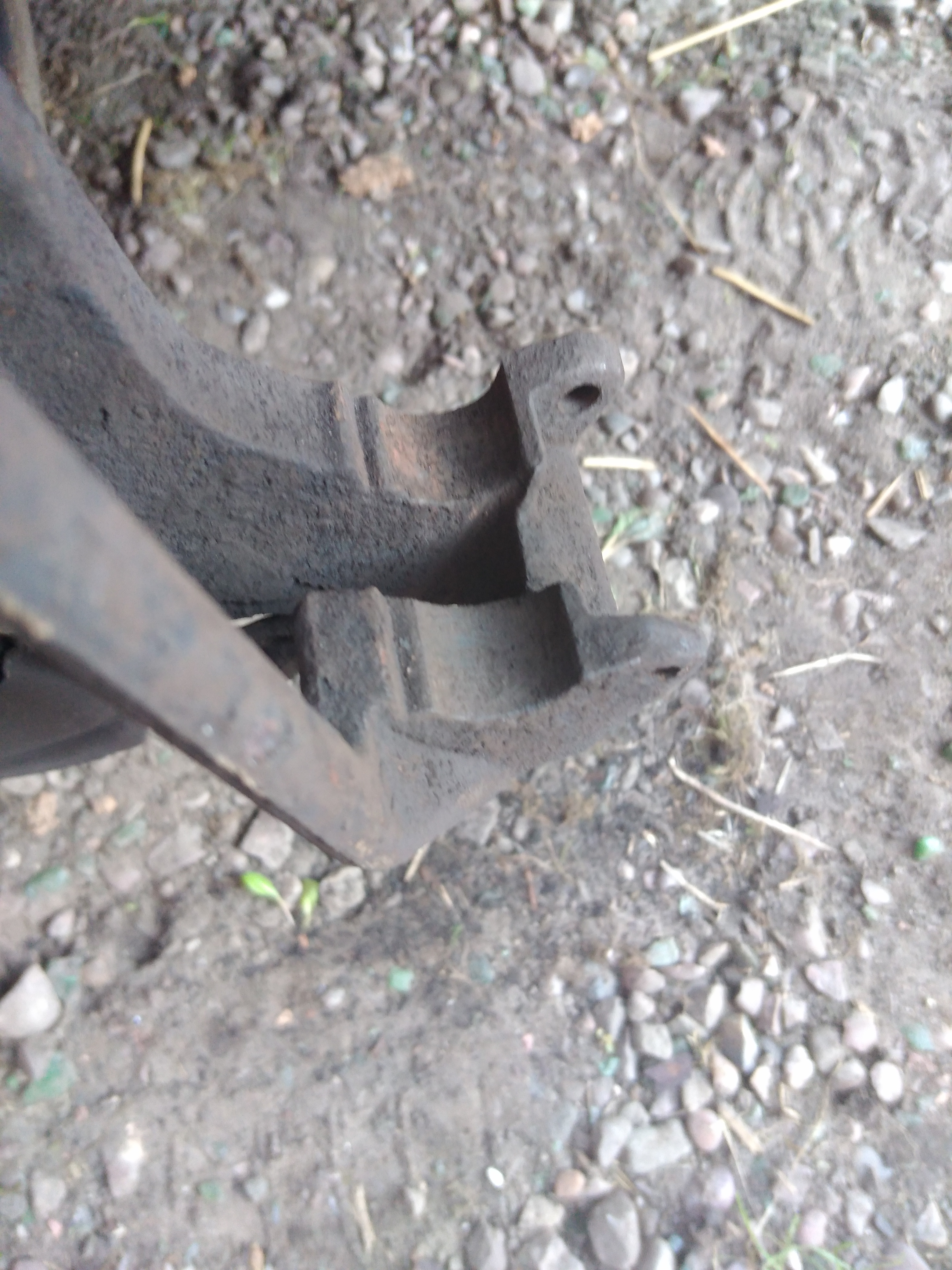

Here's a picture I took of my boy's Punto O/S/F brake when I was servicing it the other day:
The discs and pads were new about 5 years ago and the pads are now down to their lower limit, although the wear light has not yet illuminated. The discs themselves still have sufficient thickness to go for a while yet but there is significant lipping visible and, if you look at the top, to the left of the caliper carrier, you can see a couple of faint lines (much like yours). However I also see some strange marks which seem to be imperfections in the surface of the disc itself which I'm not all that happy with. If the disc faces were unmarked I'd probably take a chance on just fitting new pads but I don't like those "spotty" marks and as my factor has quoted £90 all in for a set of good quality discs (2012 "new Punto" with vented discs - ATE calipers) and pads, I think I'm just going to do discs and pads on both sides. Going to do a search on the internet too just for price comparison but I'm happy to pay a small price premium for the convenience and surety of buying from my friends at the local factor.
Edit. Ps. Wondering also what the inside faces of your discs look like because the insides are often more corroded than the outside faces. You can see from your second picture that there's a goodly band of corrosion around the hub which has reduced effective braking area. If the inner faces are worse than this then I'd definitely be fitting new discs.
A pair of Mintex solid discs for Panda front brakes cost £25. But your third image is the result of poor maintenance. Sticking caliper slides will not allow both pads to grip and release so the disc surface gets pitted with rust. Ultra careful driving actually needs at least as much (if not more) brake maintenance than driving with lead foot.
Neither the slider or pistons were stuck. Sliders are always cleaned and greasd as discs are serviced. These discs less than a year old. The TA is identical but at 12000 miles its not having any parts! l have cleaned its discs and flatted the pads to match on coarse emery. Daffo is getting new calipers, sliders hoses and discs this next time and we will see iif they last more than 6 months in good condition. Daugters use of the brakes is fine judging by the not heavy discolouration of the wheels with dust. May be a fraction lighter use than me. I do go a bit faster on long trips and deliberately give the brakes some work regularly. I just find rust forming on the edges of the wearing area of the discs hard to understand when the car is properly maintained, and in daily use. She does 30 to 50 milesxa day 6 days a week. The brakes are in fact given vastly more maintenance than specified. Piston movement is verified and i work them the full range of movement each time they are checked and bleed if required, fluids always done biannually. Sliders always cleaned and greased. My earlier years driving may just have avoided this due to very hard use. I do recall one mechanic's expletive when he saw my BX turbos discs which had turned blue and were on the point of disintegration due to radial cracking. Even that used to suffer rusting rear discs but nothing like the pandas. Oddly the 2014 car is way less affected. The calipers look similar to the 4x4 but its brakes get very very light use. Her indoors doesnt use brakes to an astonishing degree. The discs are however much more worn, but are still the original ones. Ditto her pads.
