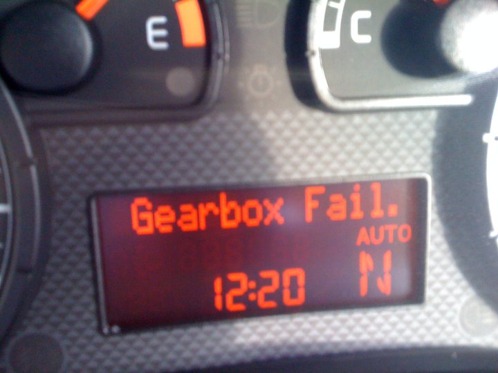

I bought my 05 plate Panda dualogic from Wentane Fiat on Monday 25th October

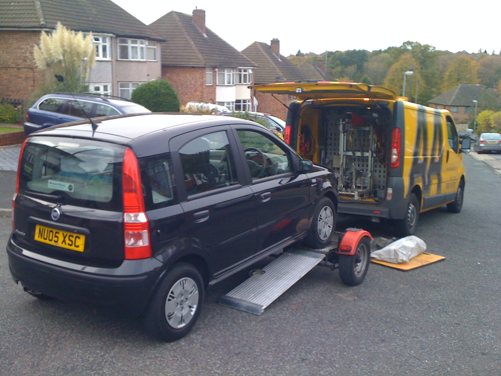

Saturday 30th October it had broken down and was towed away to Norris Brothers Fiat

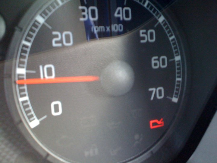

The car had lost all power whilst going up a hill, it'd been in gear, then all of a sudden was in N and lights and buzzers everywhere
Quite dangerous really! It was just revving, I put my foot on the brake, and it allowed me to select 1Auto
Got the car back from Norris Brothers on Wednesday night who informed me it was the brake switch which was incorrect and sending signals to the auto gearbox that werent right
They also said that it wasnt covered under FIAT warranty, but I'd spoke to Wentane who said they were happy to foot the bill whatever the cost
Seems to be OK now but it's knocked my confidence in the car
