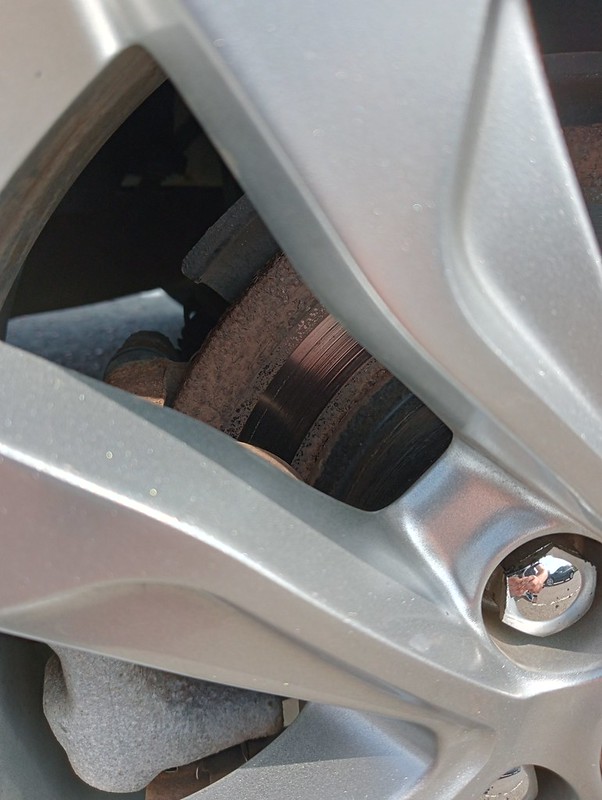

This is what the ring of rust looks like now. I have noticed no decline in braking performance since I got the car. Neither has my son who also drives it. The braking feels fine.
That disc is in a pretty poor state. You may think the brakes are Ok but you'll get a shock if you have to do a bit of serious emergency braking. It's only the bright shiny bits that are doing any braking so i guess only about 50% of that side of the disc is effective. It's not unusual to find the back of a disc is in worse condition than the front so I think someone should take a look at the other side of that disc right now. If it was my car I'd be putting new discs and pads on it tomorrow.
Sorry if that sounds a bit alarmist and it is a bit difficult to give an opinion based on just one picture, but i really don't like what I see here. The whole of that face, including the rusty bits, should be bright and shiny.

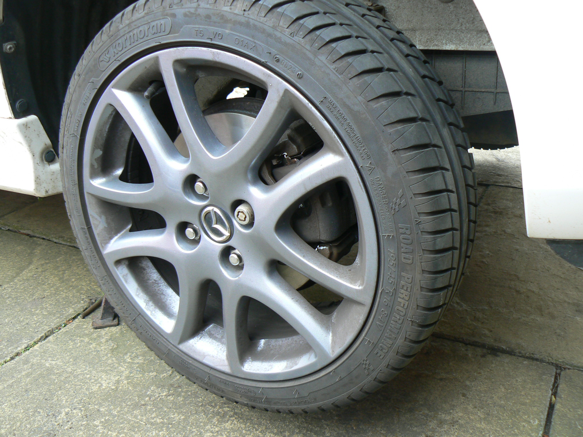

Here's the one on the Mazda:
and with the wheel off:
Of course these pictures are of a brand new disc just after fitting but a used disc in good condition shouldn't really look very different. Yes there might be a bit of a lip on the outer edge and a bit of rust around the hub in the middle where the wheel studs are, but the bit where the pads grip the disc face should be bright and shiny.

Yes 100% agree with previous comments, also I would say looking at the rust groove in the centre of the braking area, in it's past the brake pads have been allowed to go down to the metal.
The rust area on the edge is more common and if not attended to gradually takes over the contact area reducing efficiency, but the bit in the centre is purely bad practice when the brake pads were so badly worn to the metal they were replaced but not the brake discs which should have been as well.

Emergency braking has been fine. From the time I got the car, the rear pad does not sweep the whole of the disc. The first service I got included skimming the rust off, which the dealer said was normal. They charged me £70, it did nothing to braking performance and the rust was back within a week.
I will get it checked.
Do others have the same ring of rust on their rear discs?

Please don't think I'm in any way "having a go" at you. I'm genuinely concerned about you running about with discs that look like that - if the other 3 are in similar condition the vehicles braking must be impaired and you run the risk, if in an accident, of the vehicle being declared unroadworthy which would cause you no end of problems.

An update to the thread. After a few weeks of checking every Tipo I could find, realising many have drum brakes, not discs, I saw only one other with a ring of rust, that was for sale at Arnold Clark Jeep dealership, Linwood. The salesman who saw me and obviously thought I was interested in the car, said he was not aware of any issues. That car's ring of rust was not as large as mine, so I did go ahead with new discs and pads.
It has made no noticeable difference to braking performance, but if I had left it, the garage I use would have failed it on its next MOT. I wonder if an underperforming disc is as good as a drum brake and the Tipo is also available with drums.
