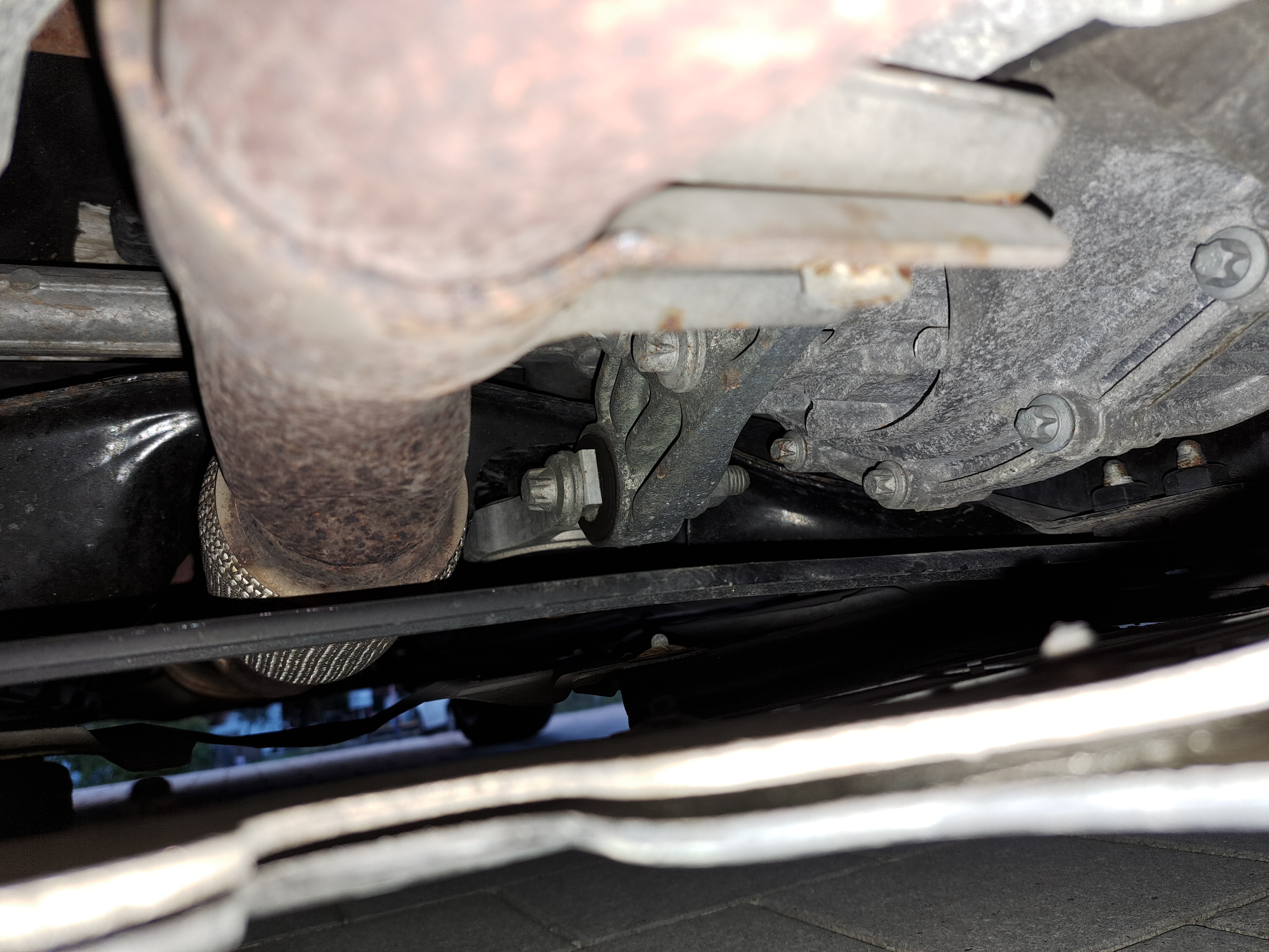

before i buy the car, i got under it. exhaust pipes are well covered in rust. is that normal? does that mean expensive repairs at some point?
year of construction 2019, 60'000miles, 10'000 euro
FIAT Tipo 1.6MJ Station Wagon Lounge DCT
I hope it's just an outside layer of rust on the universal joint of the steering.l, or would you say it is damaged?
are these rust spots a problem at the inspection?
if this is ok, how do you rate the offer?
is it possible to fit a towbar?
thanks a lot for your support!

Rather normal, rusted before it ever left the factory. Make sure it's not rusted all the way through. The rest I cannot tell you about, I would think in Switzerland to be more honest then in the states, over here we bring condoms when we buy or get it serviced. A word of caution as you are being over run by the muzzies, don't ever trust those rats.

The exhaust I would say is normal.. It's 5 years in service 😉
Steering joint.. That looks "rusty", but not damaged
It may be that the car had wet carpets a lot
Cleaning / Valet.. Or lots of Snow..?

thanks for your inputs. is there a way to
  • check if pipes are "rusted all through"? didnt sound particularly strange.
  • remove rust on pipes / steering joint; i'd like to prevent bad surprises at the inspection.
thanks
