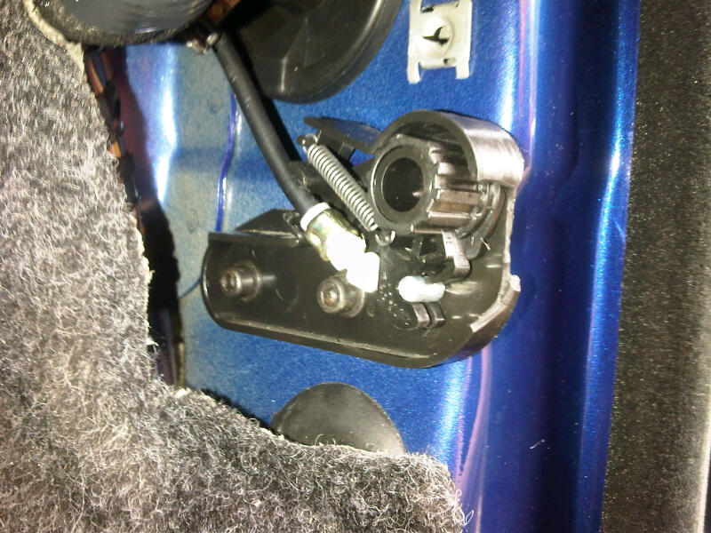

Looking for a bit of wisdom to get around this one...I noticed when I first got my Stilo that the bonnet release wasn't fantastic, but I've been gentle with it and up until a few nights ago it was fine.
When I last pulled it though, the catch did release but there was also a snap. Today I decided to uncover the damage...
Removed the door sill to find the following (images 1-4 below).
Images:
1) The catch with the sill/handle off
2) The two shards of plastic I've managed to recover
3) Where the plastic should fit ;) (less my thumb!)
4) The extent of play in the mechanism
From image 4 - I get the impression the actual release cable may have stretched somehow - no idea why. Car is still under warranty from when I bought it but do you reckon I'll be able to get hold of a new part myself (the plastic door fixing) or glue the existing one back together? I anticipate it being pretty expensive to fit a new cable altogether (even if covered by warranty).

The only thing is if you look at image 4 specifically, the handle is turned and the catch holding the release cable is actually outside of the housing attached to the body. I'm pretty sure it shouldn't manage to go that far before the bonnet opens - which is what I think is the problem?

Cheers - part no. was right - ordered it, arrived next day and fitted, BUT.....
I really think that the cable has stretched somewhere now. I'm not sure how, but going back to the first few pictures (4th pic in first post) the mechanism actually breaks free of the housing (where it was split).
I fit the new housing, attached the cable and then tried to put the handle in the right place only to find firstly it was at an angle (i.e. not facing straight down) and then when I did turn it, the bonnet never opened as there wasn't enough space to keep turning the mechanism to pull the cable.
So my question is - is there any way to tighten the release cable? Either at the front of the car where the catch is (I can still open the bonnet but have to pull the cable myself inside the footwell) OR will I have to get a garage to look at this? I'm still under warranty, and this is by no means wear and tear, so I ain't payin for it! ;)
Thanks :)
P.S. - part cost £10.30 inc vat, + £1.50 p&p - so £11.80 all in. Not bad.
I took these the other day - this is what I mean (as I'm useless at describing!):
The first pic shows the handle at an angle. On the little cog on the mechanism of the housing there is only one angle the handle can fit at. So I can't move the handle round any more...
If I try and push the handle towards the bonnet then the cable actually pops out where it enters the housing (the metal part at the edge) and when I try and turn it to open bonnet it never goes far enough.
The second pic shows the new housing in place, with everything looking OK. Apart from the fact it doesn't open :(
The third pic attached (although done in paint :yuck:) tries to explain how the cable pops out if you push the handle towards the bonnet a bit better ;)

Well i can see the problem , you have the cable incorrectly fitted.
The white piece on the end of the cable has a groove round the end of it that fits into the grrove on the piece that is screwed to the car body, does that make sense?
