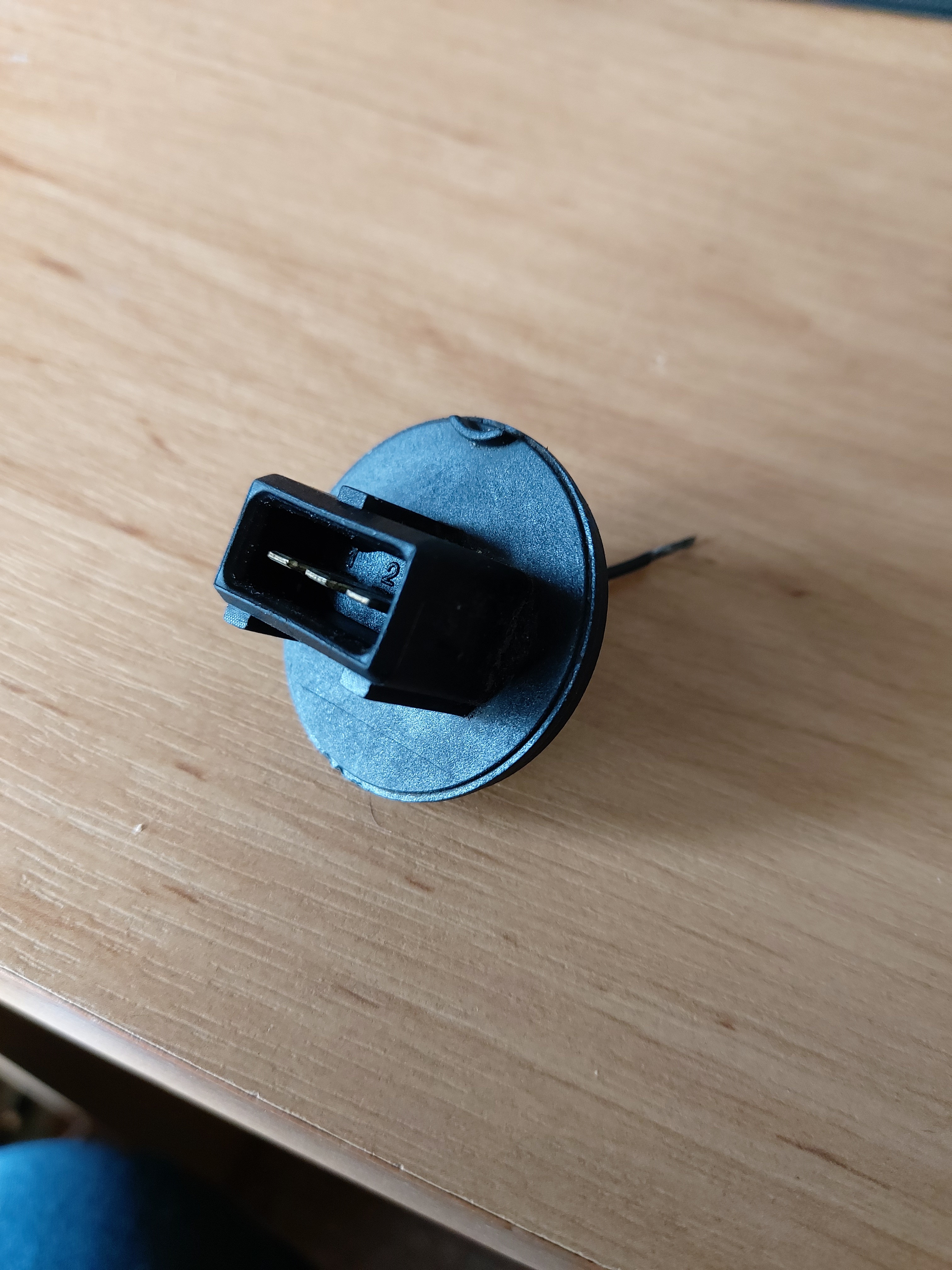

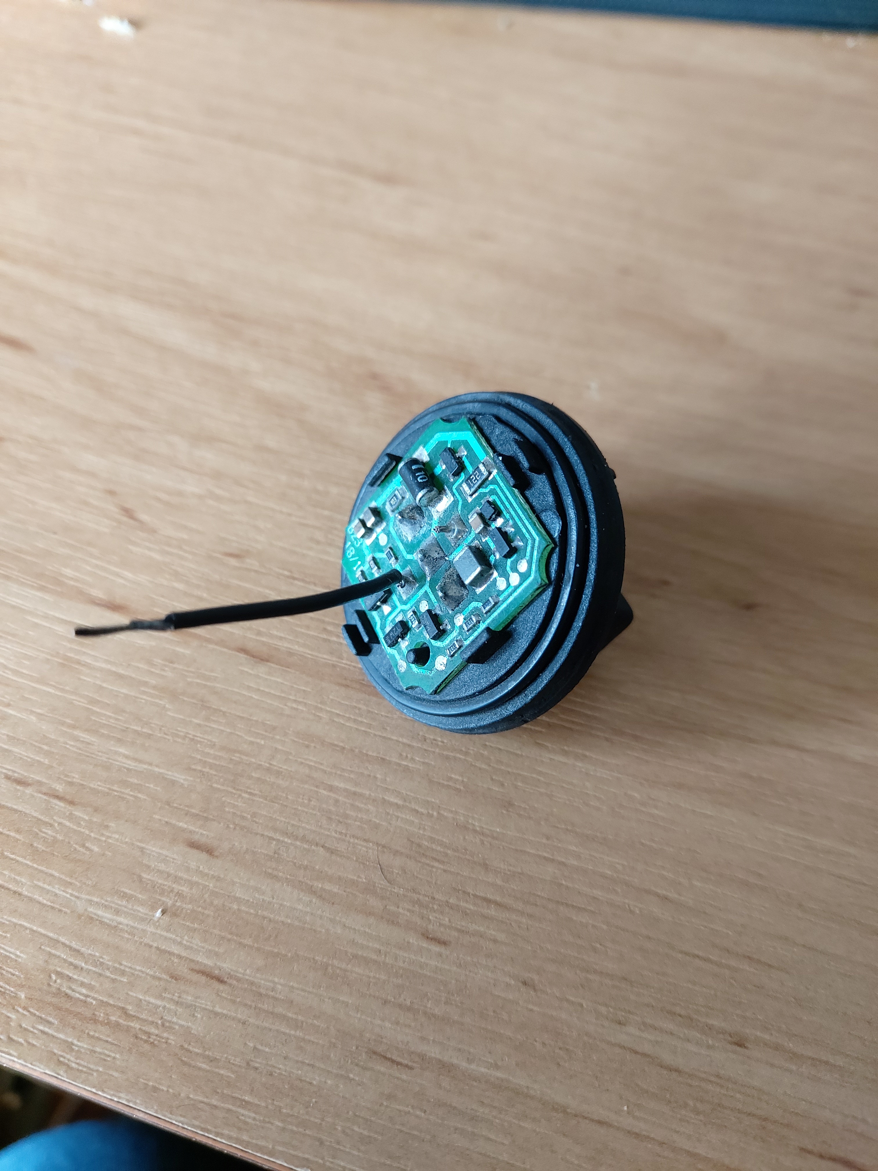

Been having problems with car struggling to start lately, it's a 1.9 8v JTD, battery is fine, starter motor is new. Earths are all good (checked). When checking everything I did find a sensor/plug that's been broken (I assume garage did it when they did some work last week and have covered it up).
It's connected to about a 4-5 inch length of wire that comes off the main wiring just above the gearbox/starter and goes around the right side of the engine and under the EGR valve, but for the life of me I can't see where it's broken off from.
Car won't start at all, not even turning over the starter so I'm thinking it's probably timing related. No errors on the dash.
Pic below is the part of the sensor that was connected to the wire:
Any help on where it goes would be greatly appreciated, car isn't near my home at the moment so taking any more pics is going to be a problem.

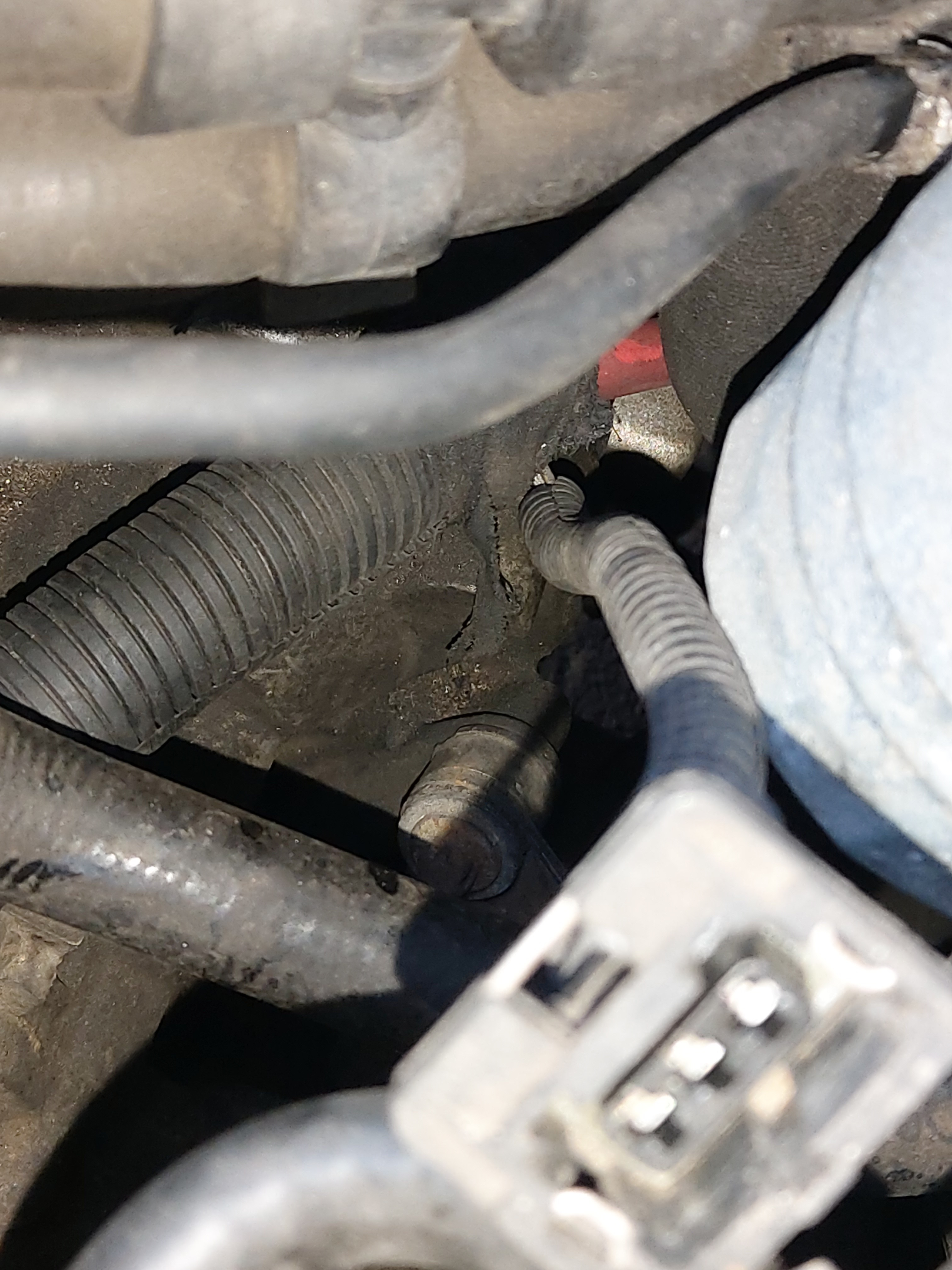

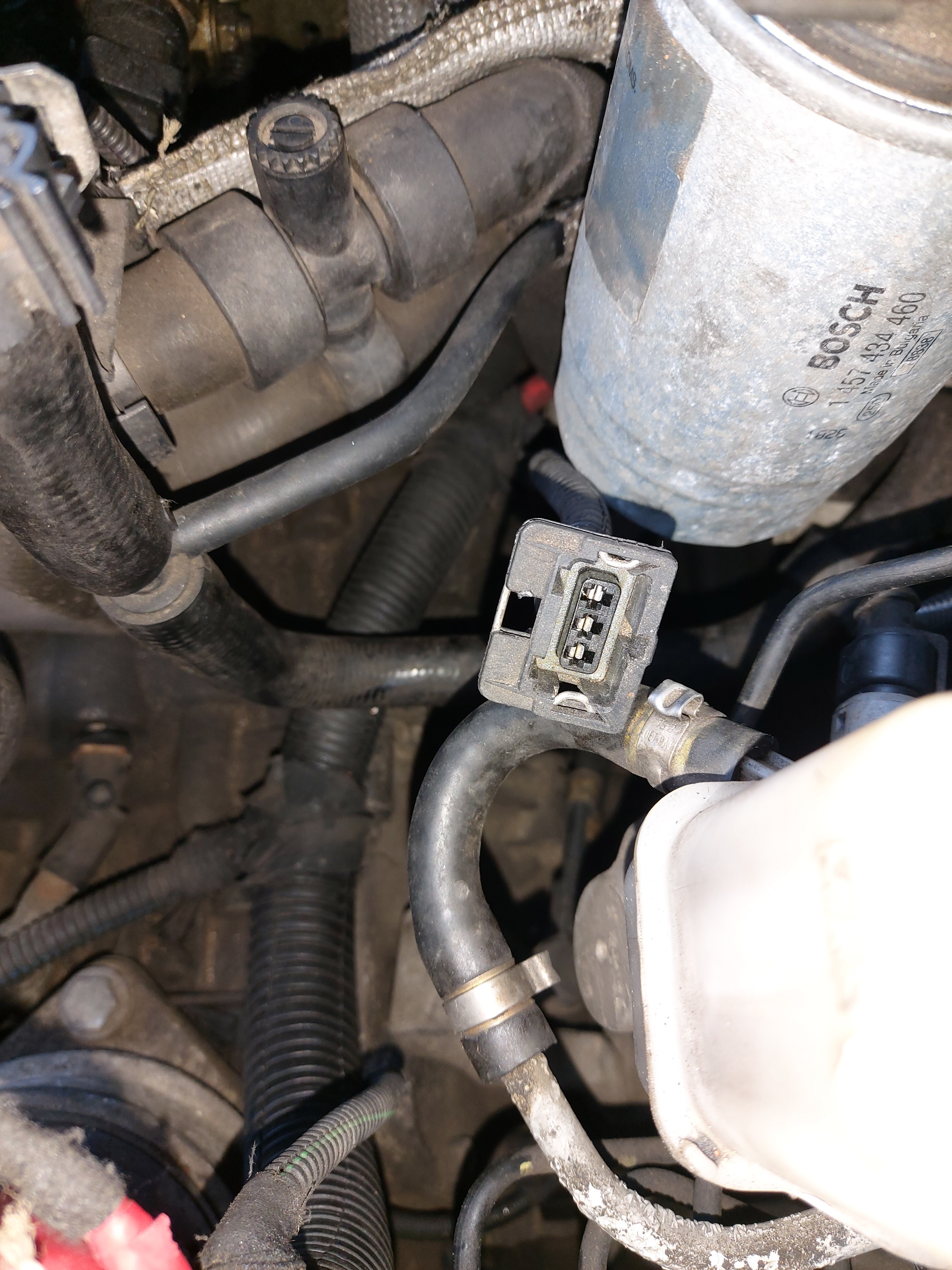

Luckily one of our engineers is at work today so he's taken a few more photo's for me. The wire in question sits pretty much directly under the Fuel Filter on the JTD, see pic's of connection and location. The main wire it comes off comes from the engine bay fuse box (not the one on the positive battery terminal):

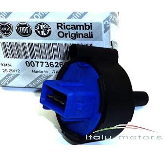

It's part of the water in fuel sensor. Fits in the bottom of the filter.
