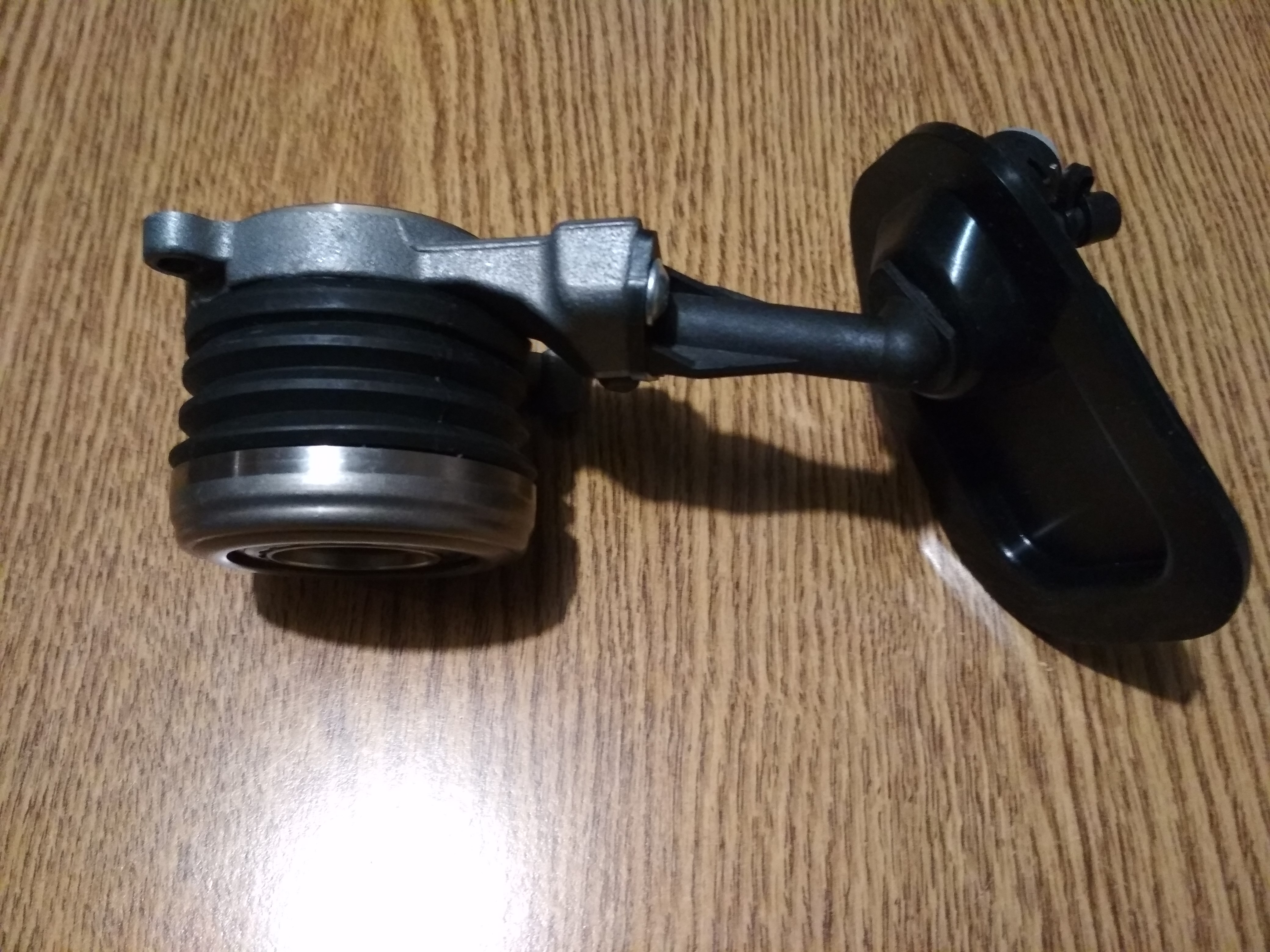

Hello everyone, for now I don't have the problem, but in anticipation I bought this bearing on ebay, they assured me that it is also good for the selespeed as it has been reinforced inside. However, it is necessary to make the holes for the fixing of the sensor.
The original spare part cod. 46762373 seems to be missing.
A letter should be made (but with a large number of users) for Valeo or Fiat to reproduce the original component given that the car is starting to have historical relevance like Abarth.

Wow well done, this could be the answer to a maiden's prayer :giggle:, inasmuch as if it fits it will help a number of folk out.
However, being 'assured' it will fit and actually fitting can be 2 different things, and fitting with some fettling/modification, a 3rd :unsure:, although coming from Italy it does give good optimism.
Be useful if there was a full comparison of a 'proper' one and that one to see what the differences actually were :cool:.

A very precise question and answer those who know. Is the pressure on the bearing of the manual version the same as the Selespeed version or not?
