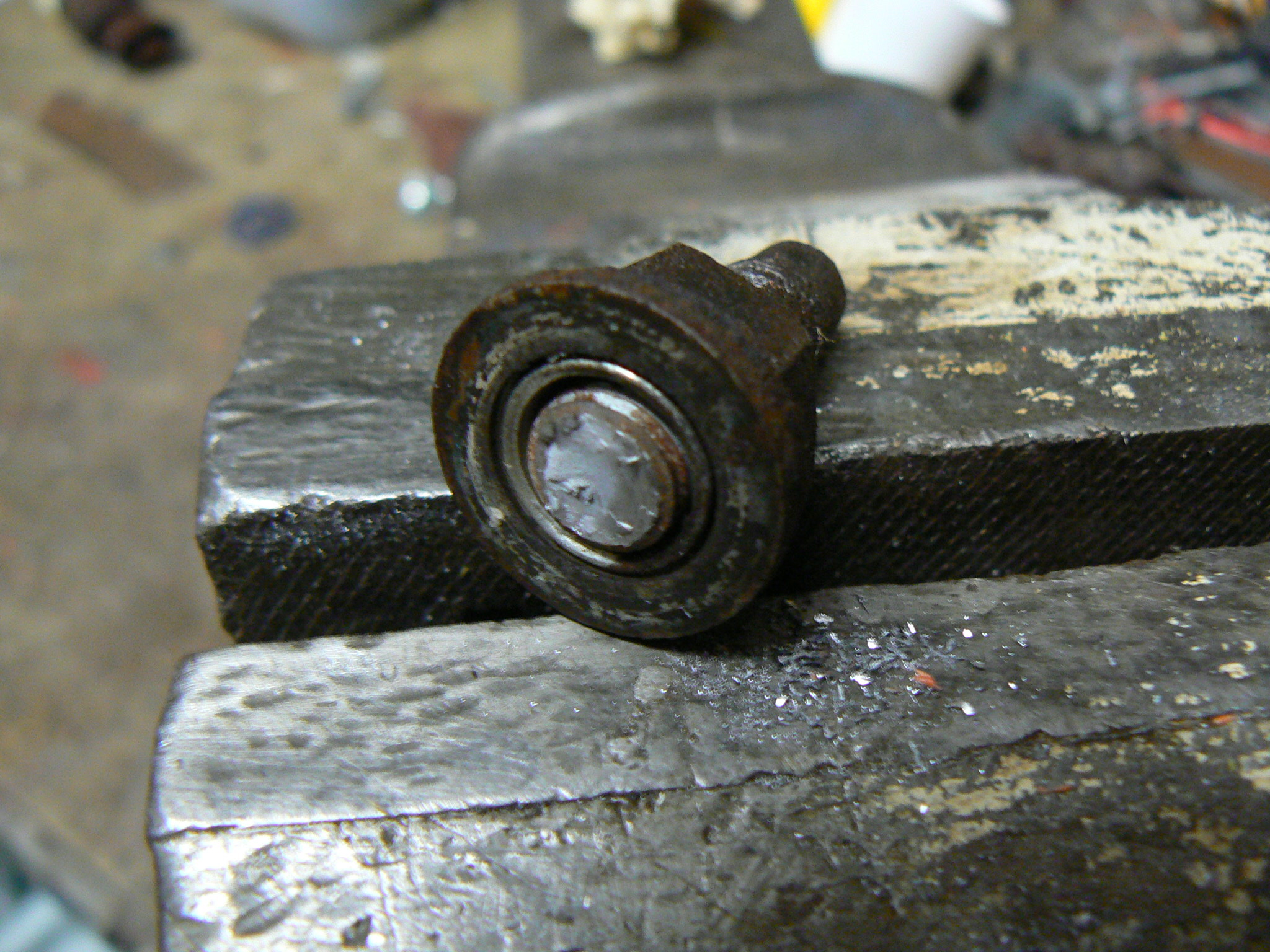

You can see from the next pic that the thread really looked quite good (after being attacked with the wire brush) but obviously just really corroded into the threads.
I could probably get them to undo with heat but I prefer to just get 4 new bolts and nuts for safety. I'm going to try my big CP "rattle" gun on the next one just to see if it will move it.

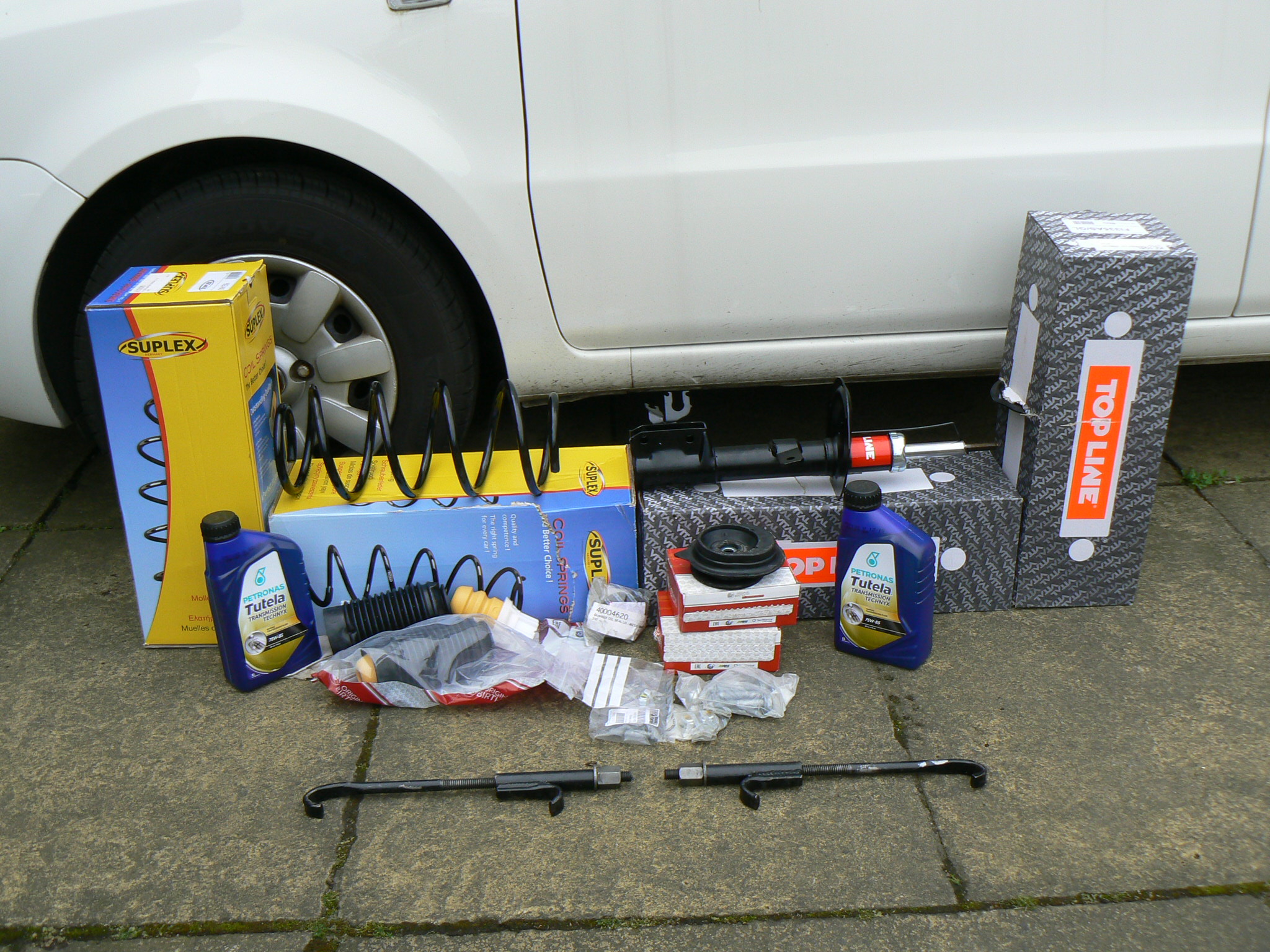

Now it's getting exciting! all the bits arrived yesterday at 15.45 - The order (S4p) was placed around tea time on Saturday and arrived, remember I'm away up here in Edinburgh, 15.45 hrs yesterday (Tuesday) so just 2 working days, pretty good I thought. - I just couldn't resist laying it all out and taking a picture for you all!
2 struts, 2 shiny new springs, 2 bump stops/gators, 2 top mounts and a load of fixings. Also the N/S gearbox driveshaft seal (which is starting to leak). You'll notice I decided on new oil for the box guys, just decided not to take the chance. (I'm going to save the drained stuff in a clean empty engine oil container and let it settle for a few weeks - thanks Dave. Then suck off the top 3/4 of it and keep for topping up when I do the seal on my boy's Punto) I looked out my home made spring compressors too - they are the metal "hooky" things lying in front of the parts - and gave them a quick clean and oil (haven't used them for maybe 6 or 7 years) You'll notice they are true "suicide" design with no safety retaining clips but I made them maybe 40 years ago, used them many times, never had a problem but I am very careful with them.
So now the strut top nuts are gently marinading in Plus Gas as are the 3 remaining pinch bolts on the bottom of the legs although they can snap for all I care as I've got 4 new ones. The nuts with their captive washers are a wee bit pricey aren't they?

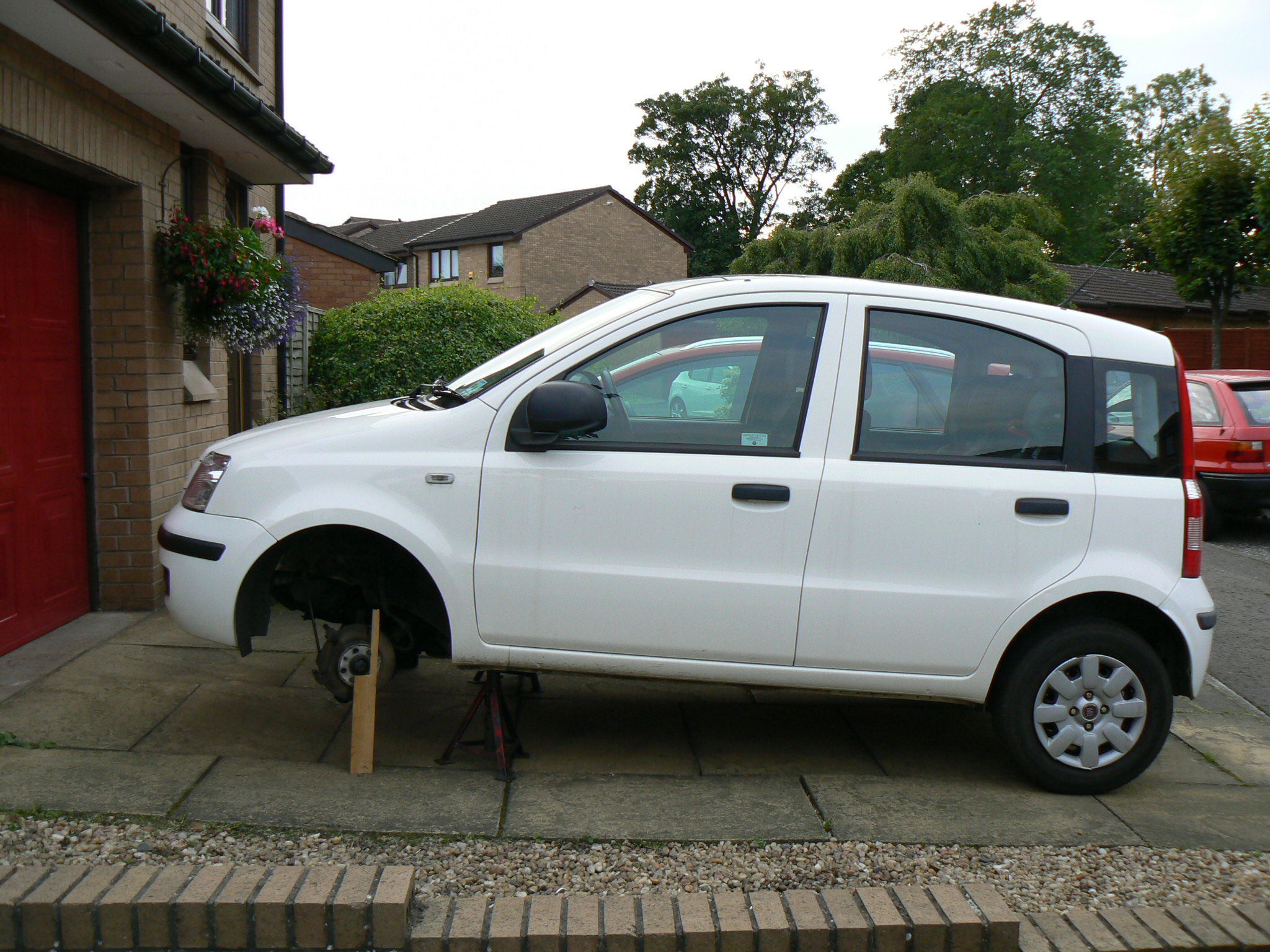

Well today got off to a poor start. I was up at around 7 am ready for some wheatabix and an early start on Becky but that bathroom tap had other ideas! wouldn't turn off beyond a persistent dribble - too much to ignore. Up into the loft, bung in cold outlet from tank, have breakfast, dismantle tap jumper (why is it called a jumper?) to find the washer (Delta type) is so perished a bit of it has become detached. Luckily I had one in the toolbox so fixed quite quickly but it's the last one so note to self - visit Toolstation and buy 1/2" and 3/4" delta washers and small tub of plumbers grease.

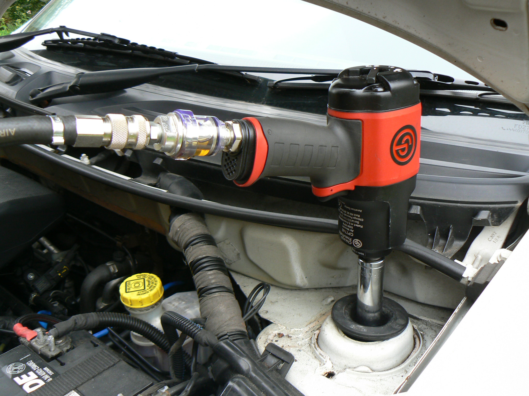

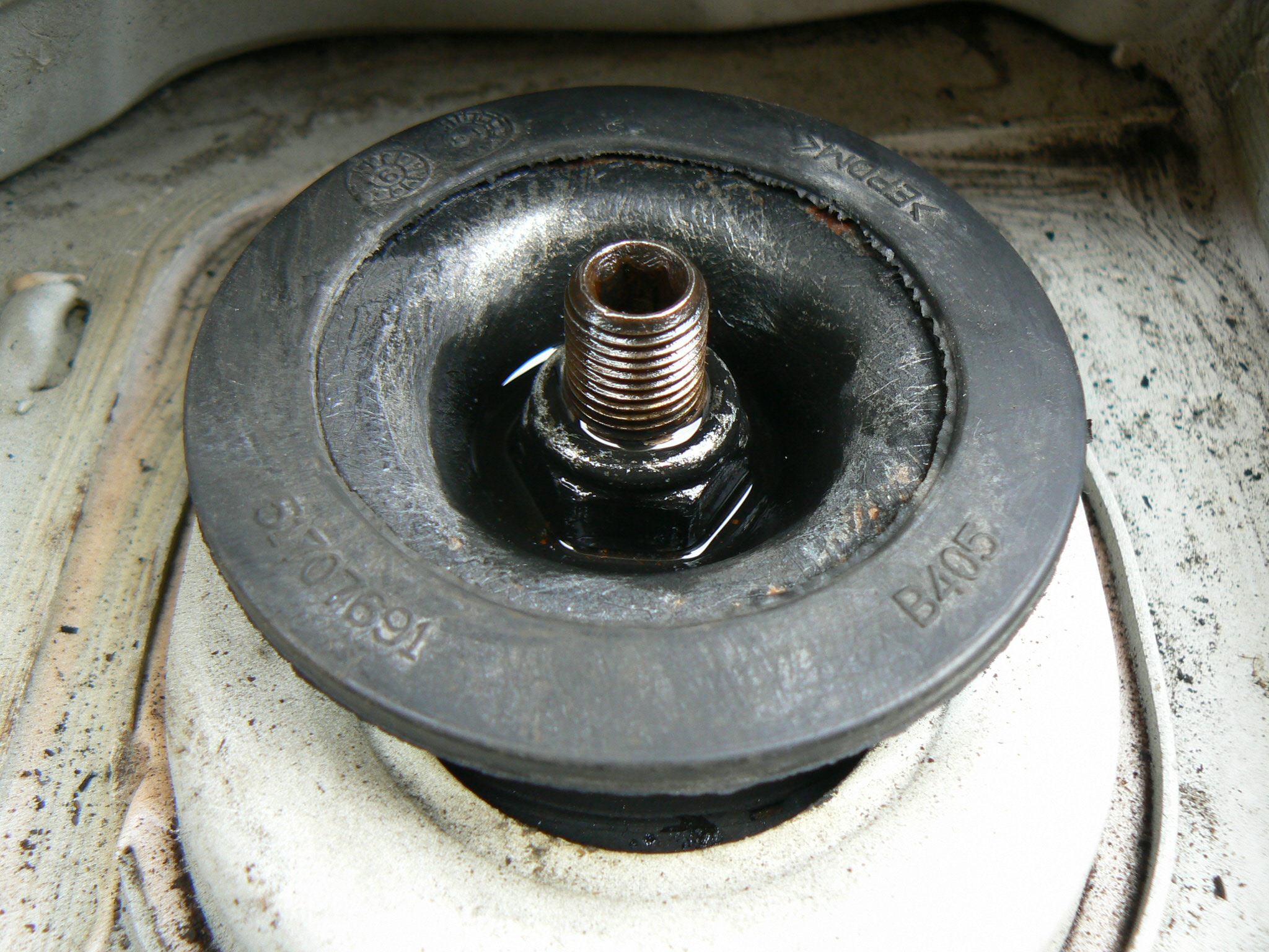

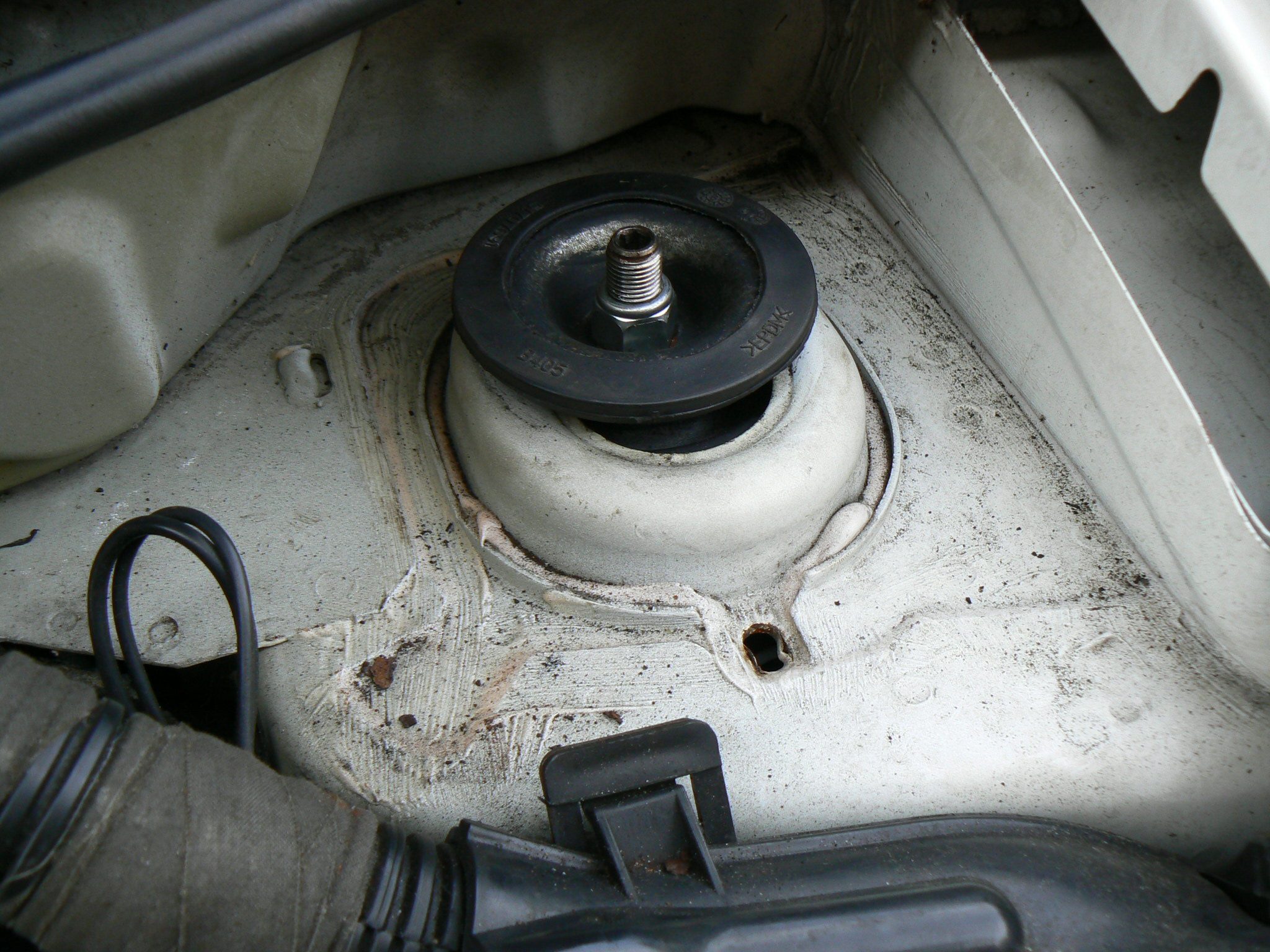

Now around 10.45 so cup of tea and into the garage. Jack Becky up and put axle stands under her front. In deference to my neighbours I tried undoing the top mounts with an Allen key and my Vortex go through sockets. Very tight so got a short length of pipe on the Allen key
but all that happened was the key started to twist! Oh my, this is tight!
Ah well I'll just have to get "Hooligan" out!
Three short "burps" later and the nut is off. Don't want it off yet so screw it back on a few turns to stop the strut dropping out of the wing. I bought the Vortex sockets as an indulgence a few years ago and thought that once the job I bought them for was done They would probably live on the shelf a lot. Although they didn't work on this occasion I've been surprised how versatile they are and use them quite a lot.

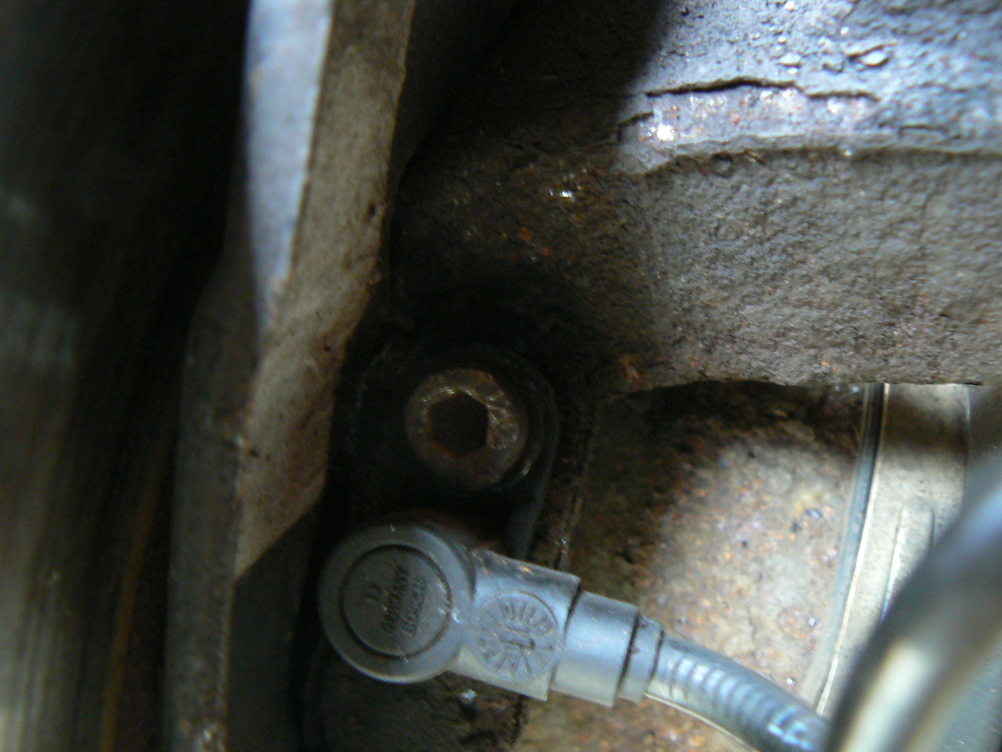

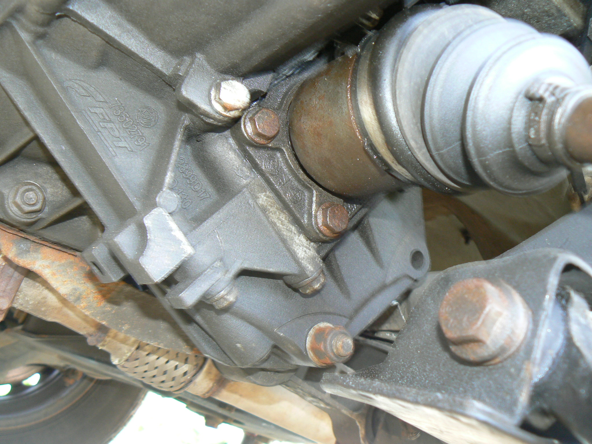

I thought I was going to have to remove the driveshaft to fit a new seal to the gearbox and my plan had been to just remove the whole hub/driveshaft complete. The fly in the ointment is the ABS sensor. I wondered if it would come out of the hub. Tap/shocked the Allen screw and I was amazed to find it unscrewed without snapping off!

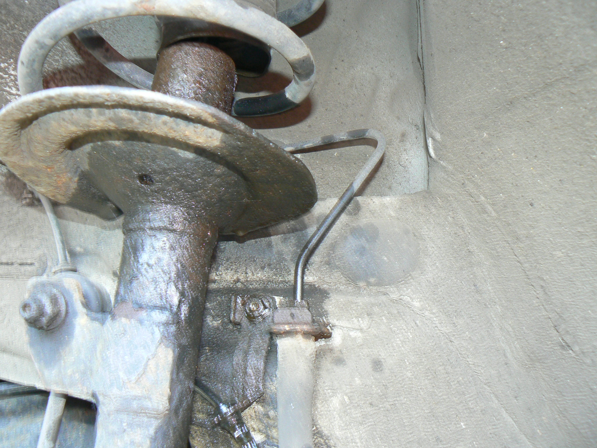

Unfortunately the sensor is solid in it's hole. If I ever have to replace it it'll probably be destroyed on removal. So I put a wee dod of ceramic grease on the screw and reinstalled it. Ok then, let's just get this strut out of the way (N/S first as it's the leaky one). Brake flex and ABS wire separated from the strut and now there's just the two pinch bolts. You'll remember I've already snapped the top bolt a few days ago. Most of the bolt is still in the hole. I tried punching it out with a drift but it's just not moving. I find I can get it to rotate slightly with my 15mm ring key - about 1/4 of a turn. Flooded it with plus gas and started on the bottom one. Didn't mess about with this one. It's already had a good wire brushing and soaking with PG when I broke the top bolt and now I give it some more and turn "The Hooligan" loose on it. It fights but slowly, slowly it turns - with me expecting the bolt to snap at any minute. But no, the gun suddenly races away and the nut is spinning across the slabs. The bolt though is still solid in the upright. Swop the 19mm for a 15mm socket and let the gun attack the bolt. slowly and reluctantly it turns with me whacking the protruding threaded end until it finally pops out. Back to the top bolt and let The gun attack it. Got it spinning and then whack it out with a punch and 2lb hammer. A couple of turns on the top nut and the old strut is on the ground. Spring clamps fitted and tightened and Allen key with Vortex socket fails to slacken the top mount nut! Turn the "hooligan" loose again but all that happens is the shocker rod spins round. Clamp my biggest "Mole grips" as tightly as I can manage to the shaft (it's junk so doesn't matter if I mark it and ------ It just spins again! Thinking about a bit of emery cloth to give grip when I notice the top of the shaft is severely corroded This might give enough purchase for the Moles? Yippee! off she spins! So here's what we have:

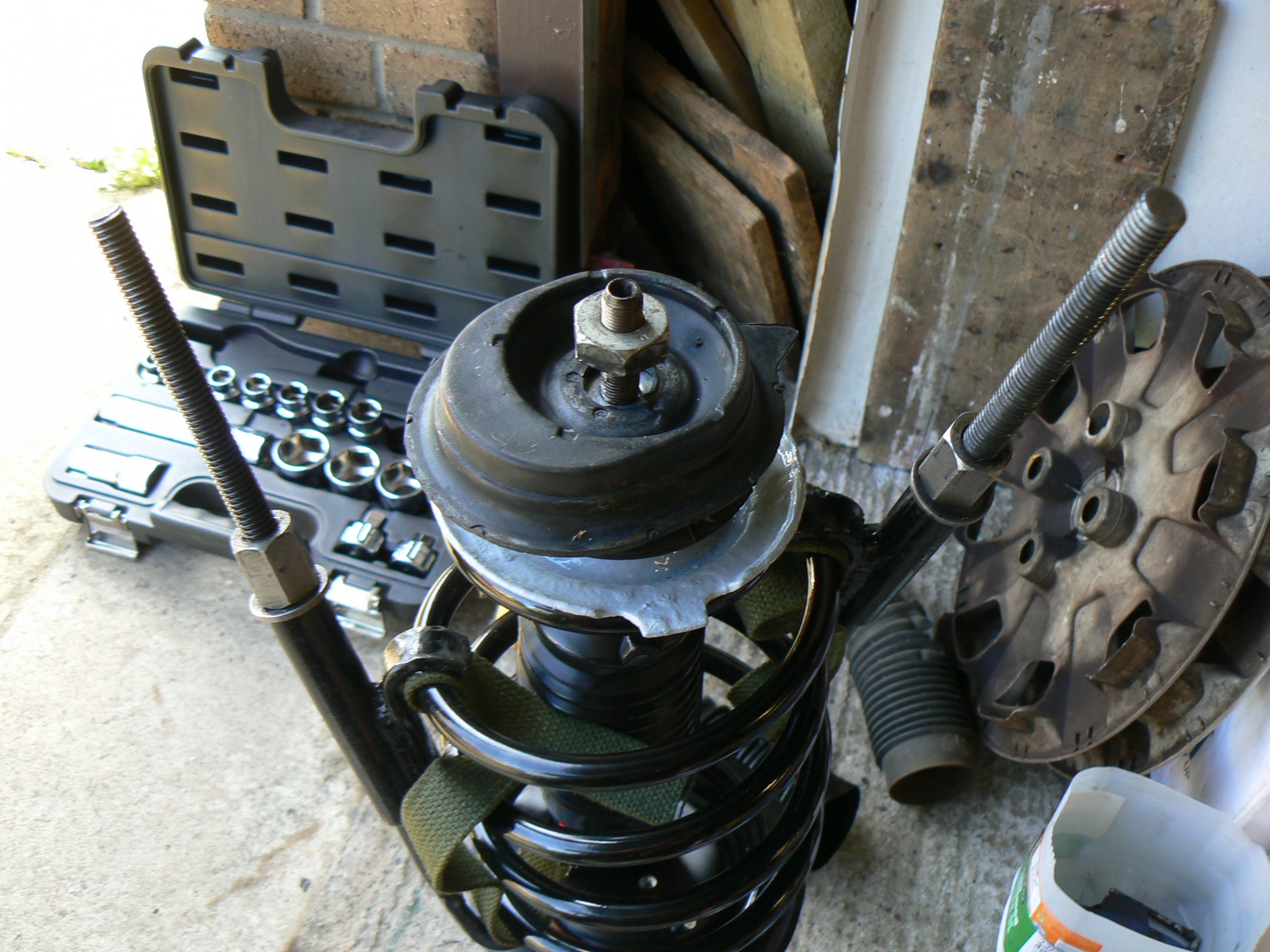

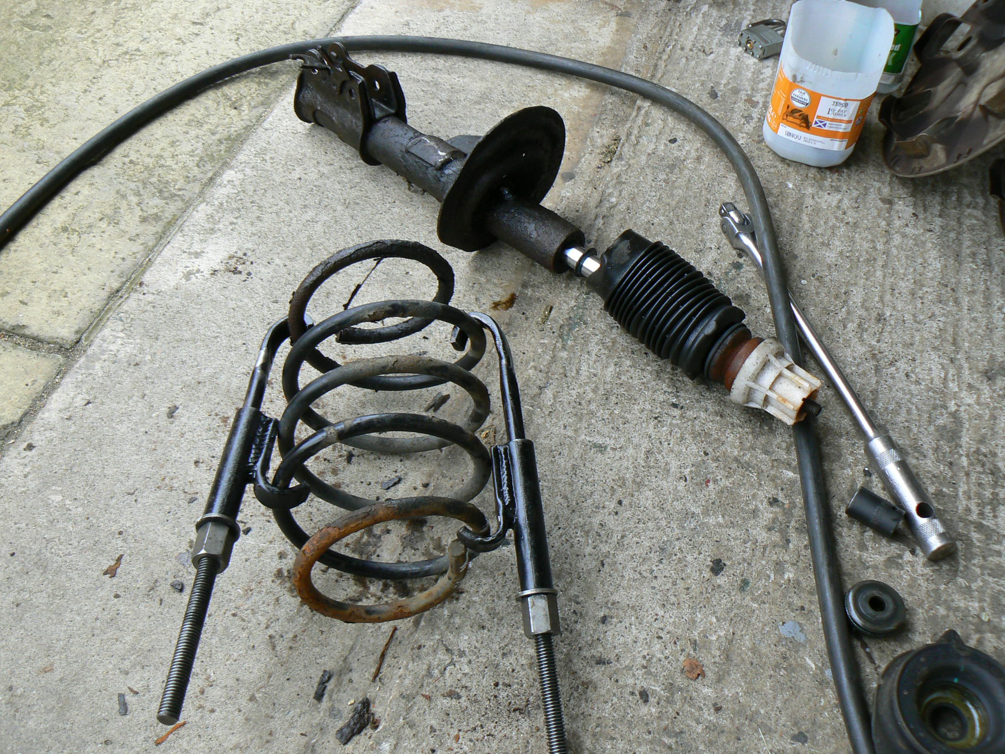

A quite rusty spring.

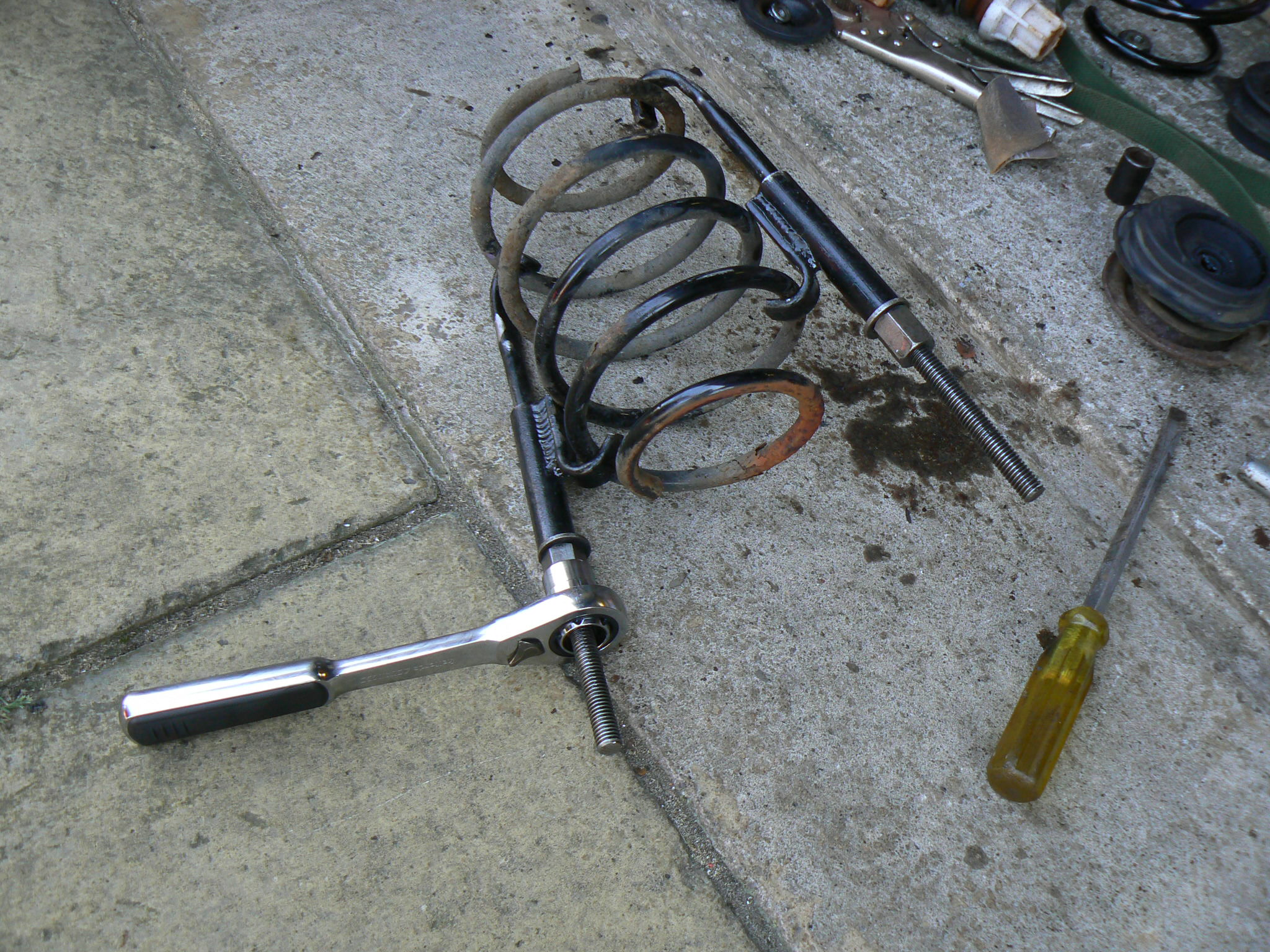

Must admit the Vortex sockets are "magic" with the spring compressors.

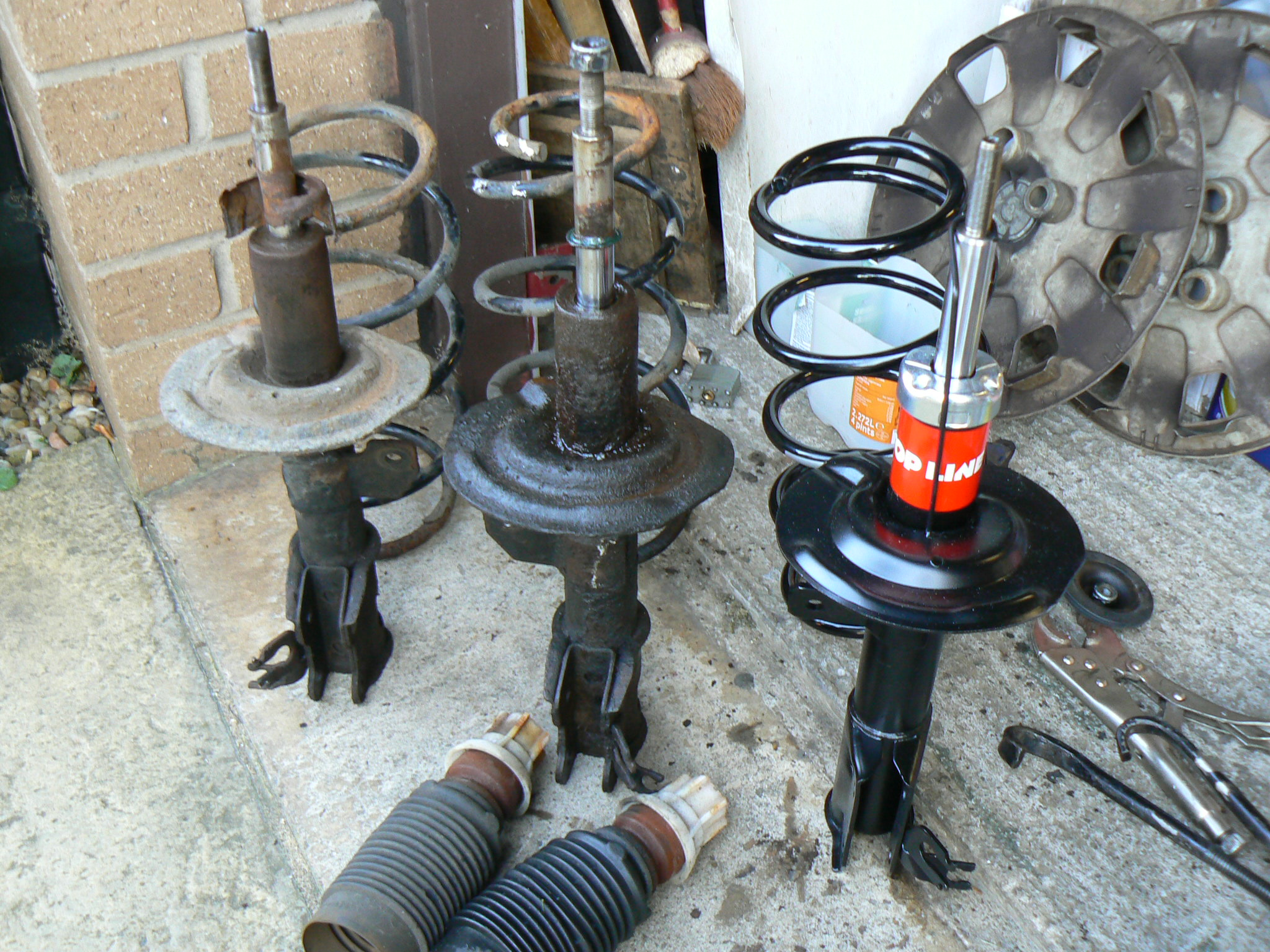

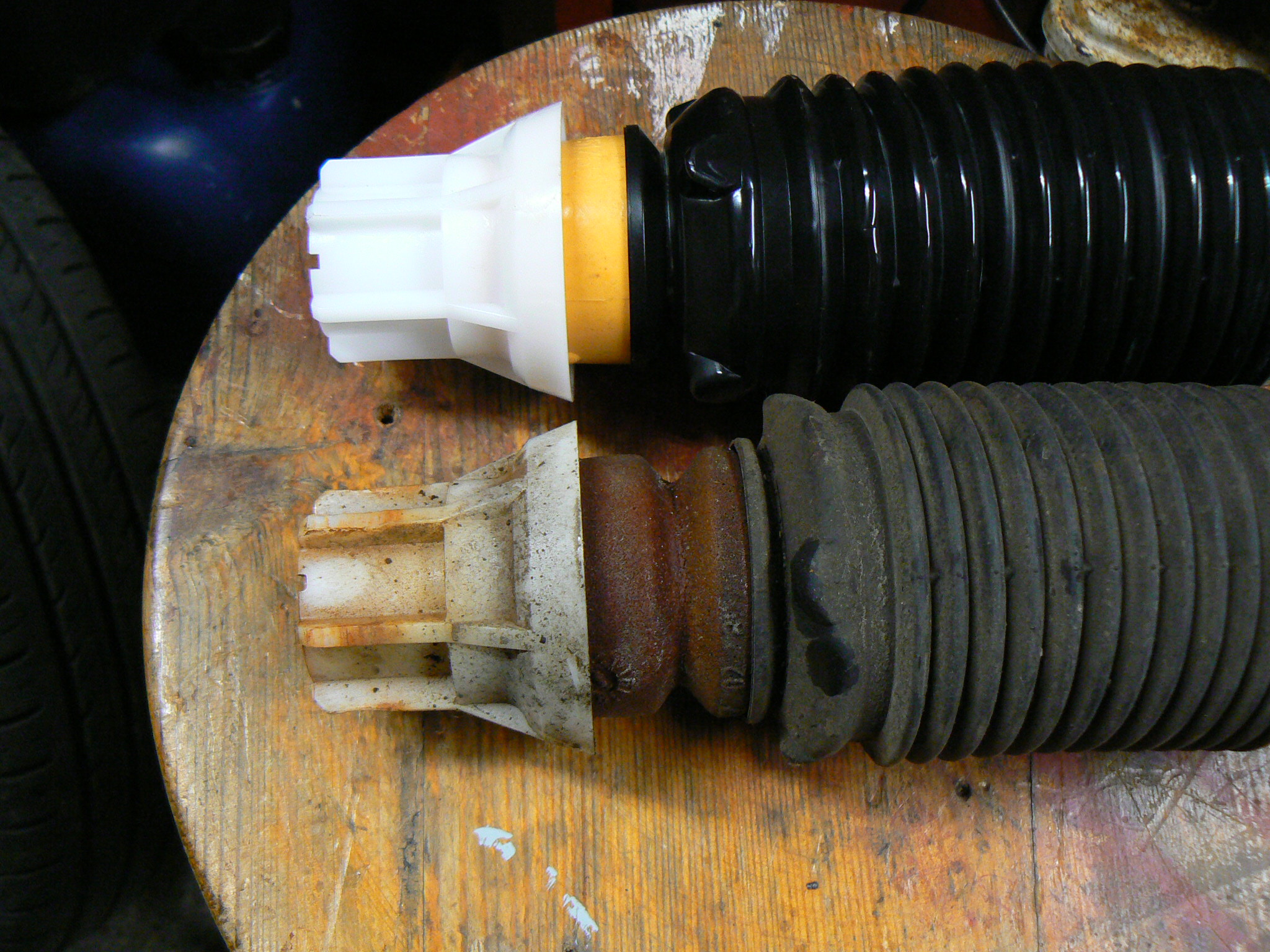

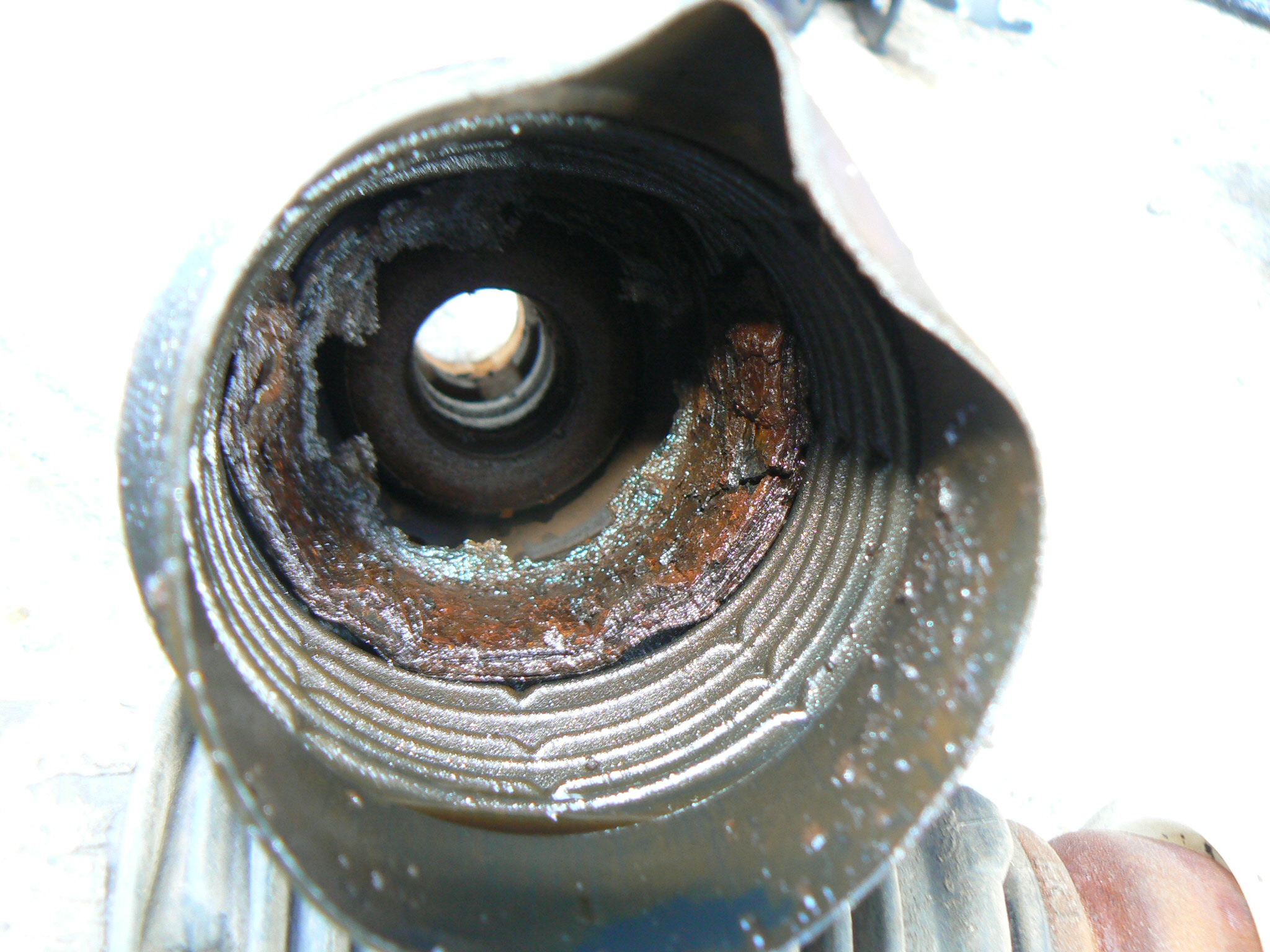

A very leaky and corroded strut completely missing it's seal retainer and with the remains of the seal about half way up the damper rod.
Oh, look, there's the remains of the seal retainer stuffed up the old bump stop/gator shroud.

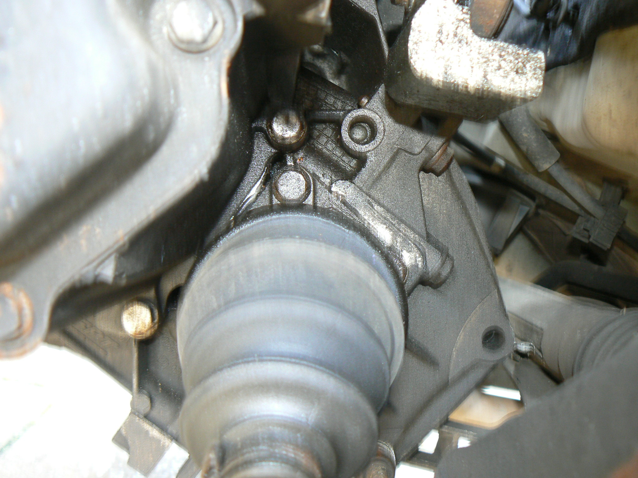

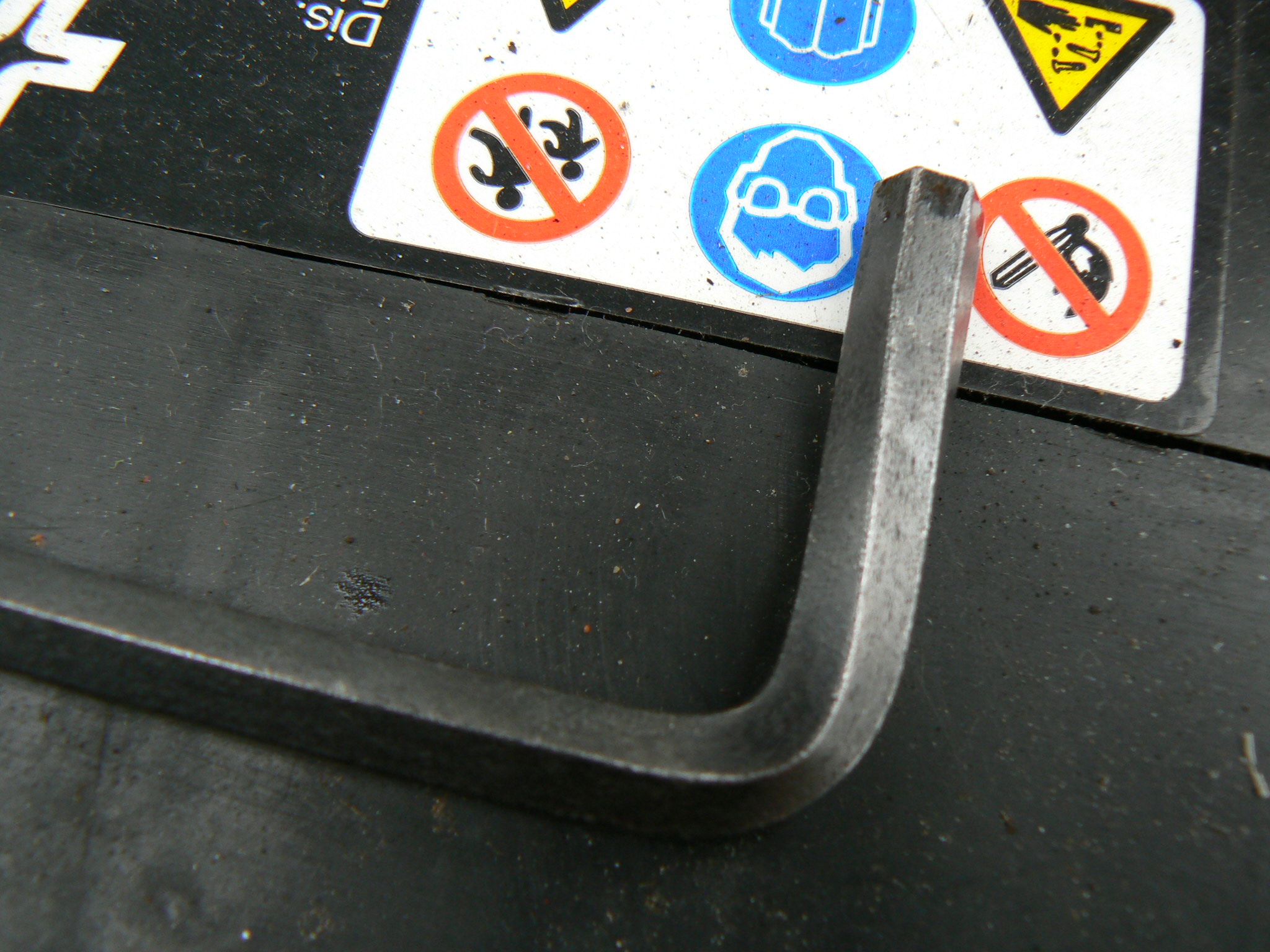

Now for that drive shaft seal. Crawling underneath to remove the drain plug (with the wrong size Allen key) I had to crawl out again to get the right one when I notice the drive shaft leak looks "funny".

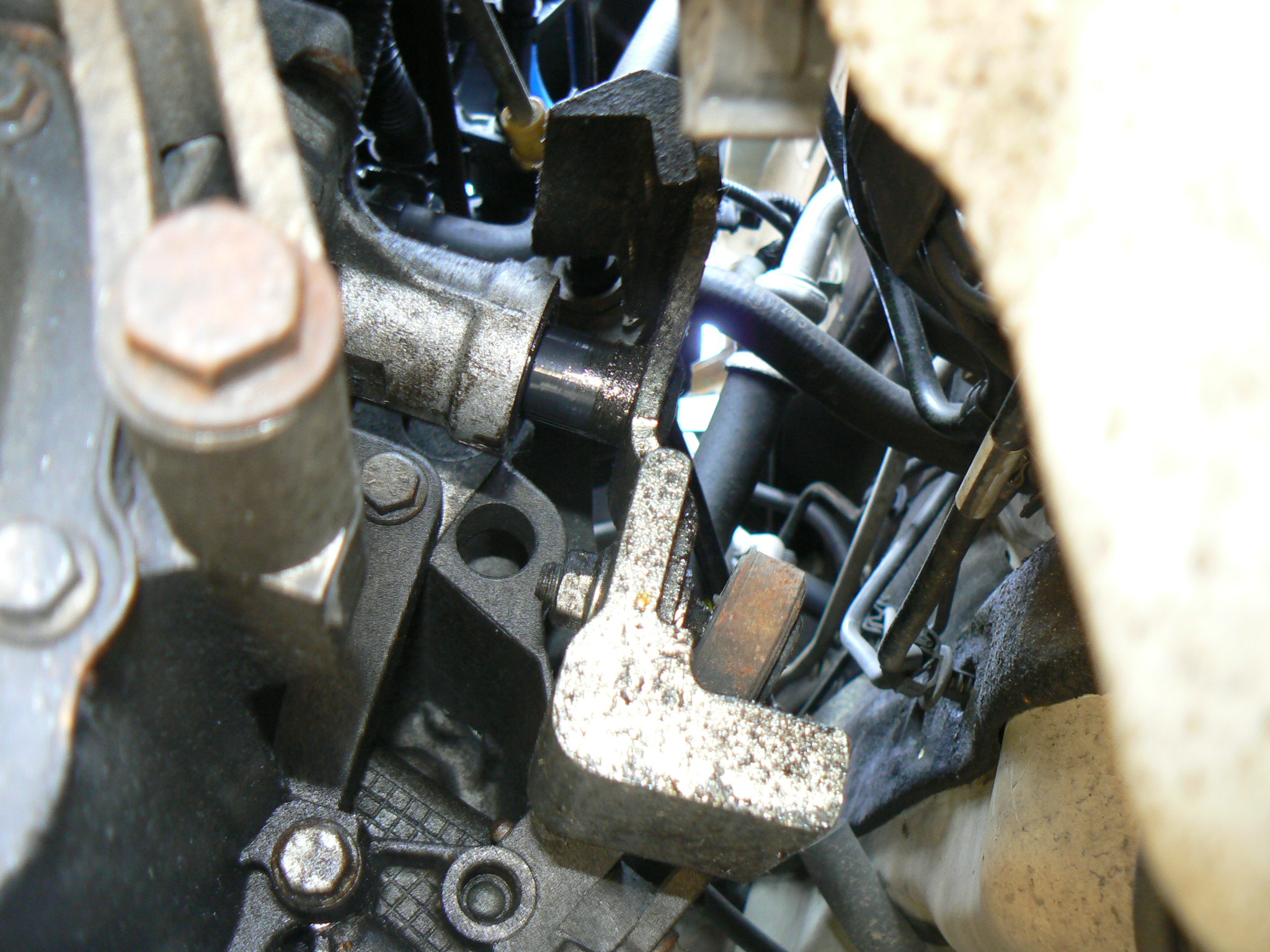

Not as much oil dribbling down but quite a bit higher up? Oh damn, its the gear change shaft! (Oh well, now I've got a spare d/shaft seal)

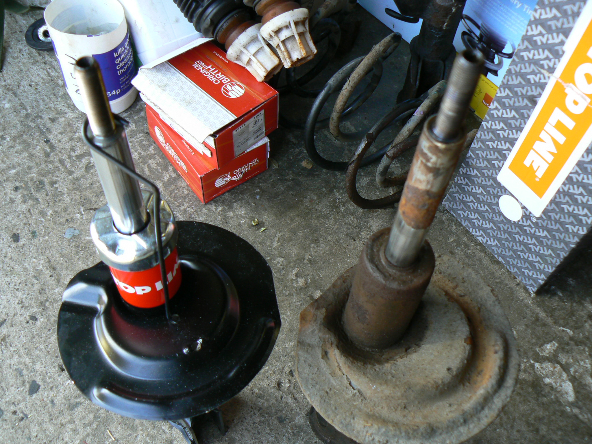

Ah well might as well get the O/S strut off. It turns out a complete replay of the one I've just done only I didn't mess about with the Vortex sockets, just let the "Hooligan" loose. Complete replay even down to the top pinch bolt snapping and both fighting me to resist removal. So let's have a look at what I ended up with before calling it a day. Struts and springs first:
Two very knackered struts, one leaking copiously, both missing their seal retainers and springs? Well maybe I could have reused them but there is some quite deep pitting in places so I'm glad I got new ones. (on the right for comparison)

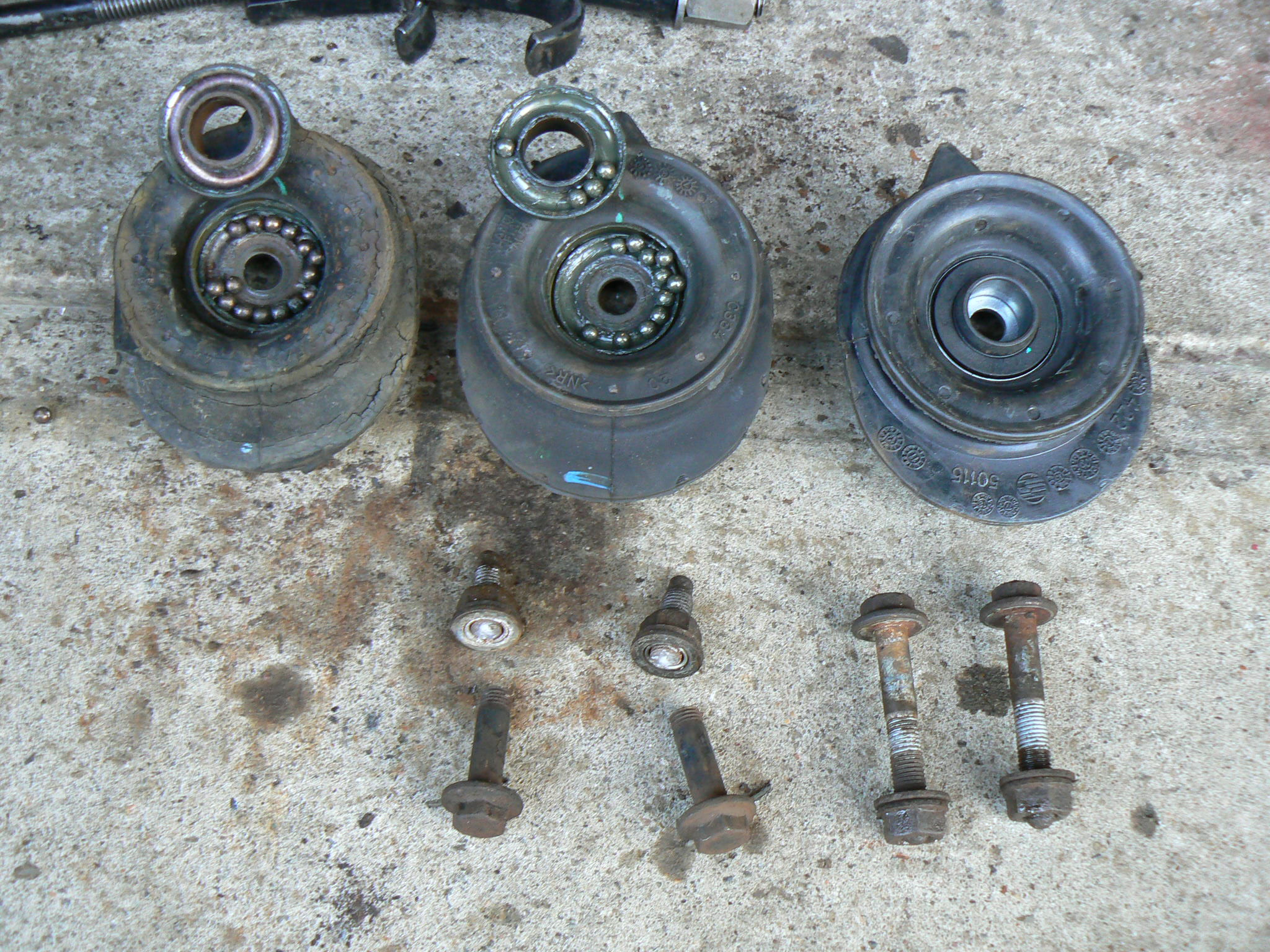

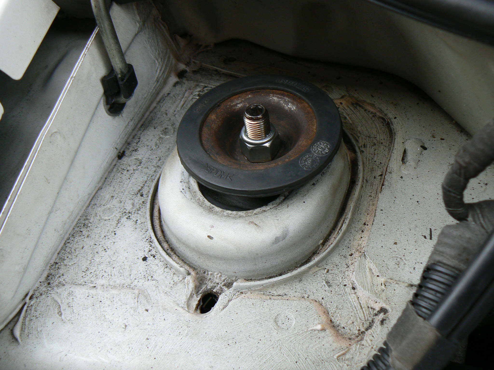

Top mounts were interesting.
The one on the left was the O/S and is in a bit of a state - Probably why the rod stuck up into the engine bay a bit. The middle one looks quite new and was on the N/S. New "Original Birth" from S4p on the right. I'll keep the "nearly new" one as a spare. You can also see some of the mangled pinch bolts

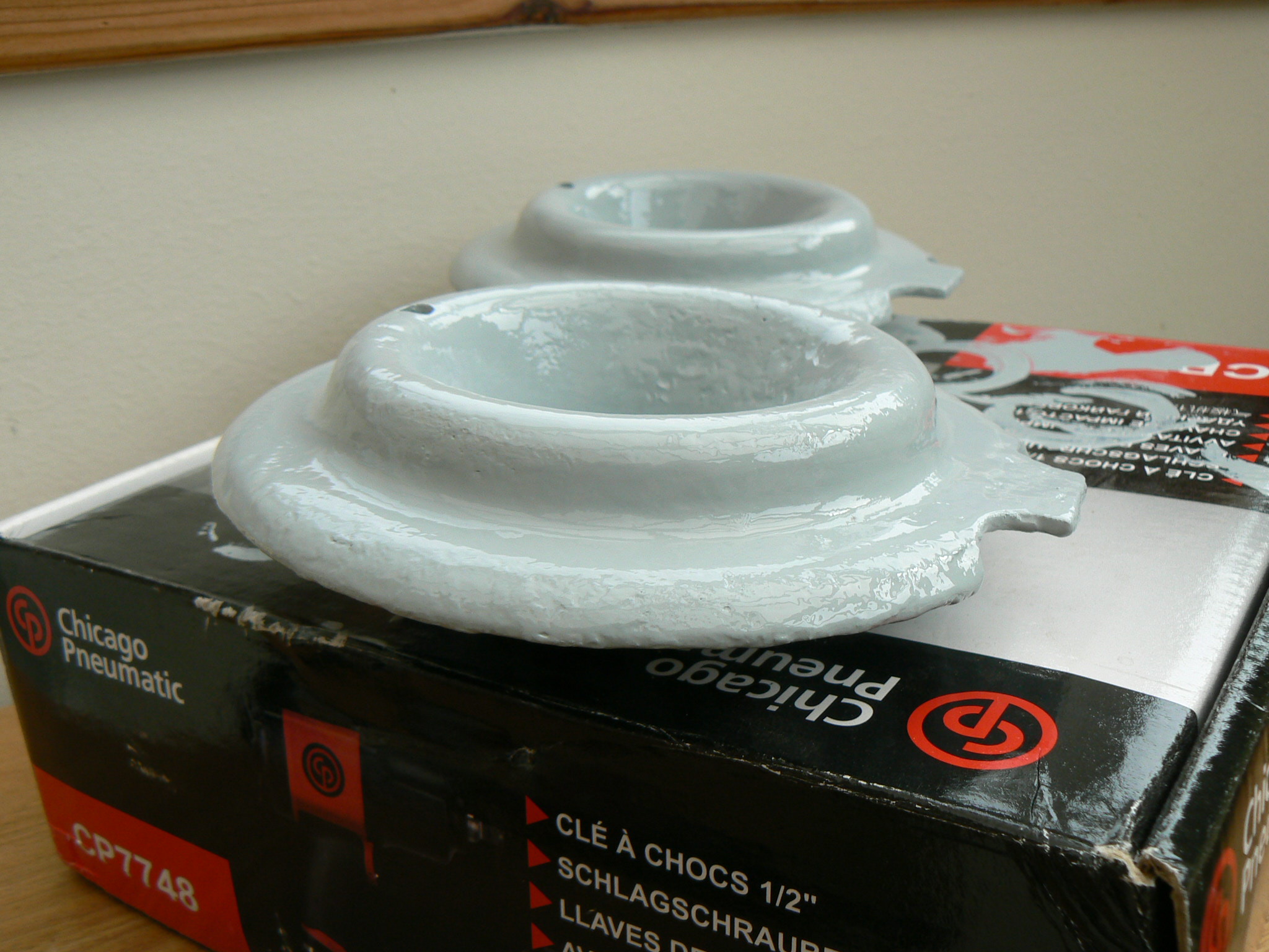

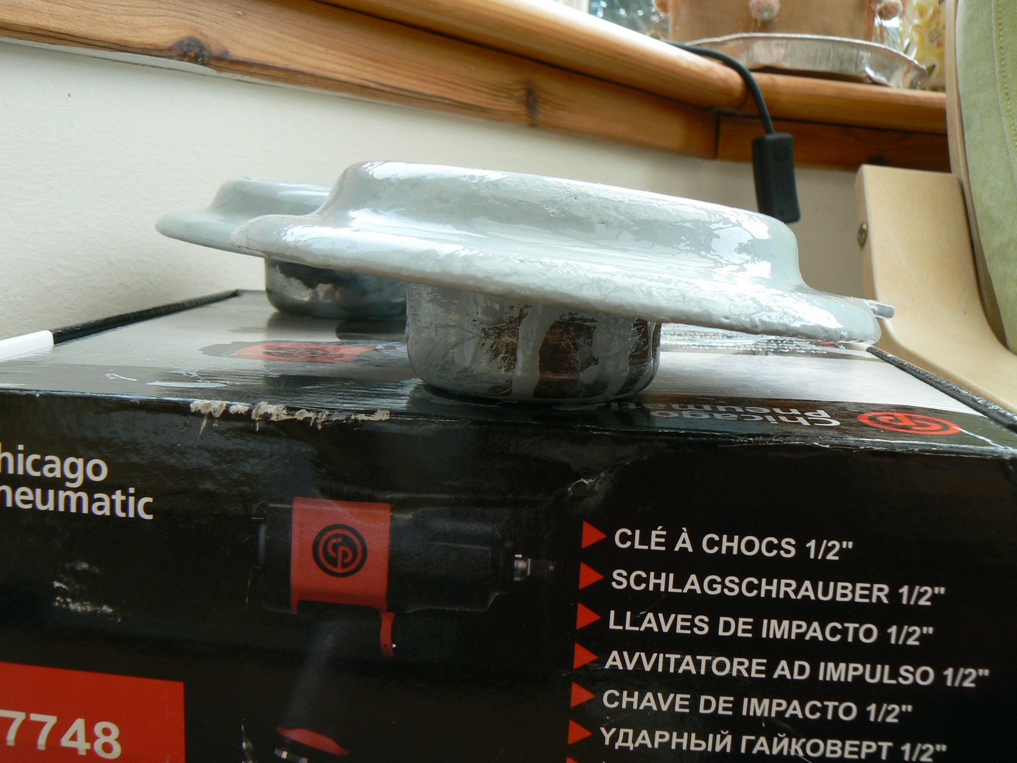

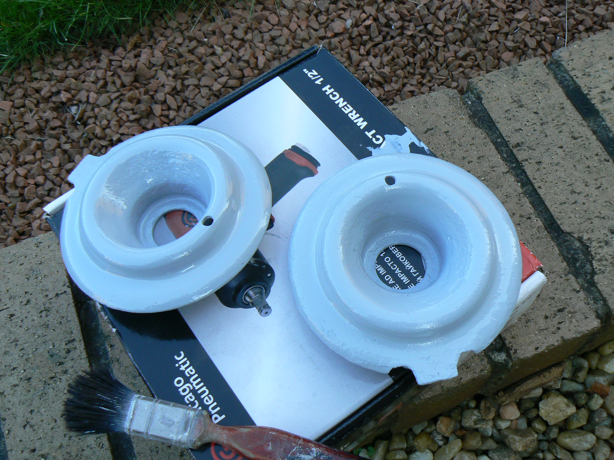

The spring top plates were pretty rusty so I rubbed them down with course emery an painted them with Lidl/Aldi anti rust paint.
I'm thinking of painting the rear axle with this so it'll be interesting to see how it fares.
So here's Becky waiting patiently for me to put her all back together again tomorrow.
I decided to give the recommended 2nd coat of paint (says so on the tin!) to the top spring plates so now waiting for them to dry and cure. They're now baking gently in the sun shine. Looking pretty good I must say?
Looking closely at them I notice the face that bolts up to the ball race in the top mount is not at right angles to face the spring sits on, as you can see here
It'll be all to do with the spiral of the spring I suppose. As many of you will know, when reassembling the strut the manual makes a big point of getting you to line up the "tab" on the top plate
with the mountings for the upright (hub) at the bottom of the strut. (where the pinch bolts fit) When I dismantled the struts I found the one on the O/S (RH) complied with this but the one on the N/S (RH) had it's tab positioned at about 1.30 (looking down on the top plate - 12.00 O'clock being to the rear of the car) That N/S strut was the one with the nearly new top mount - looks like whoever replaced it wasn't a Fiat man or he/she would have known about this. The bottom spring mount, which is part of the strut, has a register for the end of the spring. The top plate does not so it's not obvious from the mount as to how it fits - if you don't know about the Tab that is. Bet this was contributing to the pull to the left.
I gardened this morning and then spent this afternoon "fettling" parts which will be reused on the build up. Nothing of great interest except the bump stop and gators. They come, fresh out the package, like this - bump stop and gator separate
After a great deal of struggling I found out it just isn't possible to push it over the "stop" end of the bump stop but, if you remove the white plastic end which fits into the top spring plate, you can stick it into the bottom of the gator
and, with a bit of silicone grease to ease it along and a lot of huffing and puffing you end up with this

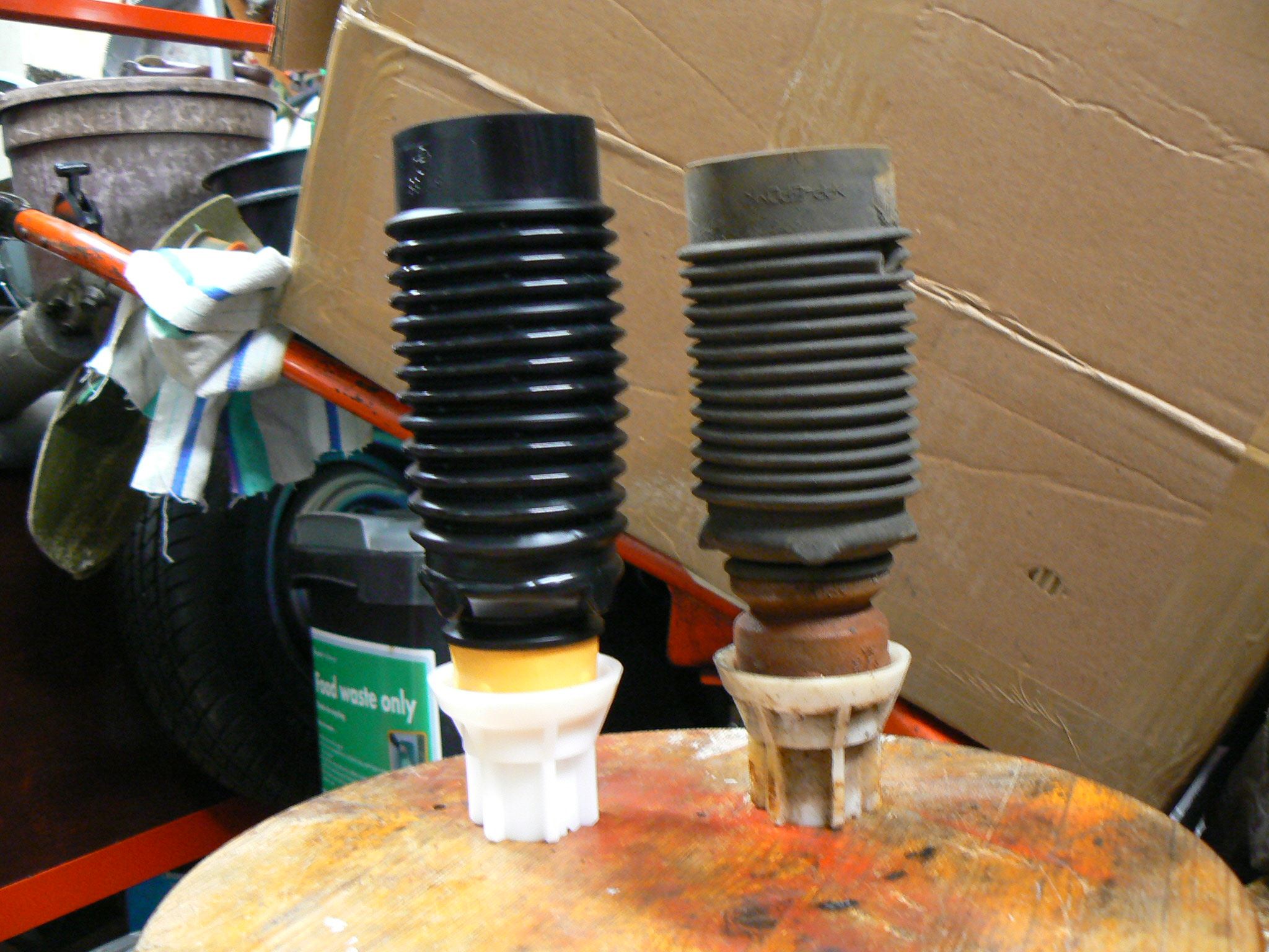

With which I was feeling very pleased until I looked at the old ones
Anyone know which is correct? I have found a picture of one in the Haynes manual which seems to show it fitted like my new one but then why were the old ones, which in all likely hood are the original factory fitment, fitted to the second groove?

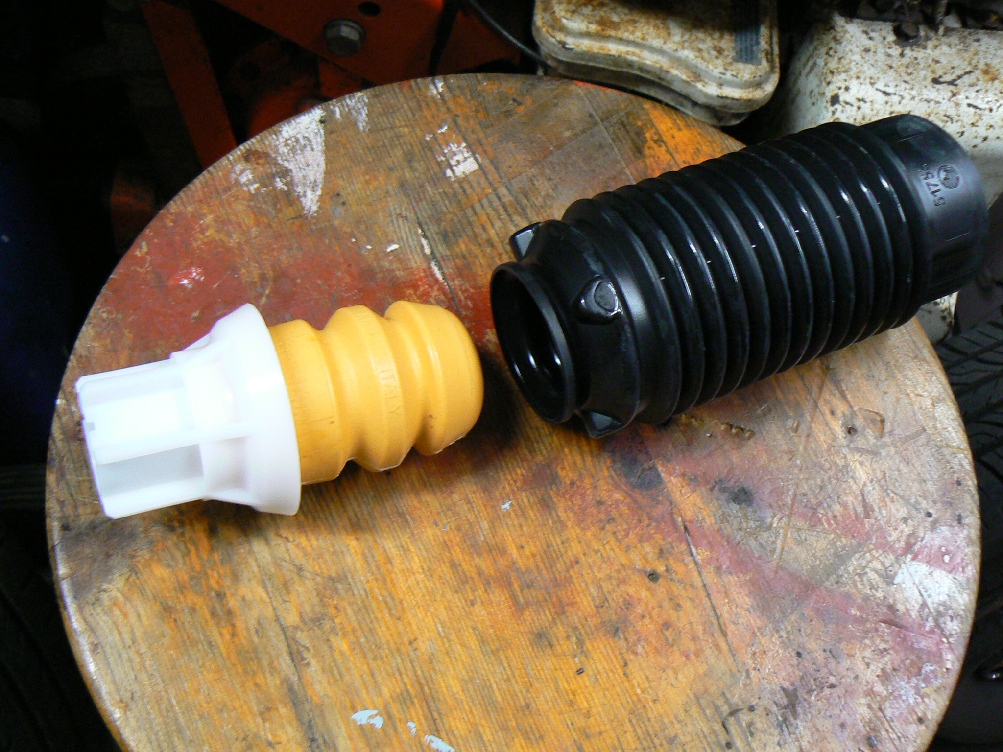

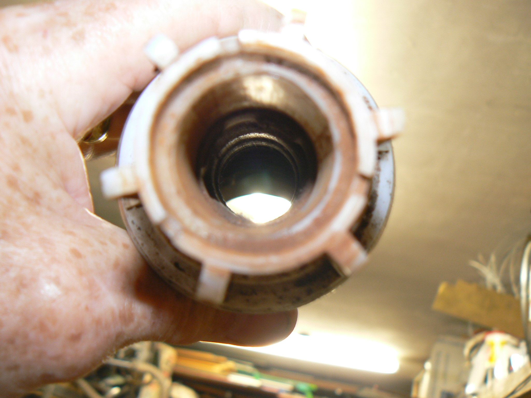

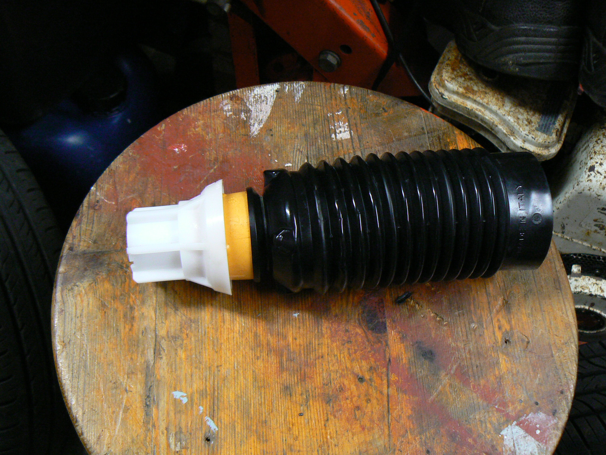

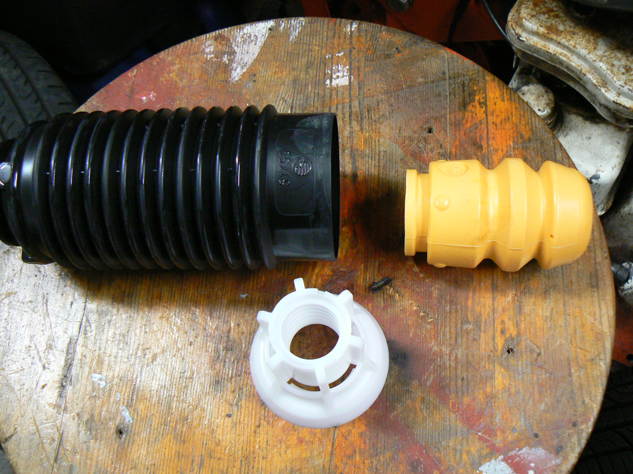

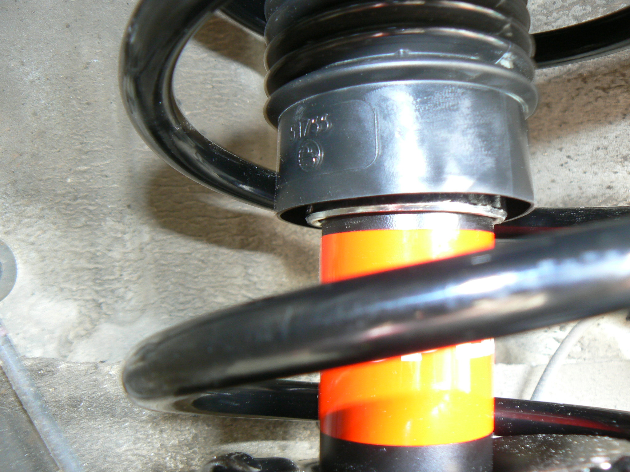

I'd been wondering about the assembly of the new bump stop/gators and you'll remember I decided the way I'd assembled them was correct. I had also been wondering exactly what stops the bumps stop/gator from sliding down the damper rod (as has been reported in a number of posts I've read) Well, turns out, there are 4 moulded in "pads" inside the bump stop which grip the top of the damper rod - You can see them here.
that seems to be all that keeps it in place, just the "tightness" on the damper rod? Doesn't seem to be an awfully good way of doing it to me. You can see on the old one how these "pads" become compressed over time and so are likely to loose their grip.
Here it is in place with the car still on axle stands so the strut is fully extended. That'll do me nicely thank you!

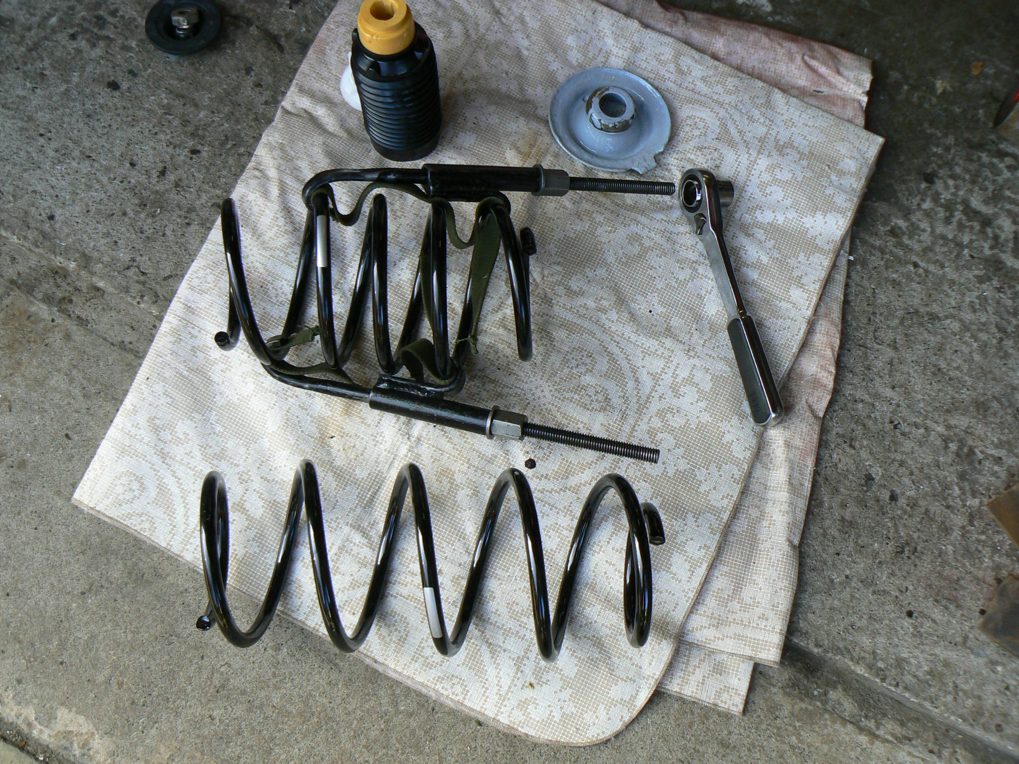

Here's an interesting picture which illustrates exactly how much the new spring had to be compressed to get it on the new strut. The other new spring is beside it for comparison. I can't over stress how important it is to get your compressors exactly opposite each other on the spring. If it starts to "banana" as you tighten them STOP immediately, slacken off, reposition, and tighten up again. It doesn't take much of a "banana" to develop before a clamp will slip. You may notice I use some strapping to protect the finish on the new spring and reduce the chance of a clamp slipping. Obviously you don't want to compress the spring any more than absolutely necessary and try to get hold of as many coils as you can. If you only grip, say, a couple of windings you'll have to compress them so much you may weaken the spring.
These springs, as we all know, are very powerful and I'm always nervous and anxious when compressing them. I'm much happier when I can get the retaining nut back on the top of the strut!

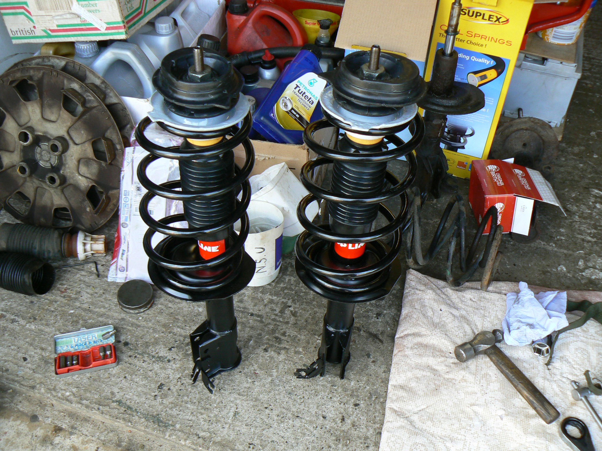

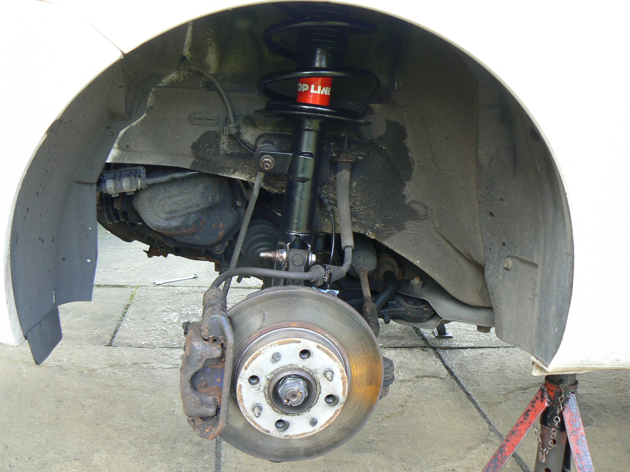

So here we are with all the nice new shiny "bits" assembled and ready to lift back into the car.
And here's the N/S (LF) one in place with everything reconnected.

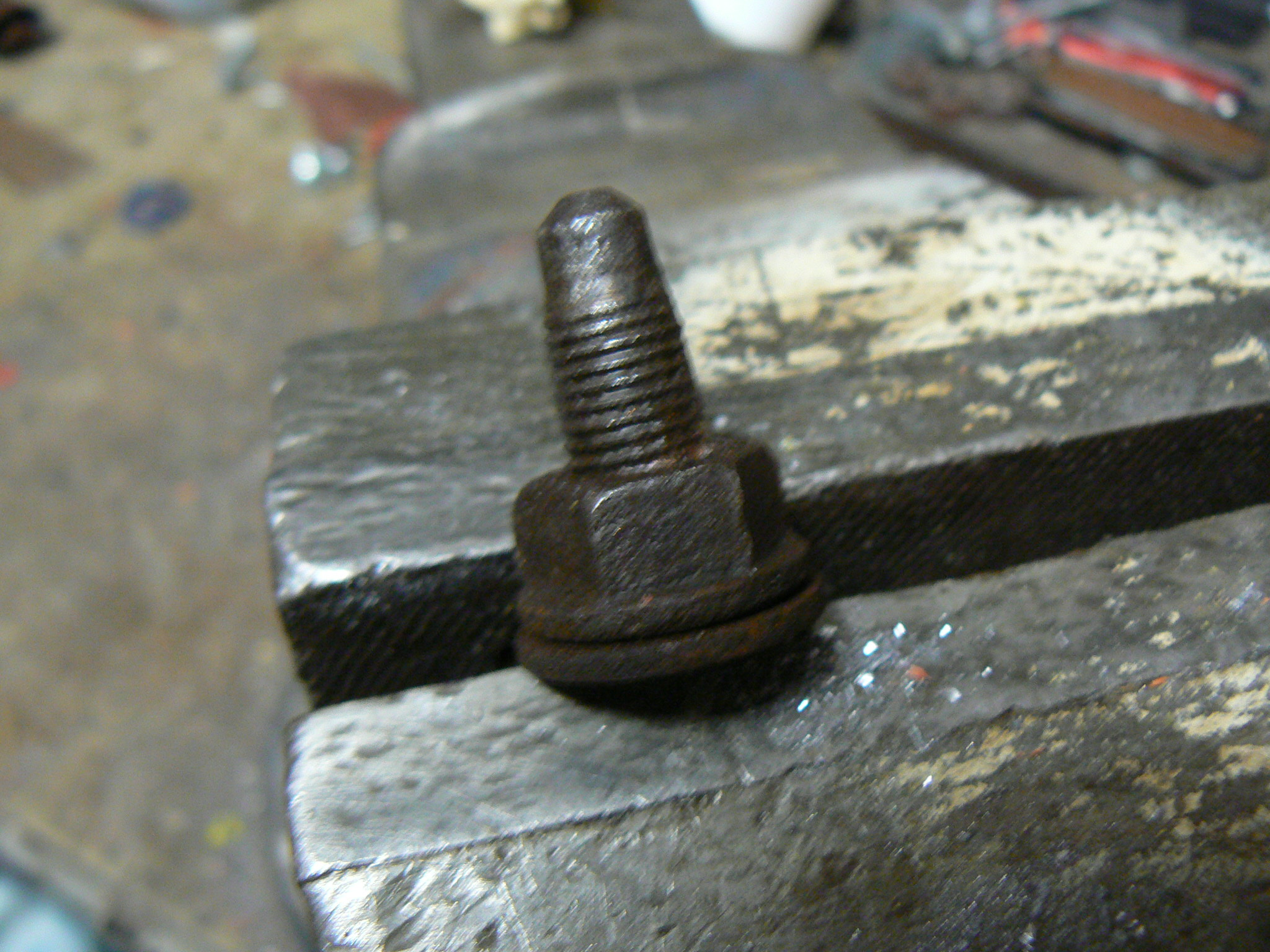

As I came to replace the pinch bolts I found myself unable to remember which way round they went. Do they go in from the front or from the rear? and is it important which way they go anyway? Then I remembered that when the top bolt sheared off I had been using my deep socket (because the length of thread means a normal socket can't be used) and I was "attacking it from the rear! Great, so they must go in from the front. But hold on a minute, I remember doing exactly the same thing, using the same socket, on the O/S (RH) strut, only the nut was on the forward side of the strut! So the ones on the N/S had been inserted from the front and the O/S from the rear. That just can't be right, can it? Of course, if in doubt and as a last resort, consult the manual. Mr Haynes, bless him, shows them inserted from the rear and actually has it in writing. I always tend to try, where possible, to try to "hide" threads from the worst attacks of the weather and road spray so my inclination would have been to insert them from the front. I trial fitted one this way and I think there is a small chance the end of the threaded section has the possibility for contact with the brake flex hose if you do it this way. So I fitted them, as you can see according to Mr Haynes advice. For the umphteenth time, thanks once again John! By the way, why are they so long? Can't see the reason. If they were shorter rust on the threads when they age wouldn't be such a big problem for us.

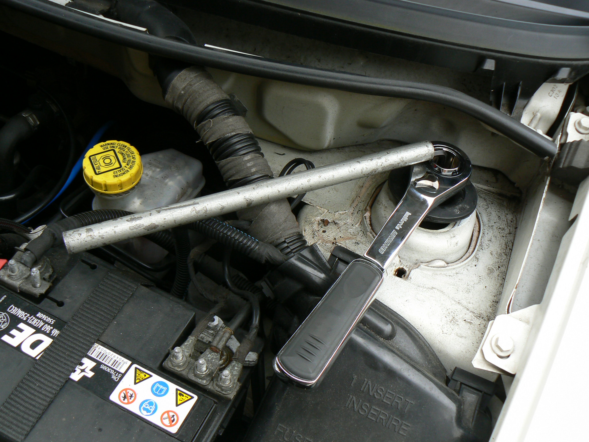

When I put her back on the ground to tighten up the retaining nuts I was very pleased to see the top of the struts rods were now protruding much less and that they were of equal protrusion where previously the O/S one stuck up more (now known to be due to that fatigued top mount)
