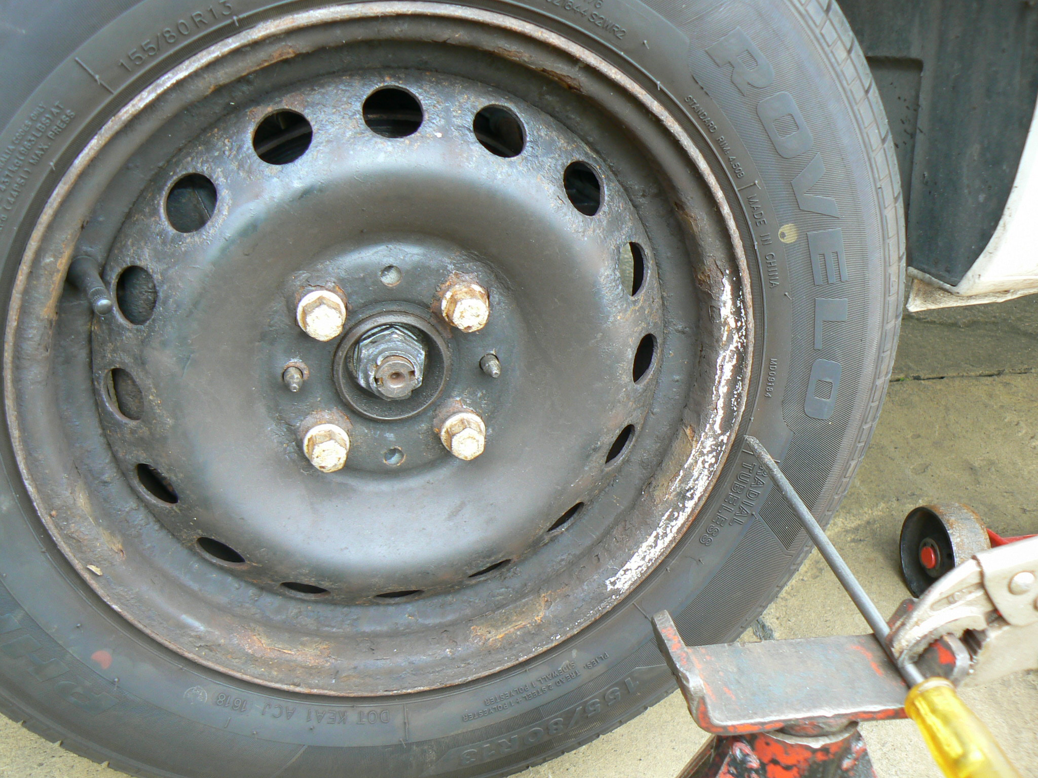

Here's me checking Becky
The screwdriver (or whatever you want to use) is clamped securely to the stand, placed so it lightly rubs against the wheel rim and the wheel is rotated. The wheel must run true. If it doesn't either try the land - in which case you will use this for your datum reference or swop another wheel to this position and try again. When you've got a satisfactory wheel on both front hubs put the car back on the ground (you had to jack it up to spin the wheels of course) and go a run round the block to settle the suspension down. If you find most of the rim runs "true" but a small are does not then just mark it (I use blackboard chalk) and you can still use that wheel as long as you don't involve the chalked area.

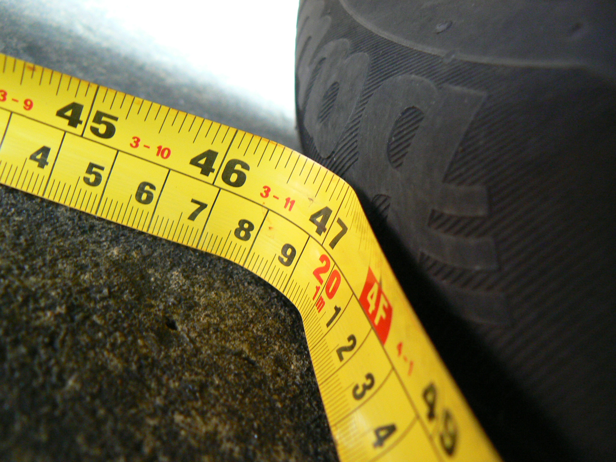

Now approach your chosen flat surface where you are going to take the measurements. The car must be driven forward and brought to a halt without running backwards so that all forces acting on the suspension are as they are when you are driving along. The "fixed" end of the tool is now locked up with the end in line with the centre of the axle and a distance piece cut to the same length (I used a piece of doweling). It's very important that this fixed end is locked off securely. If it moves your readings will be nonsense.
Now the whole tool is slid under the front of the car. The fixed end is on the right here (N/S and it's stop end is placed against the outer wheel rim (or land if you've chosen that as a datum point)
Now the sliding end is placed against the outer rim of the other (O/S) front wheel, using the distance piece (doweling) to get it to exactly the same height as the fixed end on the N/S. This is very important as wheel camber will make a nonsense of any readings you take if both heights are not identical.
Now slide the marking cursor along until the scribing line is over the piece of masking tape (more in JTG) and securely lock it off. As with the fixed pointer, if this subsequently moves your readings are toast! Now take a sharp pencil and, holding it at right angles to the masking tape (to avoid parallax always hold the pencil at right angles) make a line on the tape.
Now "wheech" the whole tool out from under the car - careful not to bang either of the lock off clamps - and slide it in behind the wheels. Now the fixed end is going to be on the O/S and the sliding end on the N/S. Repeat the whole exercise. A lot of care is needed to be sure that both ends of the tool are in contact with the wheel rims before scribing your line and I always make some sort of mark to remind me which line is the "in front line" and which is the "behind line". Now "wheech" the whole thing out and have a look at your lines. The first result I got was this
Which shows the wheels to be toed out by around 4 to 5 mm - obviously been like this since I bought her. Mr Haynes tells me it should be zero (parallel). So, as she's set up just now the N/S (LH) wheel is trying to go slightly left and the O/S (RH) wheel is trying to go slightly right. I would expect to see the front tyres with excessive wear on the inside shoulders if she's run for any length of time like this but the dealer had put a new tyre on the left front and swapped the best of the rest to the right front so I couldn't really check but, interestingly one of the rears looks like this

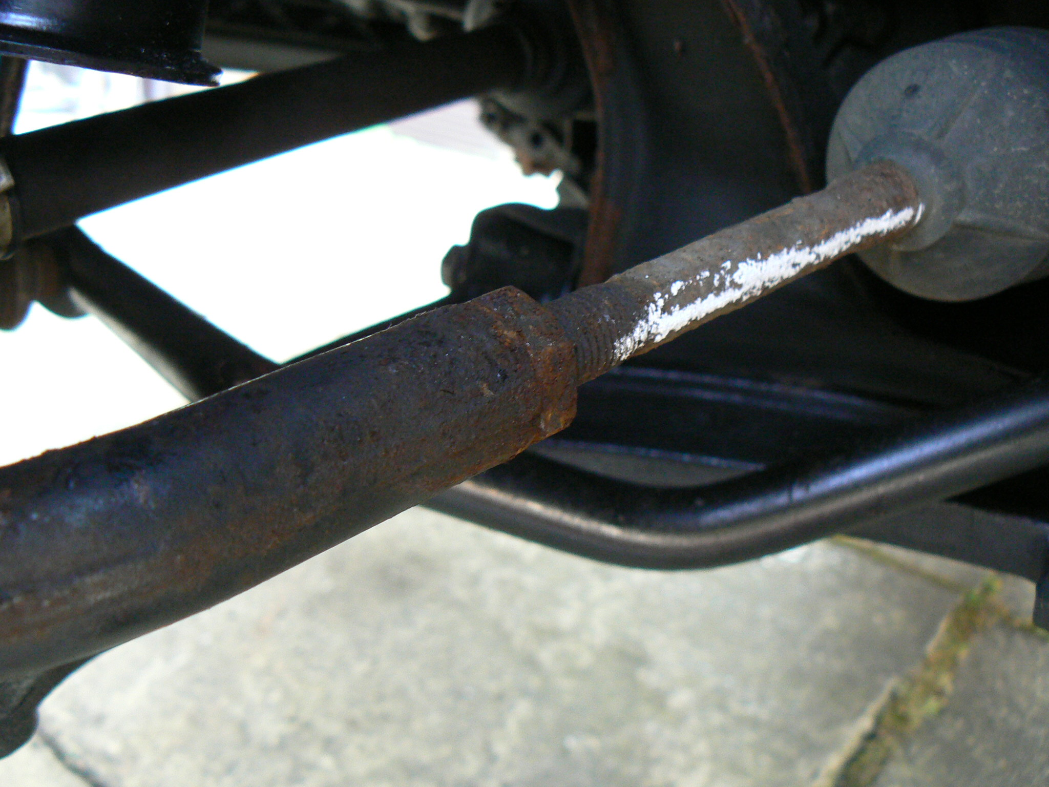

To get rid of all this unwanted toe out we need to adjust the effective length of the track rods (which connect the ends of the rack to the track rod ends.) They are threaded into the trackrod ends and secured with a lock nut (often corroded nearly solid) the end in the rack is a ball joint so can spin round as you turn the track rod itself (after slackening the lock nut)
On the Panda the rack is behind the centre line (axle line) of the front wheels so the track rods need to be screwed out of the trackrod ends a wee bit. But by how much and do both need to be turned the same amount? Well the first thing to find out is whether the steering wheel is centred on the rack. Do this (I like to have the front end off the ground to minimise stress on the steering components) by sitting in the drivers seat, turn to full lock (doesn't matter which way) and make a wee mark (I like blackboard chalk because you can rub it out easily) on the wheel at 12 o'clock and also, in the same position, on the top of the instrument binnacle. Now go to full lock the other way and mark the wheel, wherever it stops, opposite the binnacle mark. You now have two marks on the wheel and know how many turns it took to get there - half way between is the straight ahead position OF THE STEERING RACK. If the wheel is correctly fitted to the column, with THE RACK in this position the steering wheel should also be straight ahead. If it's not you've got a problem and I'm not dealing with that here. Your steering needs to be centred like this before you start adjusting toe if you are to end up with the wheel straight when you're going straight!

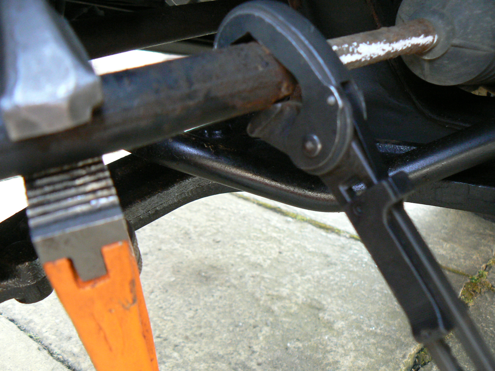

Slacken the lock nuts (that's why you just "nip" them up during adjustment so they are going to slacken easily) and a wee turn in the other direction - I went less than a quarter turn - lock it all up lightly again and remeasure. Both pencil marks are now coming out on top of each other so I'm now at parallel! Yippee!
That was quite an easy one, I've sometimes spent hours doing these adjustments where the wheel is not centred on the column and someone has made unequal adjustments side to side to compensate when what they should have done was centre the wheel on the column before doing anything else. I notice cars with EPS are tending to have a column with one master spline so the wheel will only fit in one position - Halleluja!!!
Now lock the track rod nuts up good and tight and give them a good slaistering with Coppaslip so they'll be easier to undo next time.
