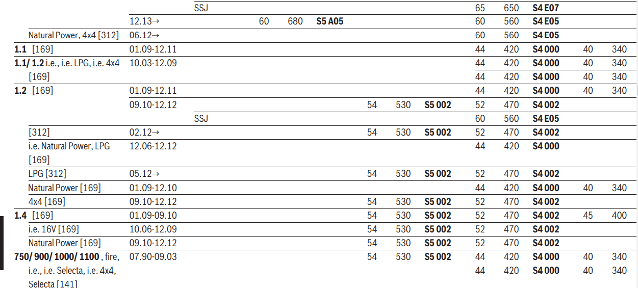

bosh catalogue

I would use something like the bosch catalogue i posted earlier https://aa-boschap-rs.resource.bosc..._parts_rs/catalogues/products_3/batteries.PDF
then search for that particular size and CCA
your current battery will have a code on it ie 054.
put this into a site such as Tayna (recommended by the way) or select from the list and this will give you a large range of batteries to choose from, go for a higher cca and select one within your budget.
