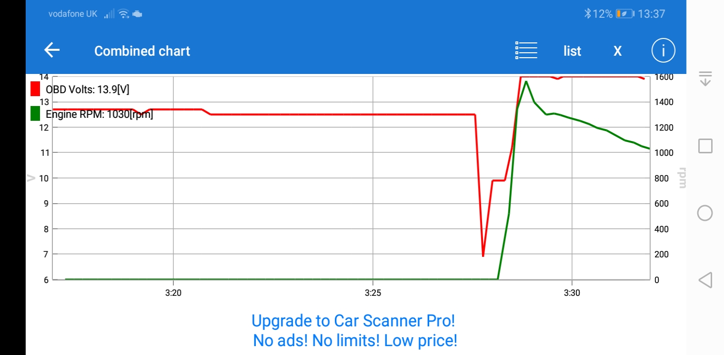

If you have a scan tool measure the voltage drop during cranking
You can not measure this with a multimeter it drops too quickly, a new good charged battery should stay above 10 volts, this is mine at the end of its life
