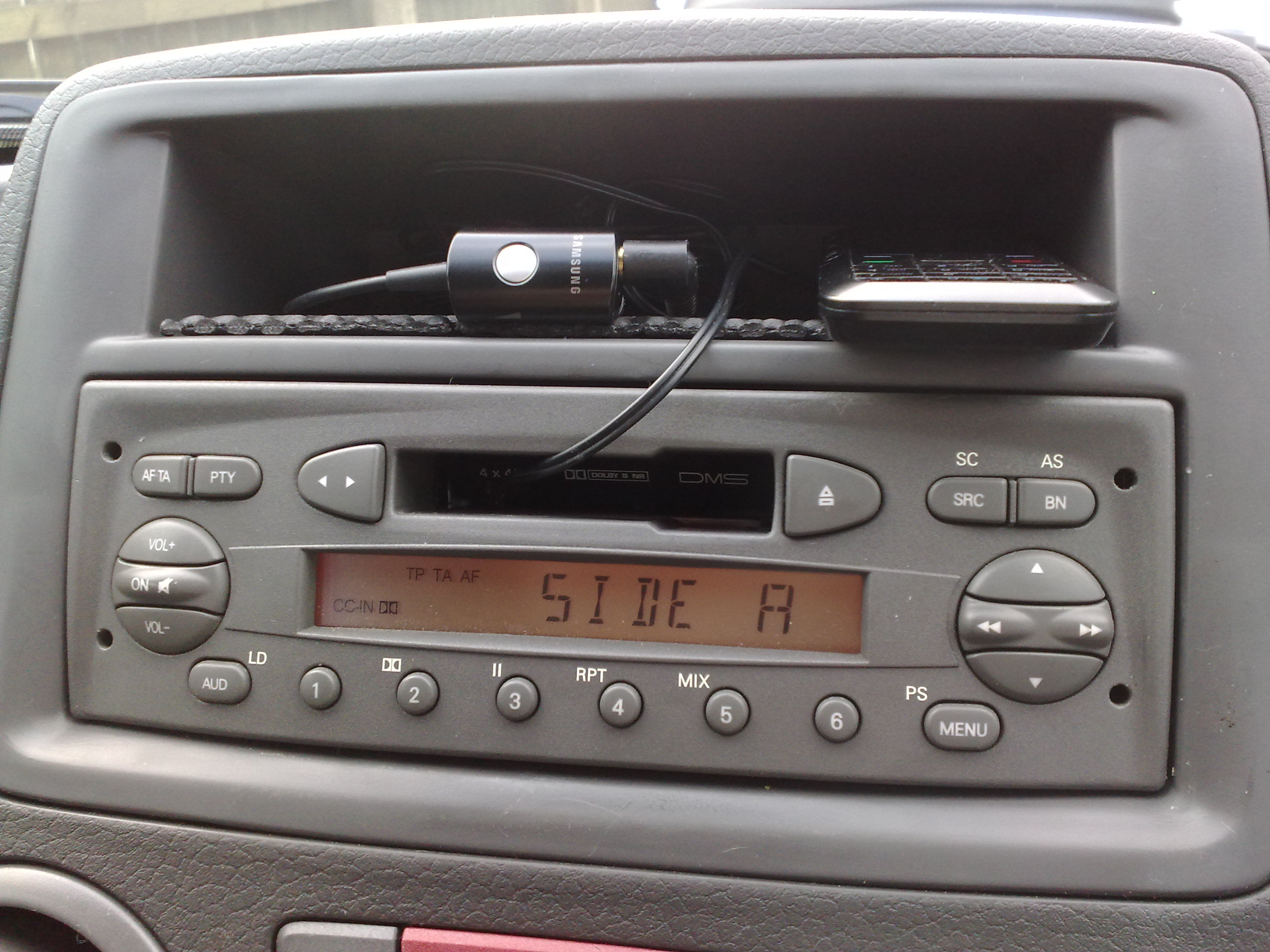

I had a hoke in the garage and found an old tape deck for the panda and pulled out the cd and stuck in the tape (like who uses either now, like really? It's either radio or the 'Comes with Music' on my nokia or laptop).
Got the tape converter, found a handsfree from my junk box that seems to say samsung on it and now for the grand cost of 'bugger all' I've got a mp3 car kit, lol
When a call comes in I just press the silver button and the mike in that little box picks up my voice and the caller goes thou the cars 4 speakers. When the call ends the phone goes back to playing music again.
Quite happy with my 'Heath Robinson' approach to it all:rolleyes:
Fred
