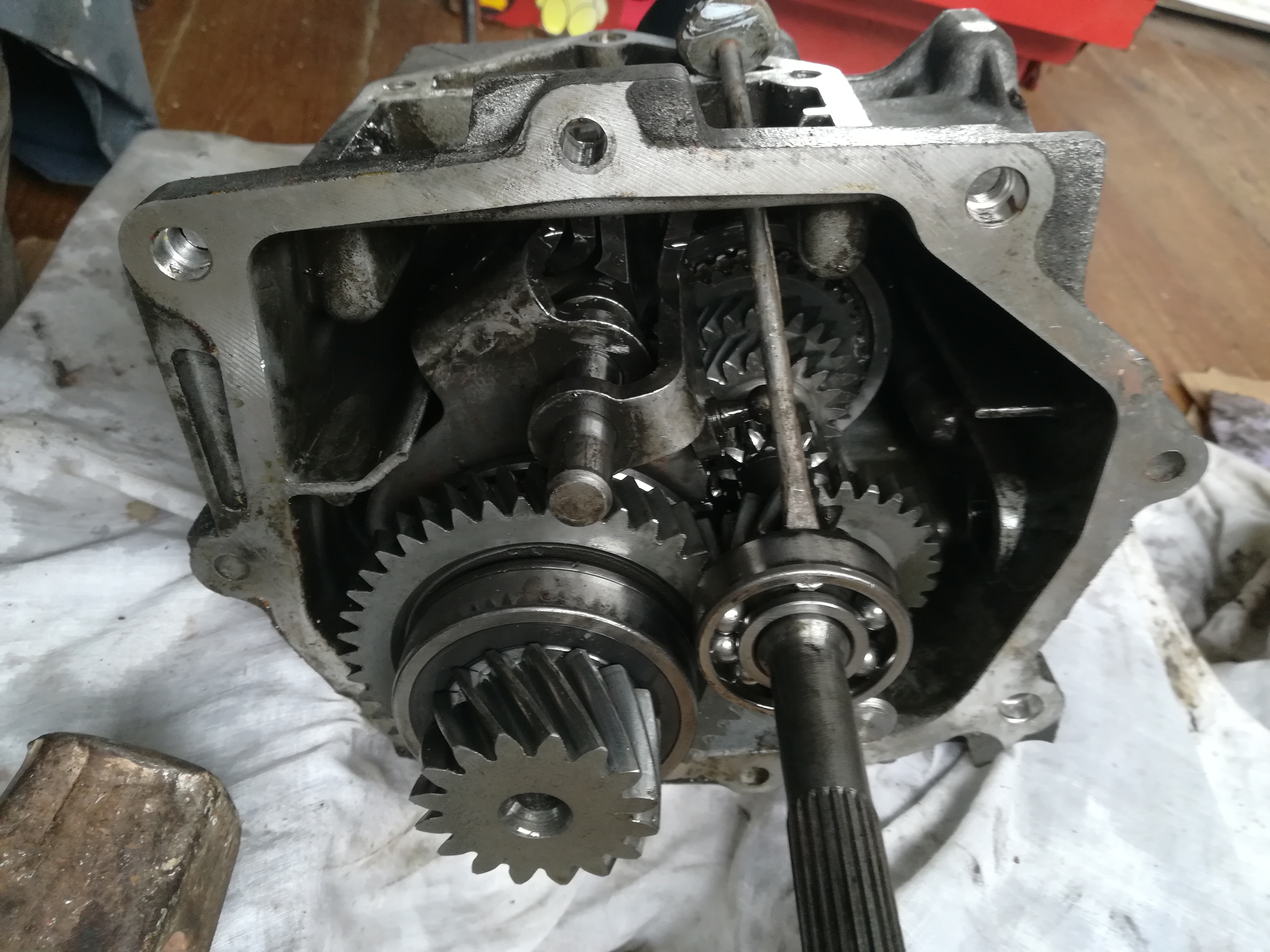

I finally got round to pulling my gearbox apart today. There was play in the input shaft...
...and I discovered my input shaft bearing looks like this:
Only seven ball bearings, no seal, no cage. No markings on the bearing (I intend to replace it tomorrow with SKF Explorer 6204 C3).
Is this normal?
I've drained the gearbox twice now (first as routine maintenance when I got the car in October 2018).
There were a few tiny metal particles in the drained oil. There's nothing obviously rattling about inside the box or differential.
Yes normal. My original and working 500 box had failed the same. Looking through eBay at least 50% of the cheaper ones need replacing and new input seal.
if its an original bearing there should only be 7 ball bearings
The cage is glass reinforce plastic
It melts away if its ever starved of oil
one side had a glass reinforced plastic ring attached this should face the bellhousing so oil can run down the groove and lubricate the bearing
Measure the gap before you remove the bearing. Its not hammered all the way onto the shaft. Mine was three Stanley knife blades.
Its likely to be very tight on the shaft and the small gap isnt enough to get bearing pullers on unless you are lucky and the outer race stays in place
I used a chisel as a wedge to open up the gap slightly till my pullers would fit

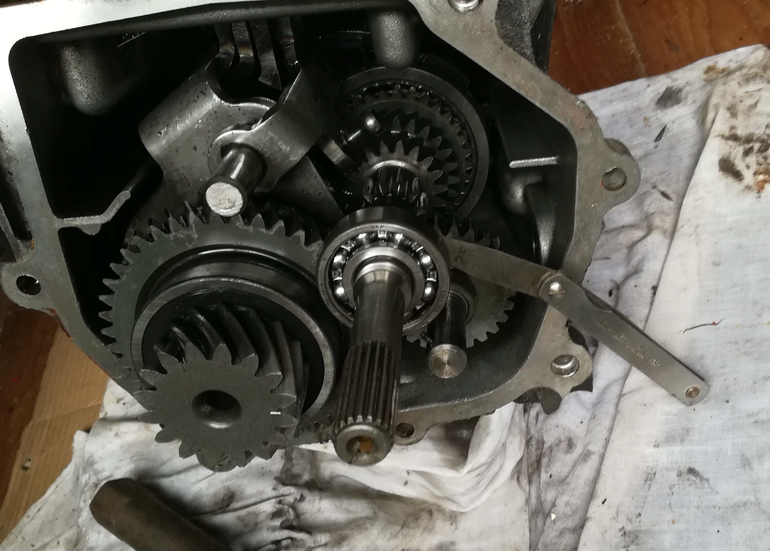

I measured mine at 25 thou and tapped the new bearing down to the same gap.
My old bearing wasn't too hard to remove in the end:)
I tried a variety of chisels and pry bars before settling on an old screwdriver I could place against the inner race.

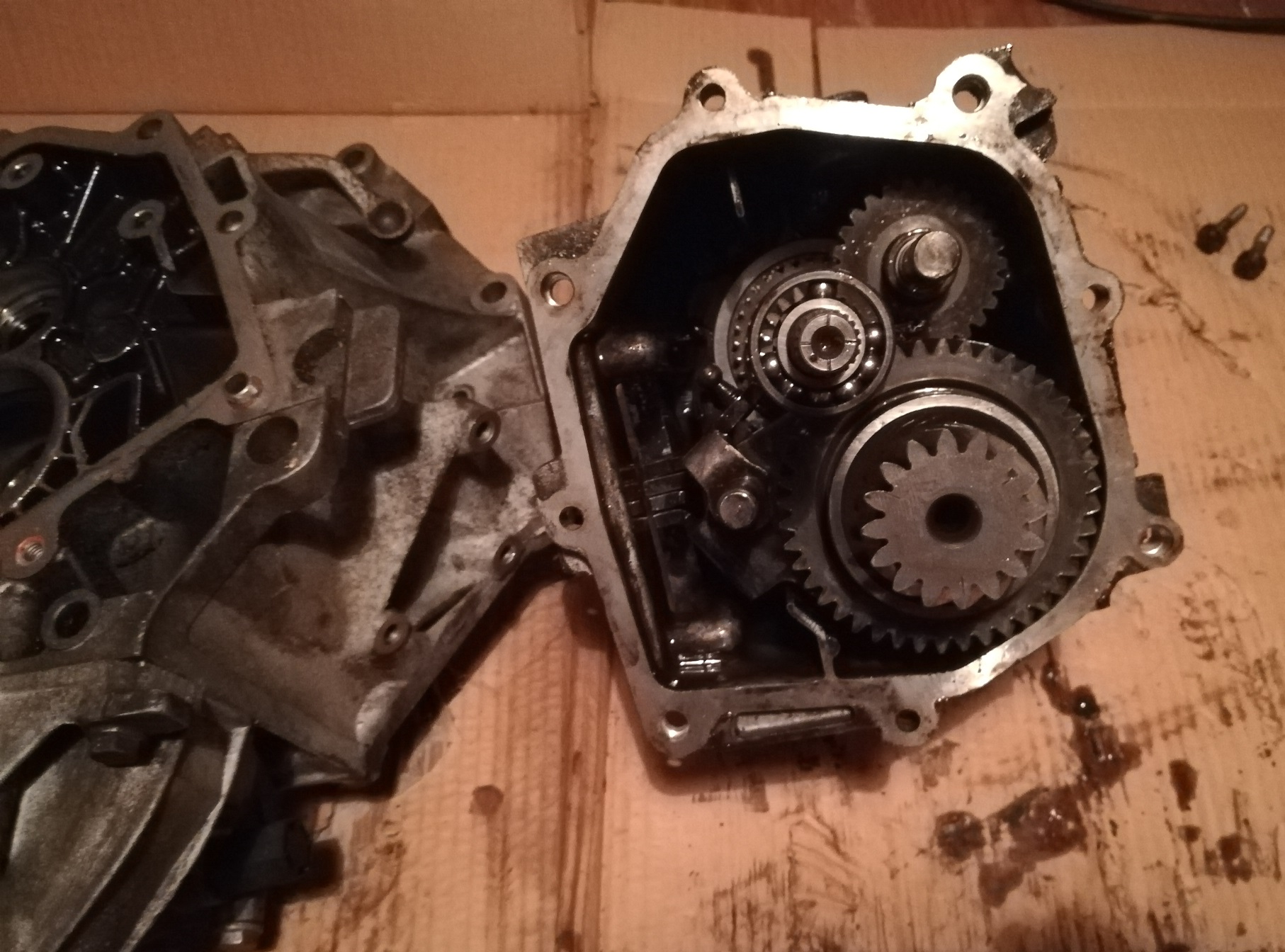

Thank you for this. Yes, my inner race was badly pitted (hopefully shown in pic).
I did um and ah over getting a sealed bearing. I can see now that it makes a lot of sense. The other bearings in the box are sealed, it's only the input shaft bearing that is open.
Due to the vagaries of getting parts delivered to my new home in Ireland, I could get a non-sealed bearing for about 1/4 of the price. So that's what I did. Oh well, fingers crossed it'll last another 100k miles:eek:
