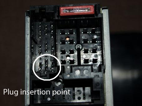

you know that you need to break the pins out of the aux input lead connector?
The other way of doing it is doing what this member did and usefully illustrated :) https://www.fiatforum.com/attachment.php?attachmentid=52592&d=1225387263
Obviously it's a one shot thing, ie when you push them home that's it, but you can insert them enough to make contact to test you've got the pins inserted in the right place on the back of the connector block.
Is that true? So once you put the plug in that's it, you can't take it out?? :eek:

It is only the pins you can't get out of the plug again, the plug still comes out fine so there's nothing drastic or irreversible about it, just you can't do it more than once with the yellow plug that comes with the caR.

Now this is where the problem becomes apparent - The multi coloured connector block occupies all available slots on the back of the head unit...So there's no place to plug the nice new lead in...
This might have been obvious to some, but as I'd never removed the stereo before, I wasn't sure if there would be a 'spare' port for the multichanger etc...There isn't...:p
Anyway, there's only one wire into the yellow block, but I'm not 100% sure what it's for, so just disconnecting it to insert my new lead wasn't an option...So I had no alternative other than to (carefully) butcher the new lead to free the wires...
This done, I just looked at the handy picture on the other thread (https://www.fiatforum.com/attachment.php?attachmentid=52592&d=1225387263), and pushed them home into the relevant holes in the existing yellow connector...

I need some help with this.
Ive brought the lead and will remove the 3 wires.
Can someone tell me where each wire goes.
There is a red wire, a thin black one and a thick black one.
I know where the 3 holes are in the back of the HU but i am not sure where each one goes. Thanks, i dont know anything about electrics.
Hey Paul,
THICK Black one is the EARTH and goes in the middle hole of the 3
THIN Black & THIN Red are LEFT / RIGHT and go in top / bottom holes....
Not sure which one is L/R though! :eek:

I'm a little confused :confused: when I compare it with this https://www.fiatforum.com/attachment.php?attachmentid=52592&d=1225387263
Could someone please tell me if this would be the right connexion :worship:
I think its confusing as the block has been turned around in the pic. I did it the way 'ThisBitterPill' said to and it works fine. I aint no expert but i dont think it matters which slots you put the other two pins into as long as you get the earth right. I tried them both ways and it didnt make any differance to the sound.
When I connected mine up the way you show it in your pic (the same way that it is shown in the other thread) I could just about hear the output but it clearly wasn't right.....
Through trial and error I ended up with the set-up I previously mentioned....
LEFT & RIGHT wires (the thin ones) in the holes you have marked as LEFT & EARTH....
The EARTH in the one you have marked as RIGHT (the middle one)
(although I ended up earthing mine throught the casing as I broke the clip!)
Try putting the LEFT and RIGHT wires in place but don't fully click them in....Then try the EARTH and you should hear your output....(make sure your mp3 player is playing!)
I run my mp3 player in LINE OUT mode....
Good luck....let us know! (y)

Popped my headunit out, thick black wire in the middle of the yellow connector and the thin black and red in the relevant slots either side.
