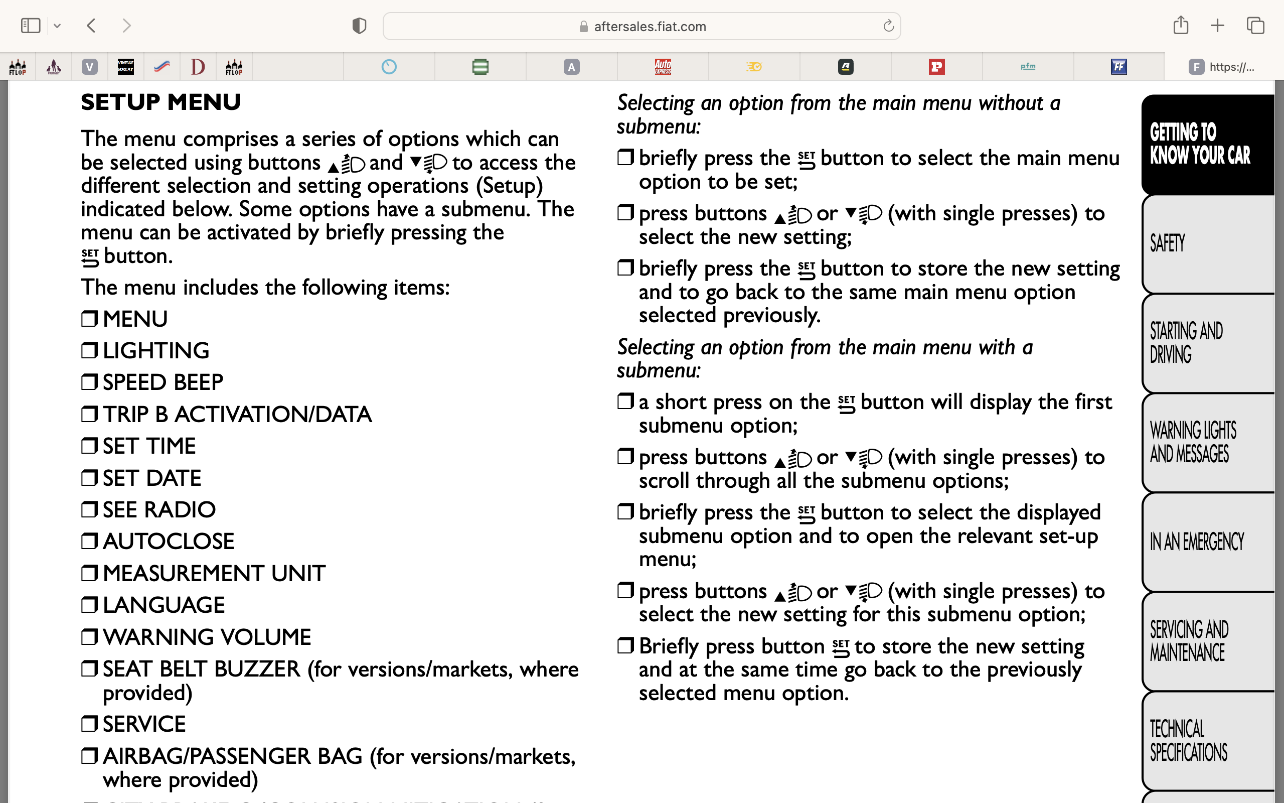

I've just noticed that my new recent Cross 4x4 hasn't got auto locking door function when I drive off. I'm sure my old (2018) Cross had it. Can anyone confirm?
It's in the menu for my car which is a 2023 4x4 so presumably the same for your own but you can just push the driver's door handle away from you and that locks the doors.
