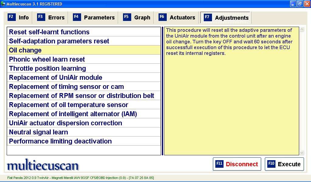

Our 2012 Panda Twinair has developed the exact same problem. All following an oil change and a Multiair 'oil change' reset on Multiecuscan..
See Pic 1
Now, from a cold start (takes about 6+ hours from parking up this summer), the engine runs very rough and if allowed to idle, a misfire will develop that Multiecuscan identifies as from cylinder 2. I've swapped plugs and coils and this problem stays at cylinder 2. I suspect that the mixture is being set so rich by the ECU that it is wetting the plugs, particularly no 2 to such a degree that it cant spark, and misfires. This is detected by the system and Limp mode is sometimes engaged.
This seems to be connected with the Multiair learning process as on subsequent cold starts, the rough running is appearing to lessen.
Allowing the engine to warm up slightly, restarting the engine the misfire clears and the car can be driven normally and tickover is smooth. I seem to remember this happening to a lesser degree at the last oil change but cleared up after the first cold start or so.
I am suspecting a failure of the No1 Lambda sensor is a culprit in all of this. At the cars last MOT back in March, the tester had difficulty in passing the vehicles emission test on Lambda reading, (HC and CO were fine though). Fuel economy has never been great but the vehicle is mainly used for short journeys.
A scan on Multiecuscan shows no reading at all for Lambda1 signal (just a 'V') but other figures related to it are there.
See Pic 2
Is this confirming my suspicion of a duff Pre-Cat sensor or is this just a bug in the software?!
I'm also feeling I should forget the Multiair reset on subsequent oil changes, it being more trouble than it's worth :bang:
