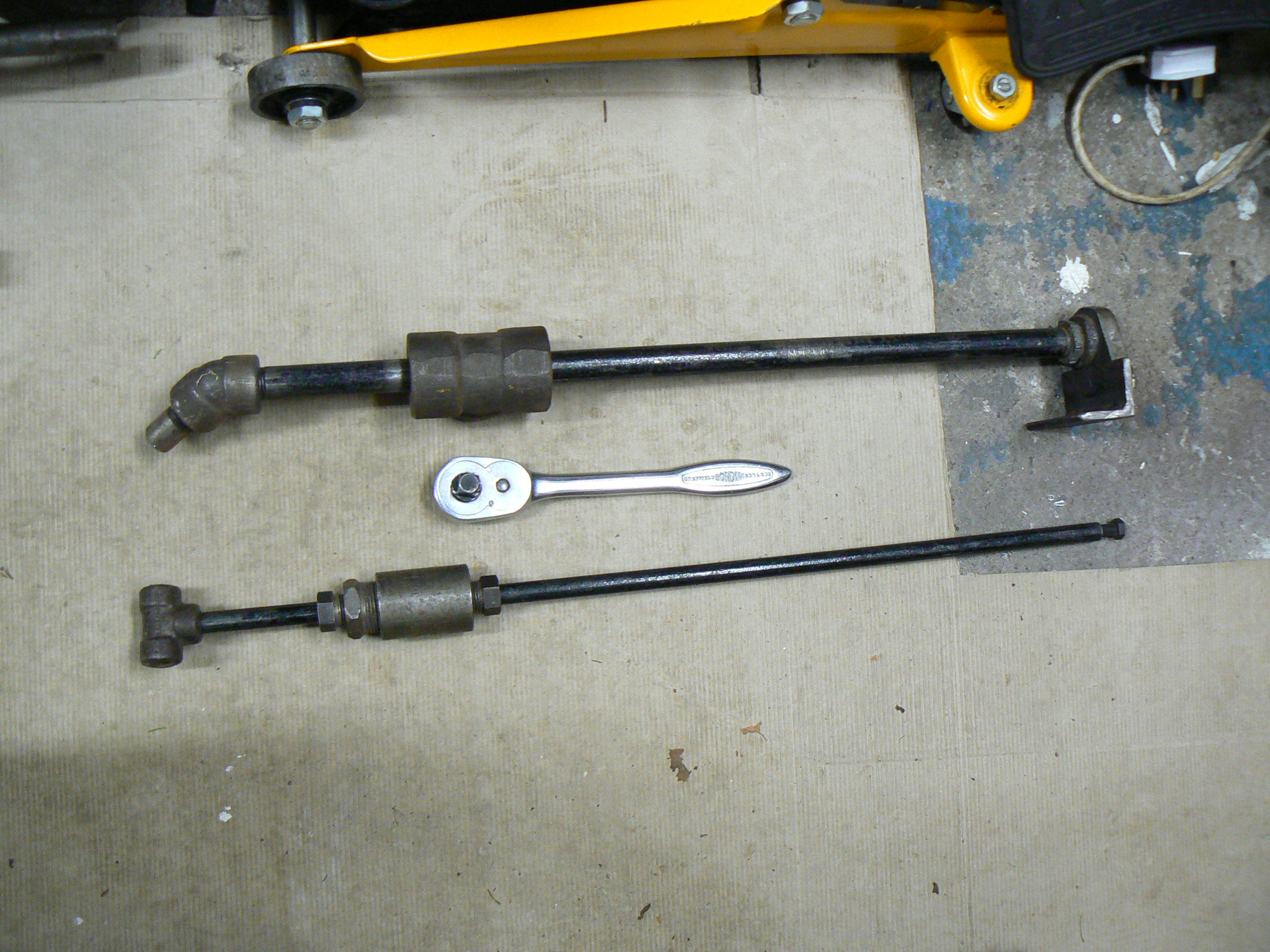

How d'ya like my two "pals" here? I've put a half inch drive ratchet handle alongside for size comparison.
Both made from old pipe fittings. The larger one I made probably about 45 years ago and the smaller a few years later. I mainly used the bigger one to pull hubs and half shafts but the smaller has been used for many purposes including pulling a stuck injector, a blind bearing in an alternator casing, etc. I realize now I haven't used the big one for many years.

I do like very much :)
I like them too. Just be careful of any bearings (especially ball bearings) when using them as it's all too easy to damage bearings when using any kind of impact tools.
